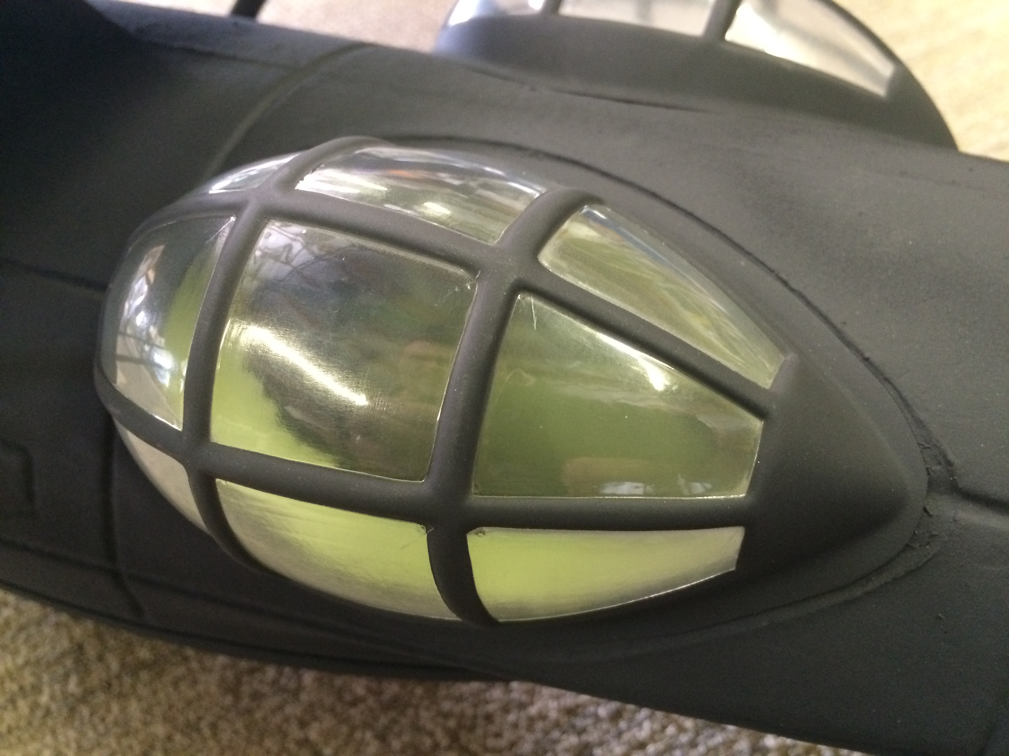

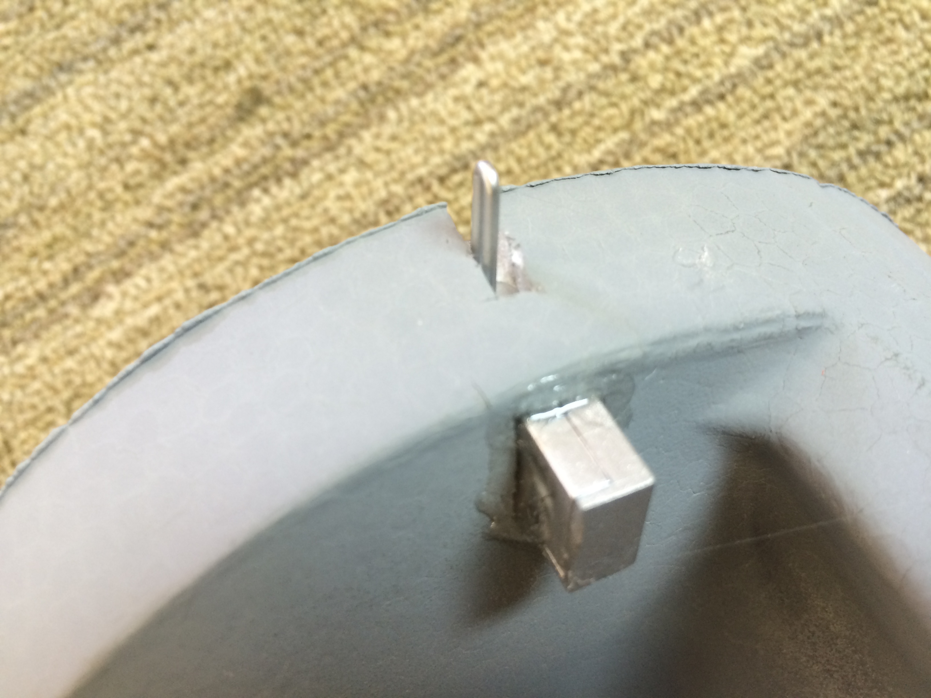

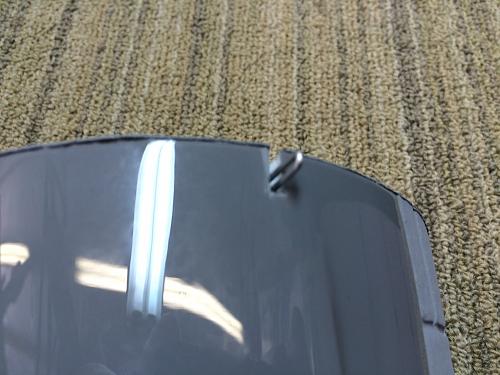

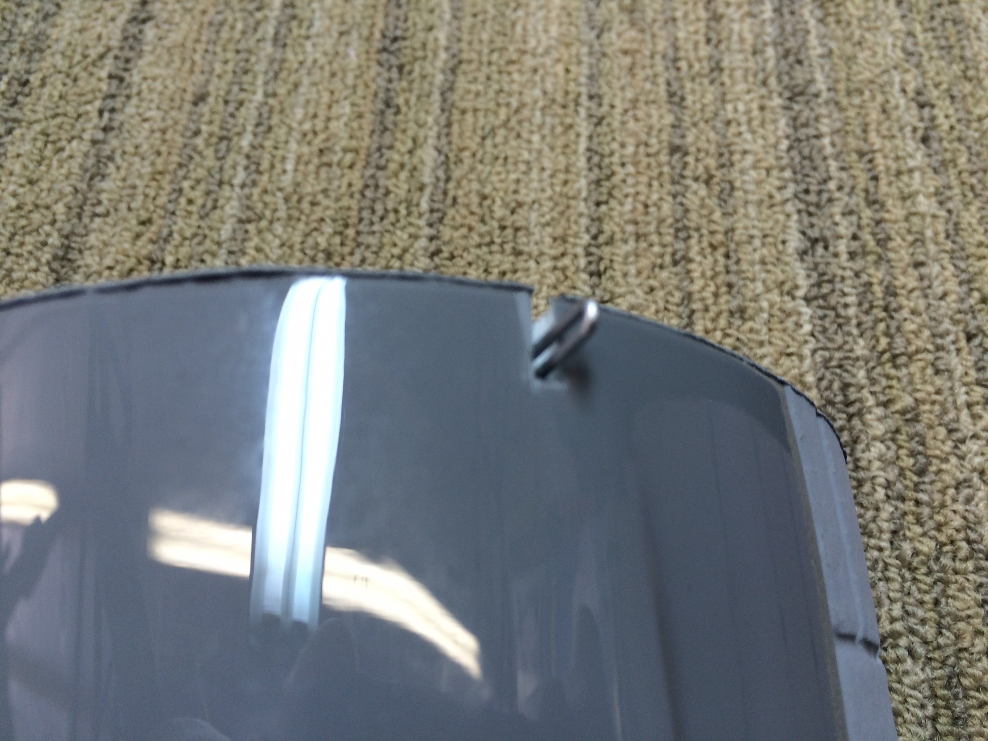

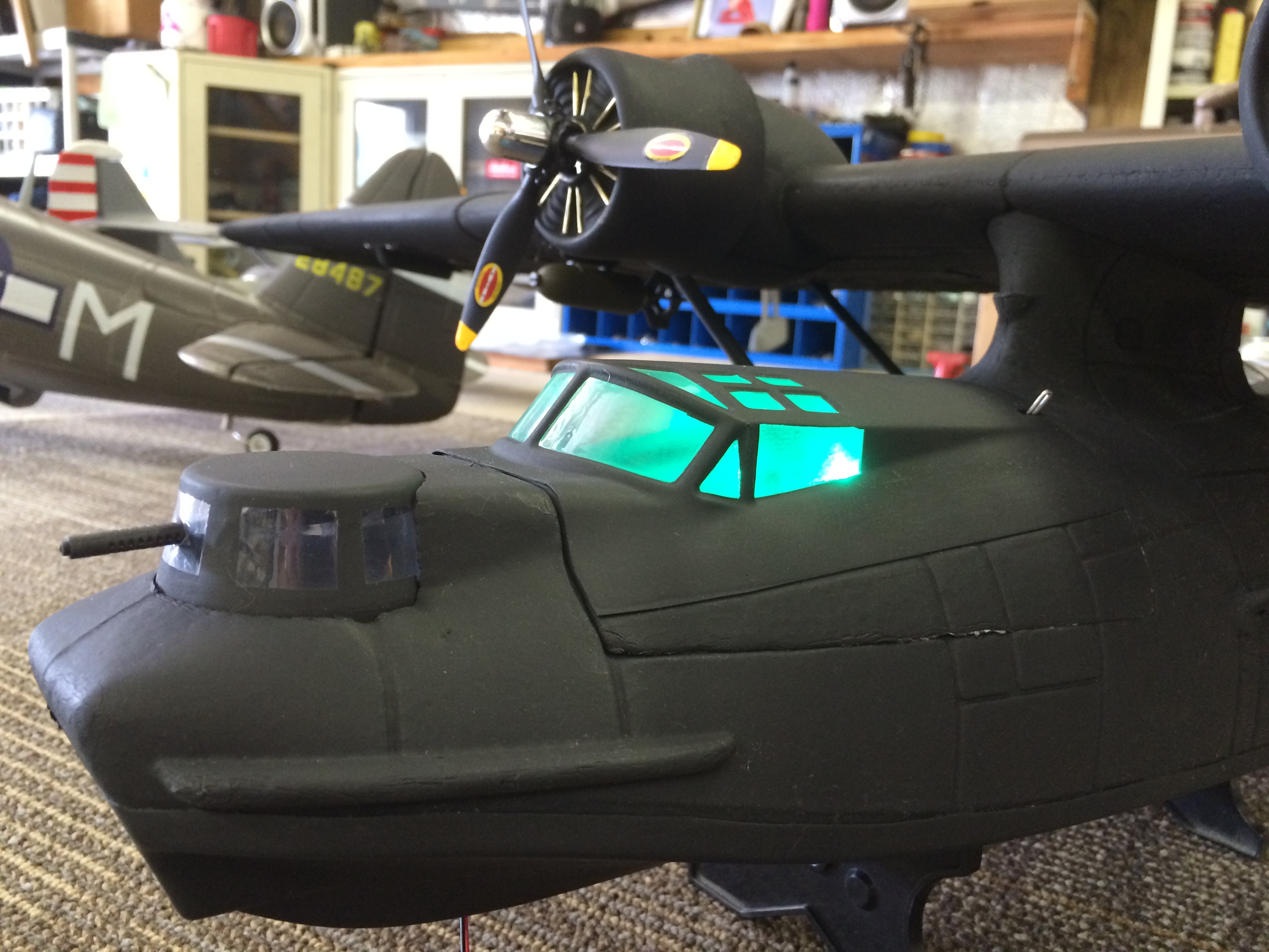

    I used a cockpit latch for a Flightline P-38.

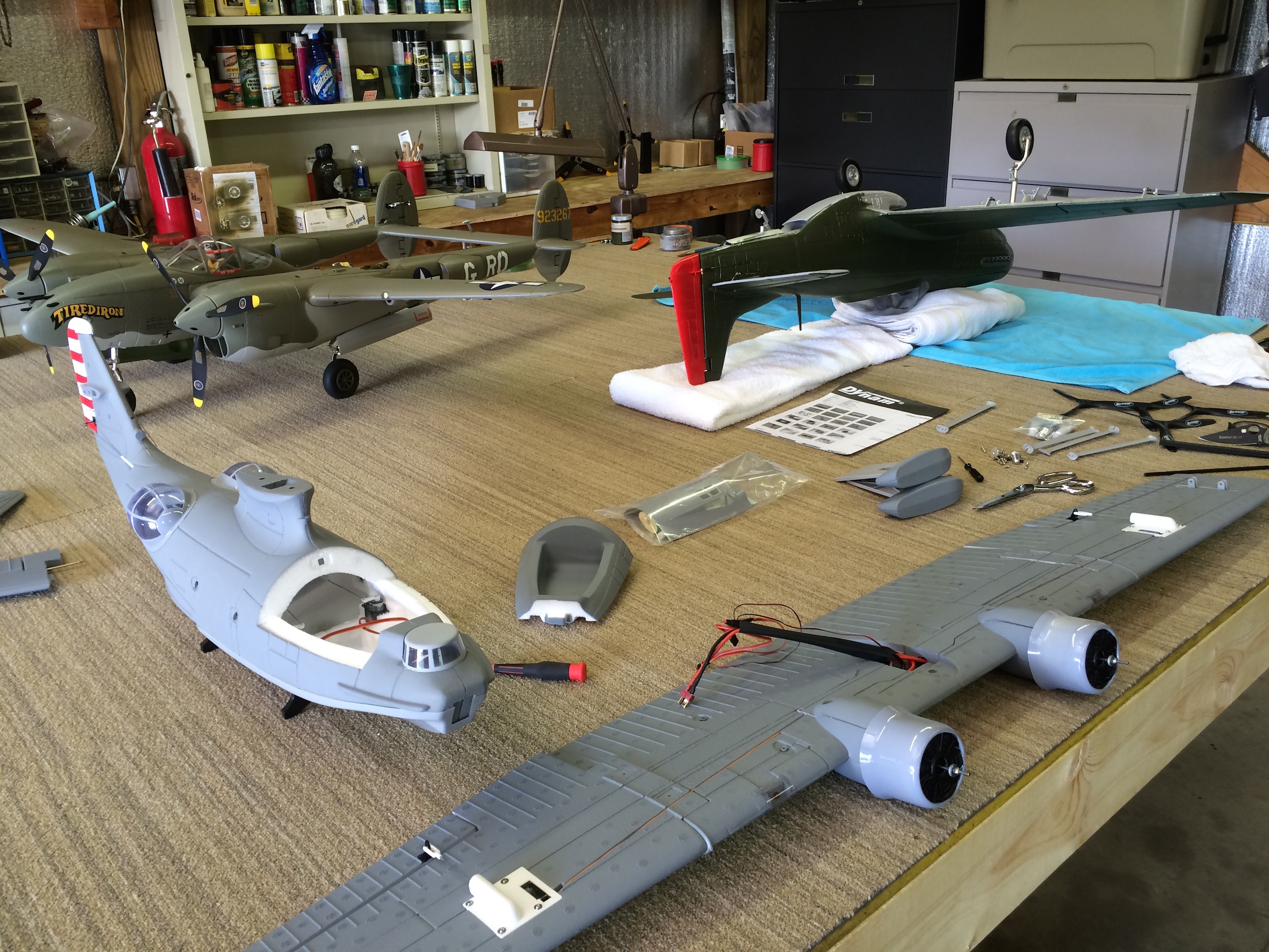

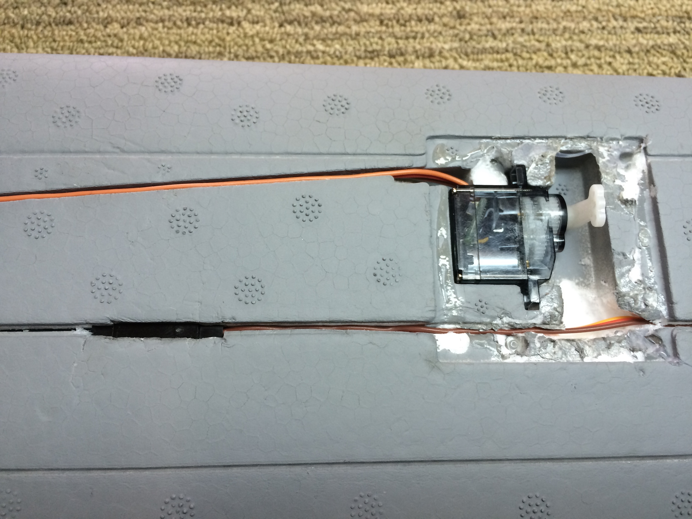

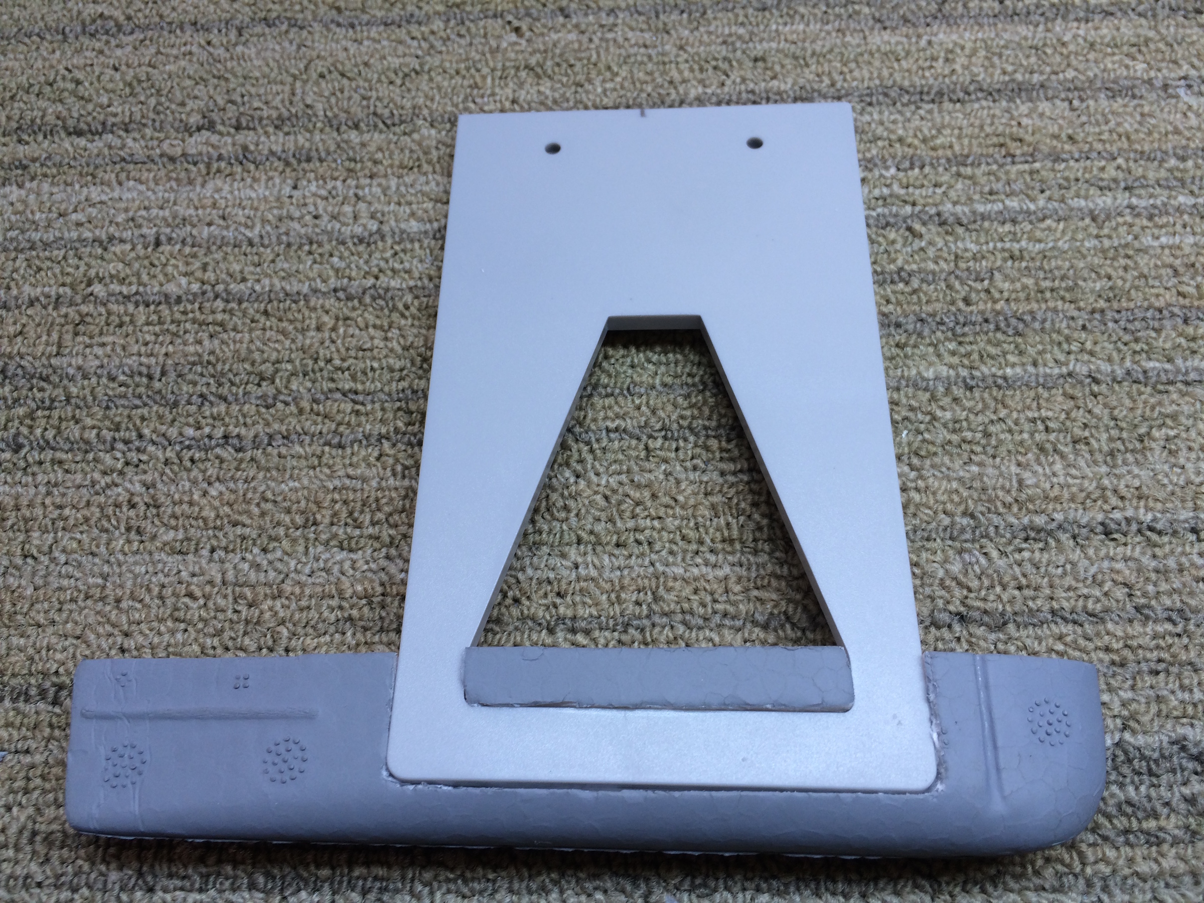

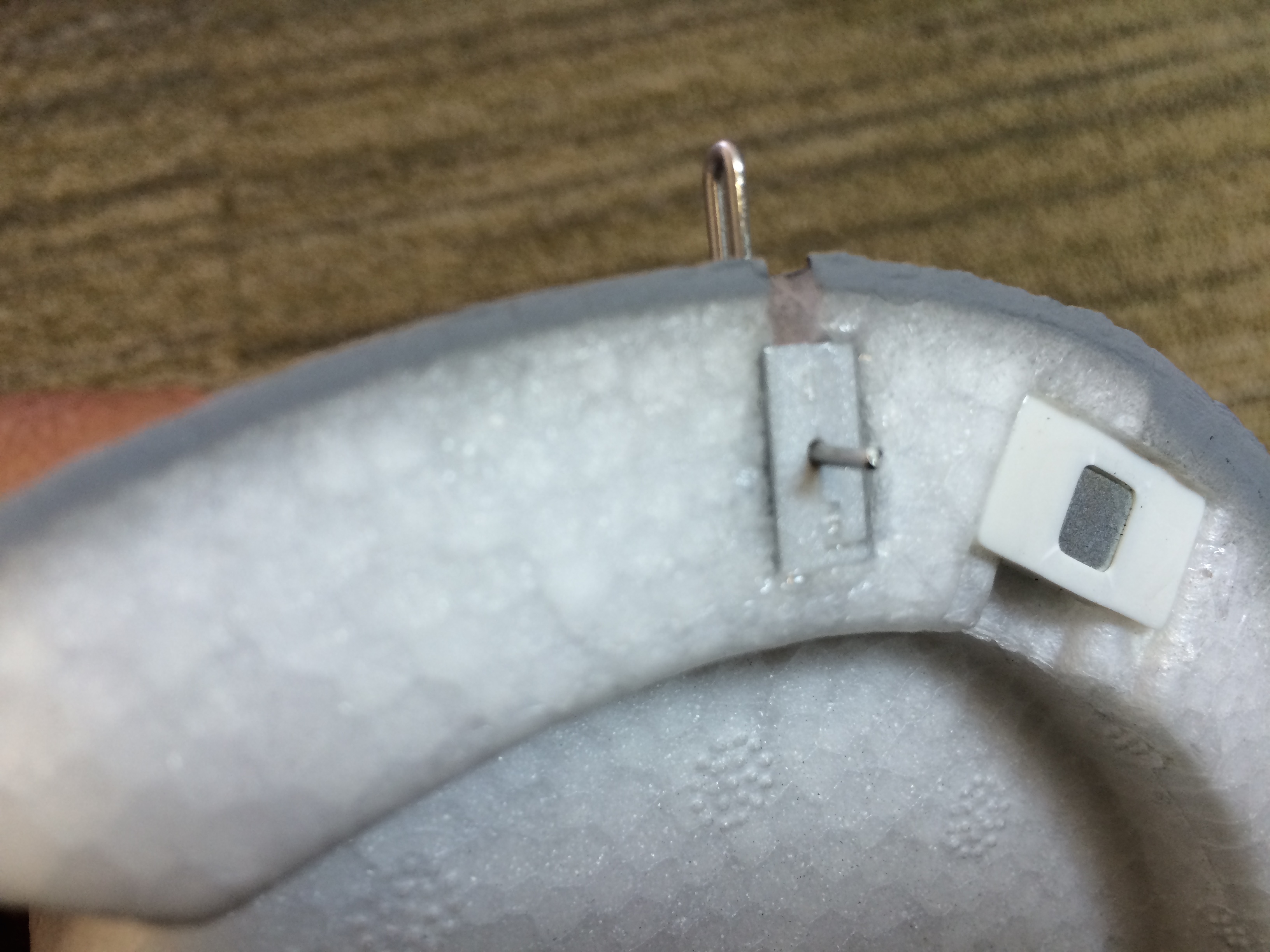

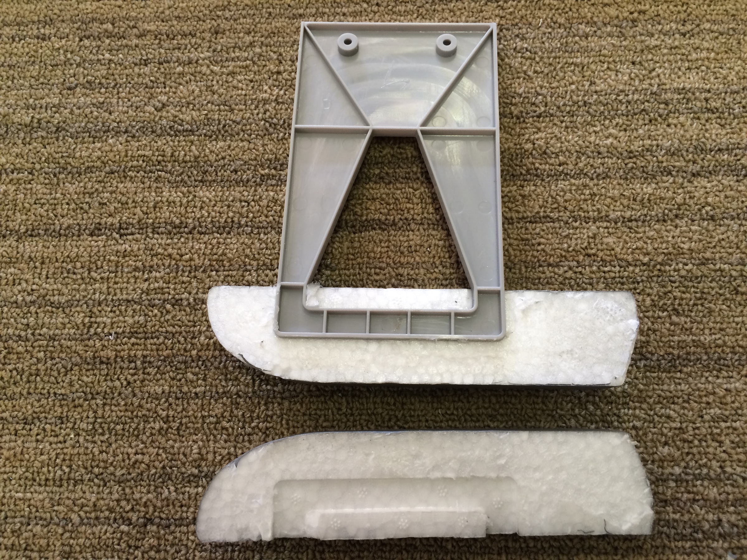

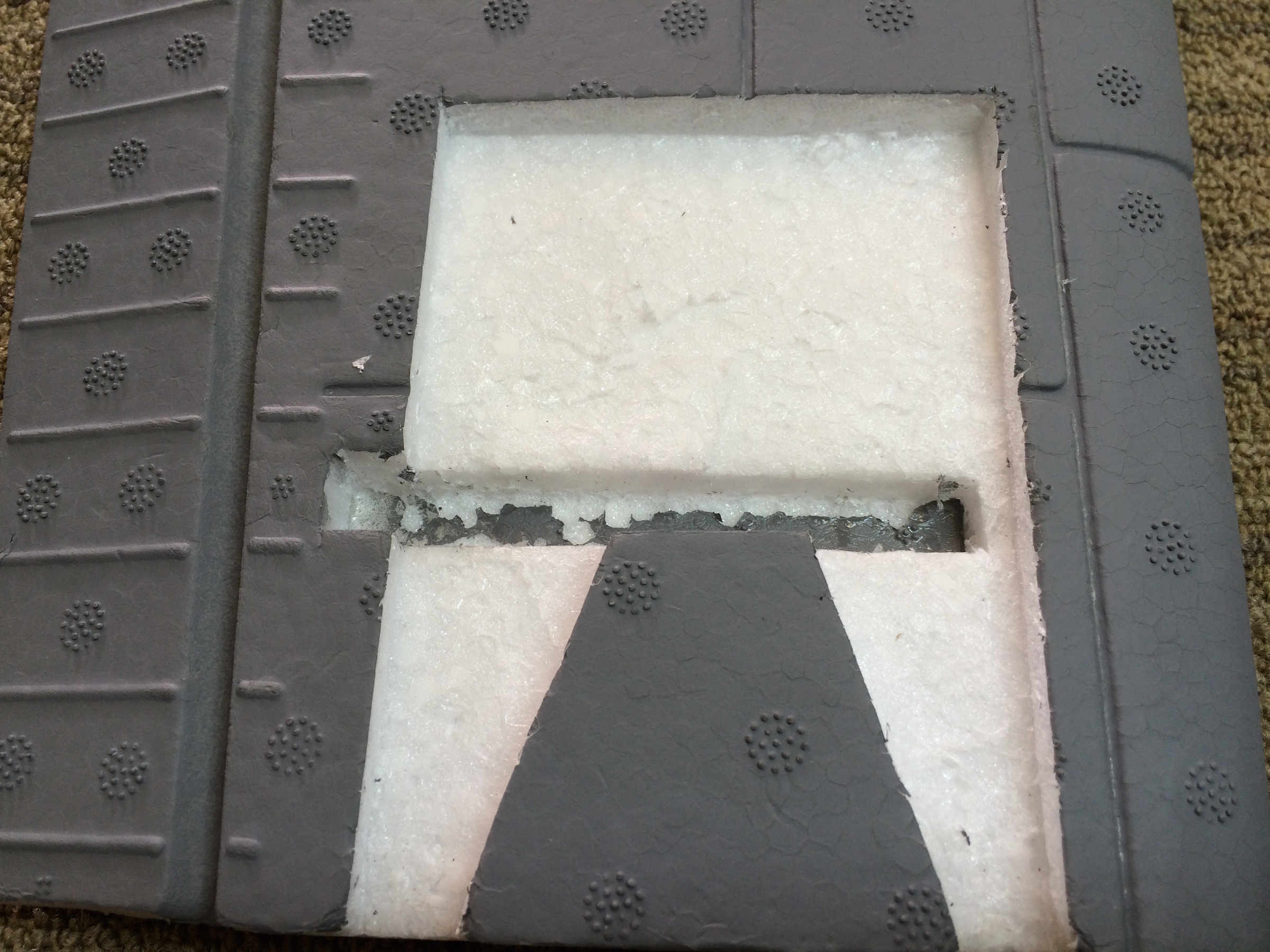

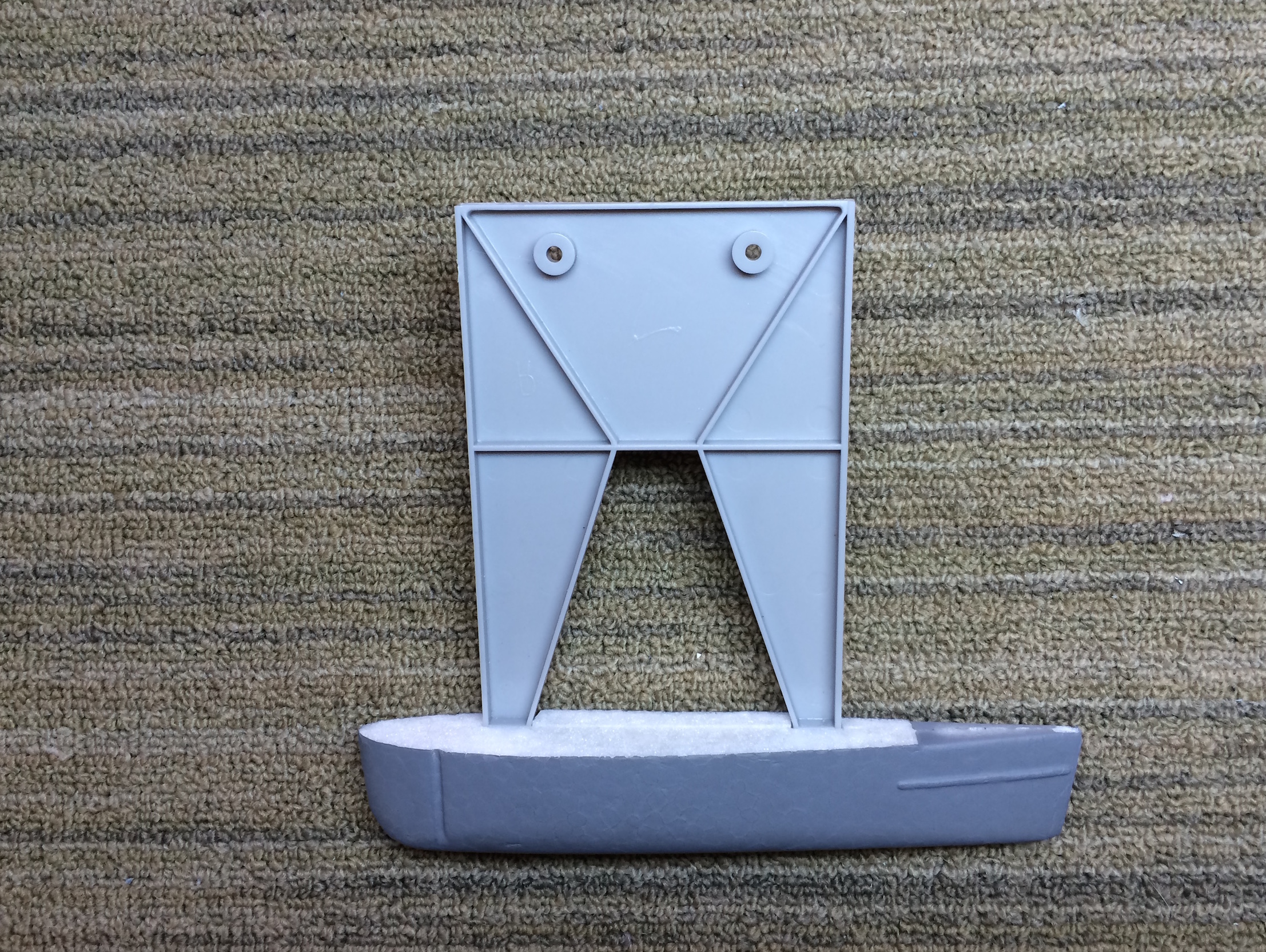

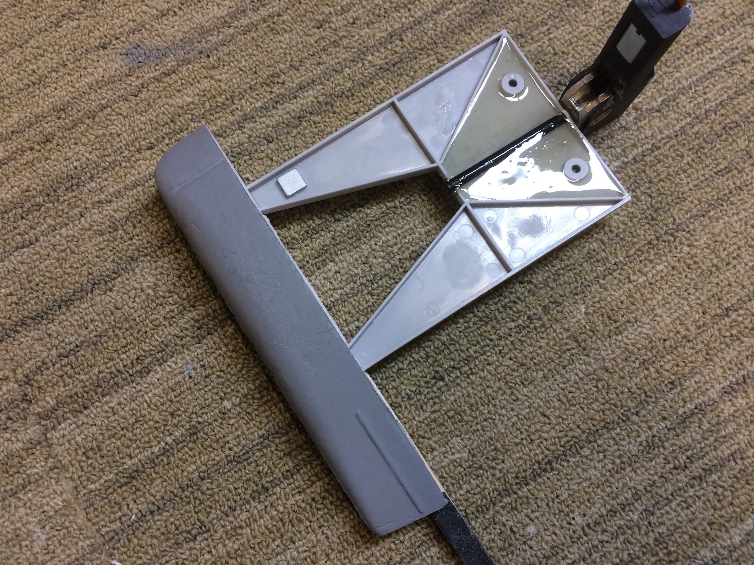

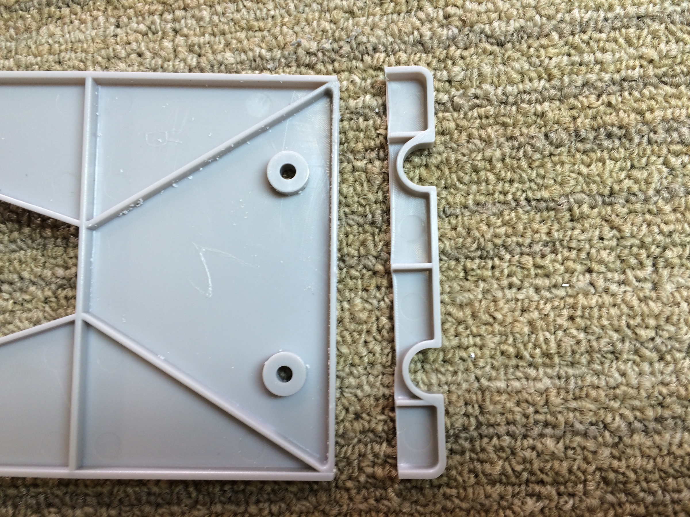

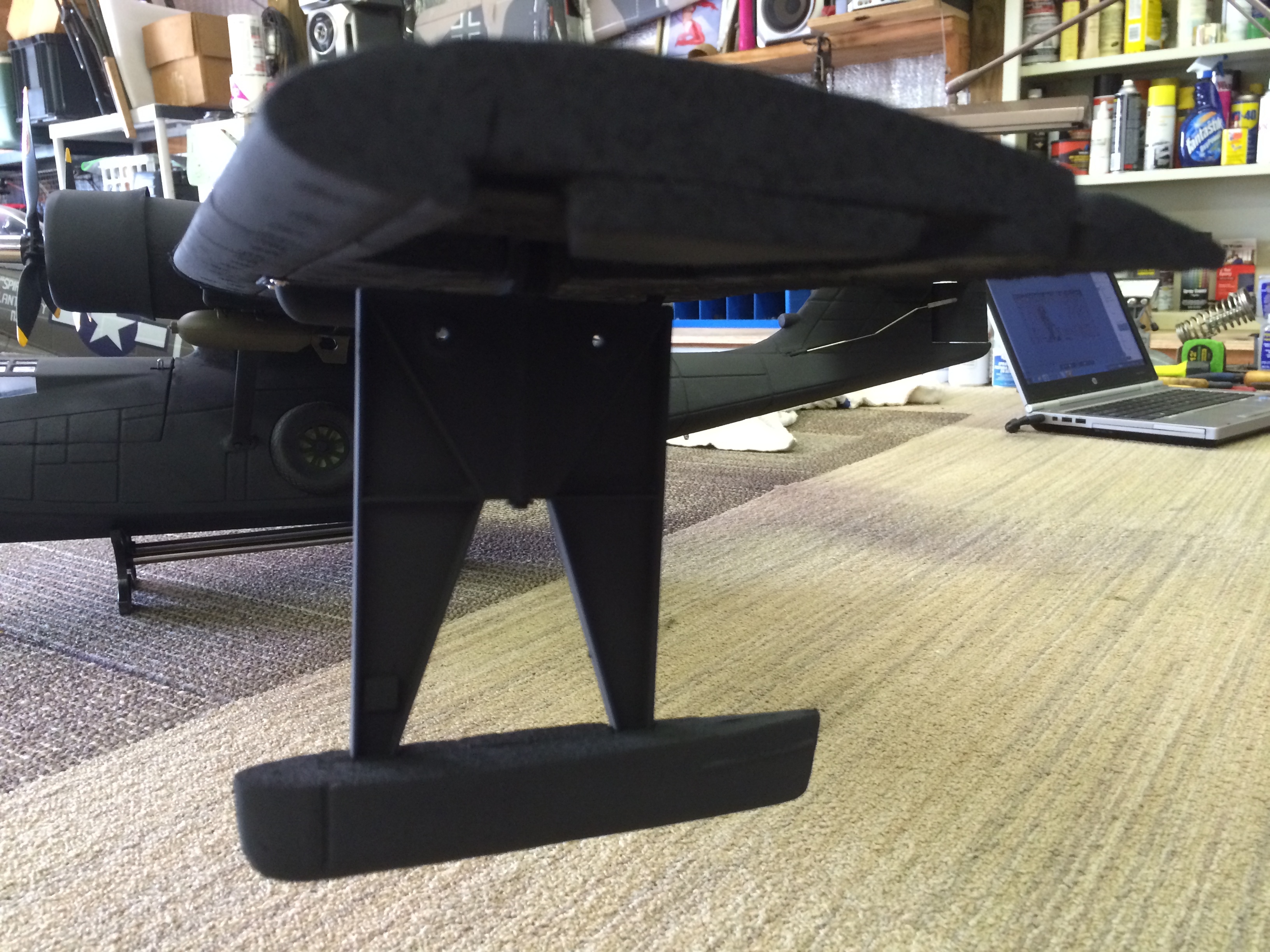

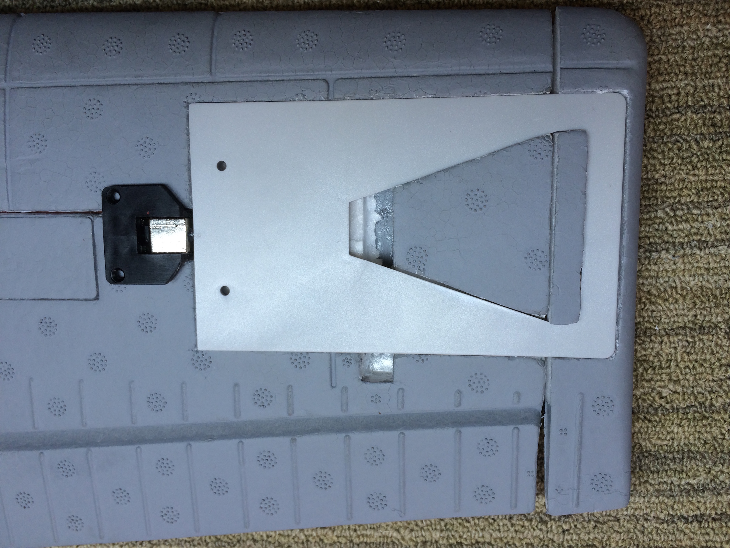

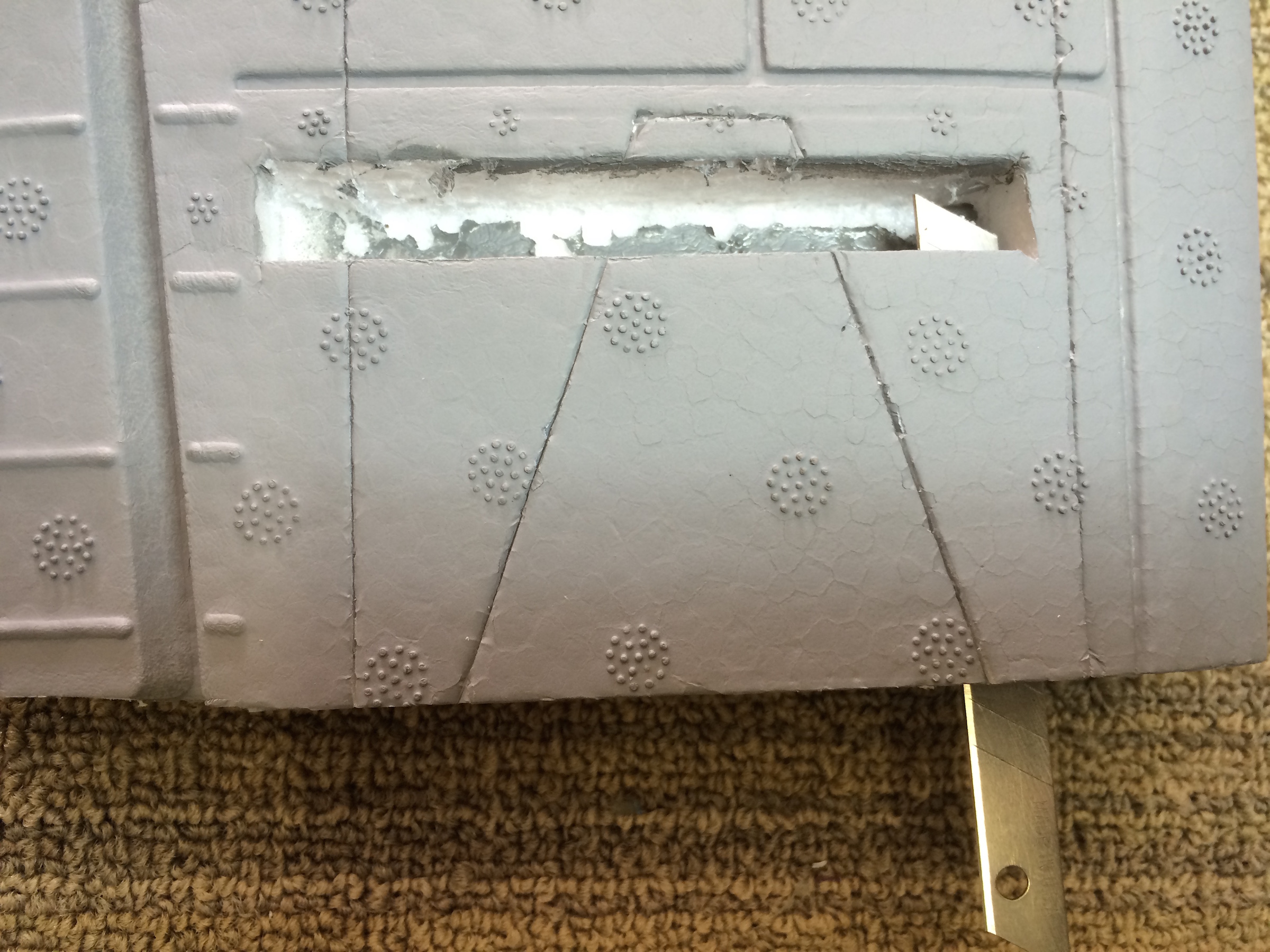

    I decided to make the wing floats retractable and even though it's not really scale I'm using the wing tip as the float.

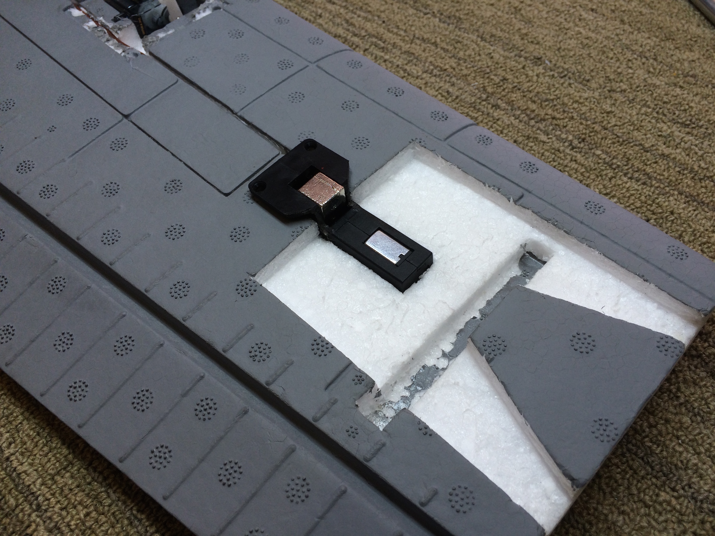

    I used a FlightLineRC Electronic Retract Type A, the magnet is to keep the float from sagging when retracted.

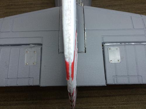

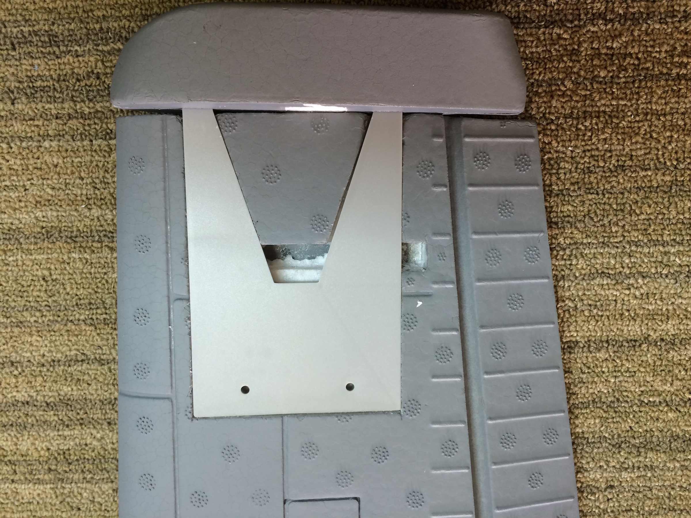

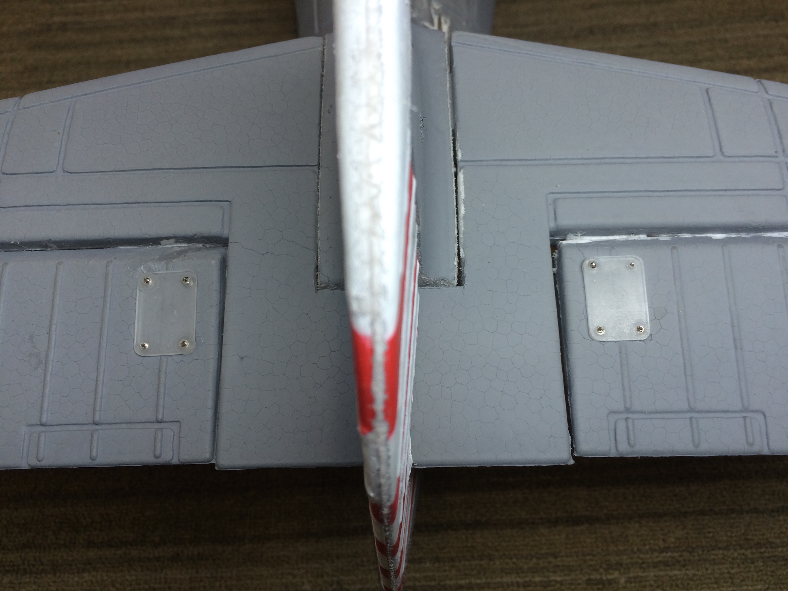

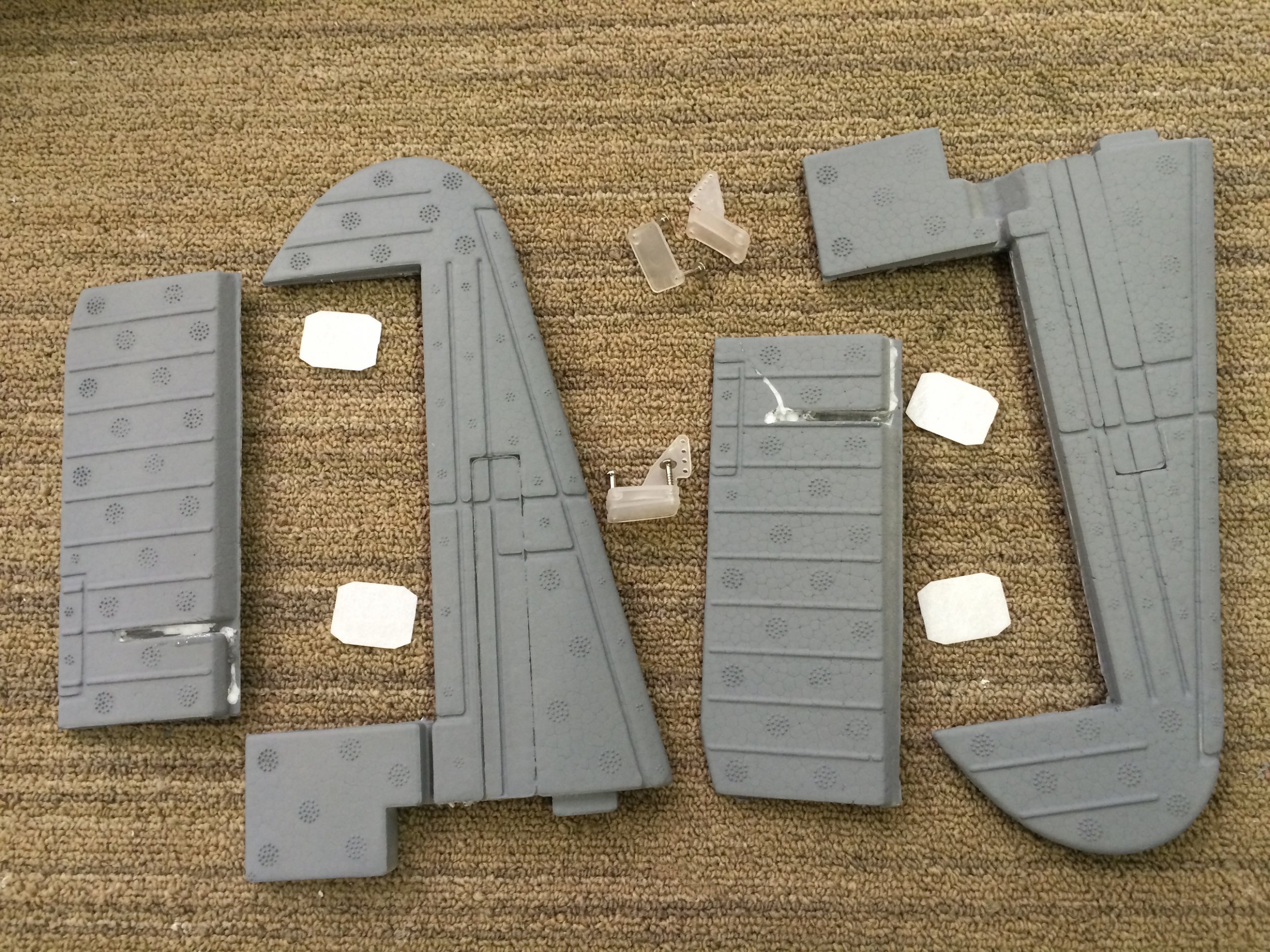

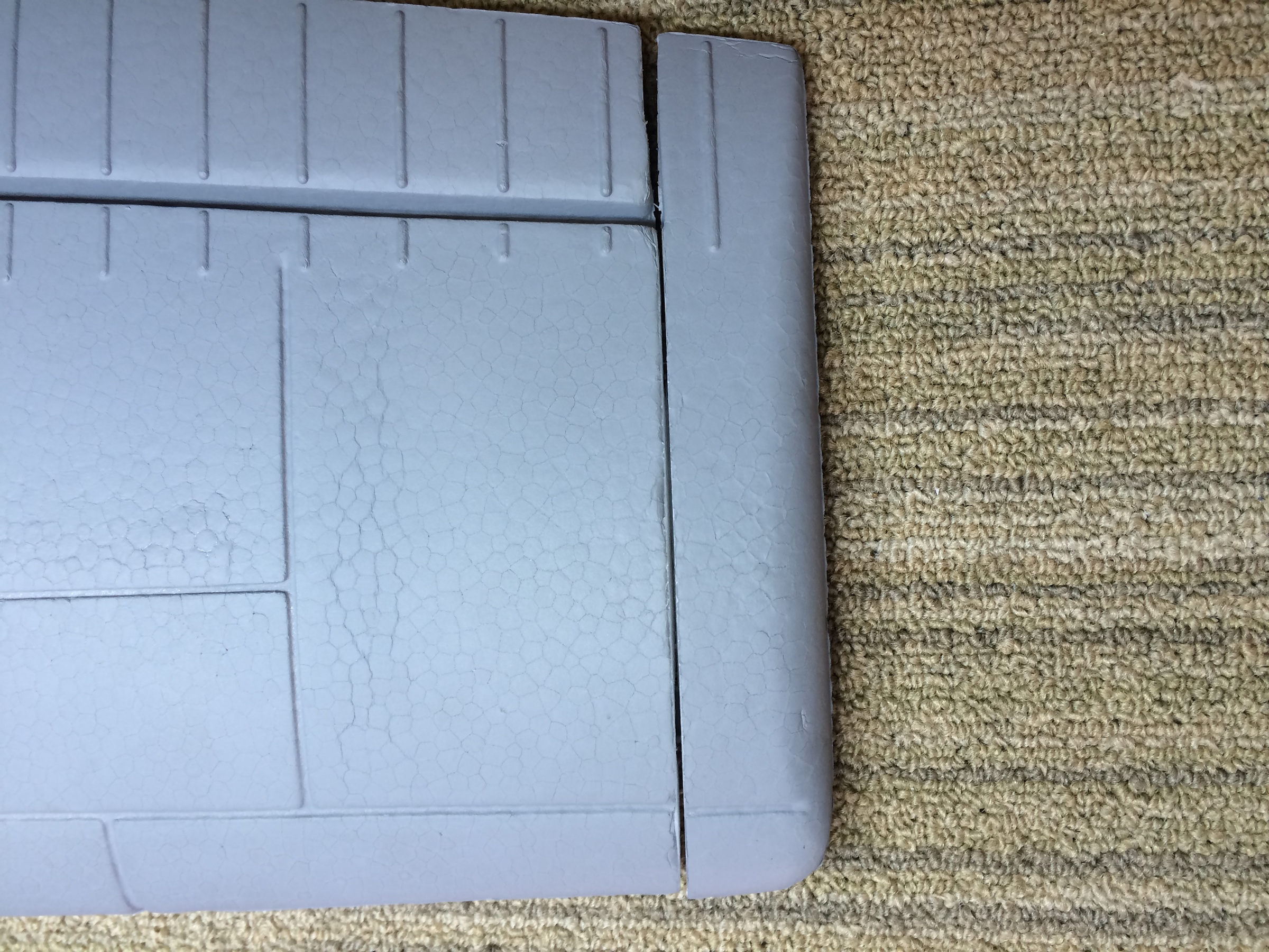

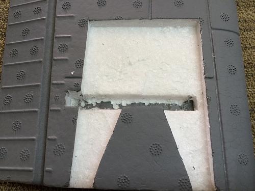

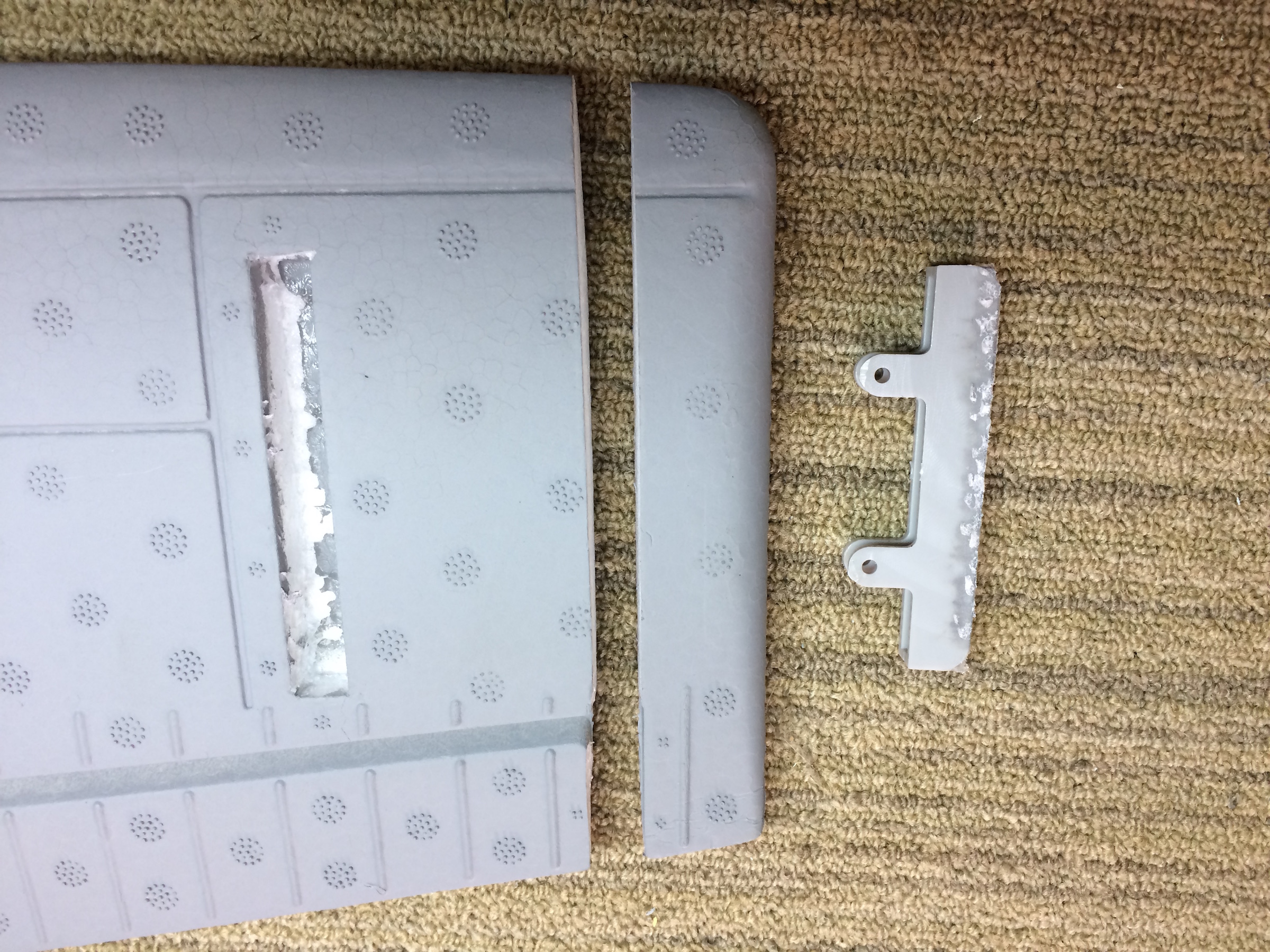

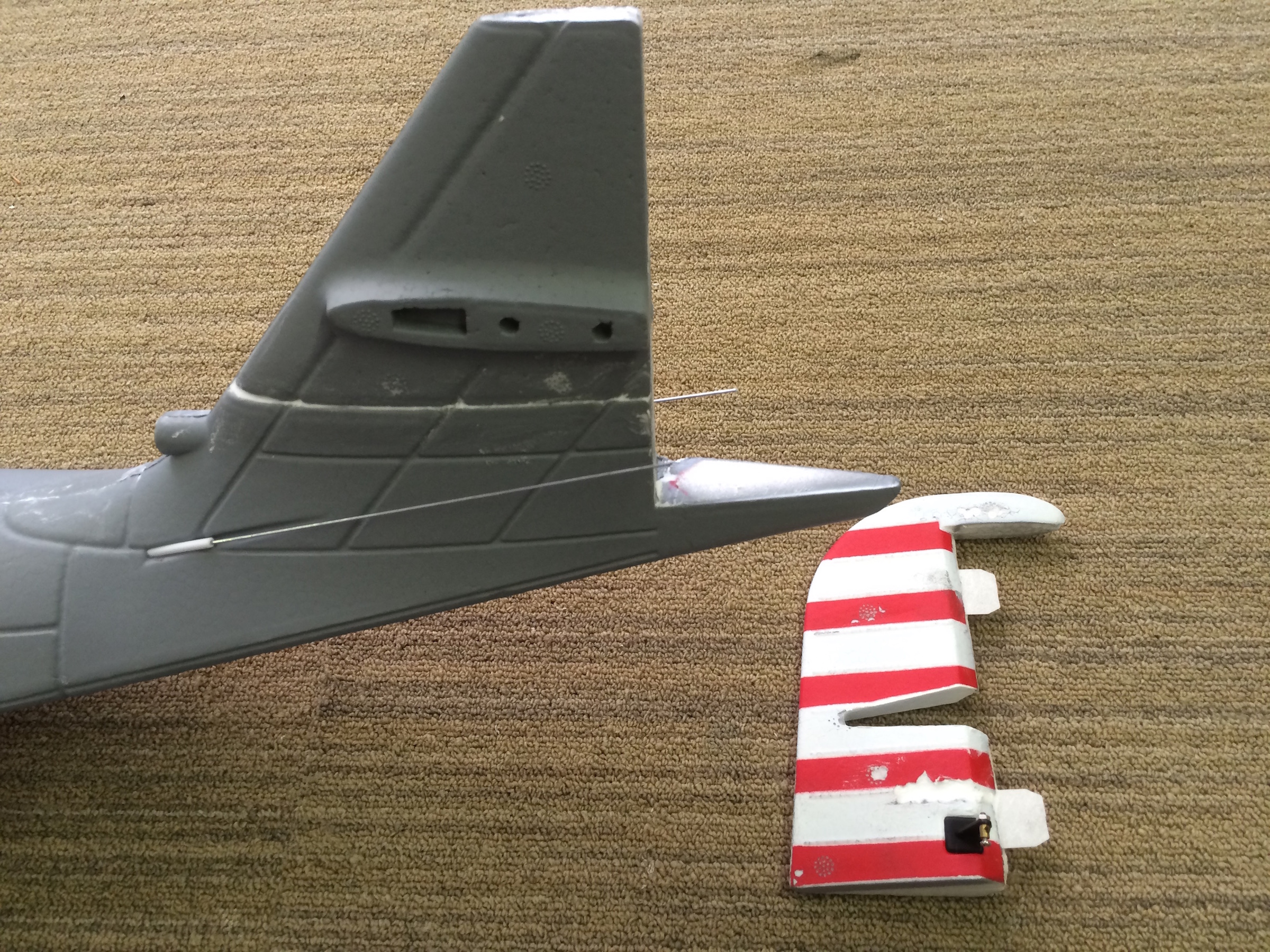

      I cut all the control surfaces off and put hinges on them.

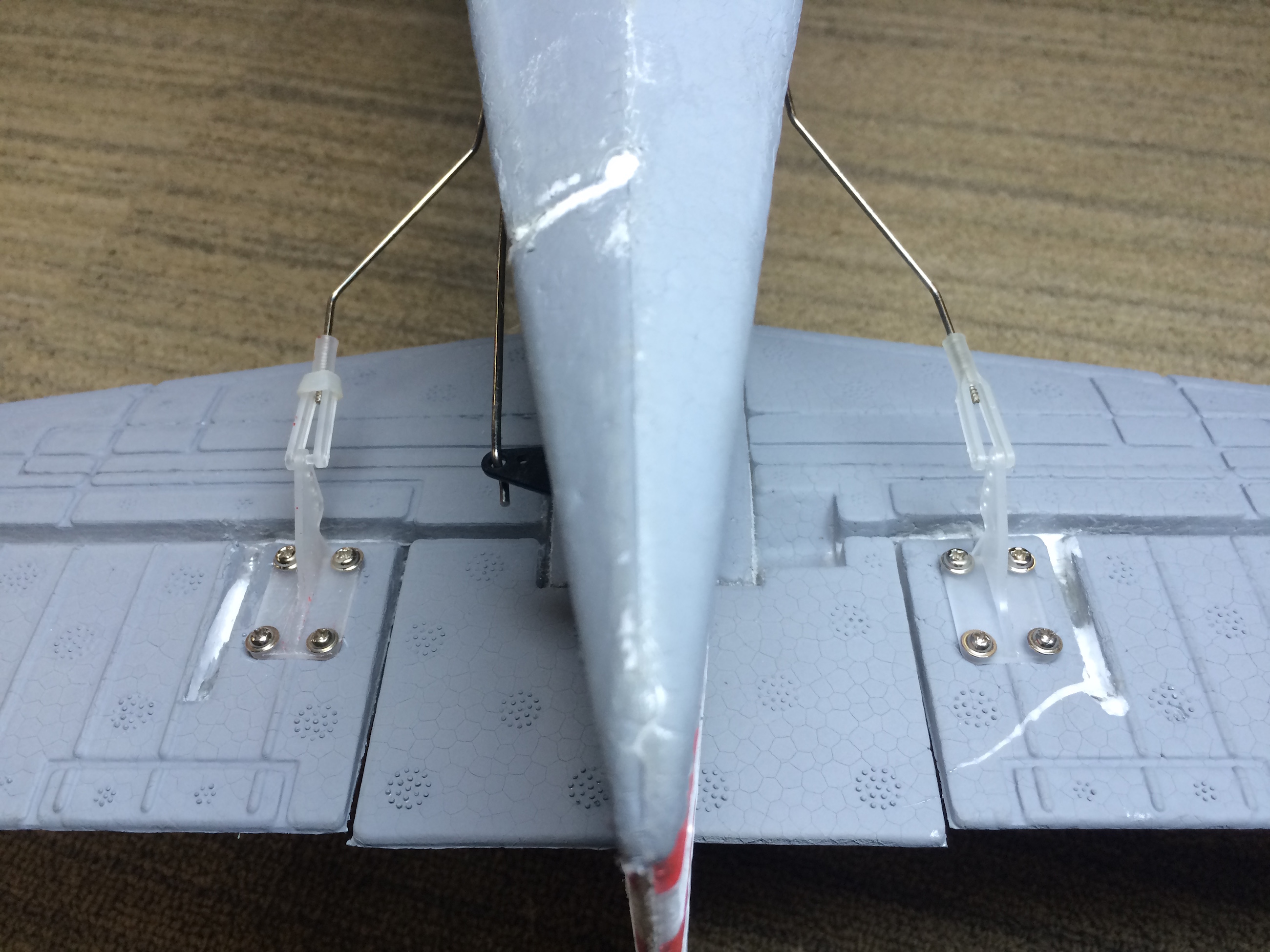

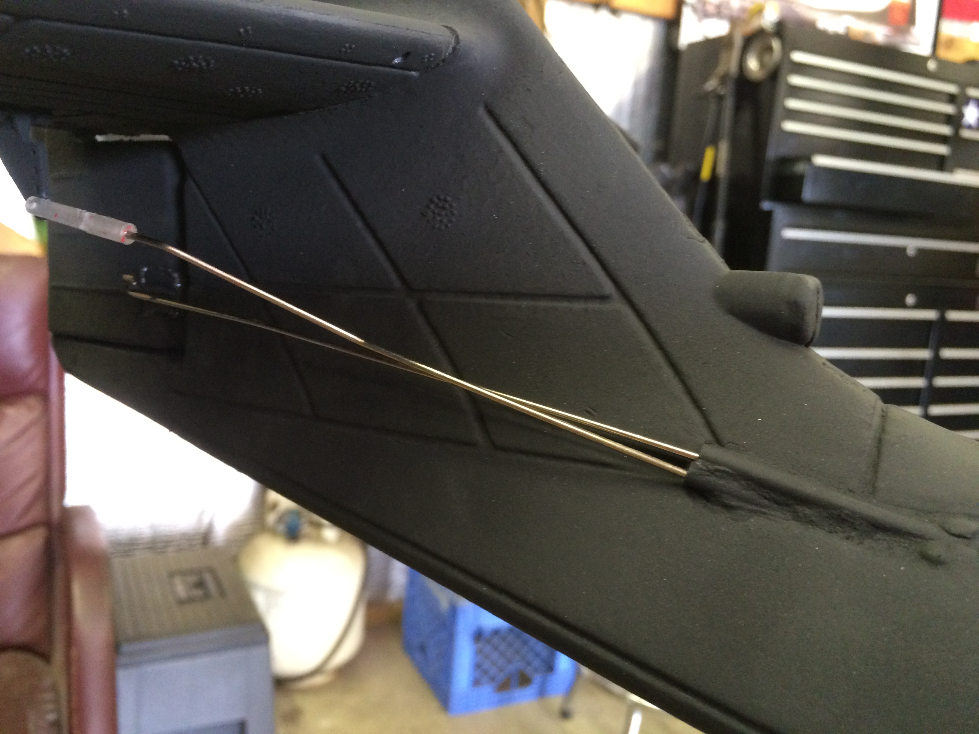

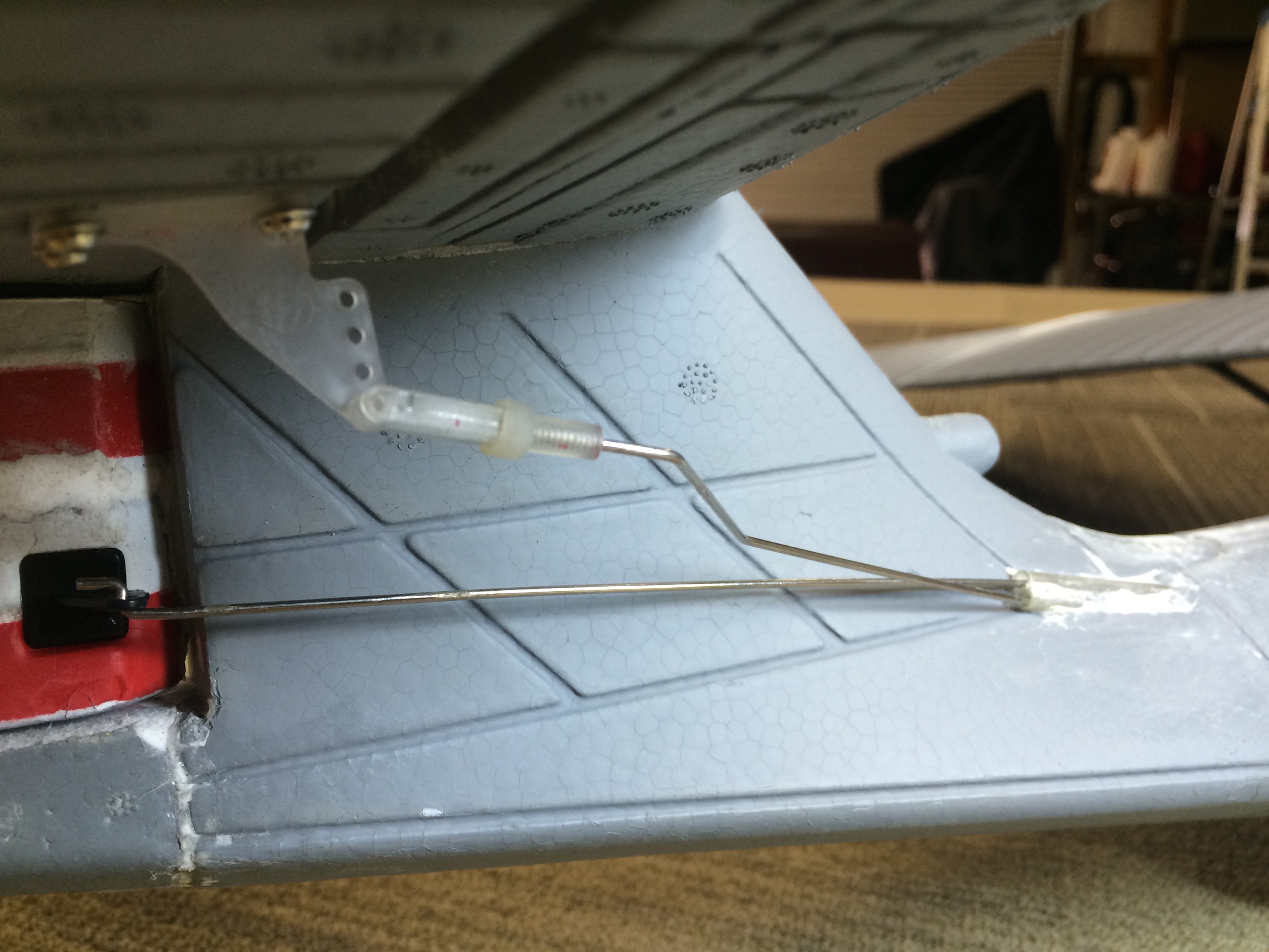

      I did away with the metal rods and single point control by adding another control rod and tube.

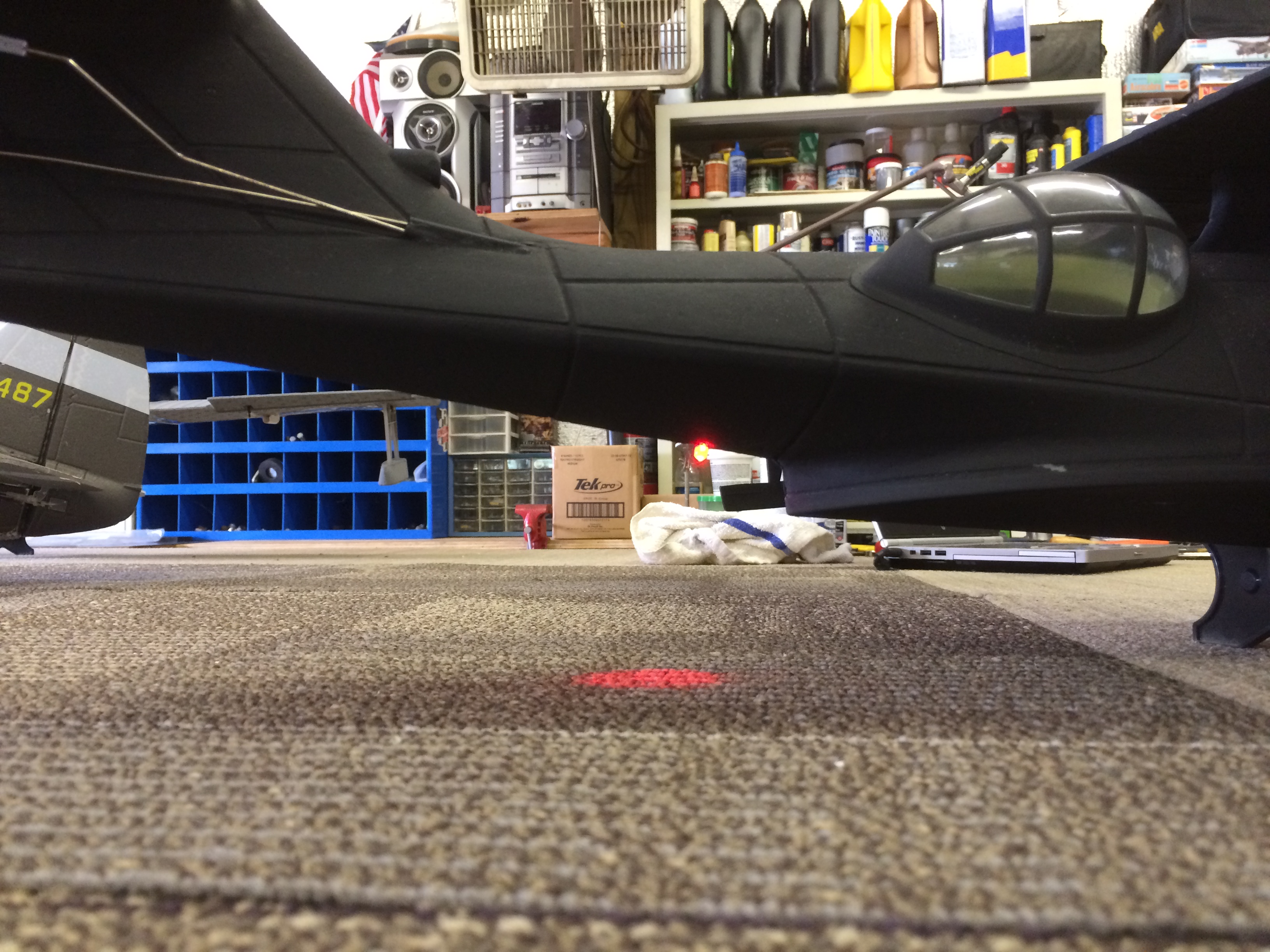

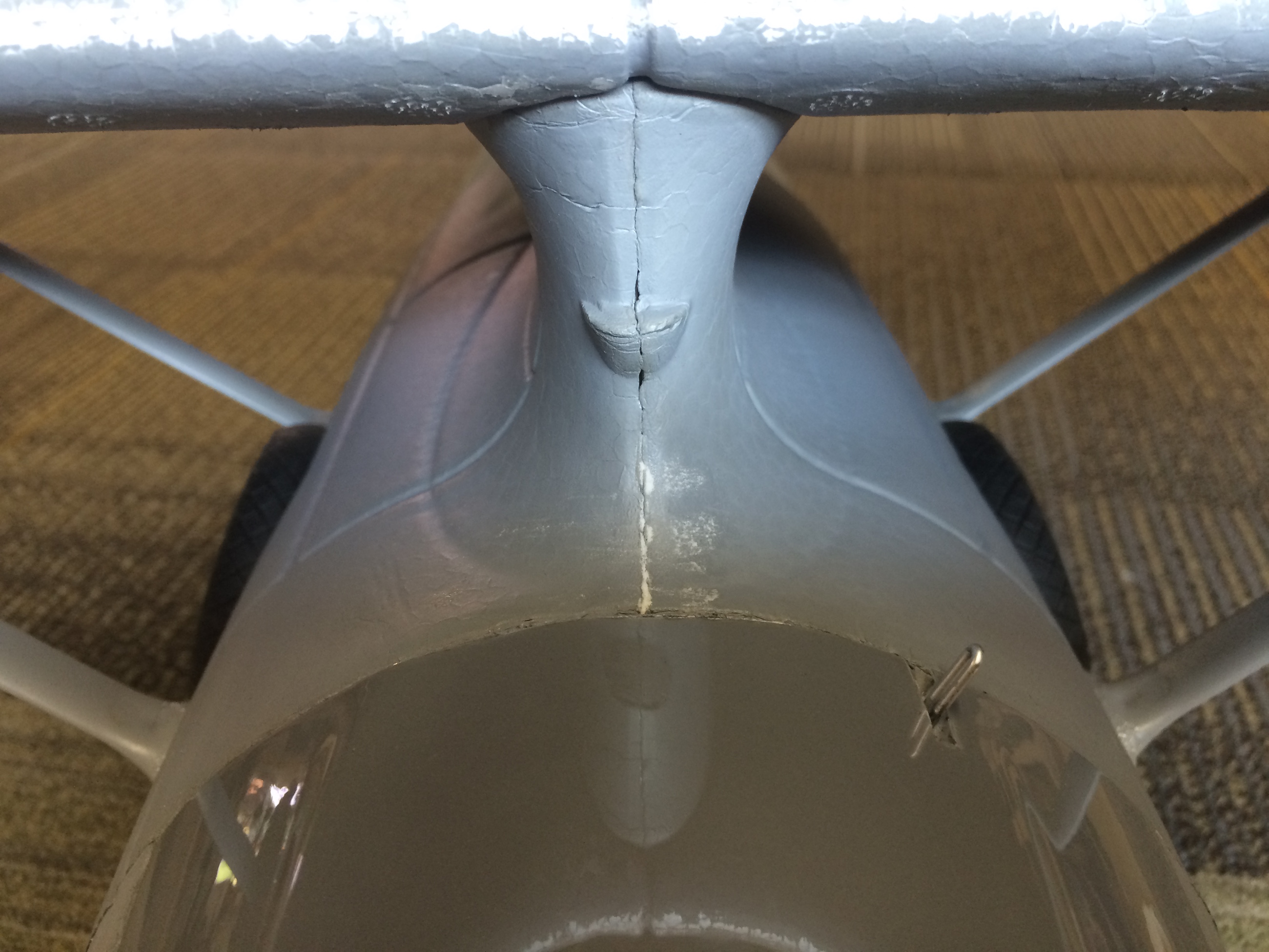

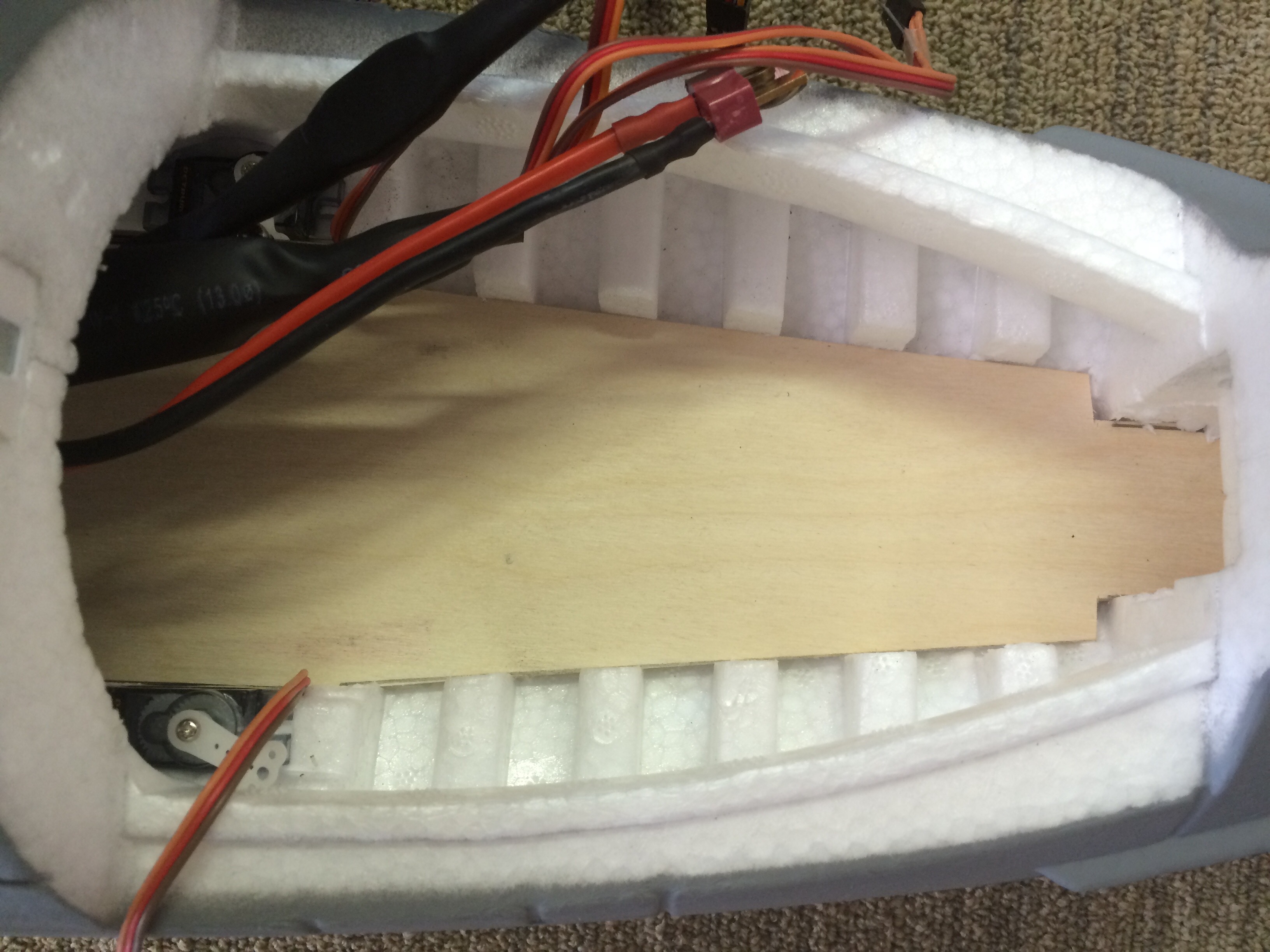

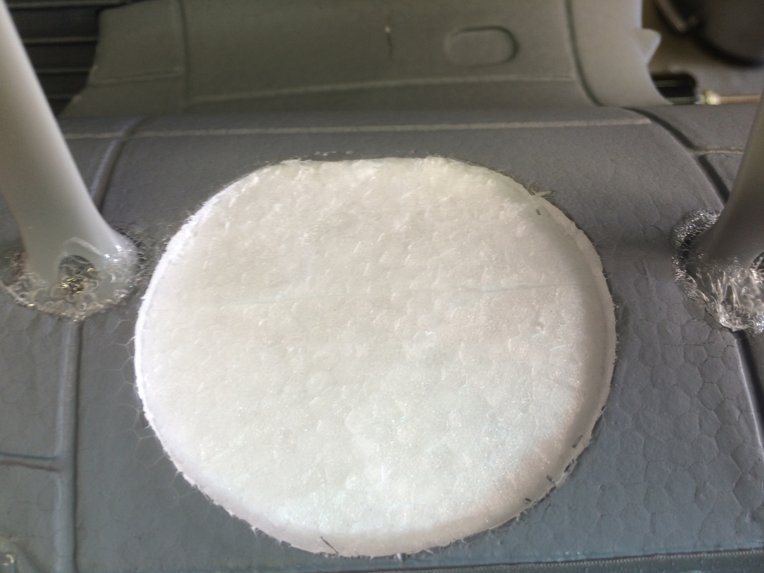

      After having crashed my other PBYs a few time I found that this area is a weak spot and will bend up and let the props hit the cockpit so I added 1/8" plywood from the nose to the mid-fuse rib.

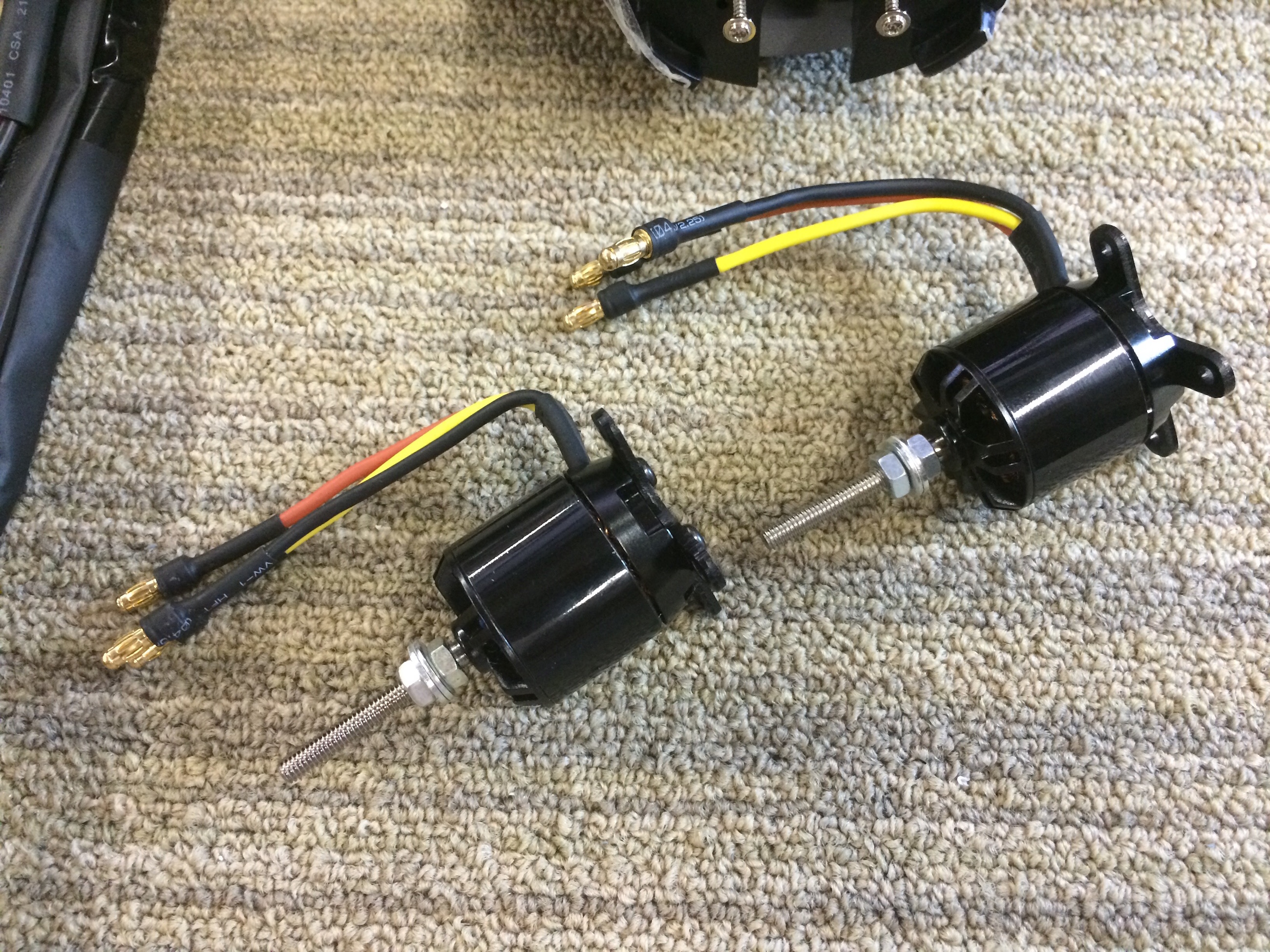

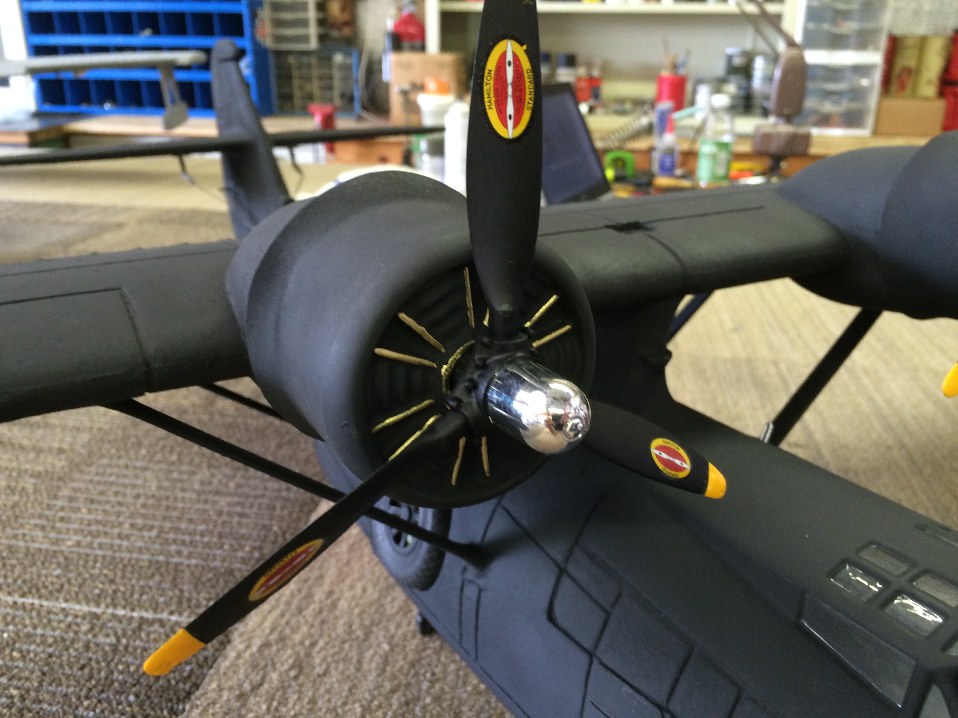

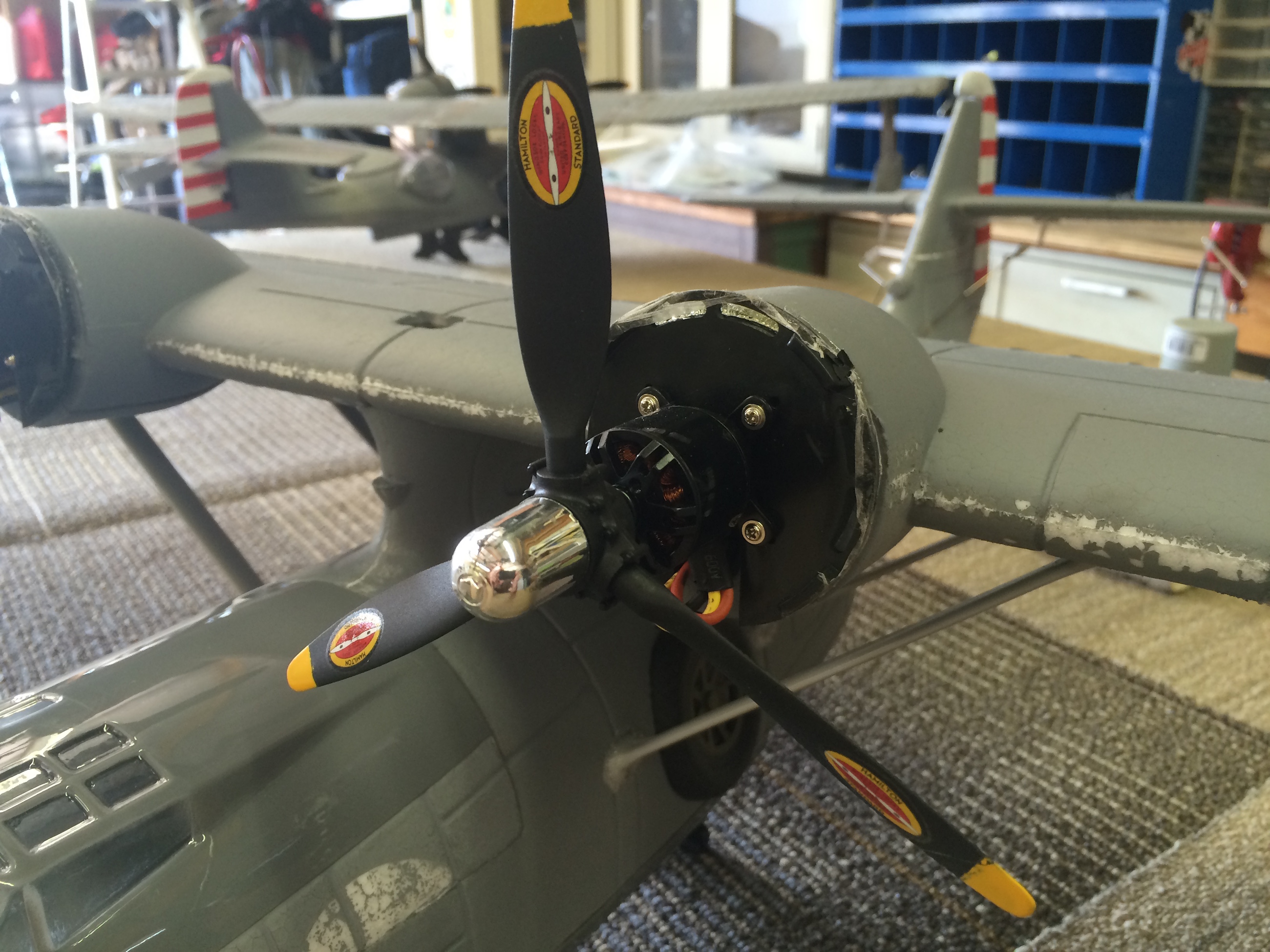

      I know the scale PBY didn't have counter rotating props but this one will, I used two 1250KV motors which have a 4mm shaft and different props.

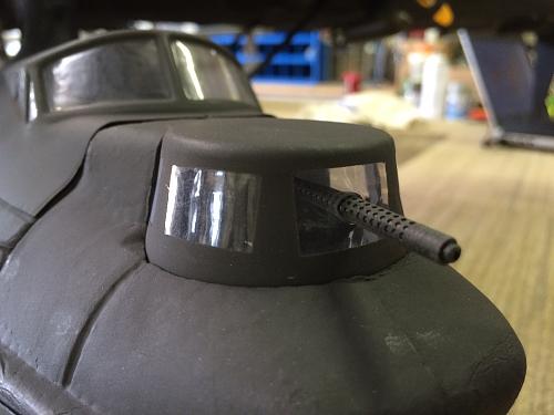

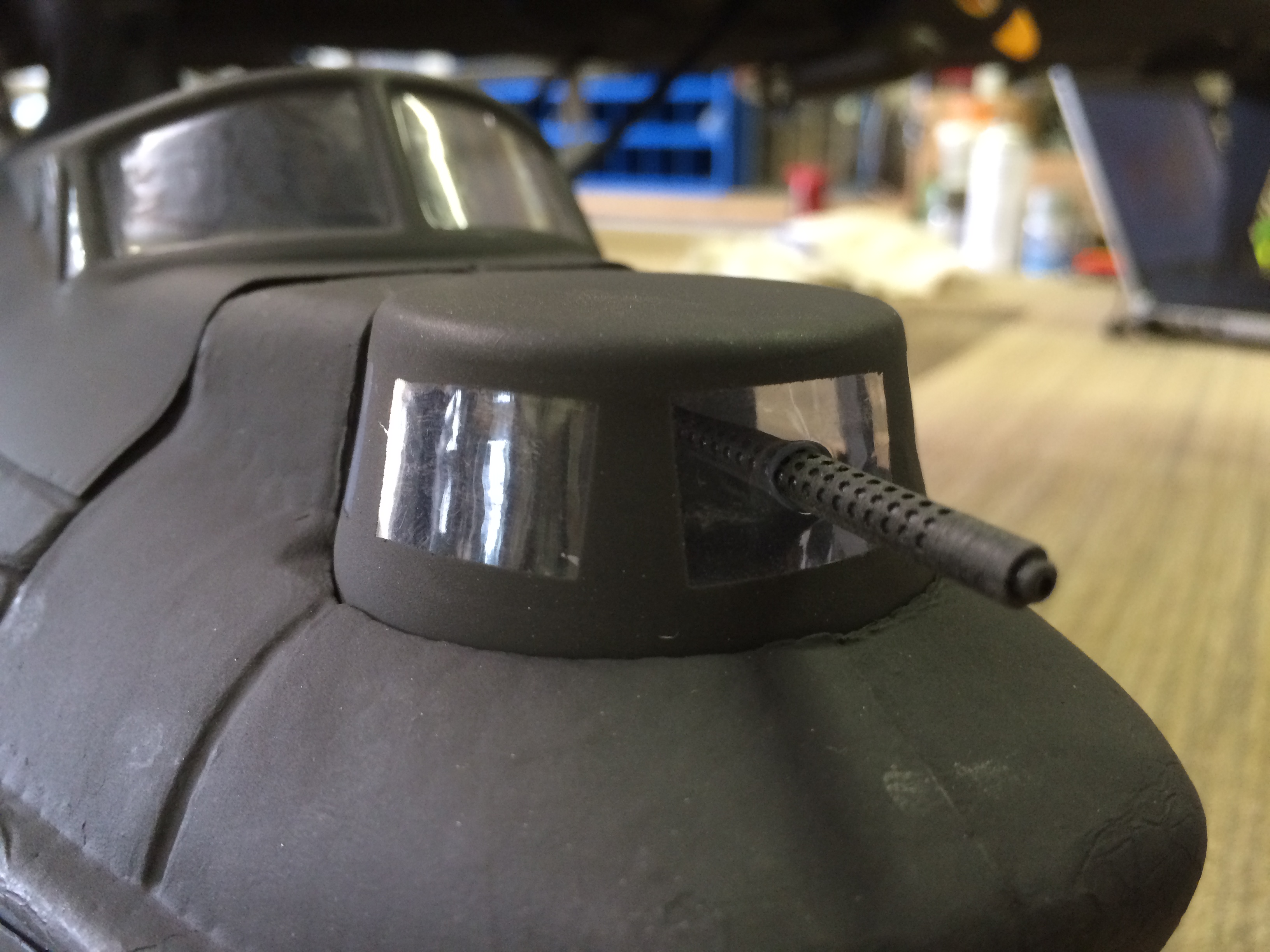

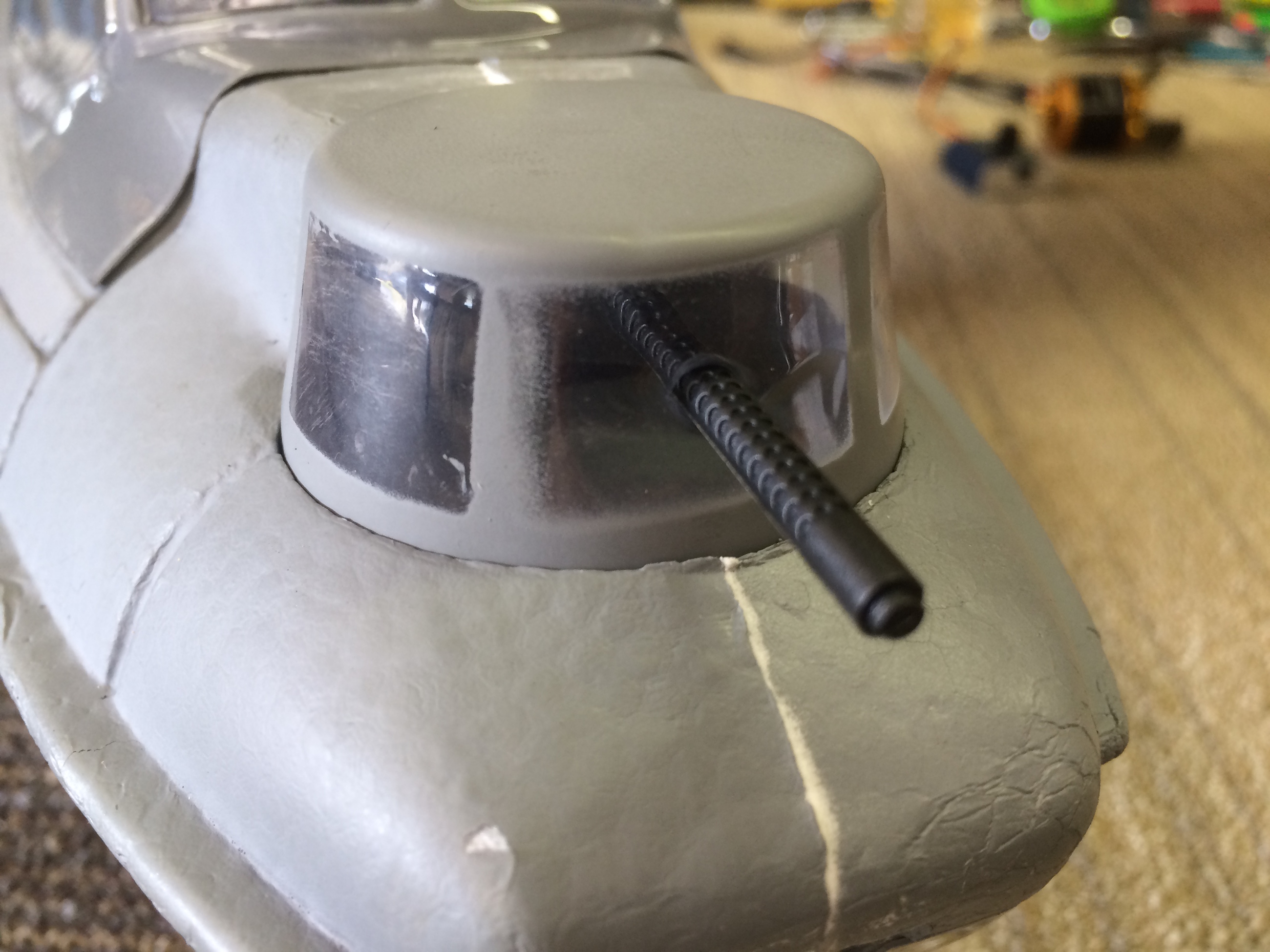

      A 50 cal for the turret.

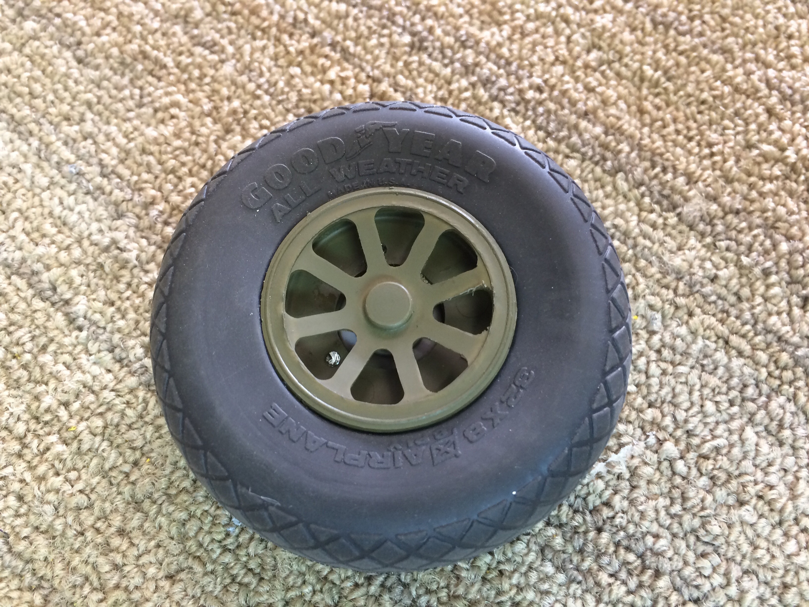

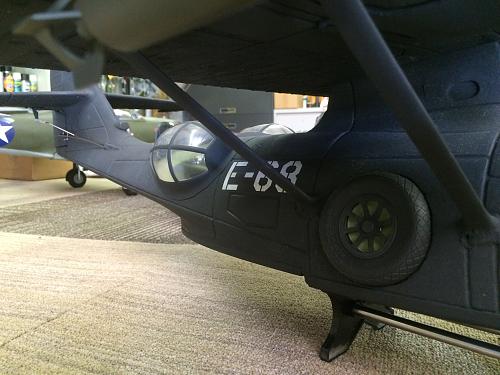

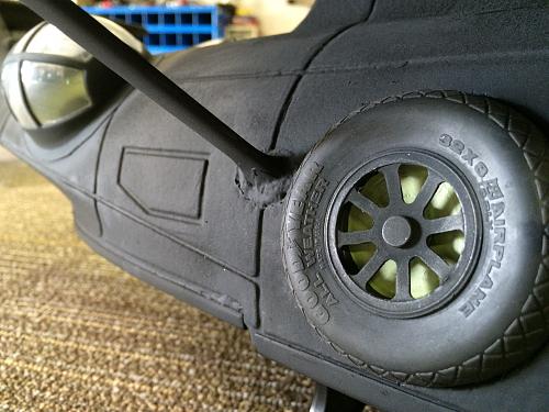

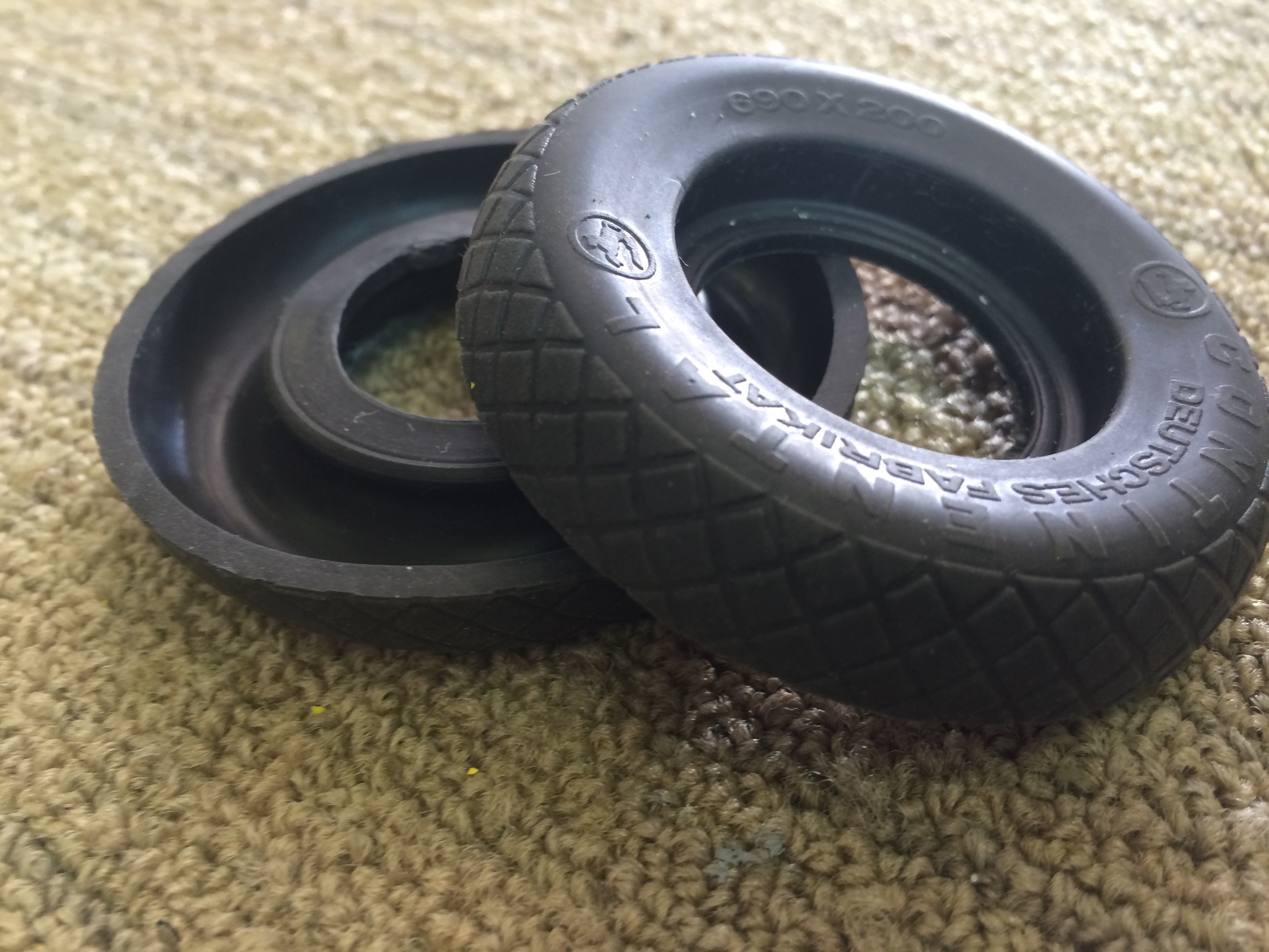

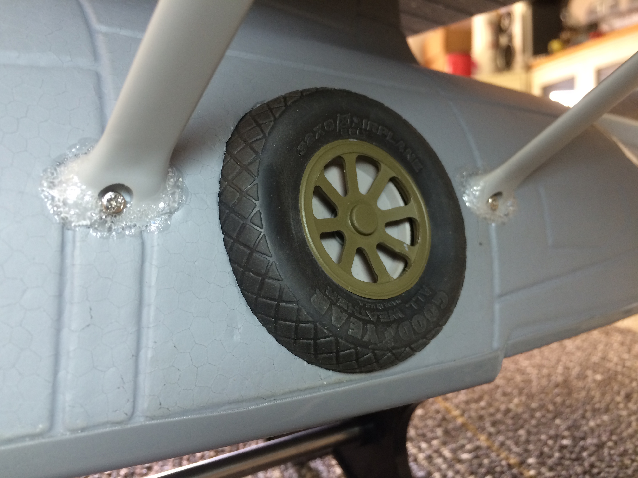

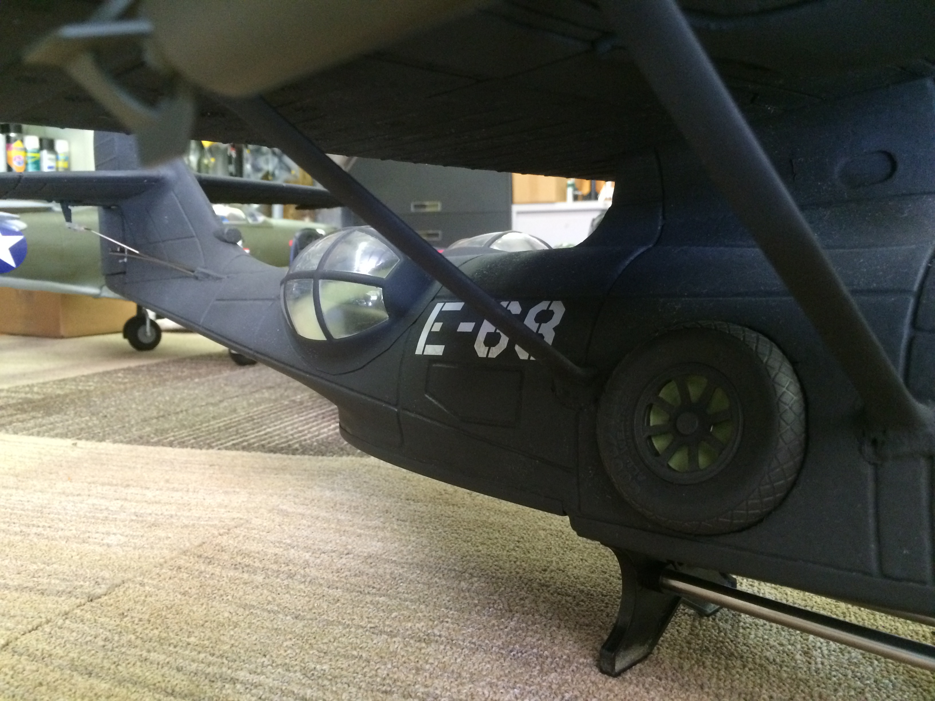

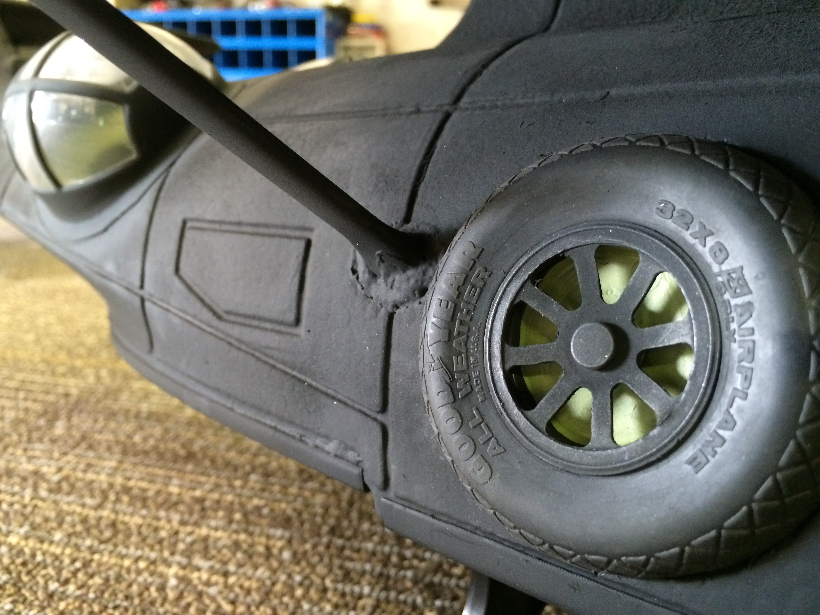

        I didn't like the wheels being decals so I used a Robart 2.5" tire and just cut it in half then cut a slight recess for each half to sit in. I used 1/8" plywood on the inside to secure the half to the fuse and to give it more support.
        Yes the wing supports are glued to the fuse and will be smoothed in before painting.

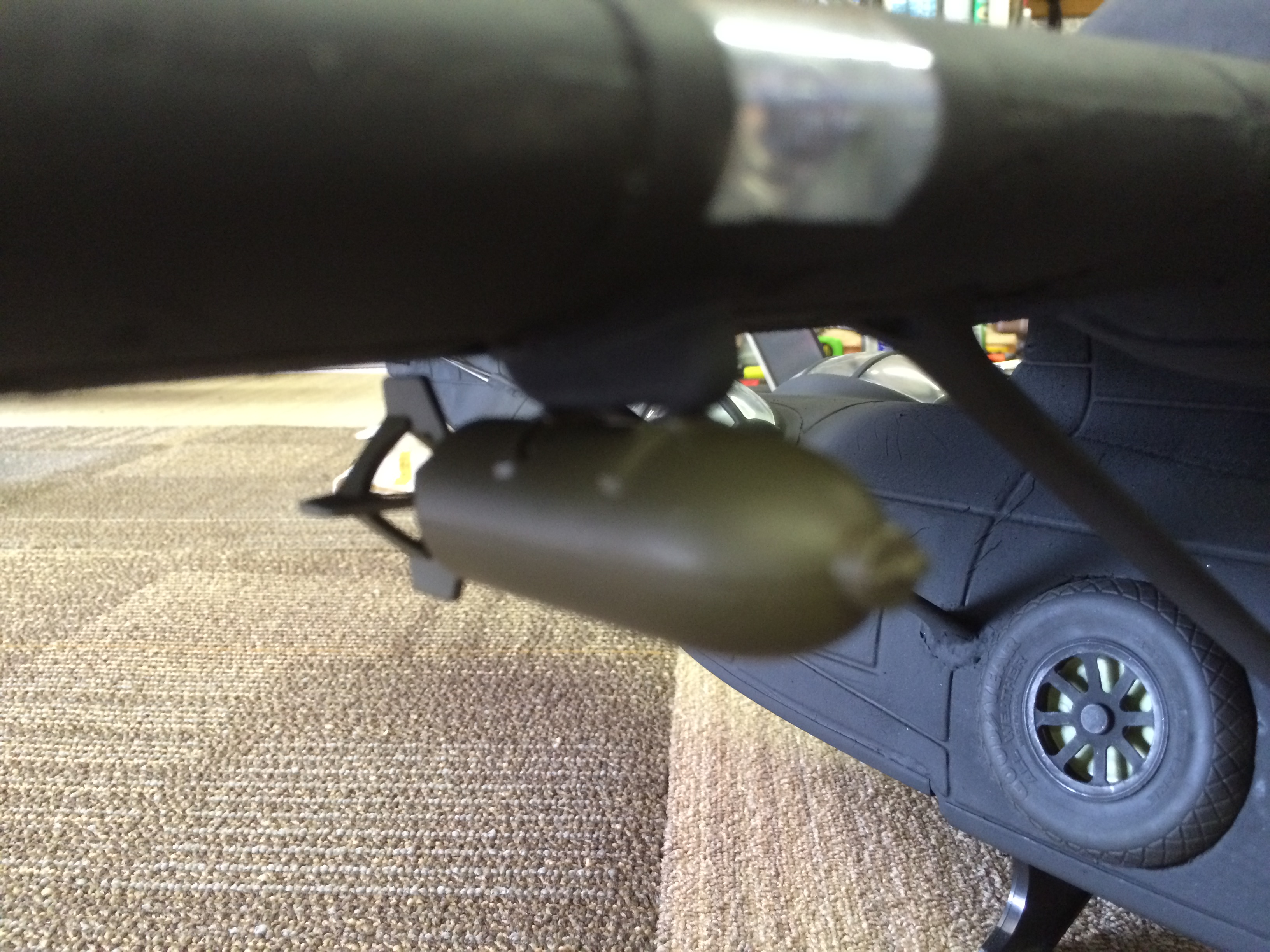

              Beautifully done! The graphics will really set it off. How did you attach the bombs? Are they releasable?
                The bombs and brackets came off a 1/18 scale 21st Century Old Crow P-51, I just glued the mount to the wing.

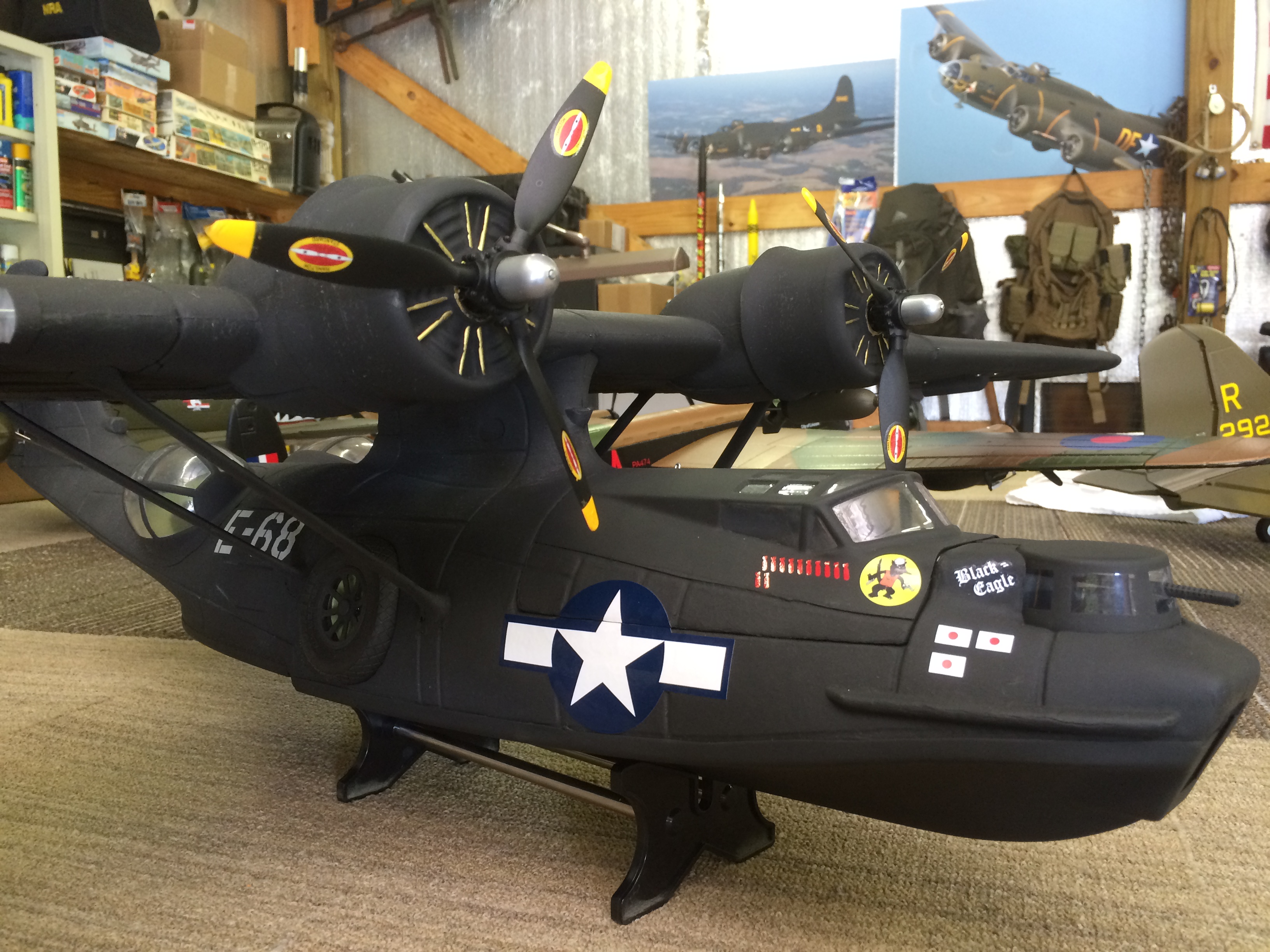

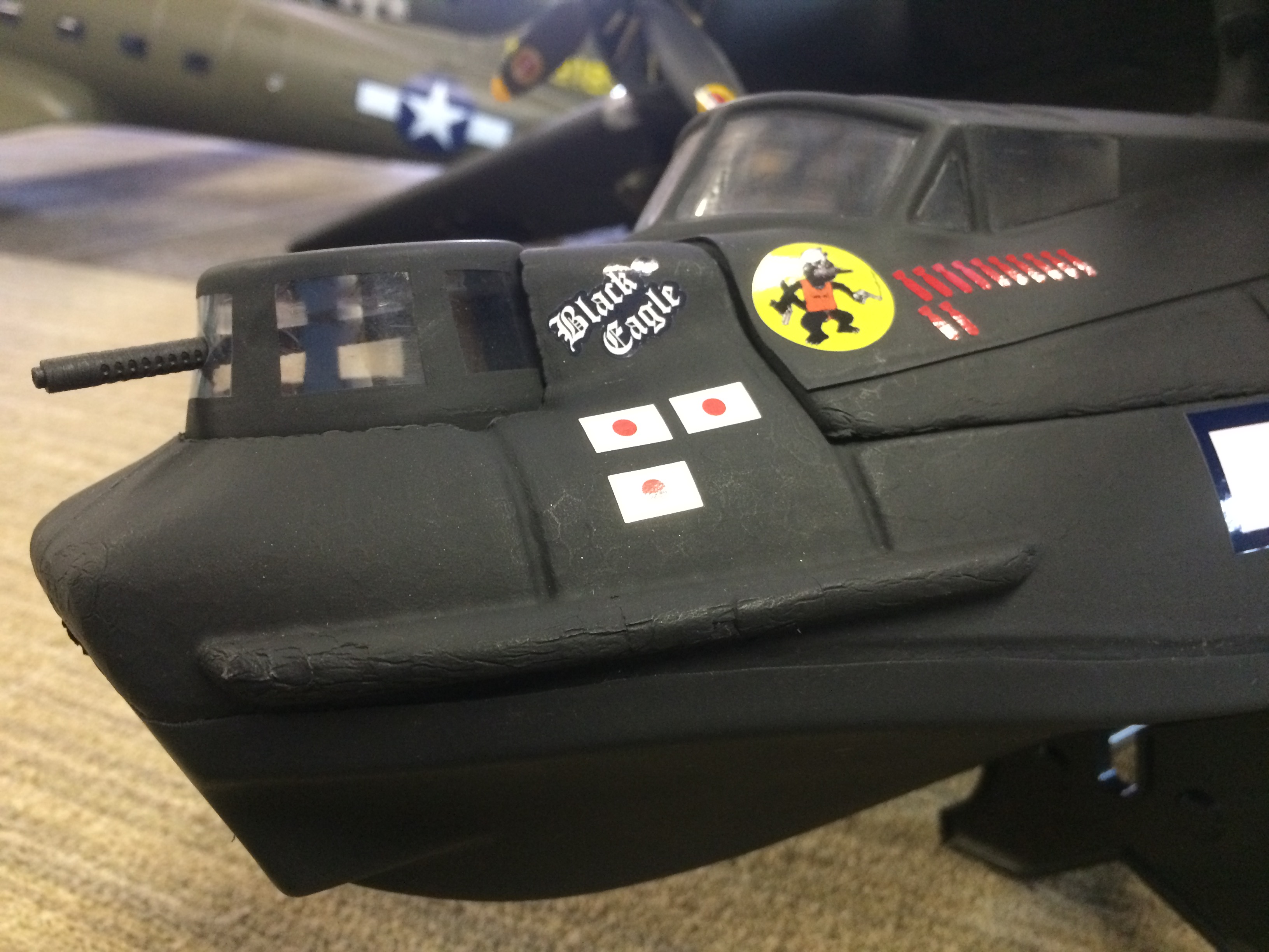

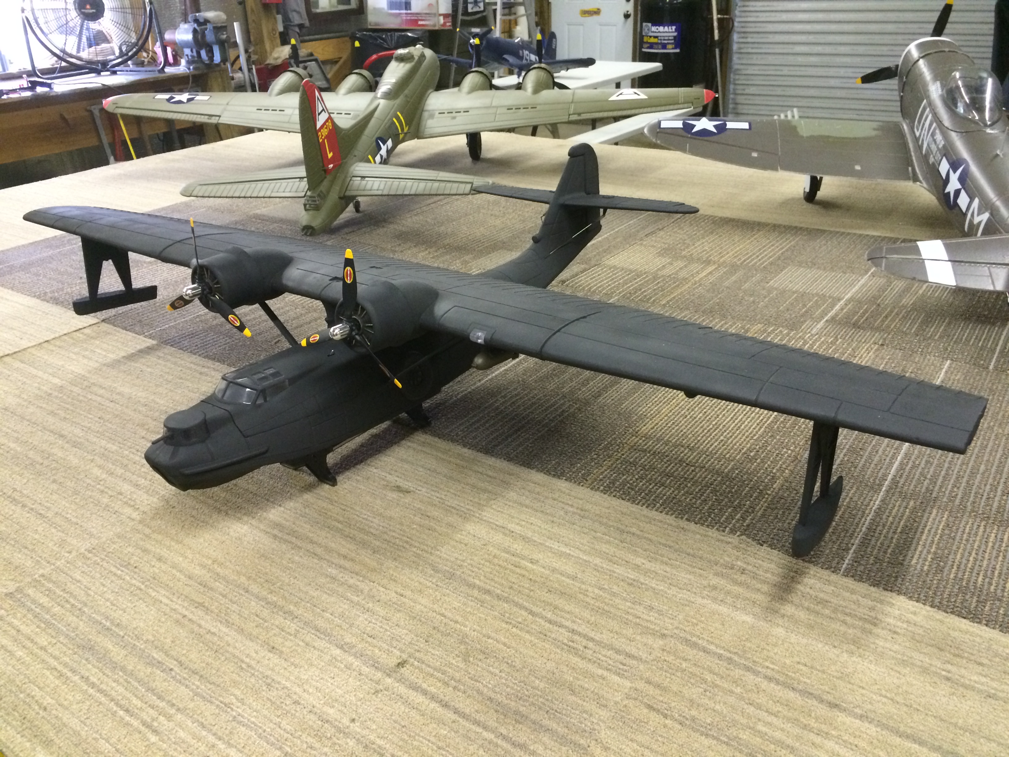

                    I got my Callie Graphics today and finished up the "Black Eagle".
                      • 2818
                      • Arlington, TX
                      Great job! It looks fantastic! Now all you need is a Japanese convoy to attack..
                      • Prowler901
                        • 940
                        • Gunnison, CO
                        That's just perfect! Will you be flying her from water?
                        • Dewey H Lee
                          WARBIRD JUNKIE
                          • Apr 2015
                          • 919
                          • Fayetteville NC. US
                          Now that's definitely a night hunter. Sneak up on them in the dark and bang. It's a beautiful build. My hats off to you as usual.
                          Dewey l
                            Yes, probably water only and early morning flights do to the black paint...I've got two other PBYs that I fly almost every day, matter of fact I just came in from burning three batteries through one of them.
                            Thanks guys for all the good comments.
