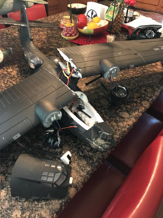

Hey TiredironGRB, have you had any indication on your PBY's of center wing issues, cracking etc.
I did my first flights on mine this Saturday. The first flight was fine. The second flight as I was pulling out of a shallow dive, the wing folded and snapped right in the middle.
I had assumed there was a center spar running down the inside in front of the pylon possibly. But the only thing there is the two little hold down plates with no indication of a spar running across the middle.
I'm bummed this thing just literally fell apart on the second flight.
Any idea? Did Dynam leave out the spar? I know I installed the long spars from the outer wings.
I would appreciate your opinion
Thanks
Scott1 PhotoComment
I don't think there is, I've never seen one do that...the wings struts may have come lose.Hey TiredironGRB, have you had any indication on your PBY's of center wing issues, cracking etc.
Thanks
ScottComment
Yes, they came loose,screws ripped right out of the plastic/rubber holes . I thought I had them glued on, but it must not have been enough. Im going to replace the broken stuff and put a center spar in the center portion of the wing. I think a groove cut down the center underneath and some epoxy and it shouldn't happen again.Comment
