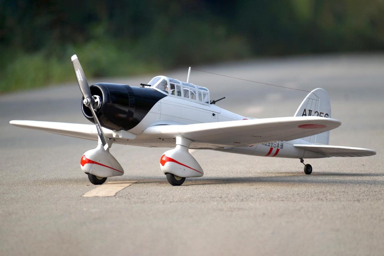

    Better late than never! :)
    FYI - the pics are not of the stock model. They’re of an example that someone has modded a bit. VQ seems to like doing that…
    It’s a nice-flying model and “something different”. Plus it’s a warbird without expensive retracts! Mine is flying with an E-Flite Power 52, using a 3-blade prop, on 5S 5000 packs. I dressed it up a bit, including a functional bomb drop.
    I’m not a fan of the vinyl covering (in general), but concede that the printed details is permits are nice. The wire used for the landing gear is soft; I’ve watch them bend while merely taxiing on the grass runway I fly from. On a rough landing they flex enough for the pants to punch holes in the wing. I’ve since made better replacements. It lacks the distinctive dive brakes of the full size, but I can’t really blame them. Done/installed wrong, they’d likely mess with flight characteristics.
    On a historical note: the markings on the tail, AII-256 makes this a model of a Pearl Harbour participant, based on the IJN Kaga (“A” = First Carrier Division, “II” = the second unit in the division. Akagi was the first unit, Kaga was second).

        Thanks! I still need to replace the Lewis gun for the rear gunner. The supplied one is crude and grossly oversized - looks big enough to fire 20mm rather than 7.62! And still considering dive brakes. Maybe removable, so I don’t have to fly with them.
