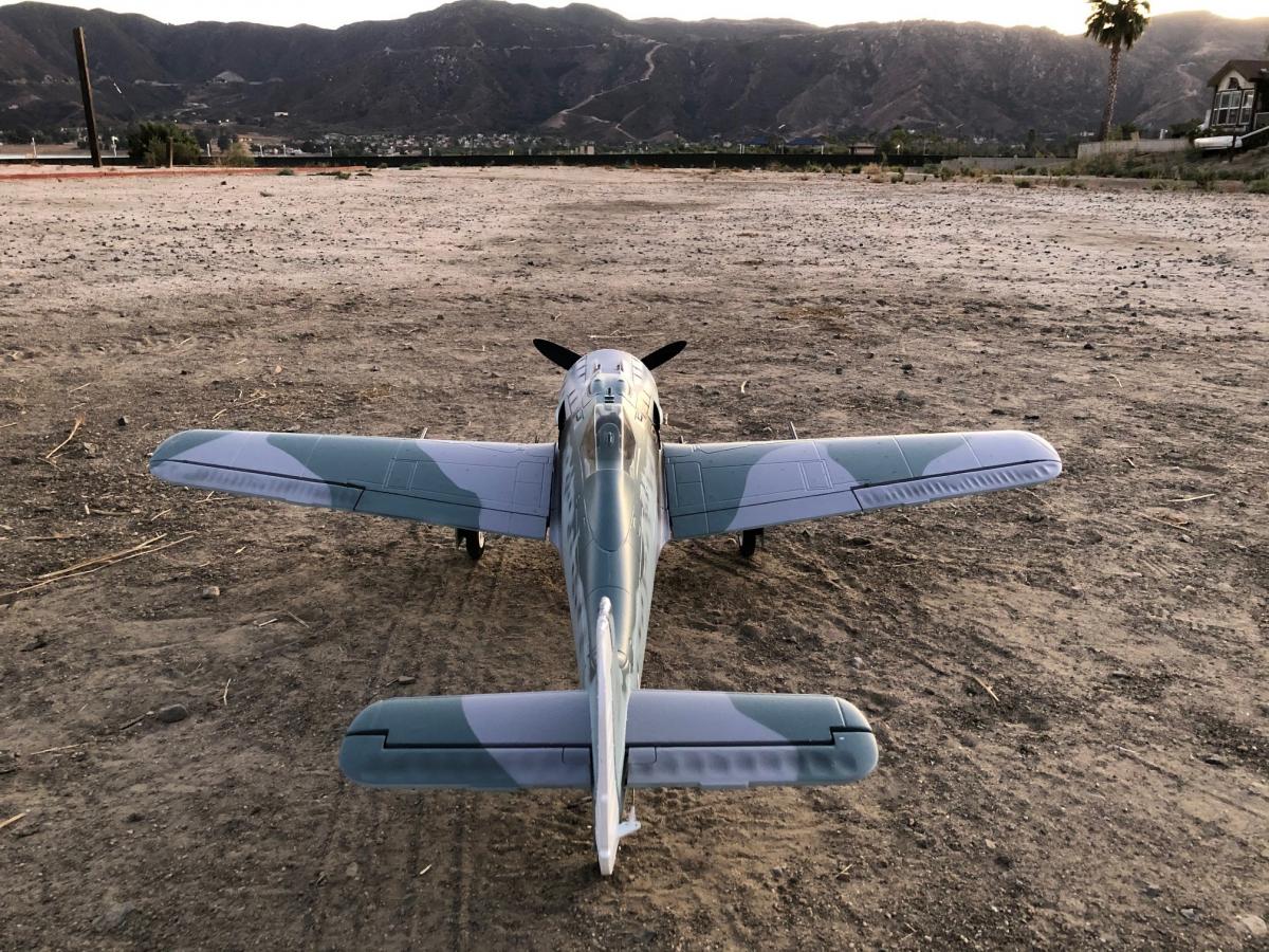

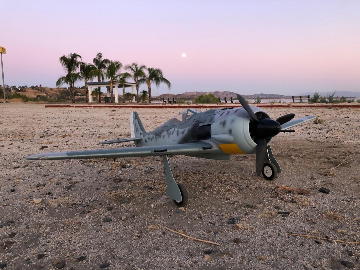

                            The Flightline Focke Wulf FW-190 1100mm is a sweet little ride! I set mine up box stock and am using 4S 2700mah packs. She is very nimble, very crisp, with a snappy roll rate. No elevator to flap mix is needed. You can drive it down with flaps and flare. I am flying off a rather unprepared surface and find it does well on short takeoffs and landings. With a few shake-down flights out of the way it's time to decal her up!

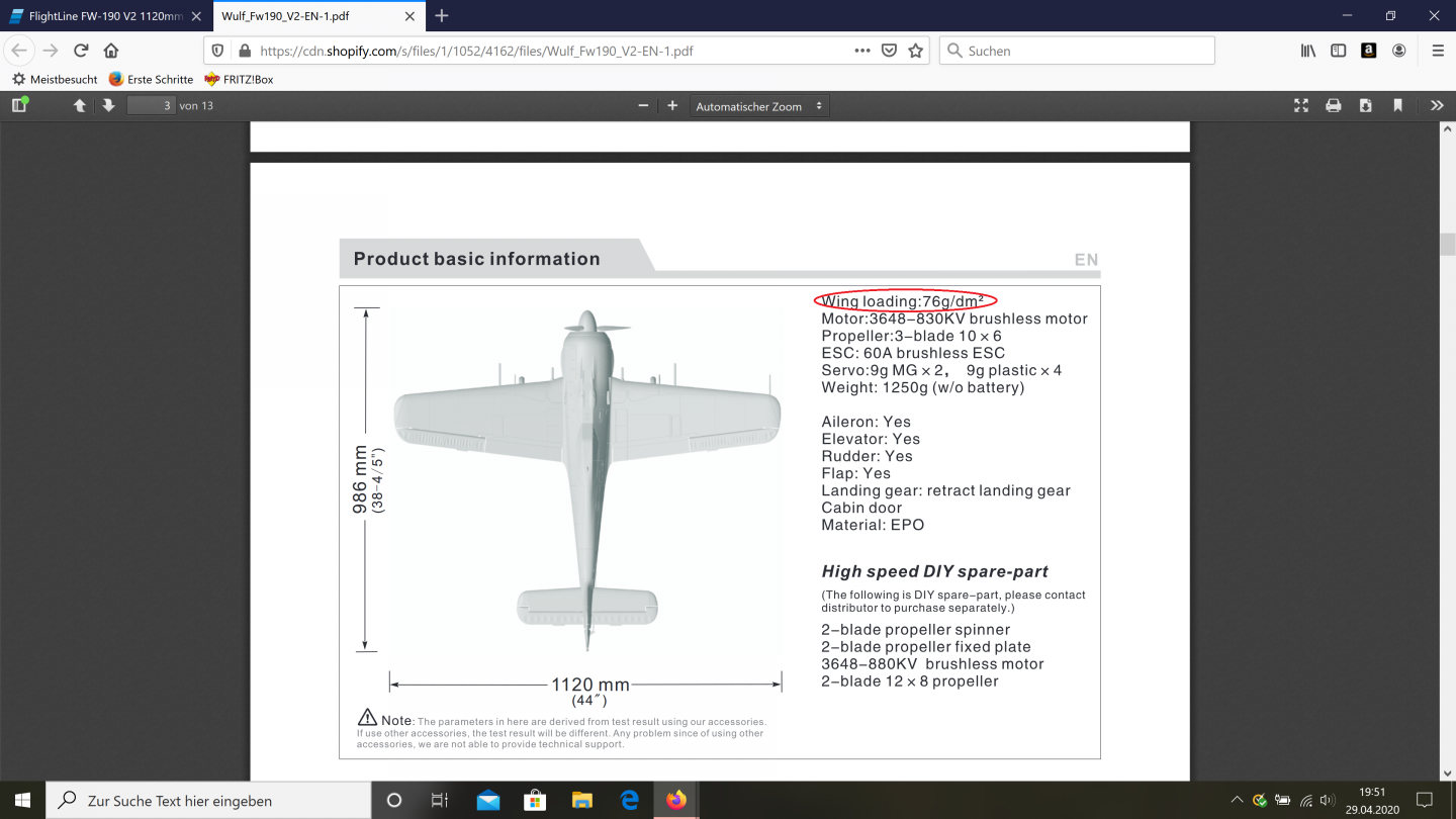

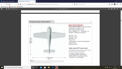

                              does someone know the wing area of the FW 190 I am trying to check the wing loading. Thanks
                              • Jets and Wings
                                • Oct 2019
                                • 103
                                • Aachen, Germany
                                #55
                                Hi bobtheman, the manual says about wing loading this:
