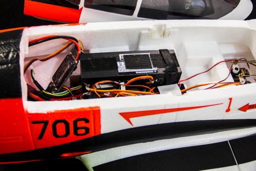

          Some pilots are having complete success with the battery placement as is. I however have never been lucky with standard battery placement. It was very difficult to fly in any kind of wind or if flaps were down. At times it was very pitchy. This happened on V-1, V-2 and V-3. So your not alone. Using a 3000ma - 3300ma battery.
          Cut the front foam square in front of the battery pocket flush. Add velcro to the bottom of the battery bay. Place the battery forward, the hind end of the battery should line up with the velcro strap. Any battery you use 3000ma to 5000ma will sit in that position. Yes thats a 5000ma hard case battery in the plane. You'll find it will fly perfect. This works on V1-V3.

                That is exactly what my Trojans did. That is a CG problem. You can fly with the landing gear down at full throttle straight and level if the CG is correct. The gear bay open has no impact on flight character. Set your elevator even and flush, cut the battery bay move the battery up front. It will be the best flyer. Trojan is the easiest plane to fly when set up correctly. I have over 100 hours on trojan, not 100 minutes, hours.
                I had to do the same on the Trojan V3 also. The picture of the plane is the V3 that we used in the Motion video with this setup. I logged just over 15hrs so far on this plane.

                                  #17
                                  Re: CG for 1400mm T-28
                                  I have a picture of battery placement a few posts back. Just line up the back of the battery with the velcro tie down. This is the exact balance point so no matter the battery size its right in that spot.
                                    Capt. Mike,
                                    You are right on the CG. With the 3600 battery far forward (after removing the little foam wall in the front of the battery cavity), she flew like a dream. Rock solid and guys at the field loved it with the fly by. Floated in on half flaps and 0 throttle, and landed on butterfly feet.
