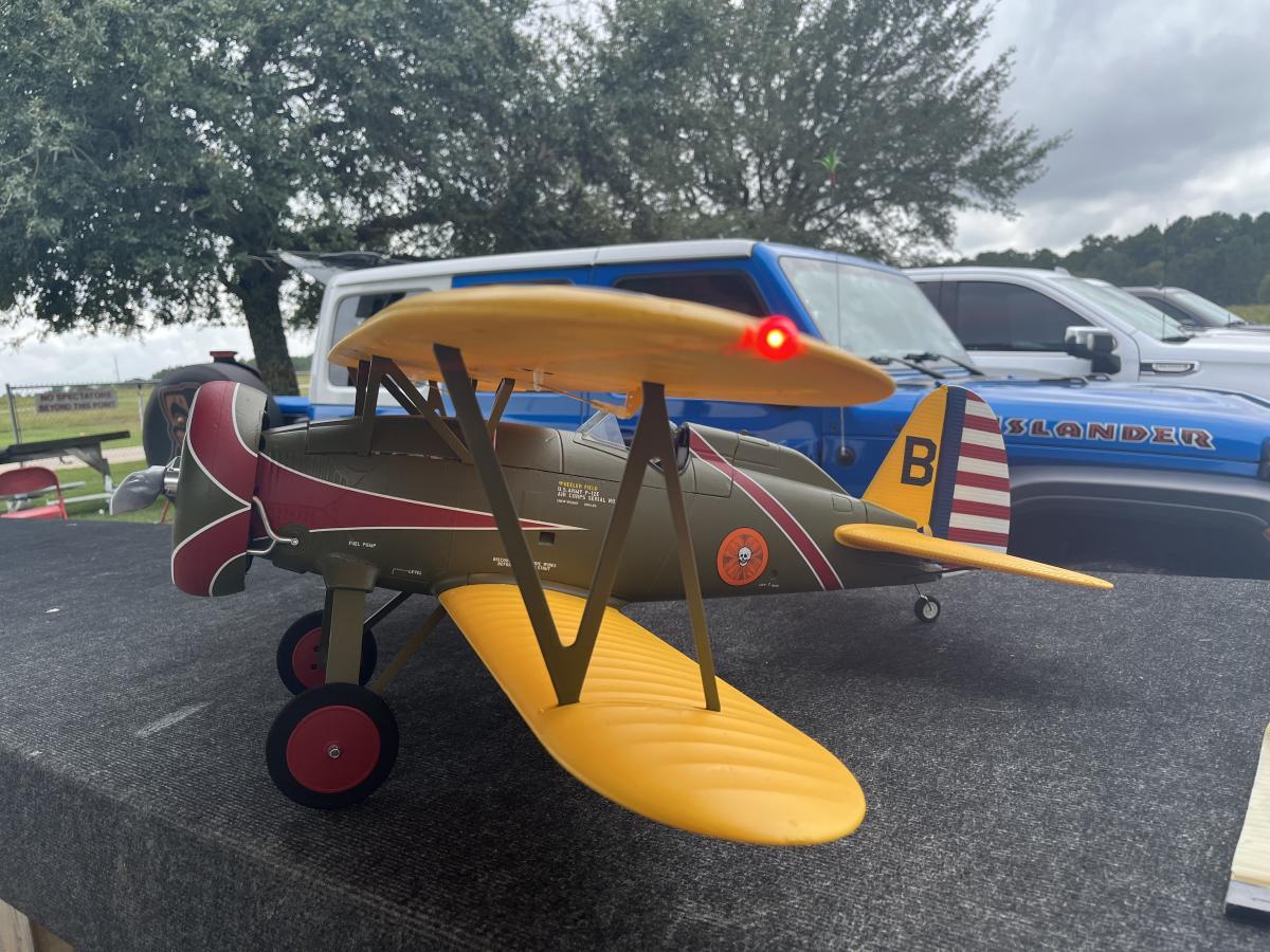

                      #50
                      Click image for larger version  Name:	IMG_8235.jpg Views:	0 Size:	179.0 KB ID:	453431
                      I had to have the P-12 the moment I saw it. A very attractive and rare “off the beaten path” RC model.
                      A very well done little model. Great colors and markings. Nice details. Easy to assemble.
                      I have had great flying experiences with this model. It is a delightful flyer. I used the suggested throws and CG with no issues.
                      Given that it is a small short coupled biplane, it does react fairly quickly to the controls. Still a great flyer for me.
                      After the first flight, I felt it could benefit from a little aileron differential to counteract the little bit of adverse yaw it exhibited, since I separated the ailerons and added differential electronically. This was worth doing. The model can also easily be flown without th the pilot coordinating the turns, if you so wish.
                      I had it at the annual BEST electric fly in in New Waverly, TX the first weekend of October. Lots of positive comments.

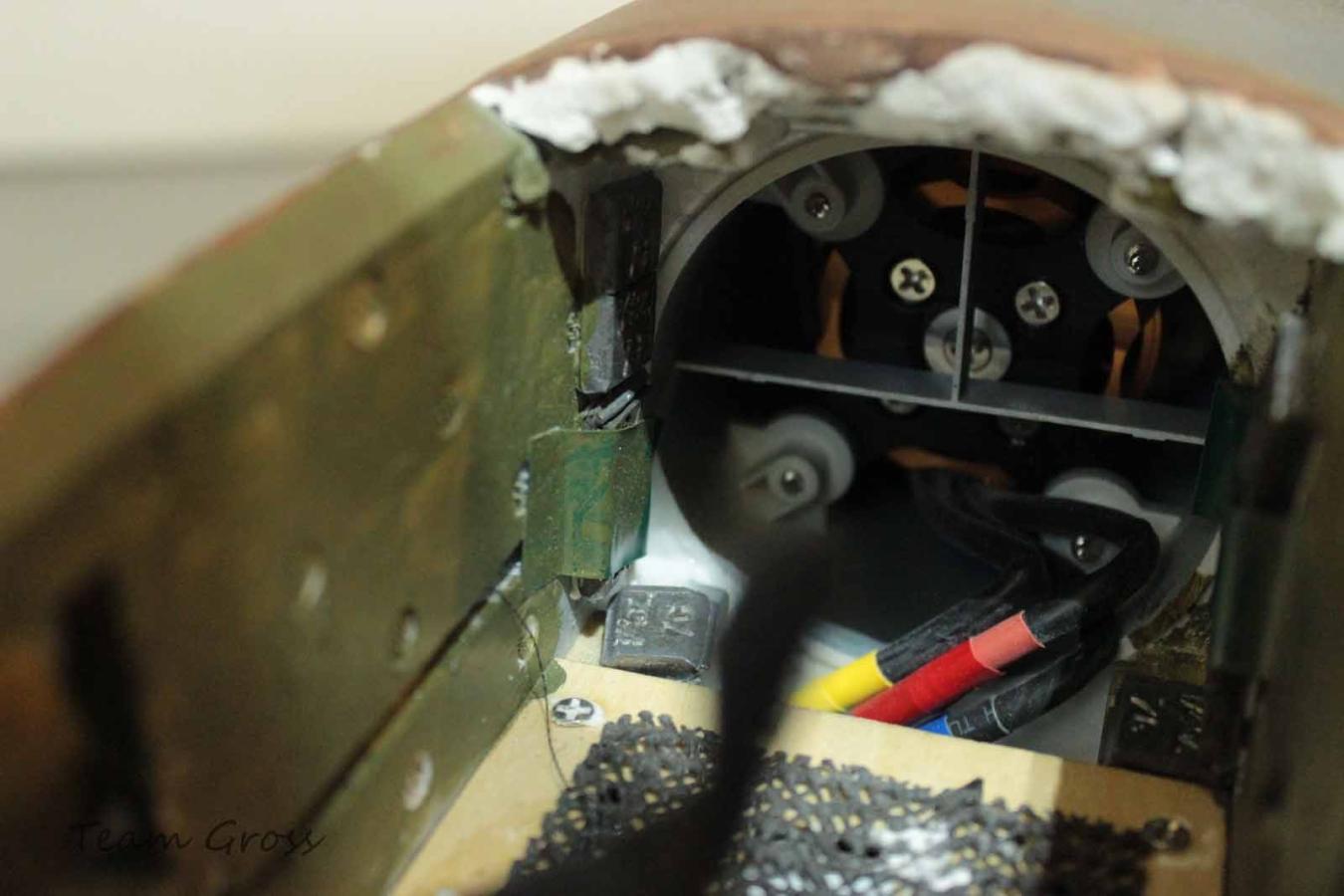

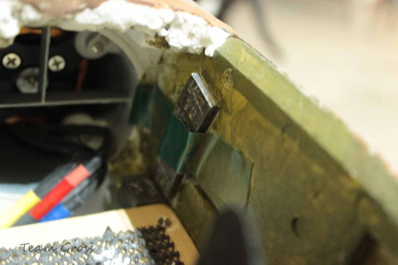

                          • 7418
                          #52
                          Wes has a good video regarding the CG, comments about the airplane on the MRC website seem to indicate a 1 oz nose weight. I had the same problem with my first 1600mm FL Spitfire. She ended up needing quite a bit of weight in the nose to tame her down
ID:	453476 Click image for larger version
                          Whereas my second Spitty was right on the money out of the box. This could be same the same case with the P 12. I know Dave has had nothing but trouble with his, yet some report it flying very well. Chris Wolf needs to chime in here.
