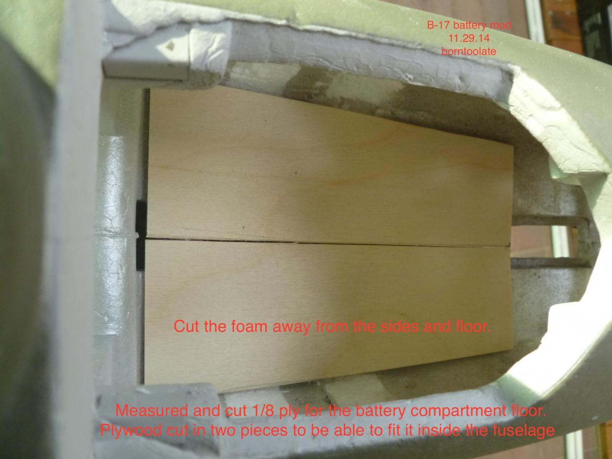

                                • #56
                                  Originally posted by fhhuber View Post
                                  Test with slowly increasing weight to see if the model's performance is still satisfactory to you. (and to make any CG change occur more slowly)
                                  The way the performance changes with weight may be just fine for one person but unacceptable for someone else.
                                  For me, the limit is usually how large of a battery I can squeeze in (often with some foam carving to make more room and get the battery to the correct place for CG)
                                  Agreed. I modified the battery bay floor on all 4 of my B-17s. I cut the foam out and replaced the floor with 1/8" plywood, then covered that with velcro. It allows me to move the various batteries forward or aft to attain the best CG.
                                  Bob
