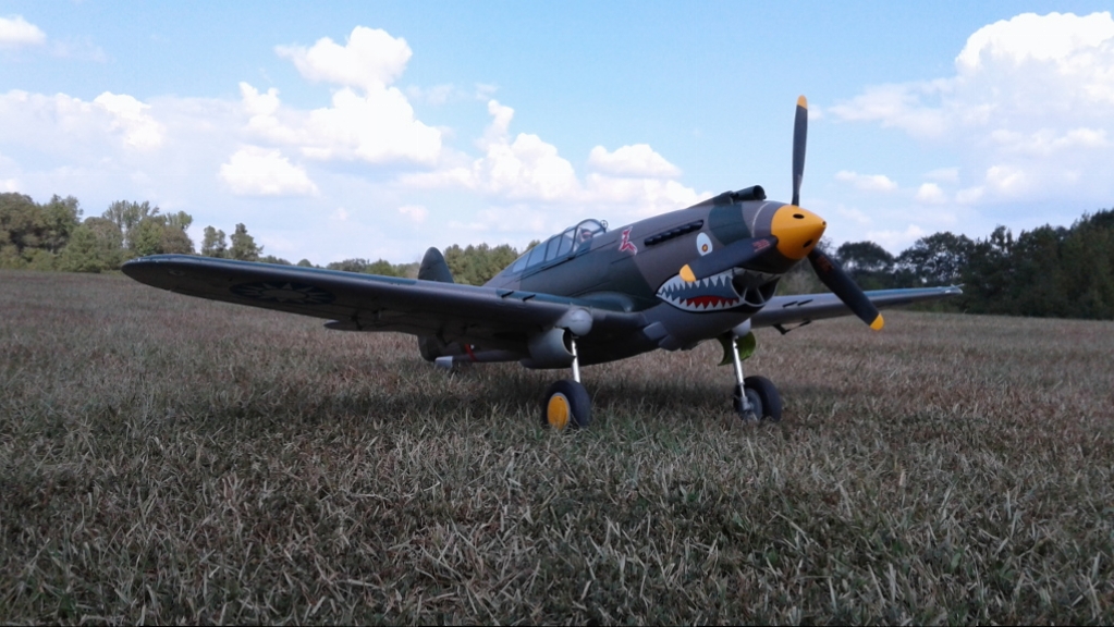

              My SECOND front retract unit is now folding on even the easiest landings. Actually I cannot takeoff because it folds on takeoff too. Talked to Wayne at Motion and he didn't think there was a problem with them. This retract is a problem part. I don't think I will be buying another one. Going to re-think what I fly now.
              The attached picture is the grass at the field today which caused my nose gear to fold. It's pretty short.
