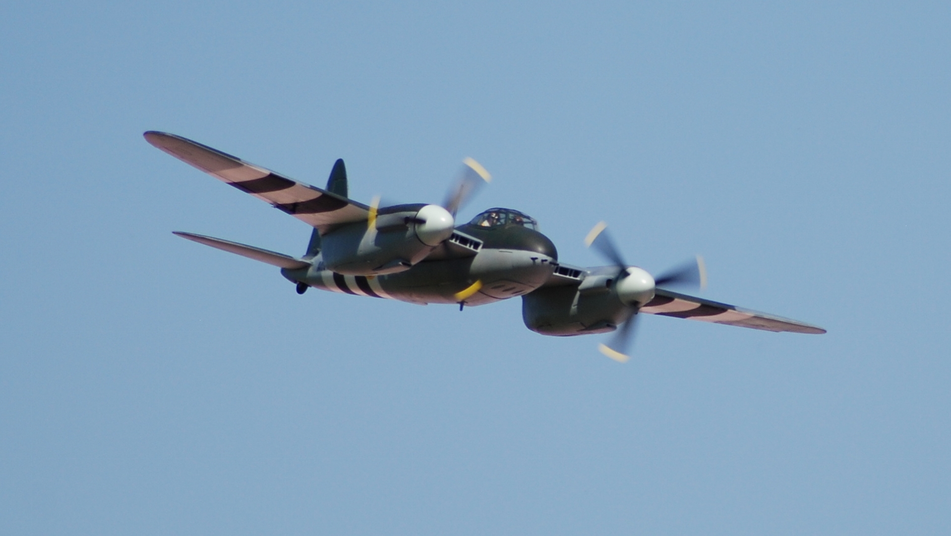

Flight Characteristics
I balanced the model gear up at the forward CG mark. In the manual, there are 2 CGs called out, one for "test flying" and one for "normal flying". I highly recommend the forward "test" CG. The model handles excellent there. The plane flies like a huge balsa model overall in terms of stability. It is very locked in and was unfazed flying in a gusting crosswind. Takeoffs are a piece of cake with the counter rotating props, and it has more than enough power. I generally fly at below 50% throttle. It can slow down to hardly and airspeed and maintains excellent stability and authority. Also, believe the suggested throws in the manual!! It hardly take any throw from the elevator the pitch the model. I had extra elevator throw on my maiden flight and it was quite scary. Flight times are an impressive 8 minutes of scale flying with aerobatics, and landings are as easy as can be.
