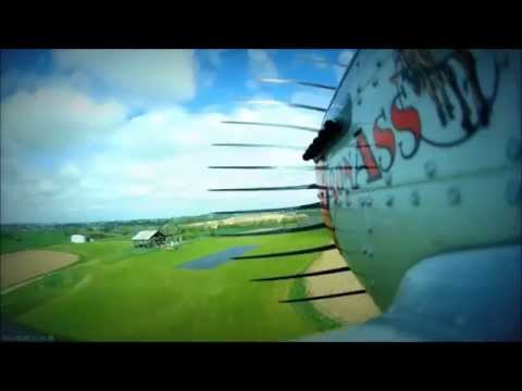

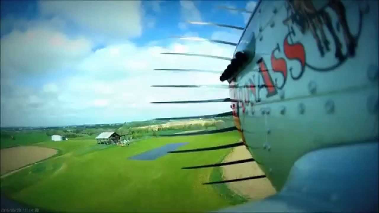

I have the original 580 motor and have done the ziptie prop mod for a little more pitch. I have well over a hundred 5s flights with this setup. I still fly 4s on it too. It makes a significant difference. When flying with the 4s, I find myself wanting to run full throttle most the time to get the performance i like with this plane. For me, it's so much more solid in handling at that higher speed, specially in the turns.
Torque roll on the take offs? Oh yes!! You have to be on your toes even more with the 5s during take offs. Be ALOT more delicate on the throttle, ease into it allowing the tail to come up, and slowly add more throttle and then up elevator and ready to be giving that right rudder. What i tell myself "Scale take-off" to help me from trying to do a short power take off. Attached is a video that will give you an idea of how a typical flights is for me with her.P-51D 1410mm Freewing "Iron Ass" 5s with 85a ESC. Prop Mod. One few seconds of full throttle pass at about the 4min time. I'm not a need for speed flyer. But...Lon
