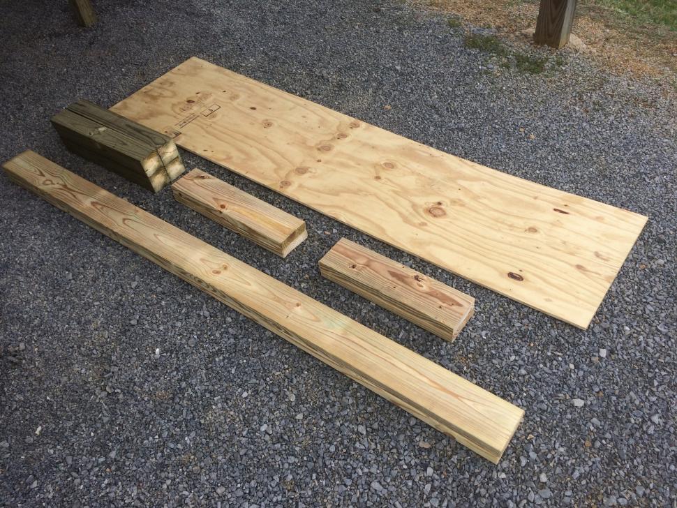

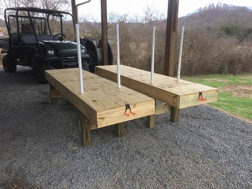

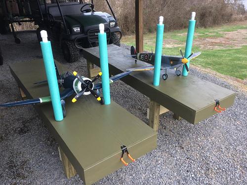

            #25

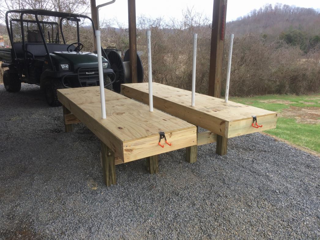

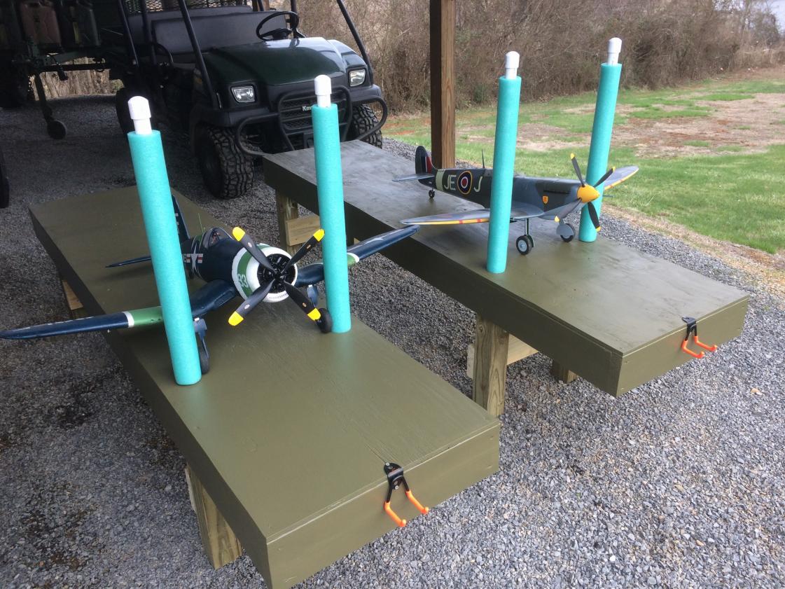

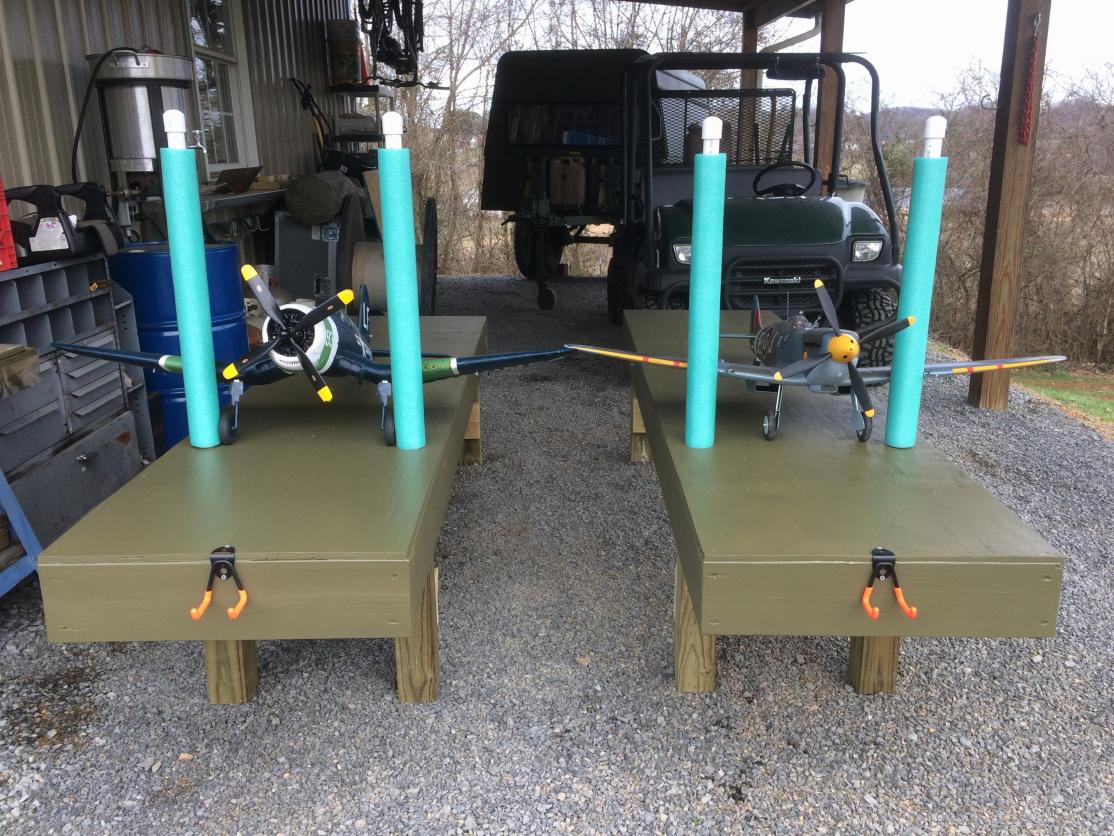

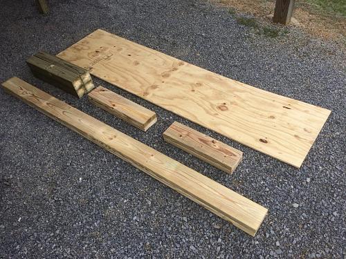

            Two plane benchs 8' X 2'
            1 - 4' X 8' X 1/2" Treated Plywood
            2 - 4" x 4" X 8' Treated Posts
            6 - 2" x 6" X 8' Treated Boards
            64 - 3-1/2" Coated Screws
            32 - 1-5/8" Coated Screws
            1 - 10" 3/4" PVC Pipe
            2 - 3/4" PVC Pipe Caps
            Cut the plywood in half,
            Cut four 2X6 at 93-1/4"
            Cut four 2X6 at 24"
            Cut four 2X6 at 24"
            Cut eight 4X4 at 24"

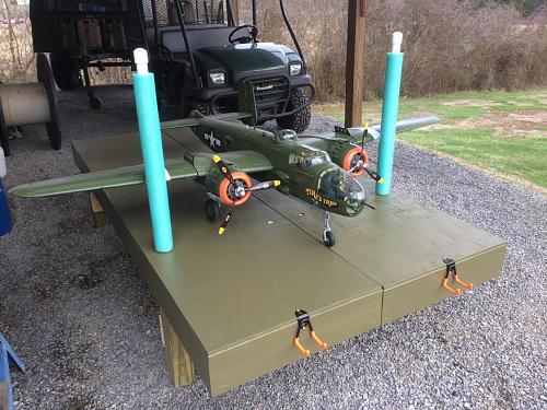

            Cut four PVC sections at 24"
            Front legs are centered 24" from front edge.
            Holes for the PVC are 1" drilled 4" deep 24" from the front edge and 3" from side which puts it in the center of the 4X4 post.
            Total cost was $80 (not including radio hangers).

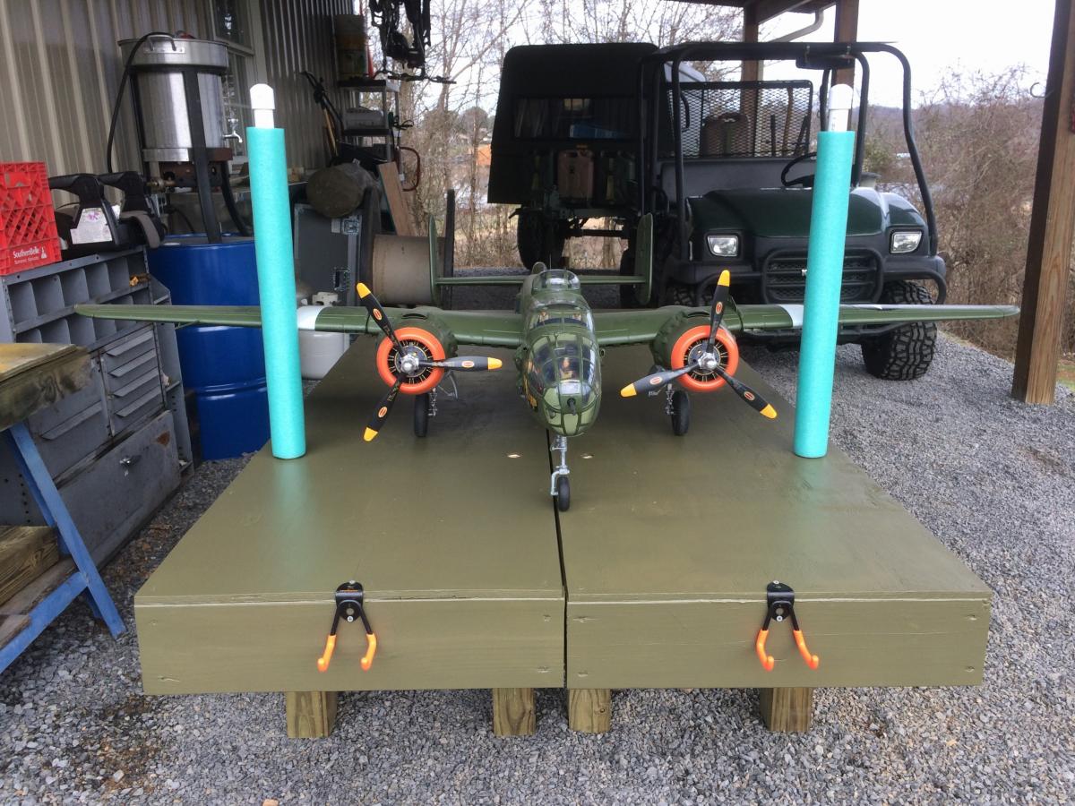

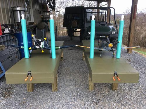

                        #31

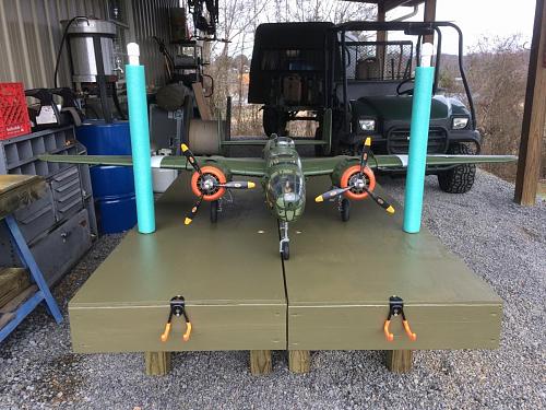

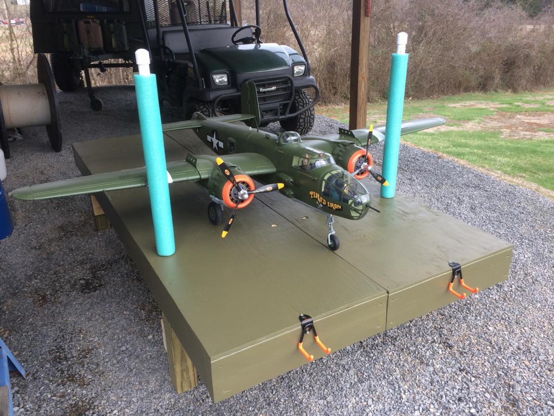

                        One last feature...I made one post on each table removable so you can scoot them together for one large scale table or put them them back for two normal size planes.
