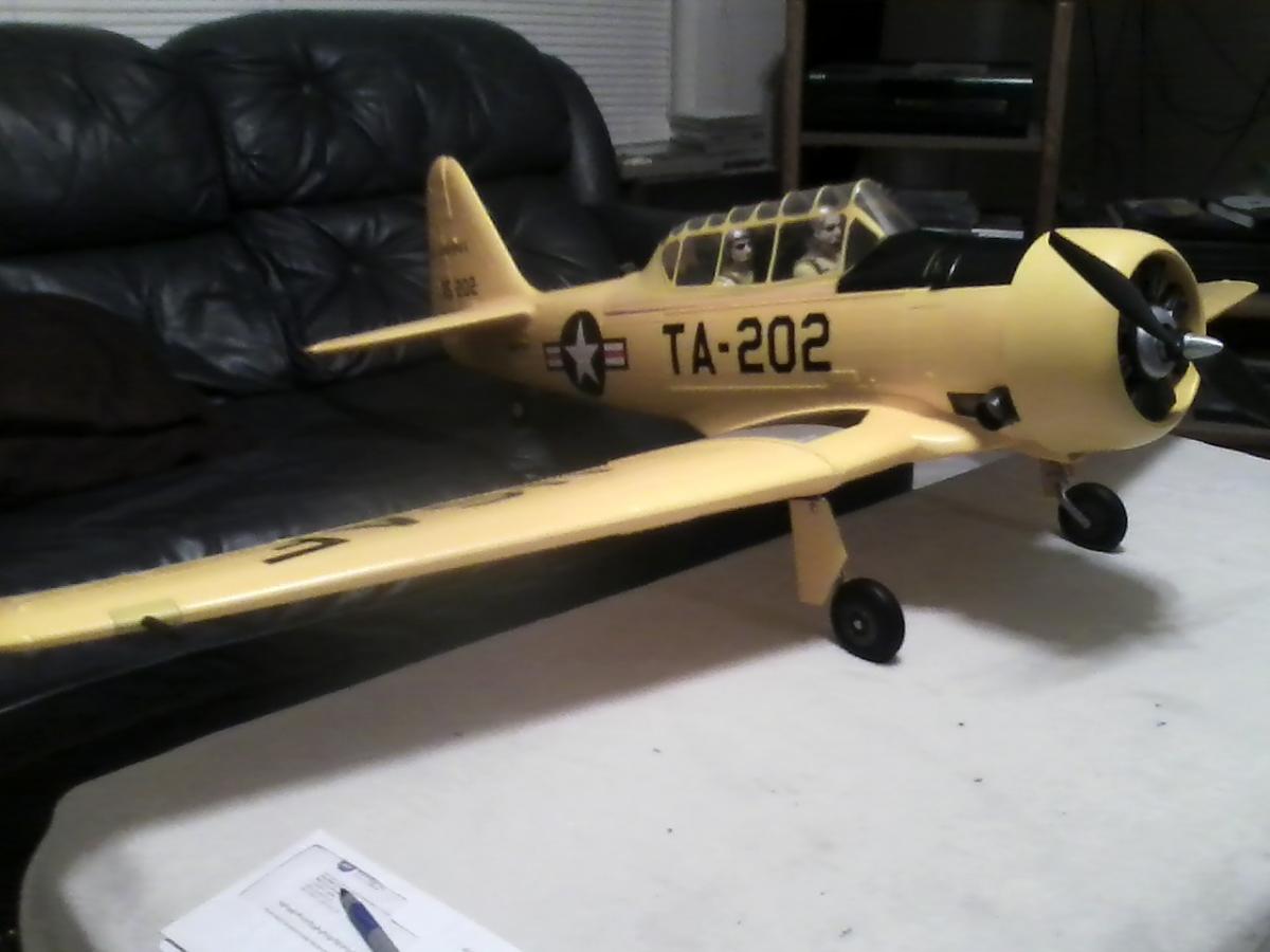

                                    Just got mine! Buddy I used to work with ordered this plane on clearance a year or so ago. He never flew it! Sold it to me for $160 including a Spektrum AR610 still in the package! Normally the T6 didn't catch my attention, but I couldn't pass up the deal. The guy in the build video was 100% correct about the needed nose weight. I added 10 oz's to get mine to balance with a 3000mah batt. I just happened to have 2 strips of lead that measure 1" wide by 5" long, each weighing 5 oz's. They used to be weights on 2 marker buoys I used on my bass boat. Took a small can & beat the lead into perfect circles & they fit behind the dummy radial like they were made for it. Encircling the motor with about 1/2" clearance all around. I think I'm gonna like this plane. I'll post a link to the maiden soon as i can. Click image for larger version
