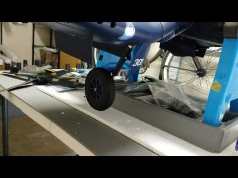

    Lame troubles so far. Gear isnt working properly, dead aileron servo...This is my 3rd FMS plane and it's always the same thing. Beautiful planes with sketchy electronics. :Sleepy:
    Anyway... does anyone know why the gear only wants to work when it's upside down... :Confused:
    I checked all the wiring. Everything is plugged in fine. I'm so confused.

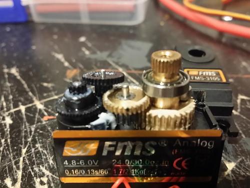

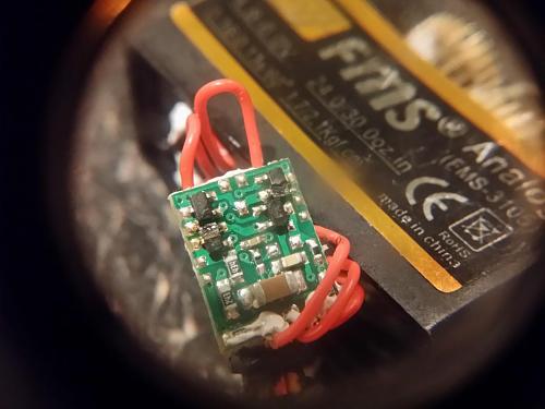

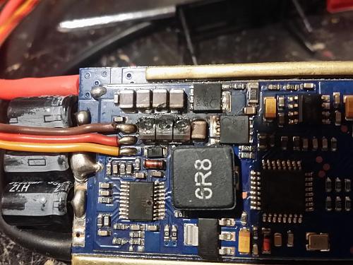

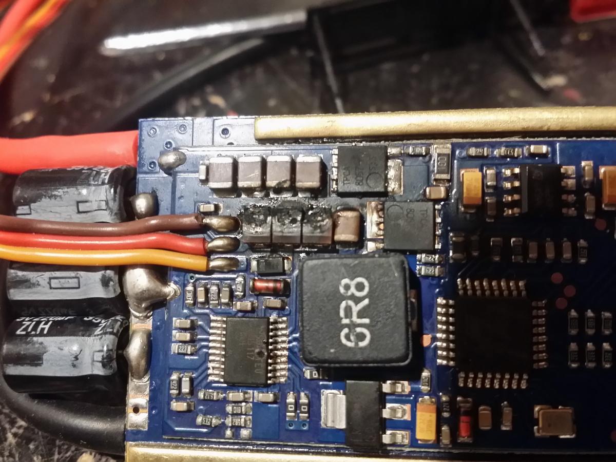

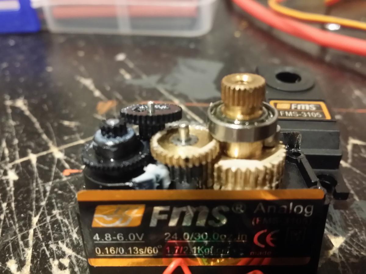

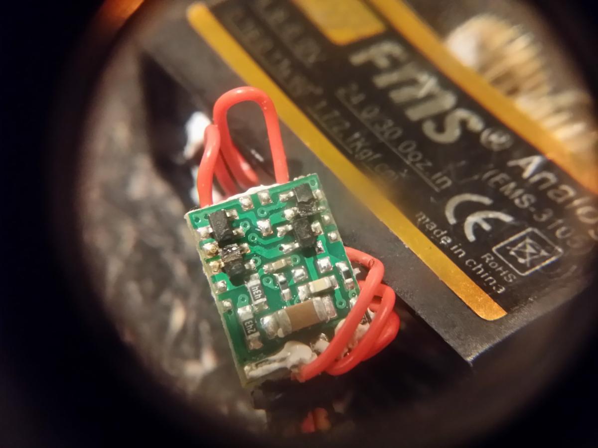

ID:	95348 Just got a f4u off eBay used. It was listed with all (yes all) electronics inoperative. Got the plane for a great price. It arrived, I started diag. And yes, all the servos,retracts and Esc are dead. The ESC has a bad burn where the receiver power wire is, all servos have a burn out on their board. The right aleron servo has much worse damage than the others. Have there been any issues with servo and or ESC failures like this? Hate to replace the bad components with components that are questionable. Also FYI, the 25g and 17g servos are not completely metal geared. The first 2 gears off the drive motor are plastic.
                  thanks
