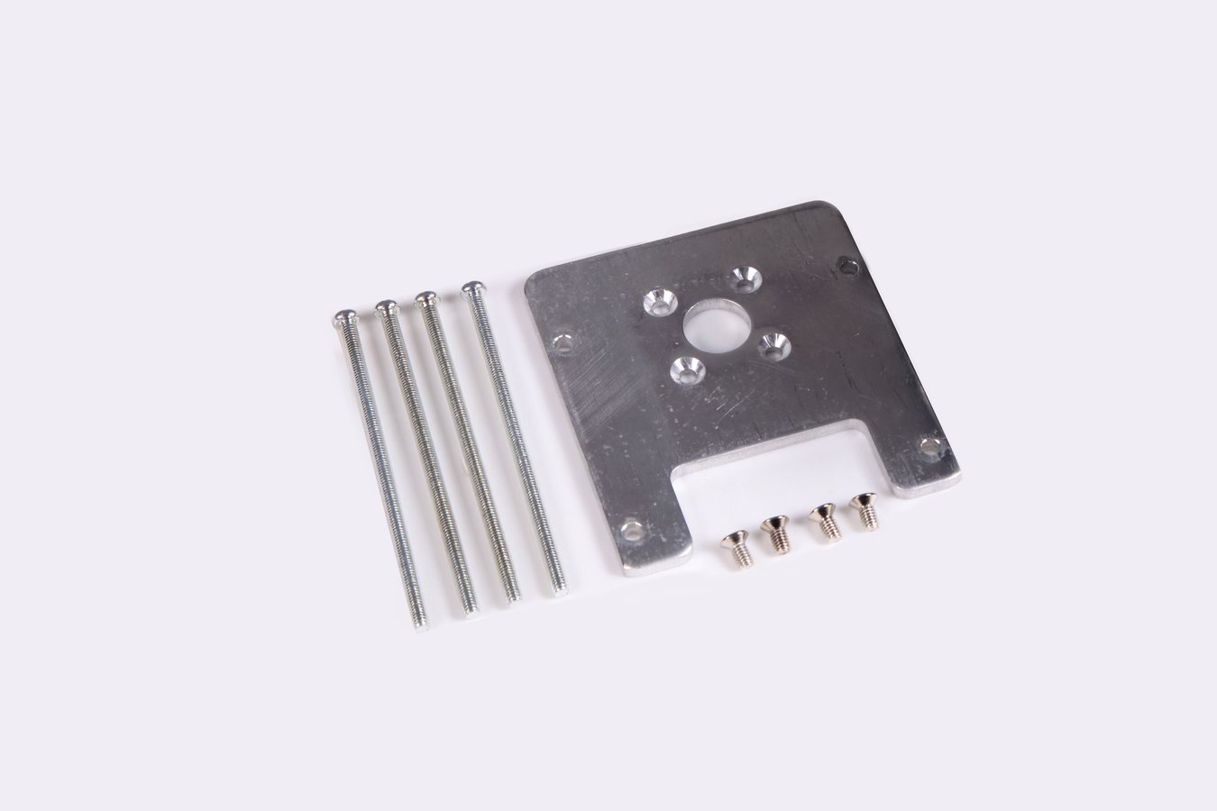

                          So, I ran into a problem.... I saw that mrc had the upgraded motor board (large metal bracket). I saw directions on how to install the new metal board over existing plastic firewall... So I ordered it and in true mrc fashion, i had it in 2 days. Well I removed the old motor mount ( the X shaped one).. i then went to remove the 4 long screws. 3 of them came out. One just spun. I finally got it out. But now only have 3 screws holding it in. If I tighten the 3 remaining screws it shifts the motor all squirrely. Any suggestions? My first thought is drill 4 holes in new motor mount to match the X shaped mount, then use those 4 screws with the outer 3 out of 4... Probably clear as Mud...
                          • #14
                            RE: 1700 mm F4U
                            apmech1, it sounds like the threads are stripped. I think the easiest thing to do is to use a screw which is very slightly larger in diameter. Ideally a self tapping screw. You could use a machine screw if you have a tap and die set so you can re-tap the threads for the larger diameter screw.
                            • #15
                              RE: 1700 mm F4U
                              I also want to mention our current inventory of 1700mm Corsair and 1700mm P-47 have the new upgraded firewalls (motor board) AND motor mount. There were not any issues with the 1700mm P-51D so the FMS factory has not done any upgrade to that plane.
                              Interestingly, the issue was never really the motor mount or firewall. The issue was a poor quality glue used to mount the magnets into the motor. In 3 cases ALL the magnets came loose on a 1700mm Corsair which caused massive wobble in the motor and thus caused the firewall to crack and the mount to fail. Again, there were only 3 cases which is a tiny percentage. This happened in early August. While we were diagnosing the problem, FMS upgraded the motor mount and firewall. When we told them the issue was actually the magnets coming loose in the motor, they traced the problem back to a new brand of glue used in the motor factory. They immediately changed brands of glue. We sold this plane for 2 years without issue so anyone with the old mount and firewall is likely safe. If you want to upgrade the mount, we have directions in the support tab for the new mount showing how to do this.
                              • #16
                                RE: 1700 mm F4U
                                Thanks for the reply. I figured it out. In the back of the motor mount there are white inserts with threaded medal inside of them. During the unscrewing process the white inserts got pushed out of the back of the mount. All i needed to do was slowly thread the longer screw in (with out the motor mount) to get it to engage the treads of the whit inserts. Then pull on the screws to re-seat the white inserts. Once that was done i removed the screws and installed the motor mount. Everything is snug. Note: i noticed if you torque down the upper mount to board (long) screws (this applies to older motor board only) too much it will cause the new mount to bend and cause your motor to sit with a positive down thrust. I backed out the top 2 screws 1/2 to 3/4 of a turn and they are still tight and no more up thrust. The only other solution is to put stand offs behind the upper 2 mount to board screws. Or replace the motor board with the new style..
