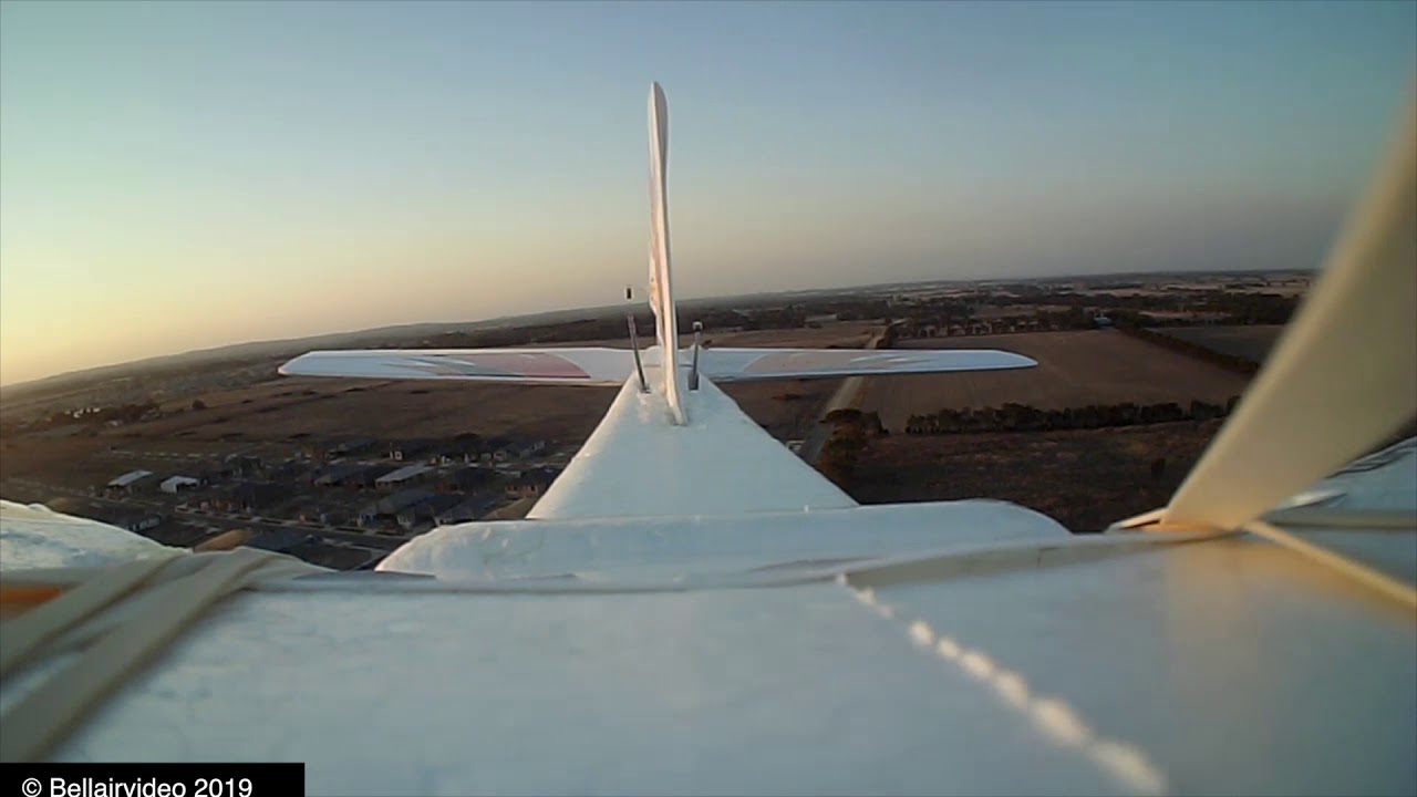

                                        Had a successful flight a few evenings ago, a balmy 27c.
                                        Make sure you check that the tail plane secure as mine came apart i mid flight a couple of months ago had to replace a few parts.
                                        I try to store the rubber bands in a zip bag with Talc powder, they then do not perish.
