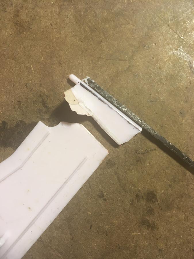

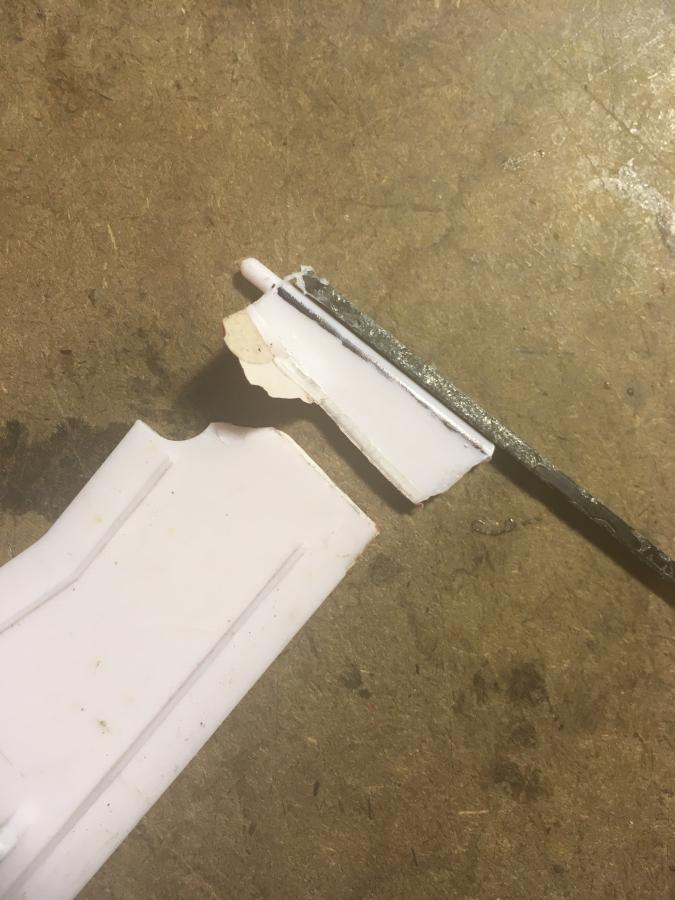

                  Lemme see if I can get a picture.
                    • 8834
                    Here's a picture of one of my broken wheel doors. You can see where one of the "pins" is sheared off and gone. If and when I need to use this part, I'll use something like "Epoxy Steel" from HobbyKing to join the end piece to the remaining main door. Note the Sharpie line I drew just below the remaining pin. I'd Dremel off that entire end and cut a piece of round CF rod. (Unfortunately, I don't have round so I used the square one for demo purposes only). Make the rod the required length so that each end sticks out to make new pins. Dremel a suitable roundish trough on the end of that piece and use epoxy to glue it down. To reinforce it, wrap around the end with fiber tape to secure the rod onto the end of the door piece. Make the tape longer so that it will cover all of the bent end piece and down each side. Just make sure none of it will interfere with the door opening and closing. If you don't like the tape showing, I suppose you could give it a light spray paint.
                    If you want to reinforce the bent end section on a new door, just use the tape. However, there is no easy way to reinforce those stock pins. They're plastic and very thin. These days, I'm just too lazy to do all this repair work on such a tiny section of a part. I just order up a bunch of spares. Of course, once you done that, you'll never need them.
