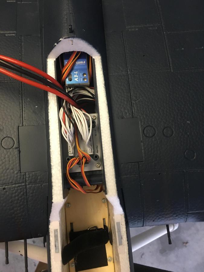

                        My question is where in the plane did you put the gyro? I see a small flat space just aft of the electronics box. I cannot see anyplace else where it would fit nicely.
                          This is where i put mine. Works great.

                            Spec 450. Thank you. I thought that would be a very likely spot.
