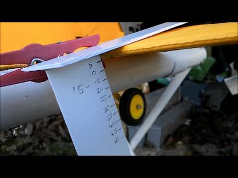

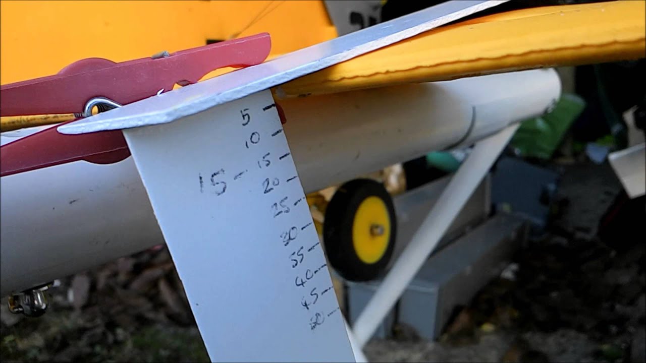

    If anyone owns this bi-plane, I could use some advice. The manual states throws of Ai 15-20, El 12-15mm, and Rud 12-15mm. What settings if different from the manual do you fly?
    Hopefully this will help .. put about 20% in on expo for ail and elev and about 15% expo for rud
    Made this video a while back to try and help another tiggy pilot get set up
