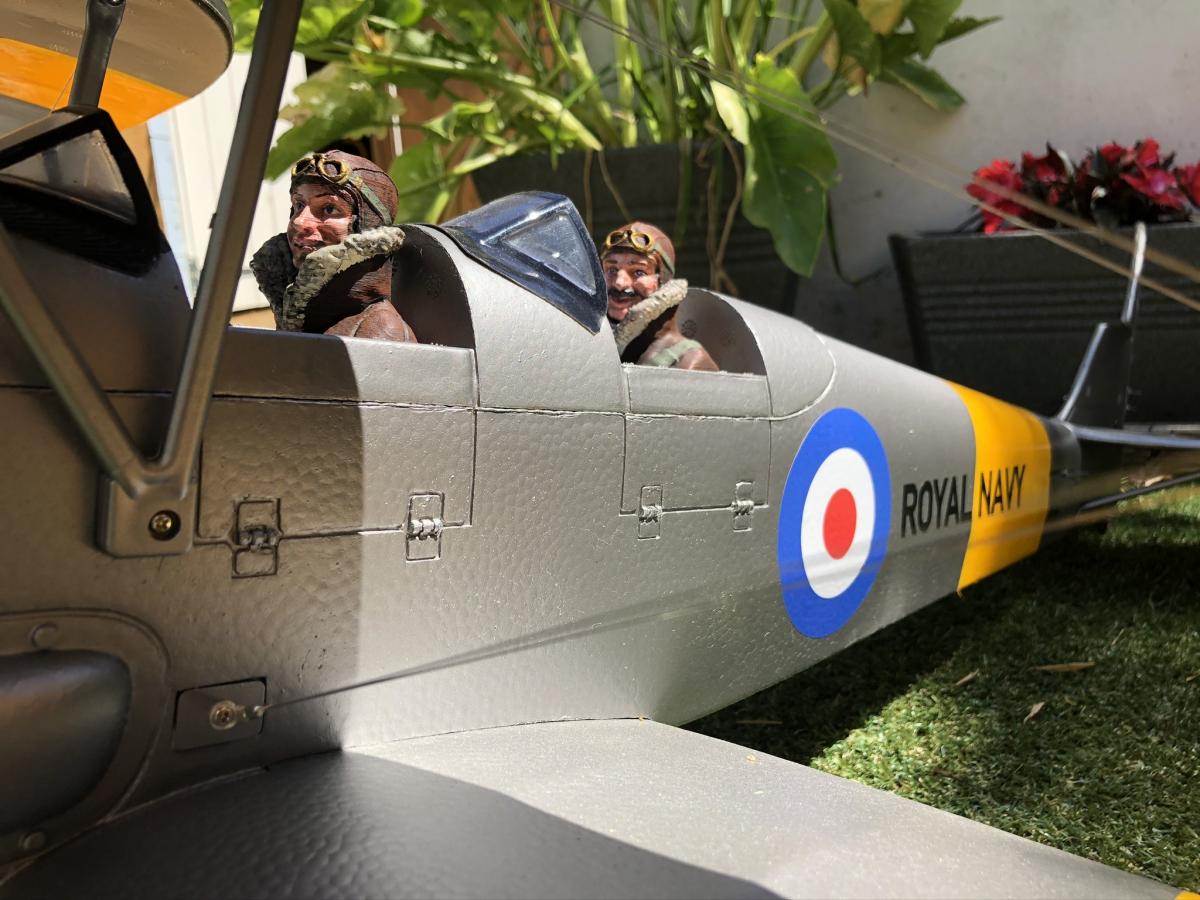

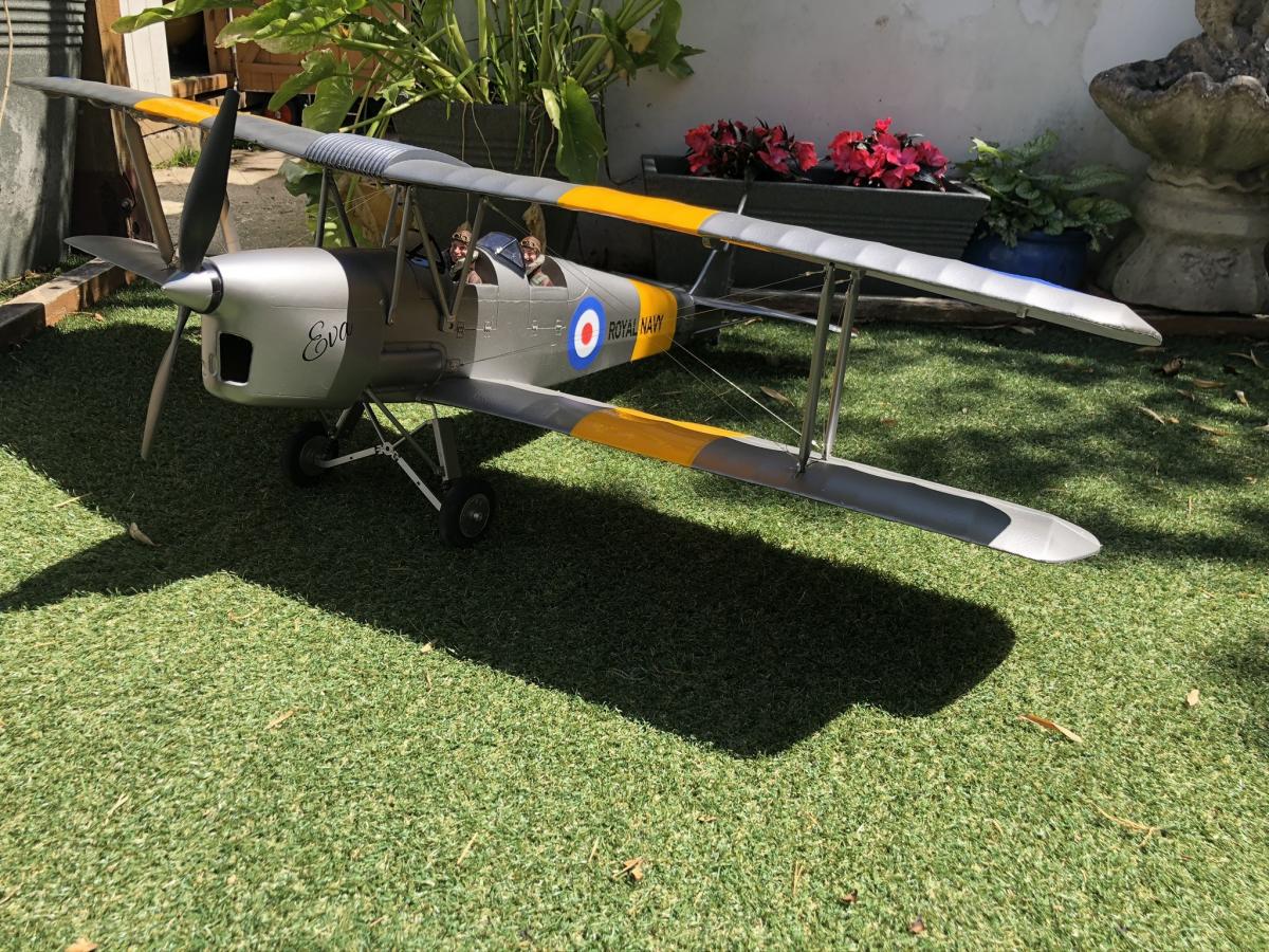

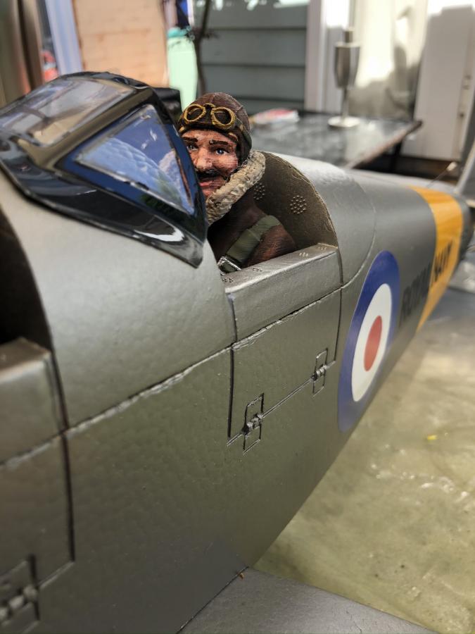

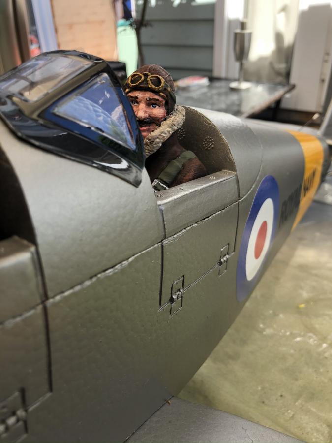

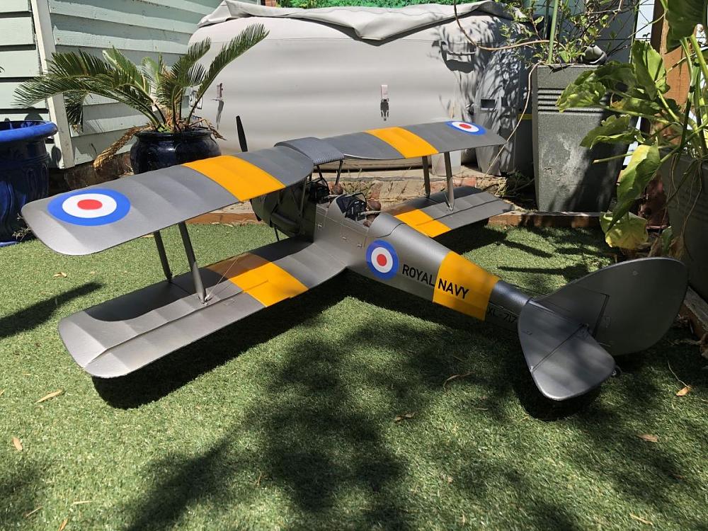

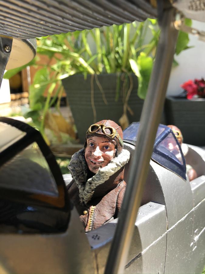

                      Hi Guy
                      I am going to maidening my tigger this weekend any advice on CofG and rates would be greatly appreciated. I’m going to be using Admiral 4s 2200mah
                      I have repainted her to a Royal Navy then nexa copied me lol
                      many thanks Click image for larger version  Name:	07153990-5558-4B98-B971-C36FF0638F22.jpeg Views:	0 Size:	58.3 KB ID:	263004Click image for larger version  Name:	BB850CDC-D702-40A0-8DF5-C0B2BCCA6E4E.jpeg Views:	0 Size:	131.4 KB ID:	263005Click image for larger version  Name:	172D8800-0C07-4207-A90A-645CE8C1885C.jpeg Views:	0 Size:	74.7 KB ID:	263006Click image for larger version  Name:	7116C243-6369-4488-AF72-90E989DDEE5B.jpeg Views:	0 Size:	262.1 KB ID:	263007Click image for larger version  Name:	33CEEB71-FB71-4267-A03D-5FC7914109B0.jpeg Views:	0 Size:	223.2 KB ID:	263008

                        #31
                        Beautiful job. I fly mine with either a 4S 2200 or a 3S2400. Performance is fine with either. Just get longer flight times with the 4S.

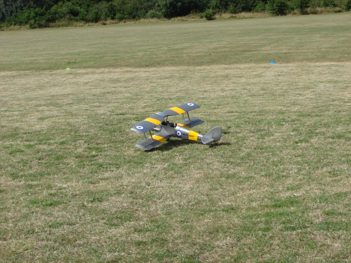

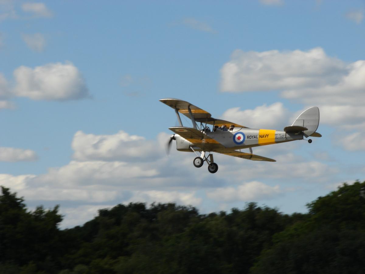

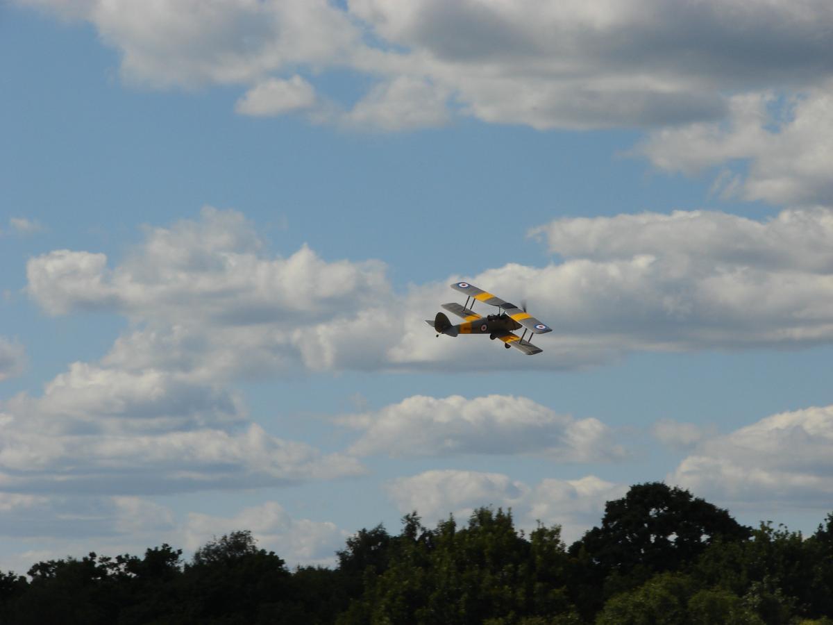

                              #34
                              Thanks for the help guys. I got to fly her for the first time on saturday.
                              She flew very well except I felt she looked a touch tail heavy. I did as you can see mess up the landing but no harm done. I will have took into a mod I have heard about.
                              Please enjoy the video and if you have any suggestion of observations I will be very happy to hear them .
