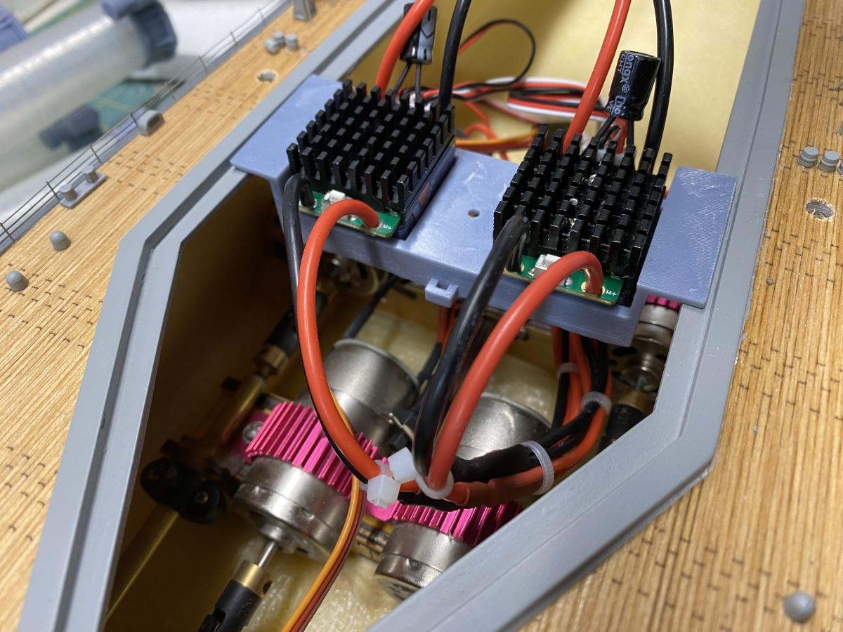

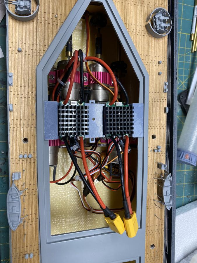

                                    TWO ESCs ON ONE SHIP
                                    I wanted to share that in my 1/200 Missouri (and in most of my other multi-screw boats) how I am able to independently control throttles to be able to twist the ship by moving port forward and starboard in reverse (or the opposite). This is how I do it. It does not make it right. There are many other methods, some of which may be more suitable for your application.
                                    While many multi-screw boats come with a single ESC, you need at least two independent ESCs to twist the ship. I can pivot her in her own length and pull her out from the pier in a minimum of space, no tugs needed. If you are fancy with your rudder, you can even walk her sideways without a bow thruster.
                                    On many boats I am able to use inexpensive RC car ESCs with good results. They can be set for forward and reverse, rather than their default forward, brake, reverse function and many can be had for under $15 a unit. I run one ESC to each side of the boat, be it a two shaft or four shaft. Four ESCs on a four shaft is probably better, but could be overkill, so long as your total amp draw is within the capacity of the ESC. Many of our boats probably only draw 10 or 15 amps total per side when running at displacement speeds. But you can check this with a meter to ensure you are within the capacity of the ESC.
                                    The real magic comes from mixing, within the transmitter. I use a Spectrum DX9, but many radios can do computerized mixing. This is a stick radio, but wheel computer radios can do the same thing. The end result is that one motor is on the elevator channel and one is on an Aux channel. With the mix deactivated, up elevator is forward motion on both sides of the ship. When I flip a switch to activate a mix, up elevator is also forward on both side, BUT, if I move the stick to the left or right...the aileron control, one motor goes forward and one goes reverse AND does it proportionately. And if I move the stick forward while doing this, there is still forward throttle on BOTH sides, so effectively I can slow one side while maintaining power on the other to tighten a turn, without actually going in reverse on the shaft on the inside of the turn. This is great for long ships that need speed to turn, such as the Missouri.
                                    There are tutorials on Youtube and RC Groups on how to do the programming and it is not hard. Once you have it, you can copy it for each new ship you use it on, so you are only programming it once.

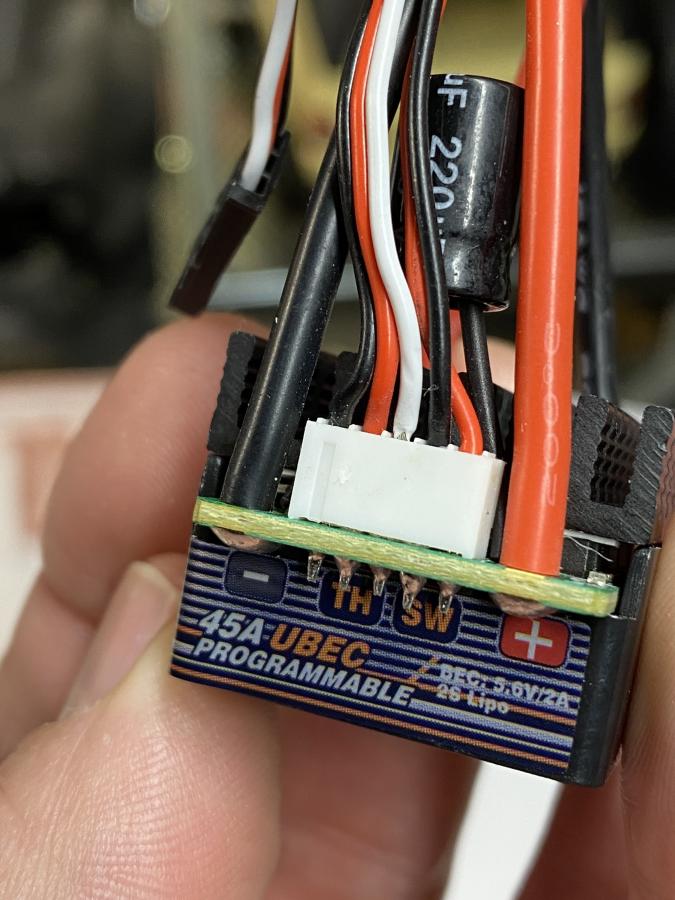

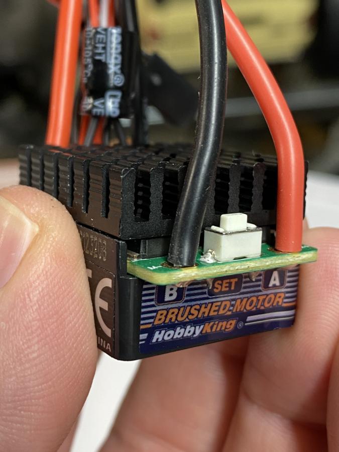

                                    In the attached photos, my wiring is not yet neatened up, so there is a bit more work to do, but you can get the idea. I 3d printed the little tray for the ESCs to keep things neat. When using two or more ESCs, it is important to disconnect the power from the BEC from one of them so that it does not interfere with the other one. To do this in a non permanent way I make a short servo extension with only the ground and signal wire and use that on the throttle of one ESC, that way I am only using the BEC from one ESC.
