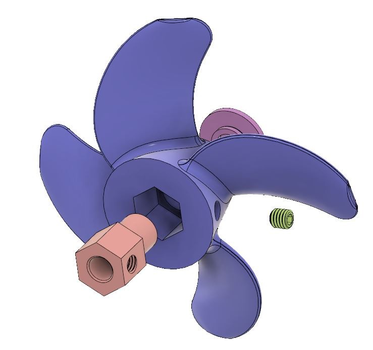

1. Metal inserts. Even many molded nylon props have molded-in metal inserts for durability. For my Fairplay 30, I designed my own SLS nylon props with a hex hole, then machined brass hex stock to press in and accept the grub screw.

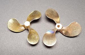

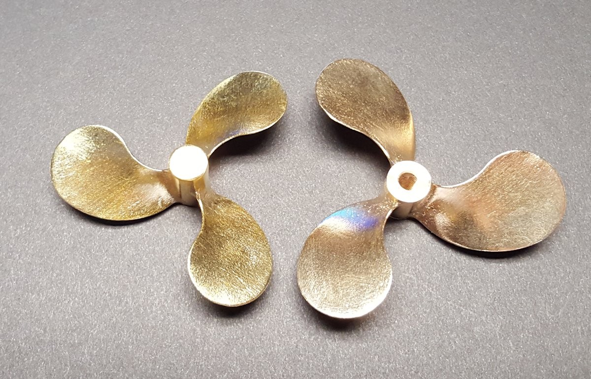

I have made some of my own props in brass and bronze through Shapeways... even pricier with SW's markups, but it was worth it to me. Such props could be offered by the retailer as an upgrade, hint hint.
My own special prop in bronze:
