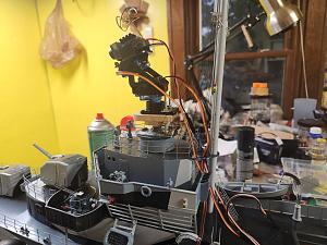

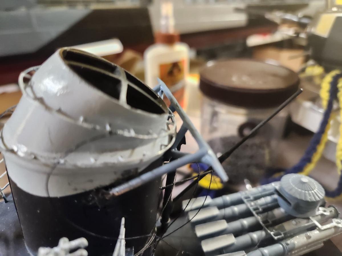

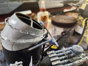

          So it's been awhile but I did some minor mods to add that I thought were somewhat relevant. One I did some time ago but just never put up as by itself it wasn't much.

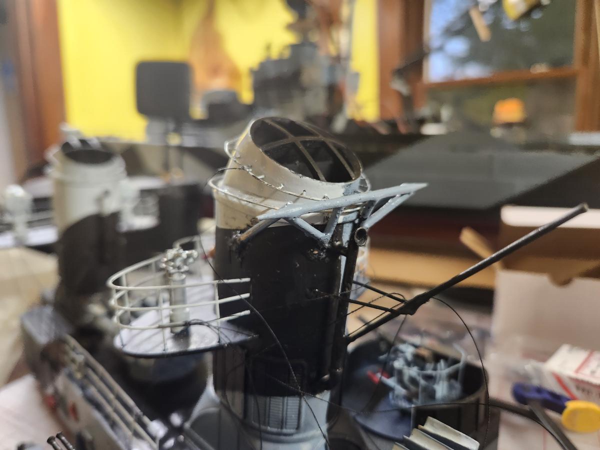

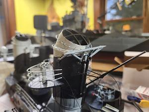

          Looking at photos again I realized on the AFT Funnel there was some extra structures up there and that a little time with some toothpicks, paint, and a bit of glue it was easy enough to add in.

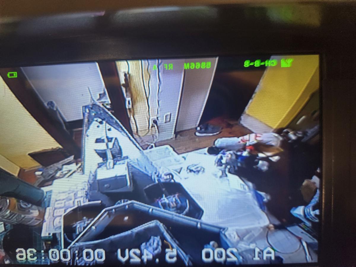

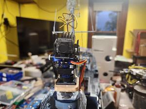

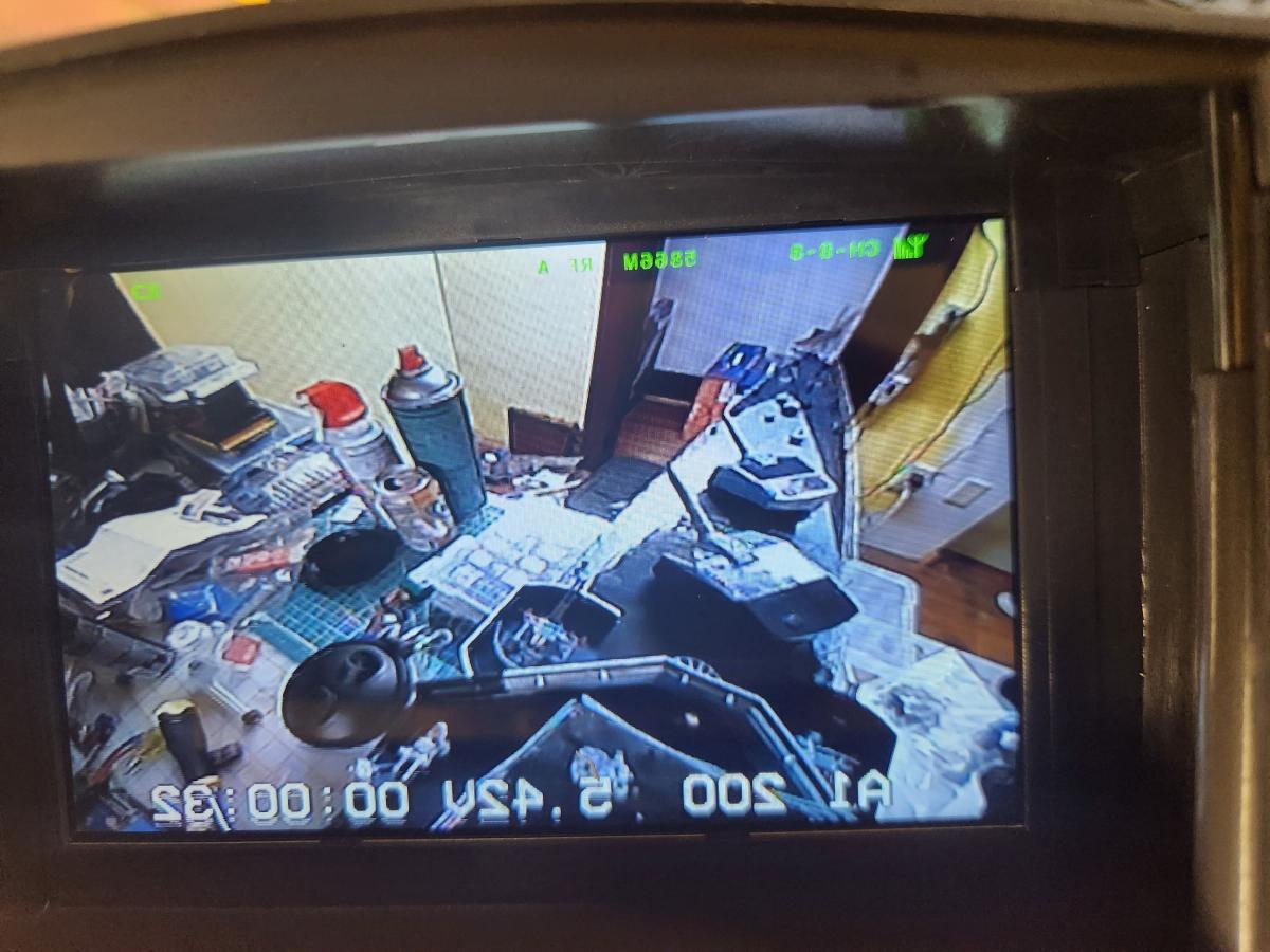

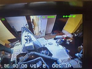

          The next one is a bit more entertaining for me.

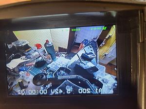

          FPV
ID:	384620Click image for larger version
ID:	384622Click image for larger version
ID:	384619Click image for larger version
ID:	384623Click image for larger version

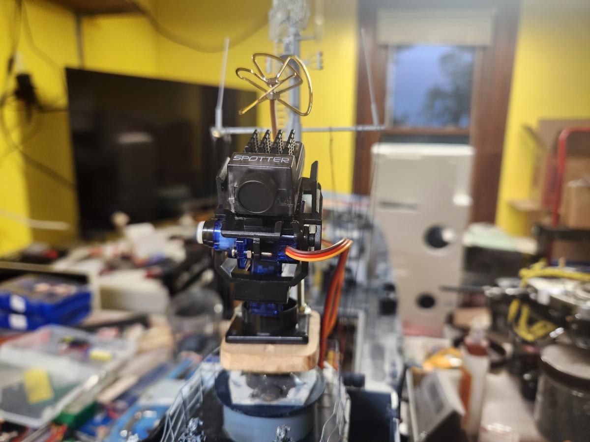

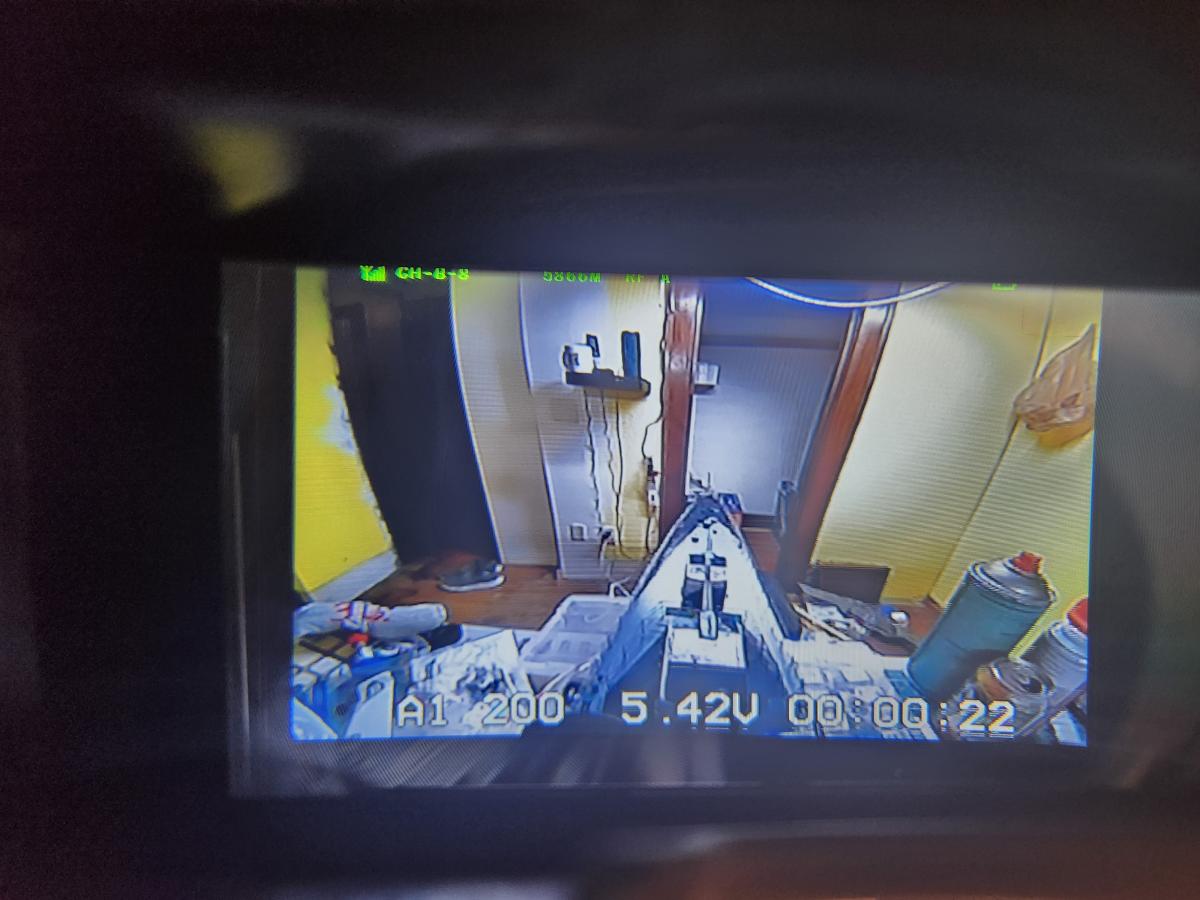

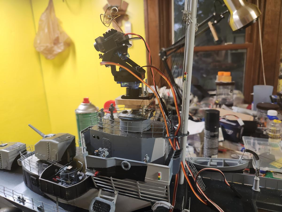

          My setup isn't anything real fancy and wasn't too expensive. It's really a cheap FPV camera and a Somewhat Cheap Headset. The mount is just magneted onto and over the Gun director's bottom plate. just a small flat of wood with a hole in the center and a $20 pan/tilt set. Only hooked one of the two servo's into things for the time being as I can use the FWD guns to pan the camera side to side and then my AUX2 knob to tilt up and down. With the camera that High up on the structure I figure that will make for a halfway decent view. Now I need to get her out on a local lake with the setup in place to see how motion sick it can make me.
