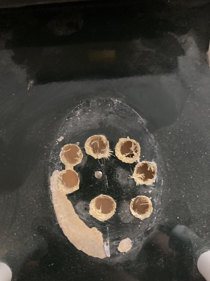

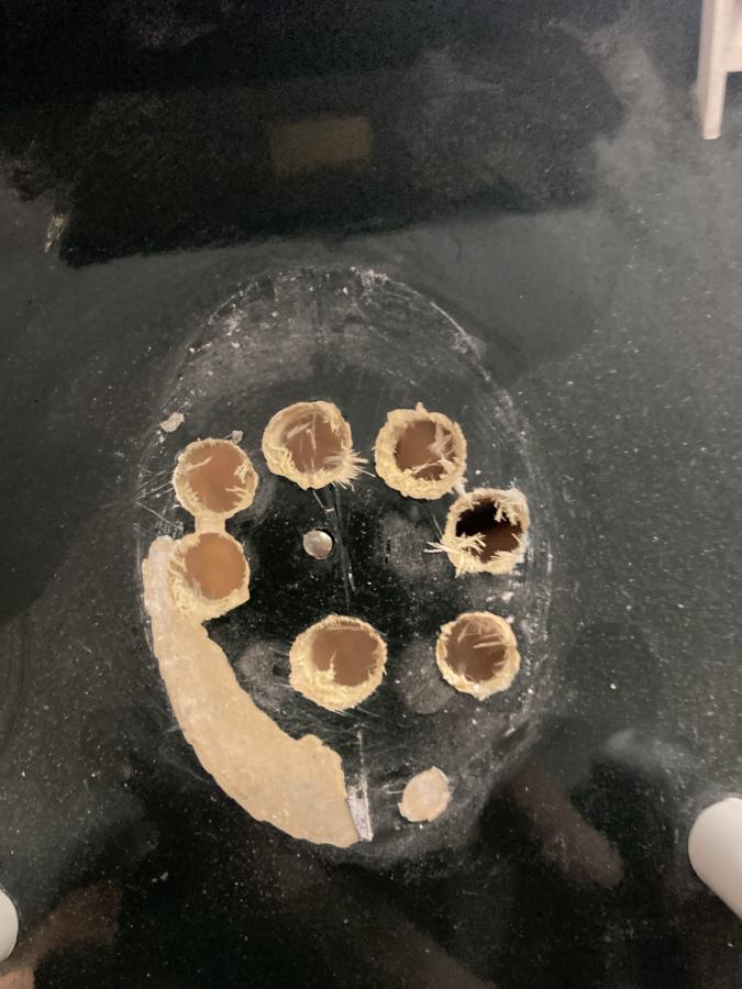

                                I'm in the process of locating a tug for sale. I found one sitting on a shelf in a hobby shop, been there for at least seven maybe 17 years ,and I called them sat after getting paid and it had been sold the day before.
                                I read comments about cooling the motor and thought a heat sink with a fan used on rc cars would work better.. then if it needed more a piece of plastic pipe inside the stack could be added. A hole to allow fresh air ro be drawn in thru the pipe and holes in the top to vent it...with a small fan if needed..air flow is the key..
                                • Battleship
                                  • Oct 2020
                                  • 242
                                  #36

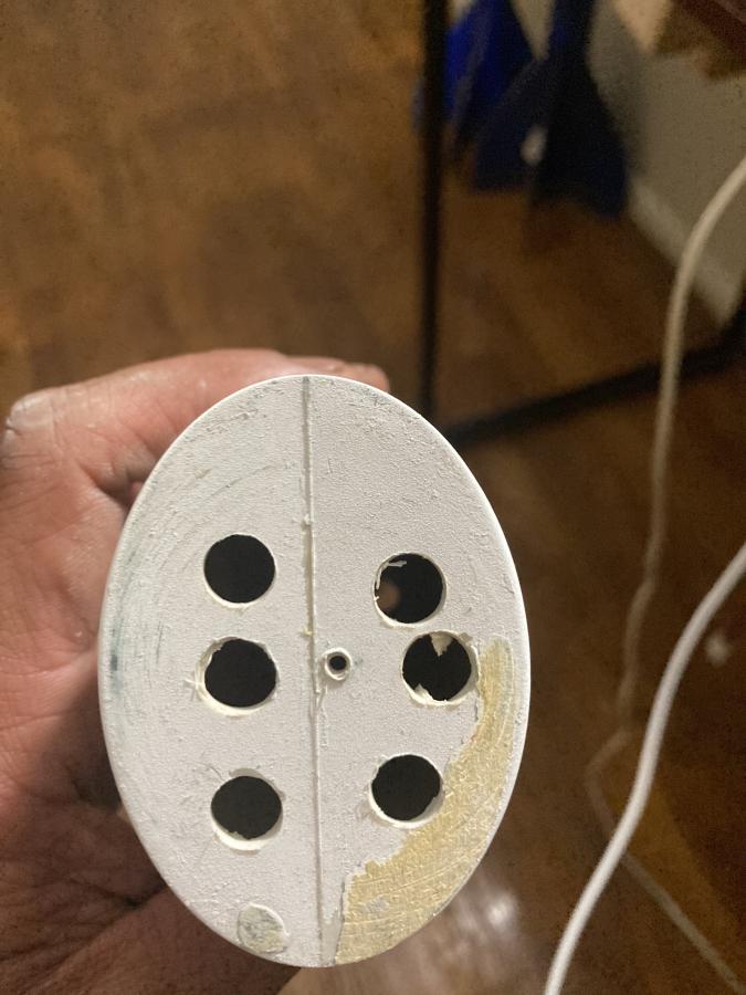

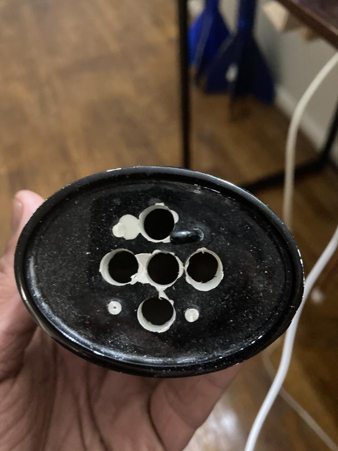

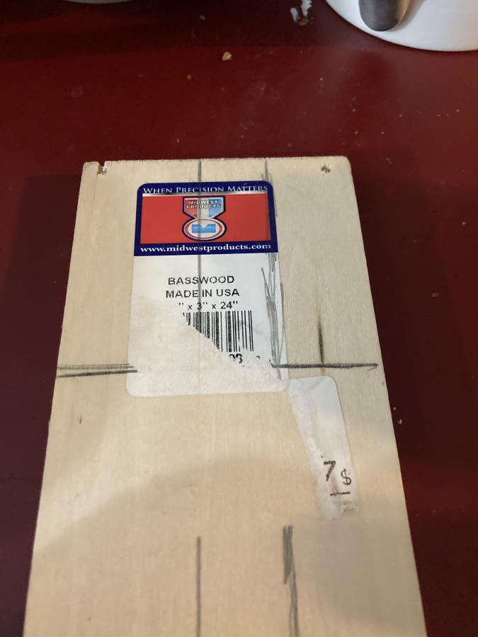

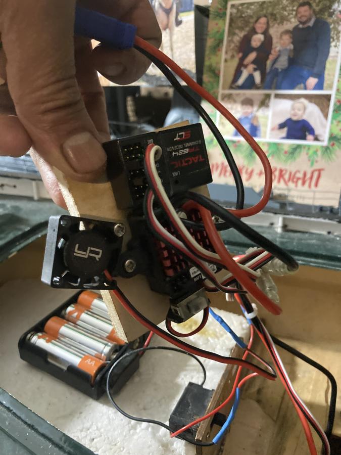

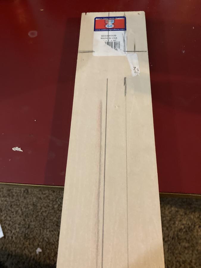

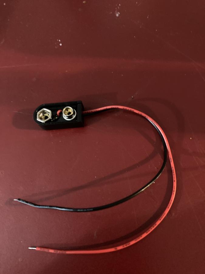

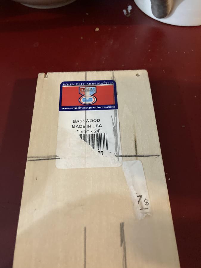

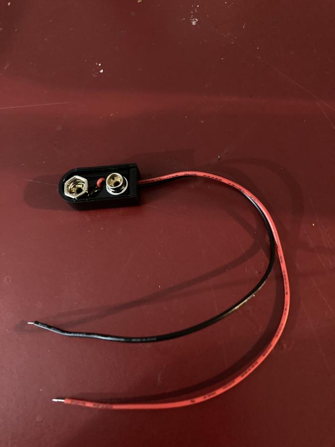

                                  Just respectfully asking sir do u have the motor copler Then u need a servo arm Then in the bottom of the tug boat smoke stack. Drill 3 5/16 inch lord. I on eatch side of the smoke stack and then on the top of the smoke stack drill 5 = 5/16 Then buy a sheet of bass wood and cut it in a square then drill a pilot hole for the screw to hold the cooling fan in place over the motor with that the square block of wood use Velcro the u will need a for aa battery holder with a nine volt to a nine volt battery wire lead then soldier it in to place with shrink tubeing and that’ll create more air flow inside the hull of your tug boat tell me how u turns out
                                  battleship I did post some pictures on how I did it

                                    Just respectfully saying sirs the photos on page on of the Atlantic harbor tug boat page 1 is how I did that

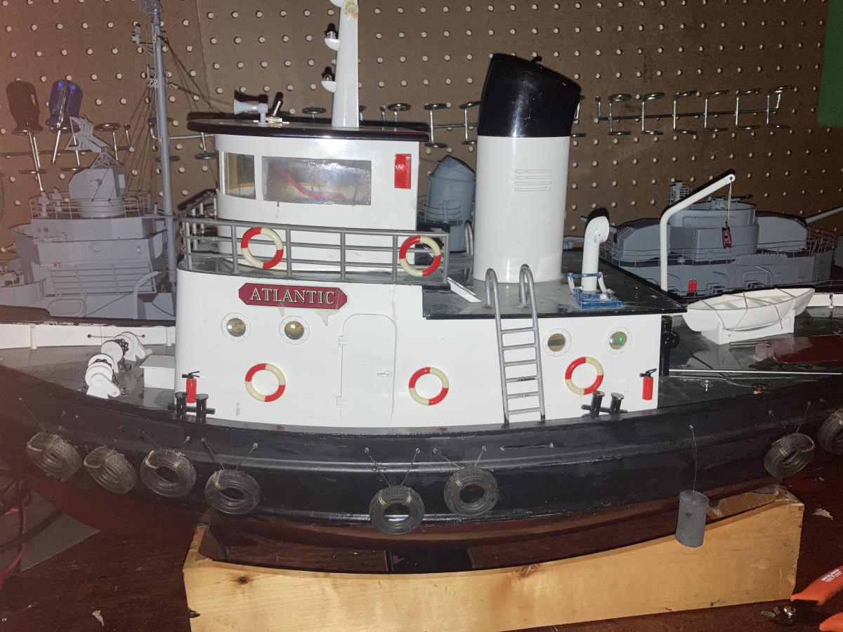

                                      Here are the things that I did to my tug boat

                                        This is what the improvements I have made on my tug boat

                                          I thinks this is what it looks like with the lighting
