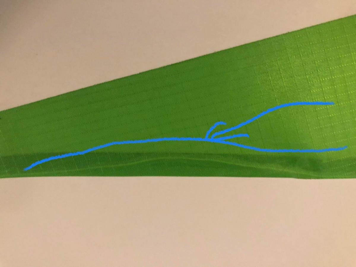

    1 - The forestay line was not free within the luff of the jib. In fact, it appears when the luff overlap was completed during manufacturing, the forestay line became fuzzed in place. The forestay line or wire needs to be free of the jib material. You should be able to slide the jib up/down over the forestay, as it is used to tune the shape and drive of the sail. Mine was fuzzed in place with lack of tension on the leading edge, so some folding of the luff could happen when under way.

    Forestay example. Should move freely within the Jib pocket. Line is fused in place

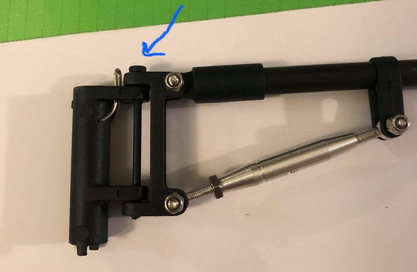

      example of Boom hinge bore toleration causing deflection variation

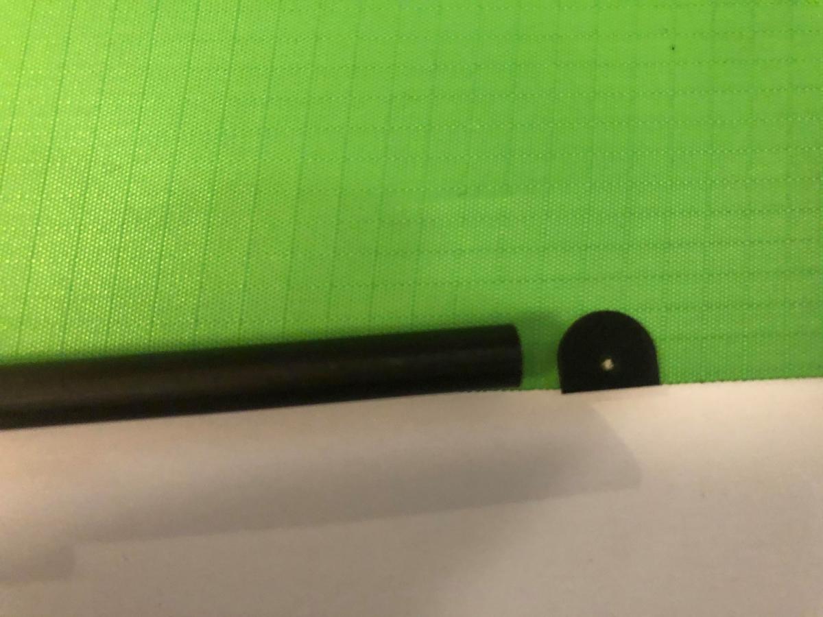

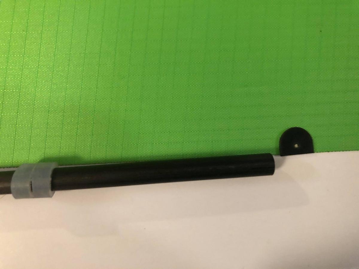

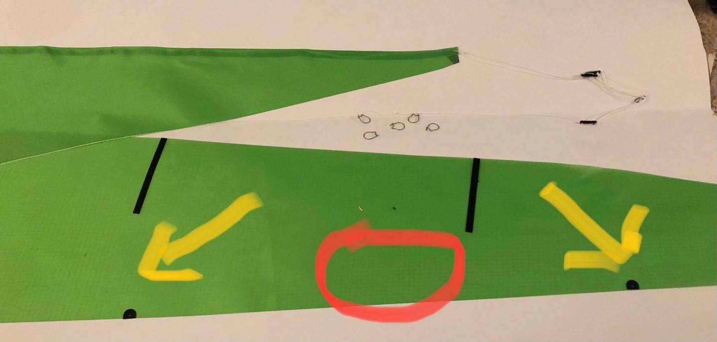

        Mast eyelet patch missing on Main sail
        Since sails do not have stainless eyelets, the patch helps reinforce the sail and decrease the chance the retain rings will tear thru the material

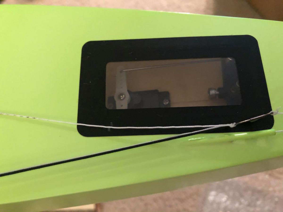

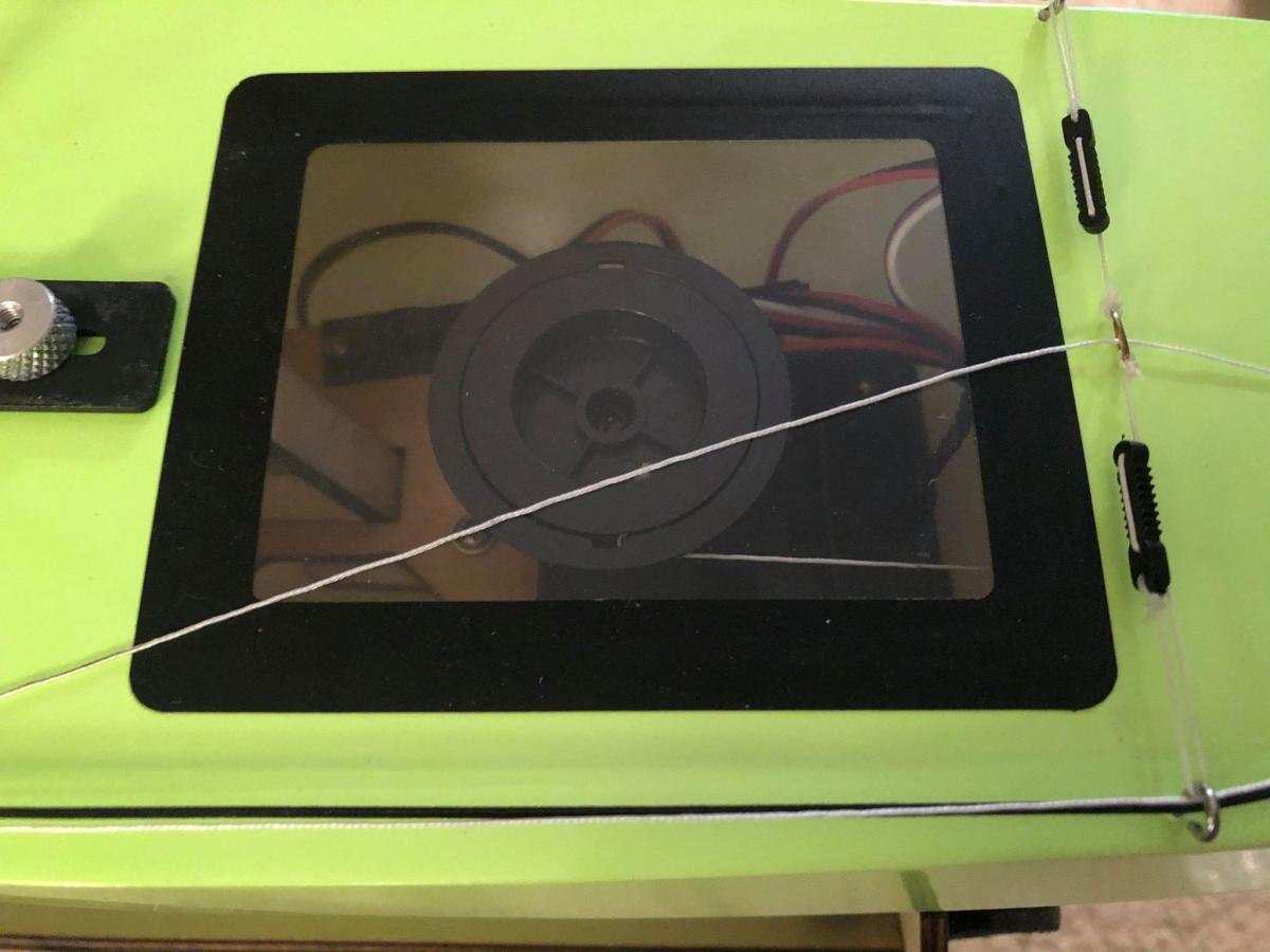

          Hatch and Rudder Service hatches. They come already installed, but you have to untack them to setup the boat. Please have to remove the main hatch to turn the boat on/off each adventure. The clear part is plastic film. The black portion is an adhesive patch
          A good upgrade would be a magnetic switch since there is no self bailing cockpit on this design.
          FYI - Clear Hockey Stick Tape makes a great use for hatch sealing on boats. Please you get a lot more of it on a roll for the money.

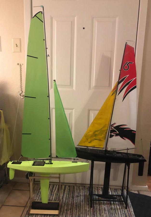

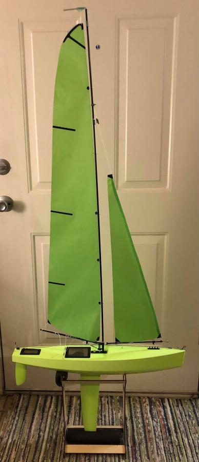

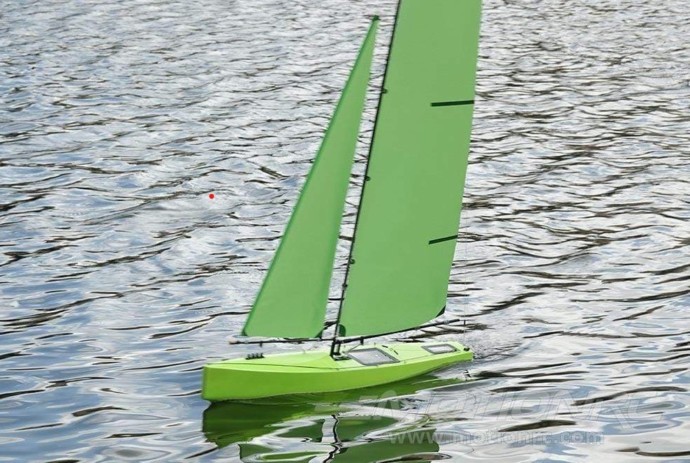

              She carries a tall main verses my "OLD" DragonForce 65

                  We were able to get a couple of the Quickfires on the water last weekend.
                  Winds were really pushing the limits of the tall sail package. 15-20mph and gusty.
                  Boats performed well. We did really have to luff the sails to limit the power they could generate in such wind conditions. Very minimal water intrusion. Likely due to wicking from the Boom Sheet guide as the sails get worked in/out
                  I think the standard rigging is ideal for casual sailing or cruising. I would prefer a more race inspired tuning setup like other boats in the RG65 class. Would be really helpful for tuning the Jib and Main Booms.
