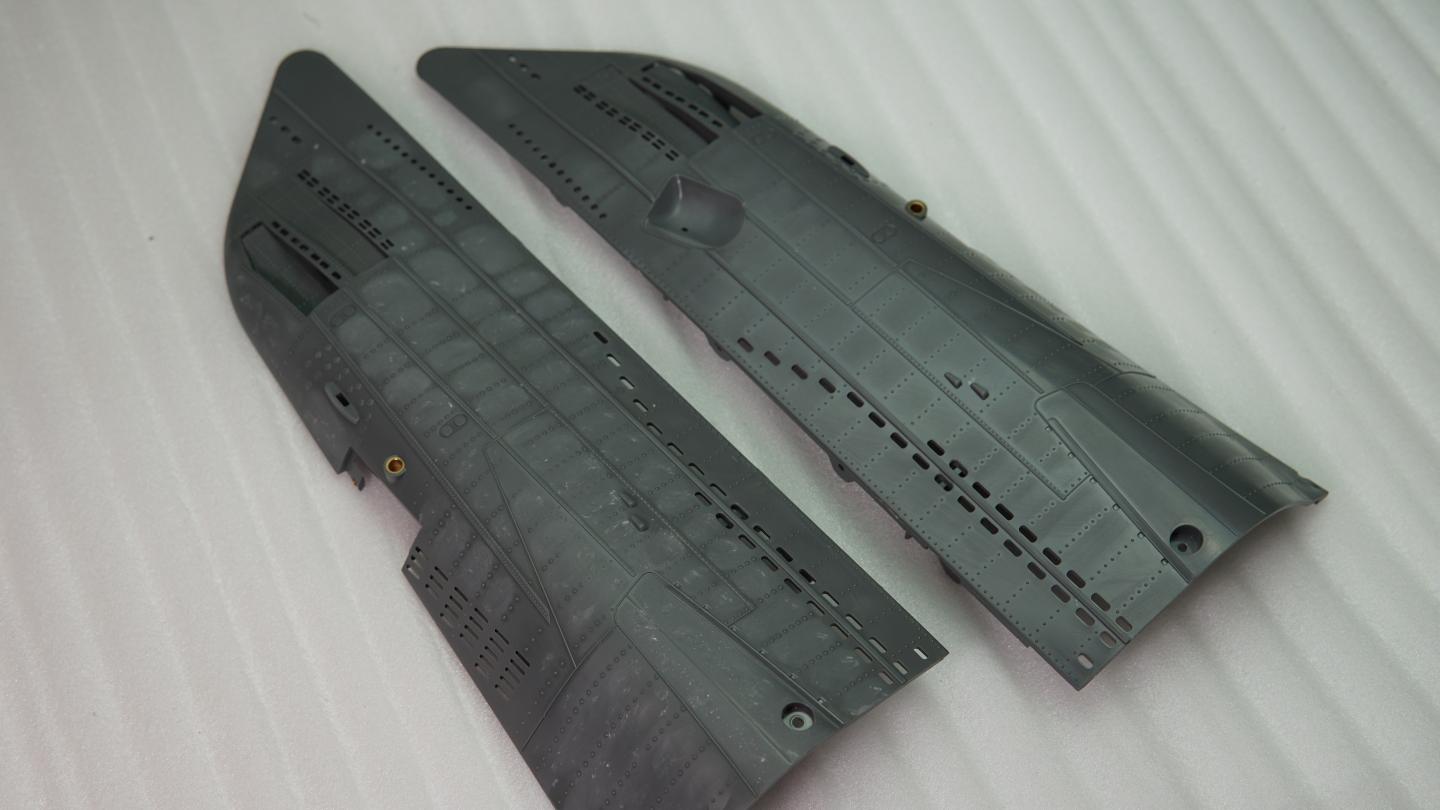

    To start off, I am not a 3DP master of patience like RCJetDude, so I didn't 3D print this kit, but rather did it the old fashioned way and bought it. It's a 1/48 scale kit molded from ABS and designed as both a static display kit and an RC-Ready kit. The "RC-Ready" aspect of the kit simply means that some areas are designed to facilitate moving surfaces and easier disassembly. For example, the main hull is divided into three sections: Forward, center, and aft. Each section is composed of a port and starboard half. The forward section and aft section screw into the center section with molded in brass threaded inserts, making disassembling and servicing the RC sub's WTC ("Water Tight Cylinder") much easier.
    The rudders and diving planes also arrive in the kit with brass inserts molded in and steel rods to hook up control equipment.
    I have notoriously little free time, so I decided to finish the boat as a static display first, then go back and install the WTC later since it only takes an hour or so to install the first time and just a couple minutes to access and service thereafter.

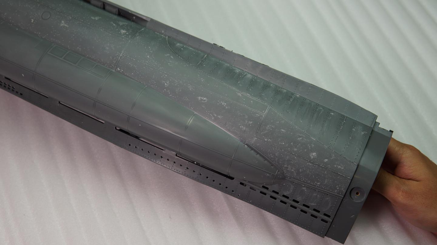

    The forward, center, and aft sections are shown below. The ABS kit is molded nicely and these sections aligned for the most part. Based on reference photos, I decided to grind down the panels to represent buckling under high pressure at depth, and also to pock the center sections fuel tank bulge area to represent pitting. This is an extreme example, but models' weathering and wear is typically exaggerated for effect, so I'm taking similar artistic license here.

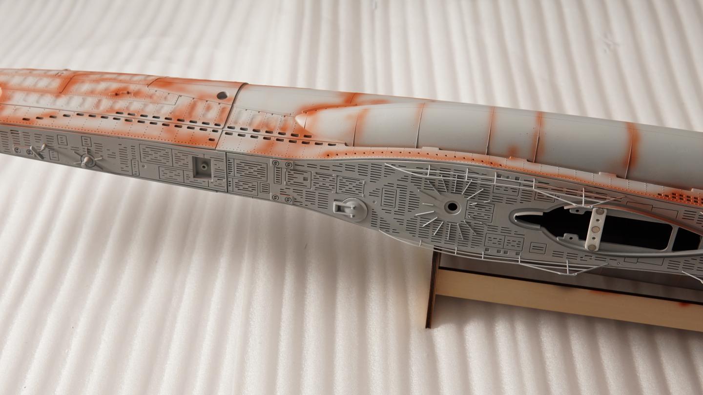

    I'm using enamels and lacquers on this sub for enhanced durability compared to the water-based acrylics I normally use on a foam electric RC airplane.
    Click image for larger version  Name:	DSC07012.JPG Views:	0 Size:	109.9 KB ID:	243900Click image for larger version  Name:	DSC07016.JPG Views:	0 Size:	85.8 KB ID:	243894
    With just the primer coat and two colors (rust and custom blue/gray), the submarine is beginning to look the part. It needs about ten more colors of paint and weathering before I seal it all in, but I'll save that for the next update.
