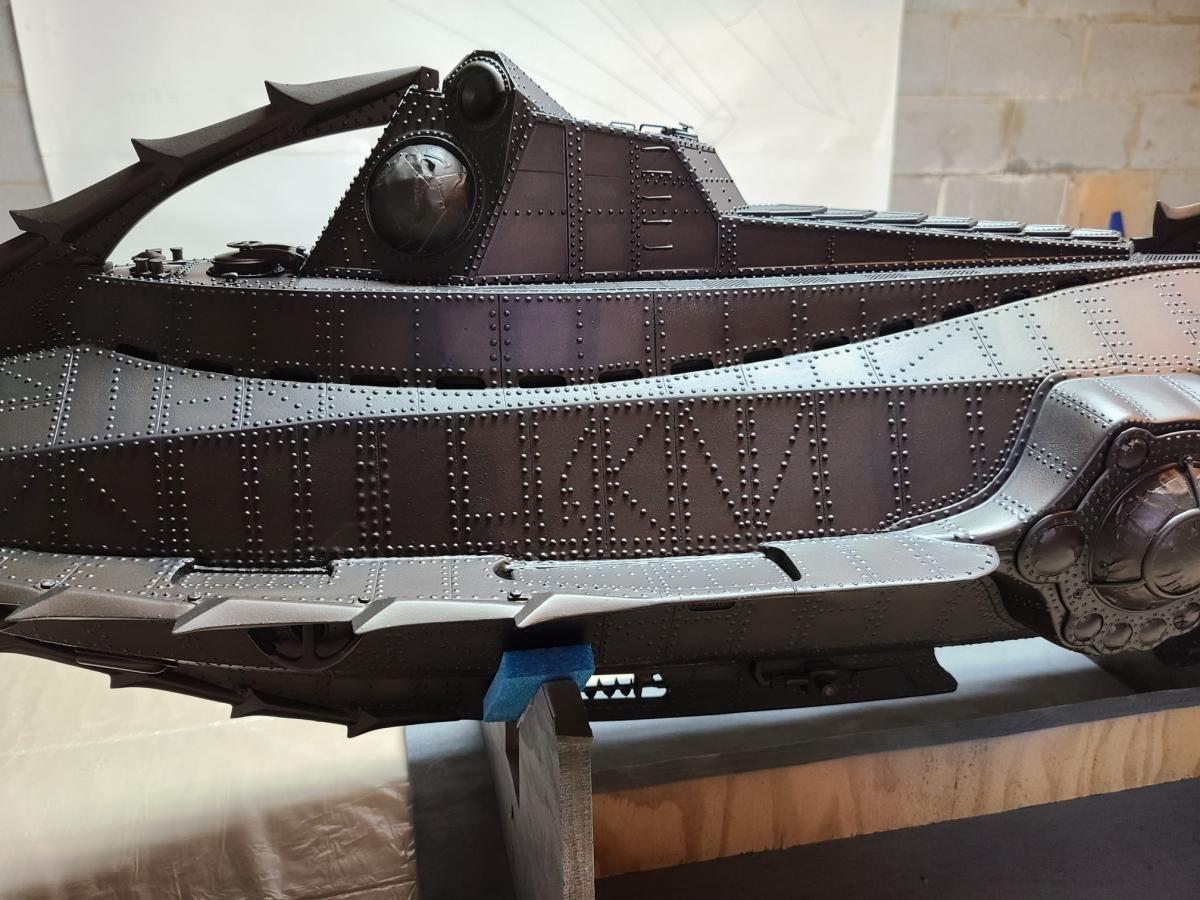

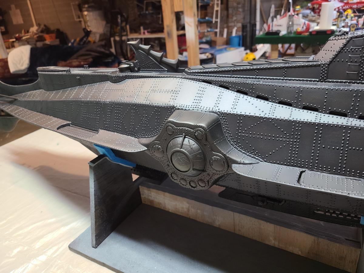

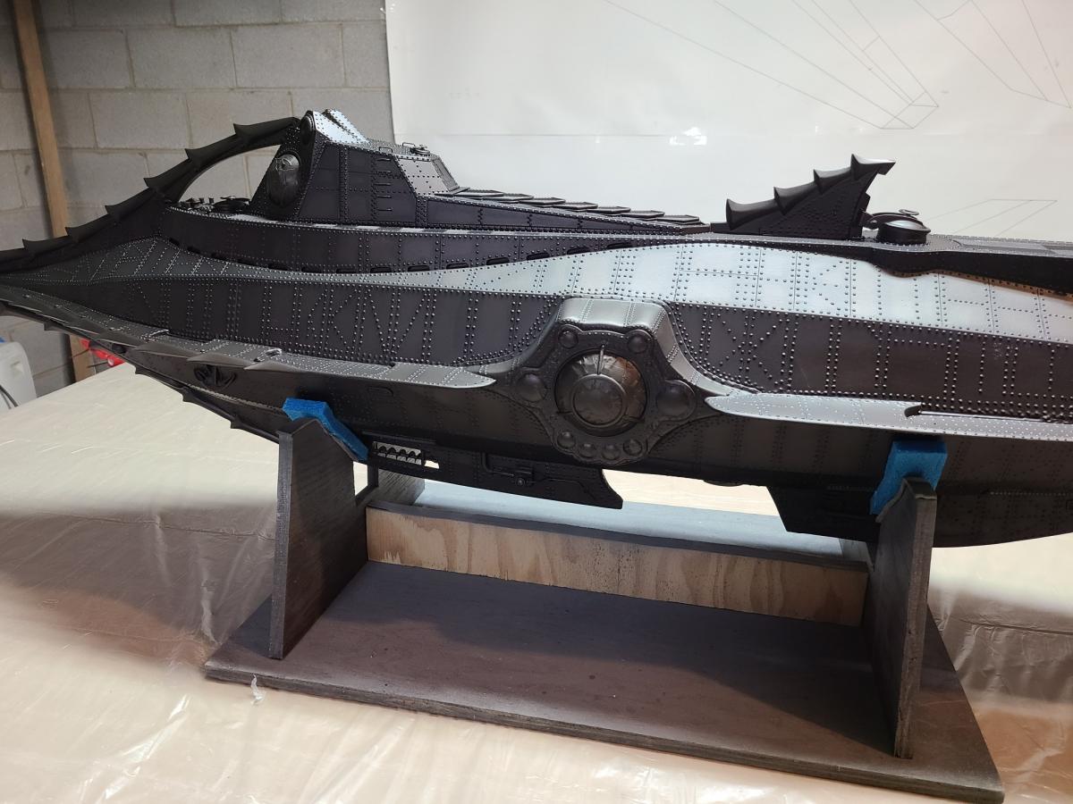

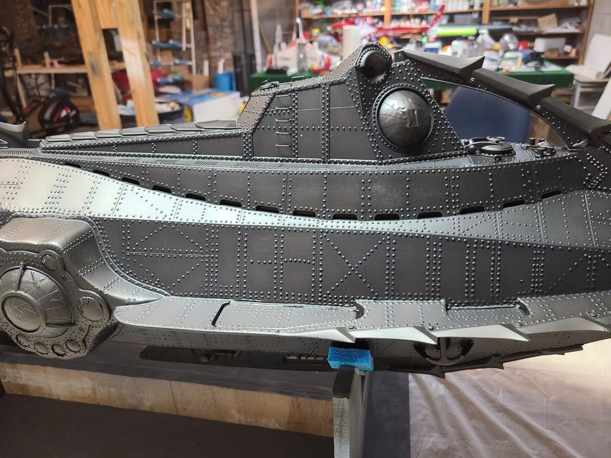

      Some airbrush work to accent rivets and panel lines with flat black. Then a light coat of Krylon flat clear acrylic and she is ready for rusting. I will be applying the Modern Masters Metal Effects oxidizing iron paint for the first time so I am anxious to see how it turns out but I have heard good things about it.
      Click image for larger version  Name:	20200423_003235_copy_2016x1512.jpg Views:	0 Size:	123.7 KB ID:	250887
      Click image for larger version  Name:	20200423_003317_copy_2016x1512.jpg Views:	0 Size:	177.8 KB ID:	250888
      Click image for larger version  Name:	20200423_003352_copy_2016x1512.jpg Views:	0 Size:	146.0 KB ID:	250889
      Click image for larger version  Name:	20200423_003330_copy_2016x1512.jpg Views:	0 Size:	145.8 KB ID:	250890

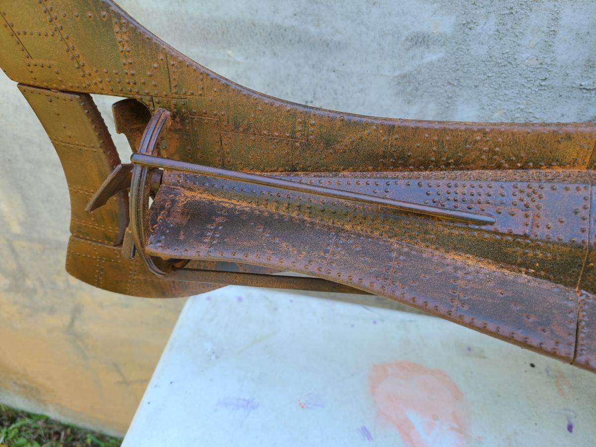

                  #28

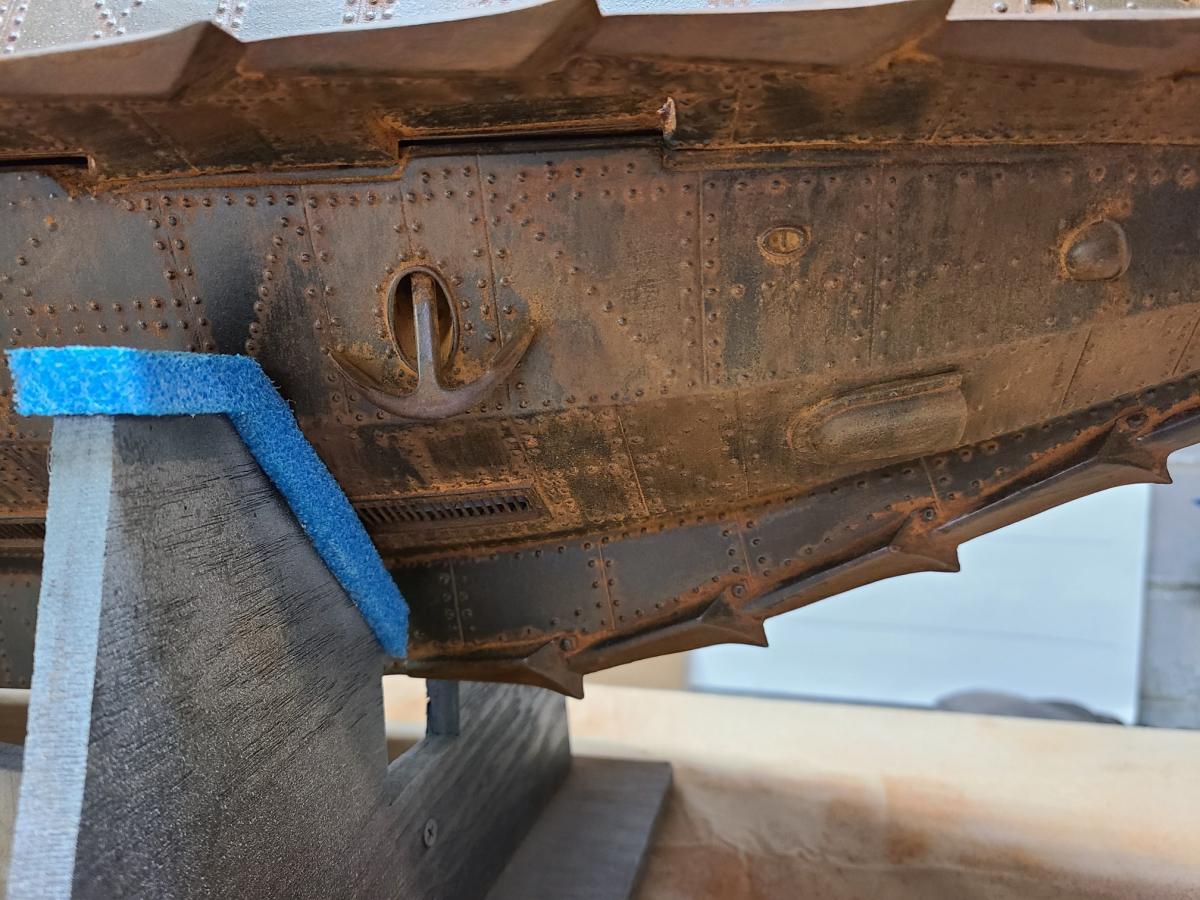

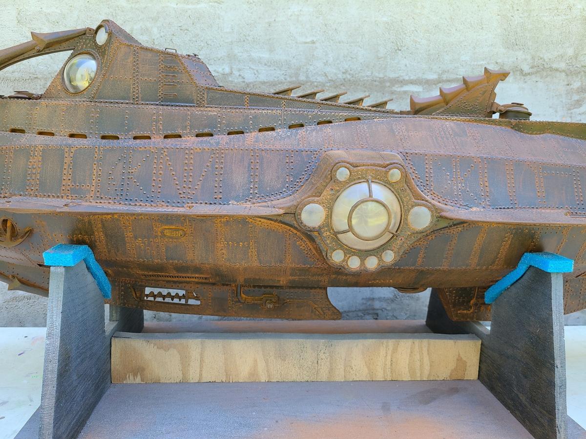

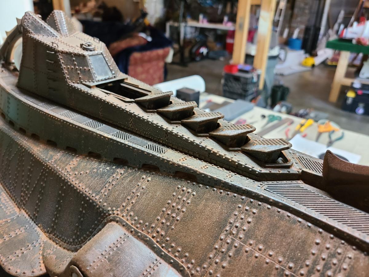

                  OK, you're crazy! The rusting process has begun. This is just after the second application. It is going to look really good when finished. Much of this will get wiped off after it dries completely. It will likely take several days to complete because of drying time.

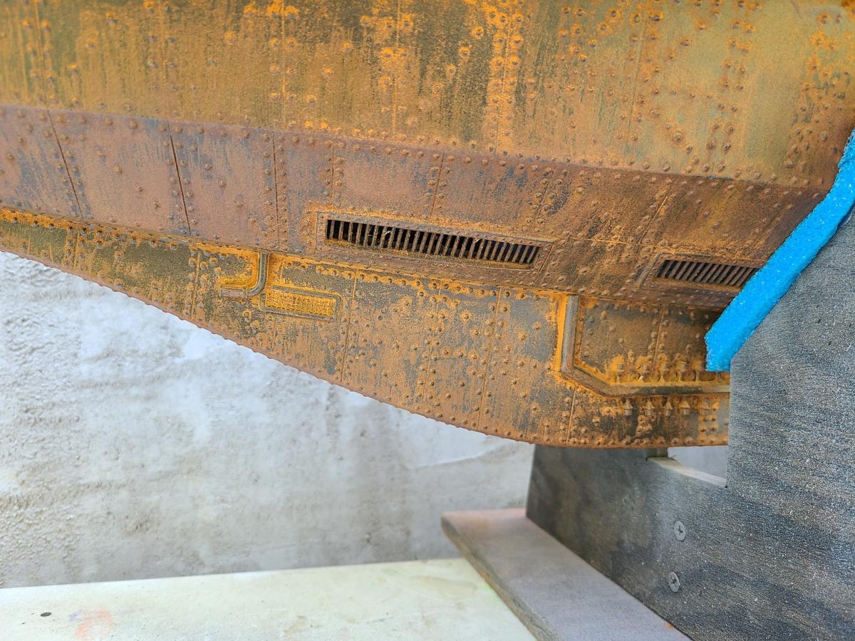

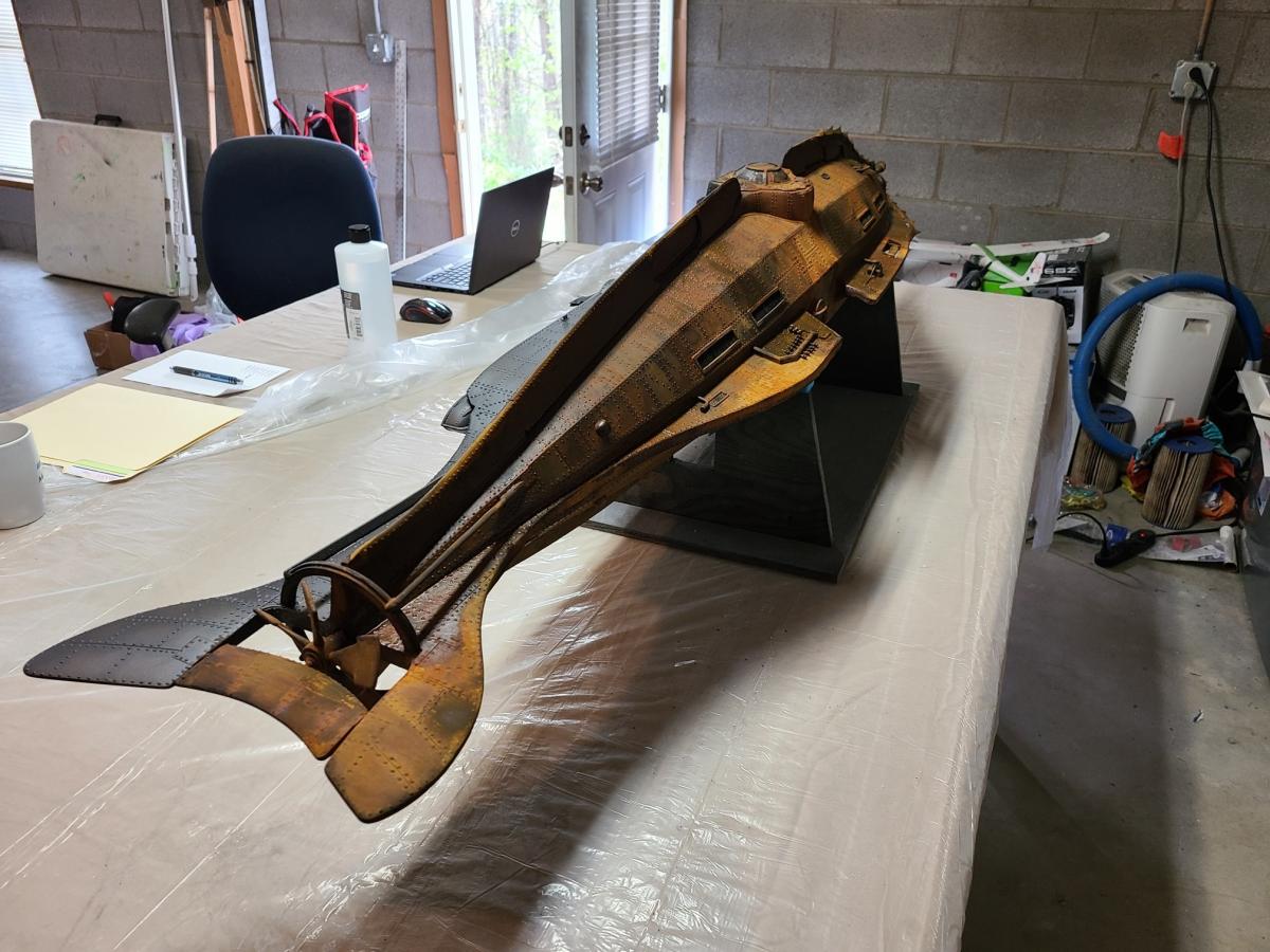

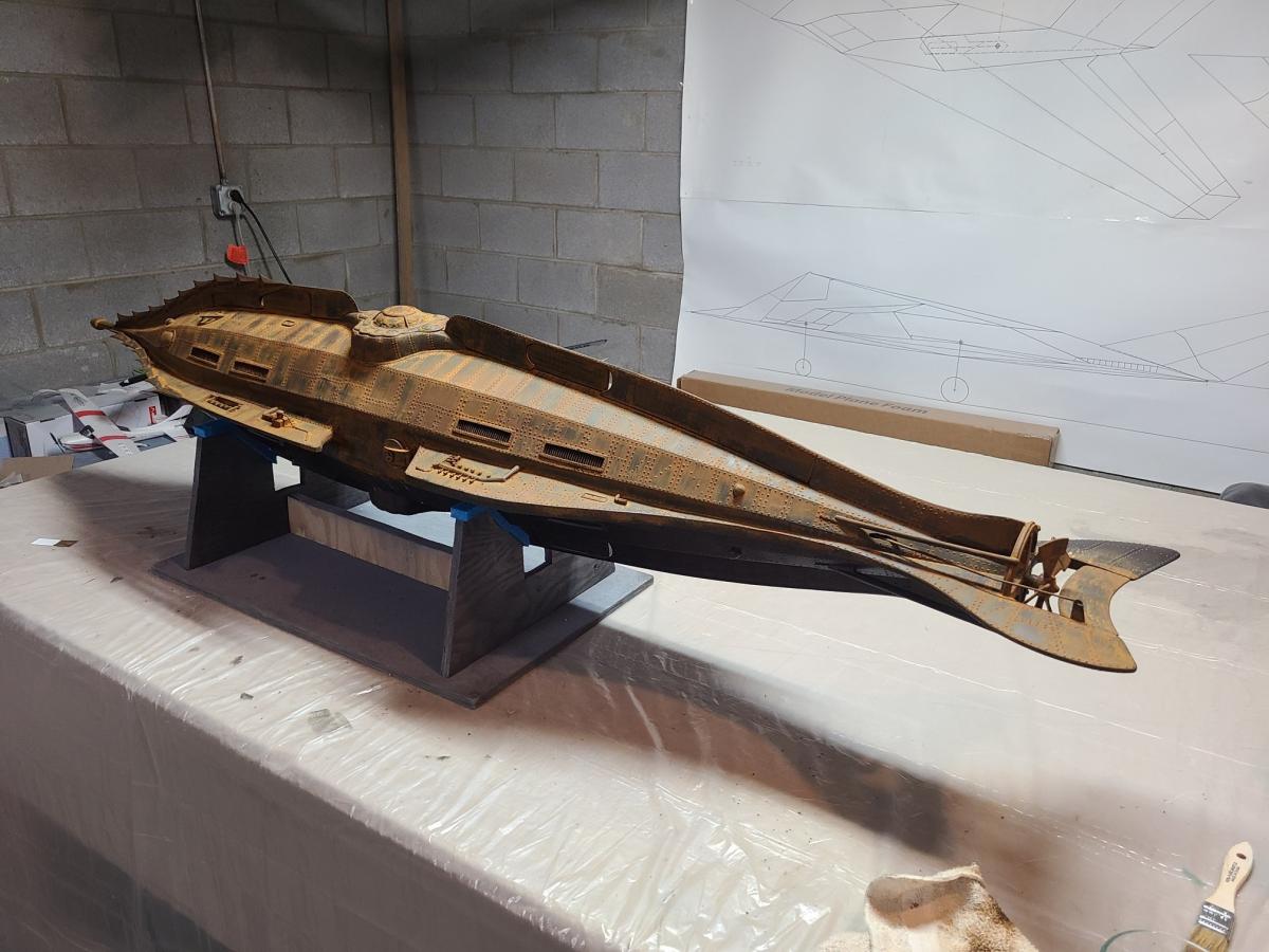

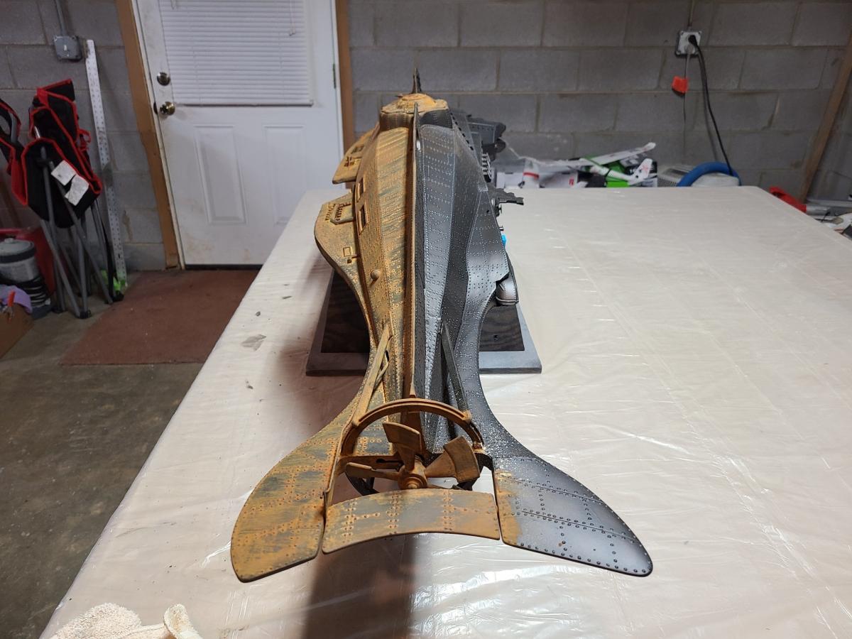

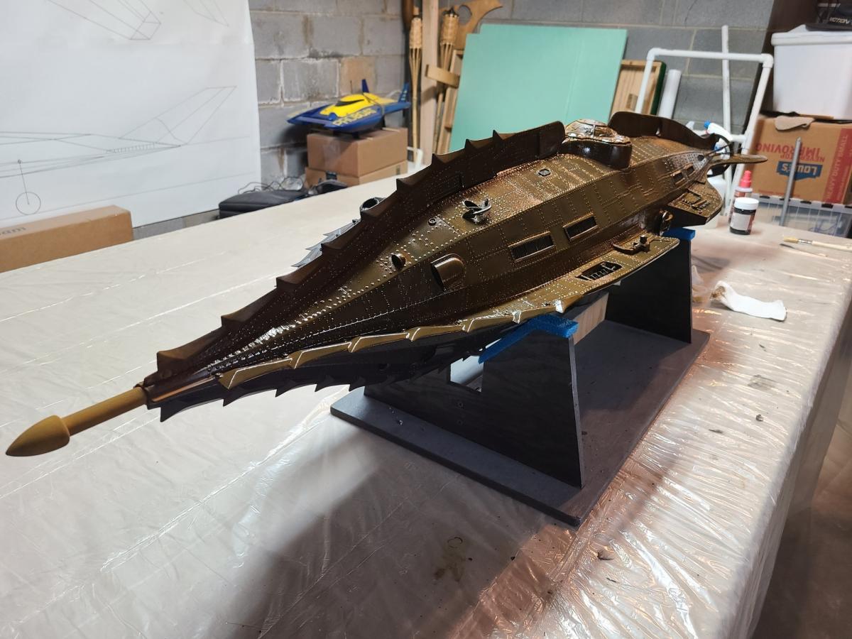

                    #29

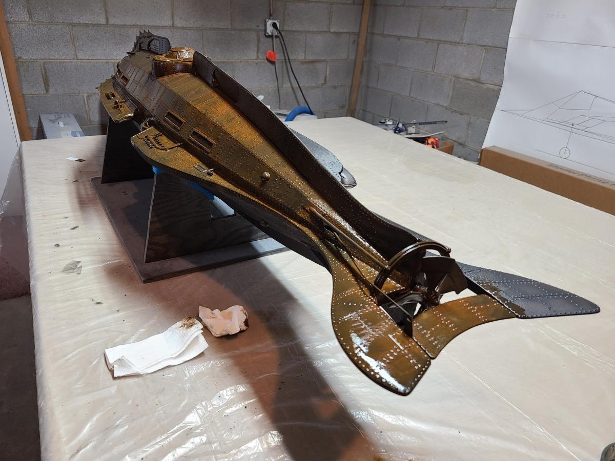

                    One quarter has now been rusted and wiped down. The clear coat will darken it a bit when applied. This rusting product works really well. It is real rust. In the first photo you can definitely see a before and after.
                    Click image for larger version  Name:	20200423_233137_copy_2016x1512.jpg Views:	0 Size:	120.6 KB ID:	251081
                    Click image for larger version  Name:	20200423_233122_copy_2016x1512.jpg Views:	0 Size:	129.2 KB ID:	251082
                    Click image for larger version  Name:	20200423_233115_copy_2016x1512.jpg Views:	0 Size:	125.7 KB ID:	251083
                    Click image for larger version  Name:	20200423_233107_copy_2016x1512.jpg Views:	0 Size:	115.3 KB ID:	251084
                      #30
                      It looks great, Steve! No surprise, coming from you!
                      What product are you using for the rust?
                      Back when I used to build large scale warships, I used the following recipe to make my own rusting solution. Like your product, it too ended up being "real rust", with chunks and other bits that concentrated particles and hues into a convincing glop that I'd work into crevices and panel lines:
                      1) Glass jar, "standard" size for peanut butter and jelly sandwiches. Eat all jelly and sandwiches first.
                      2) Fill 1/4 of the jar with #00 steel wool that you have crinkled into small spheres.
                      3) Fill 1/8 of the jar with #0000 steel wool. It is best if you intertwine the #00 steel wool with the #0000 steel wool.
                      4) Fill 1/4 of the jar with hydrogen peroxide
                      5) Add a capful or two of vinegar
                      6) Add in a tablespoon of dirt or muddy clay
                      7) Avoid filling the bottle more than 2/3 full
                      8) Leave the bottle in the sun for an afternoon. If you're impatient, add more vinegar and a pinch of table salt and stir the mixture up well.
                      9) Unscrew the cap and don't inhale too deeply. Stir and gently mash with a blunt chop stick to further break down the rusted steel wool into smaller particles
                      10) You've essentially created a bottle of self-contained all-natural oxidation. Tint with food coloring as desired. Apply like a thick paint, a little goes a long way. Most importantly, let it fully dry and SEAL IT before touching it.
                      Tinting with colored potato flour, [expensive] modeler dry pigments, natural dirt, or food coloring results in an infinite range of colors.
                      Best of all, it's cheap.
                      If your rust is on the lighter (fresher) side of the tonal spectrum, try applying it over a darker rust painted layer that was applied with the hairspray technique or gauze technique. Real rust layered over darker simulated rust is next level.
                        #31
                        This is a Rustoleum product called Modern Masters Metal Effects Oxidizing Iron paint. It is thick. I diluted it down at least 50/50 with some water and brushed it on. It says to apply two coats then spritz on the accelerator it comes with. I found a pump cap that fit the bottle but they also sell one for it. Wait 5 minutes and spritz again then let it sit. In about an hour it will start to show rust. It gets heavier as it dries. Maybe apply additional paint as needed and accelerator until desired effect is achieved. Once dry I then wiped it off with a cloth and downward motions to expose some of the base paint. Creates a very realistic look. It takes time but very effective. I ordered it from Amazon.

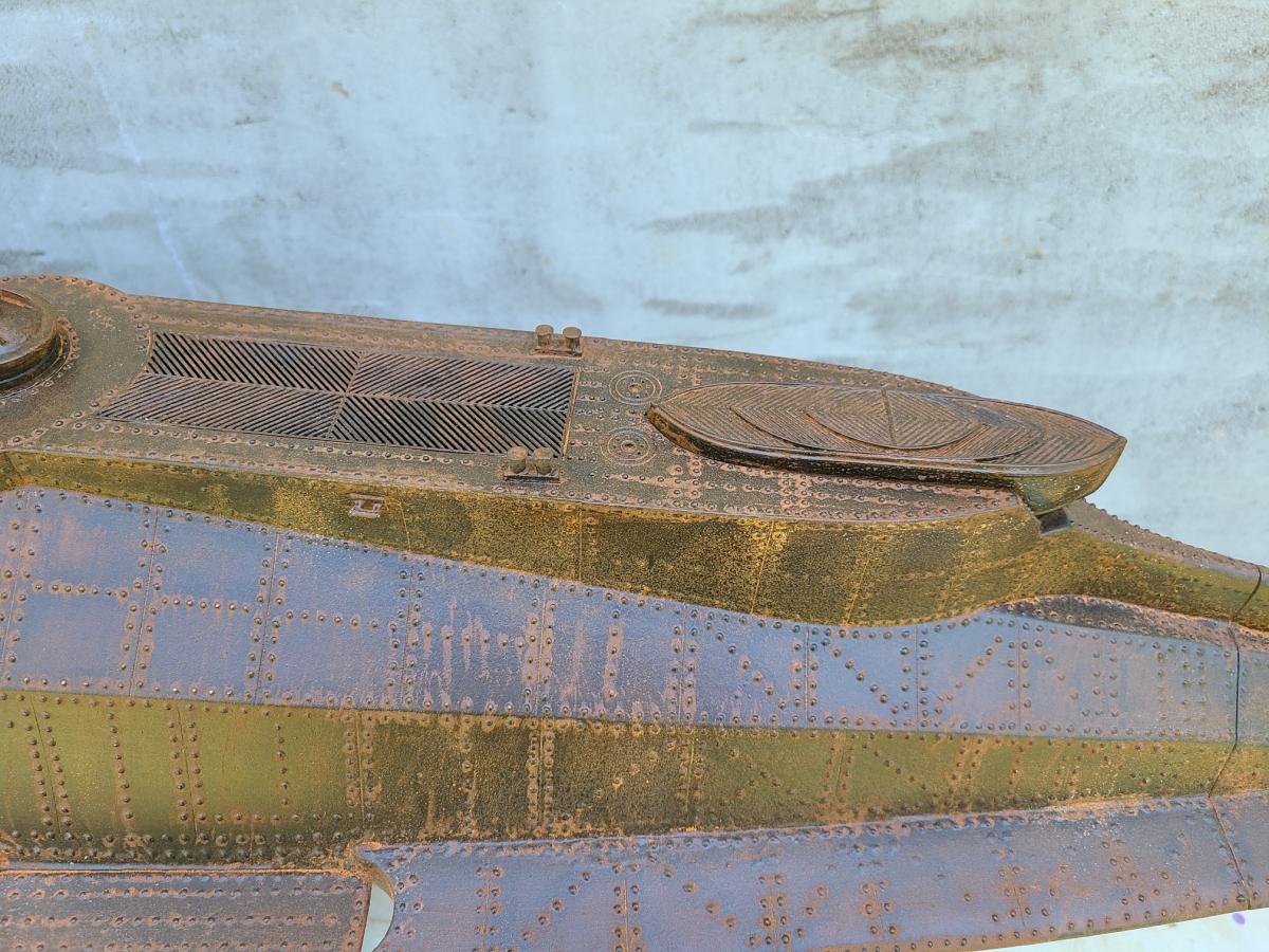

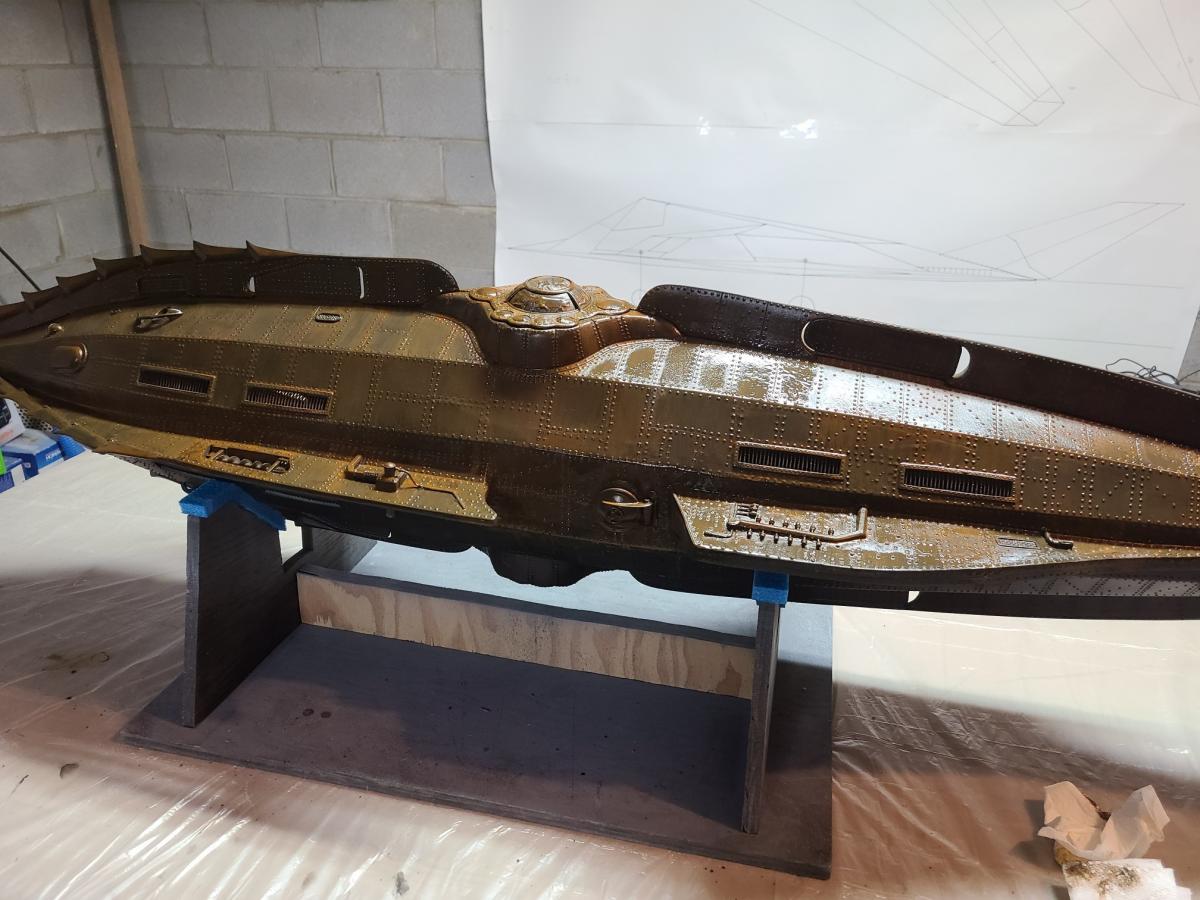

                              #34

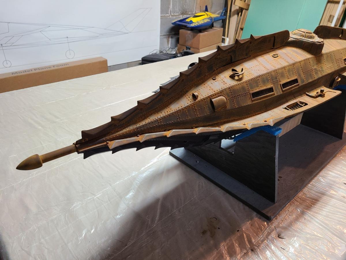

                              It is almost mesmerizing to watch it change....

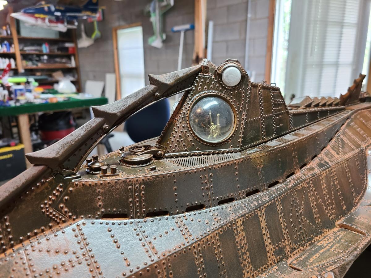

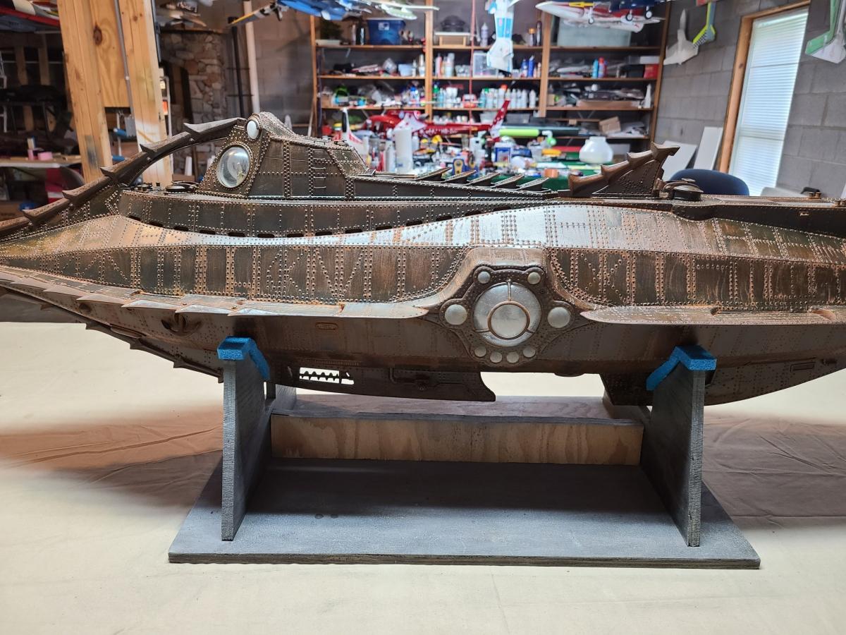

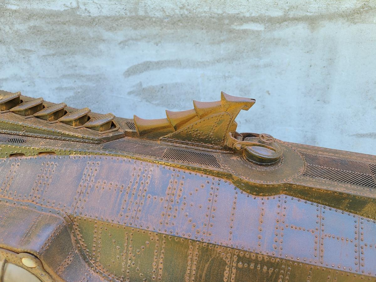

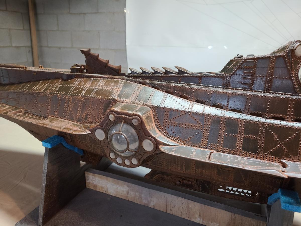

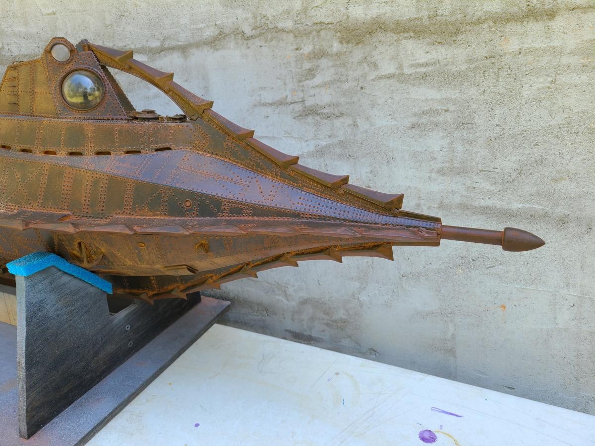

                                  Paint work is basically done. Applied a light coat of Krylon clear Satin acrylic.

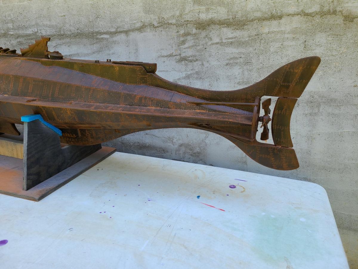

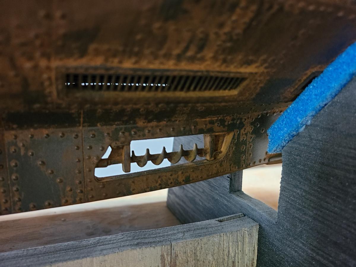

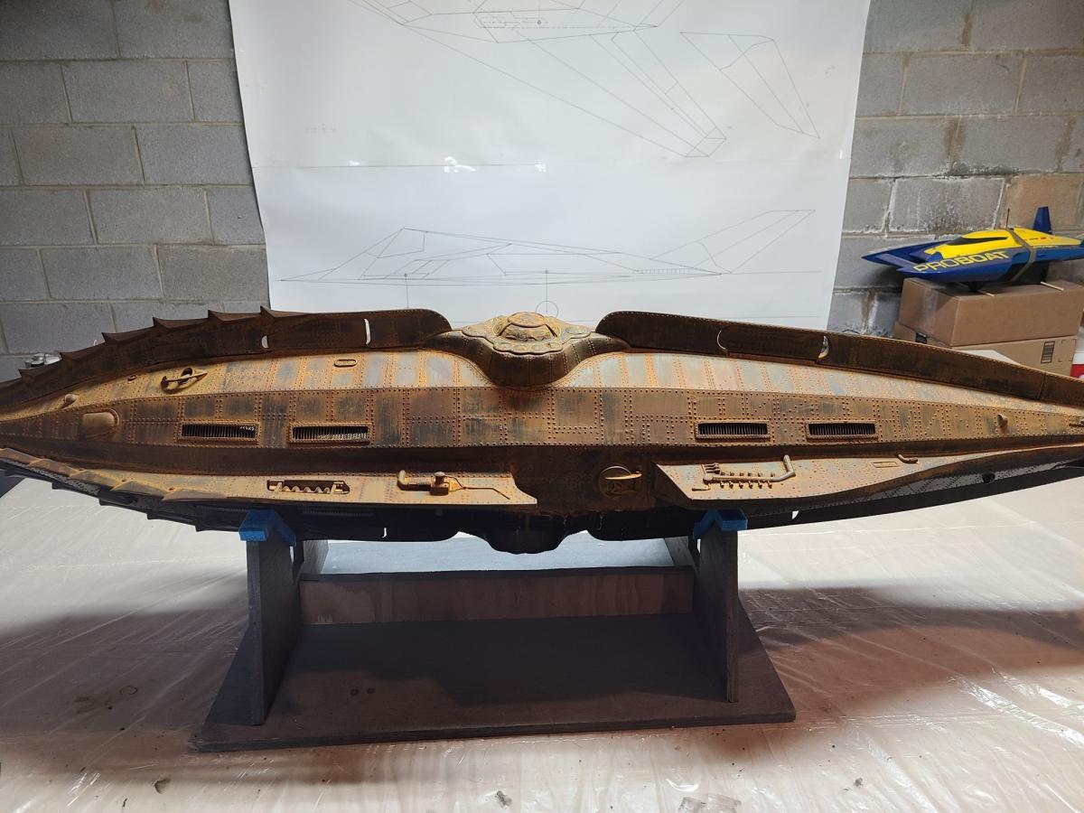

                                    #37

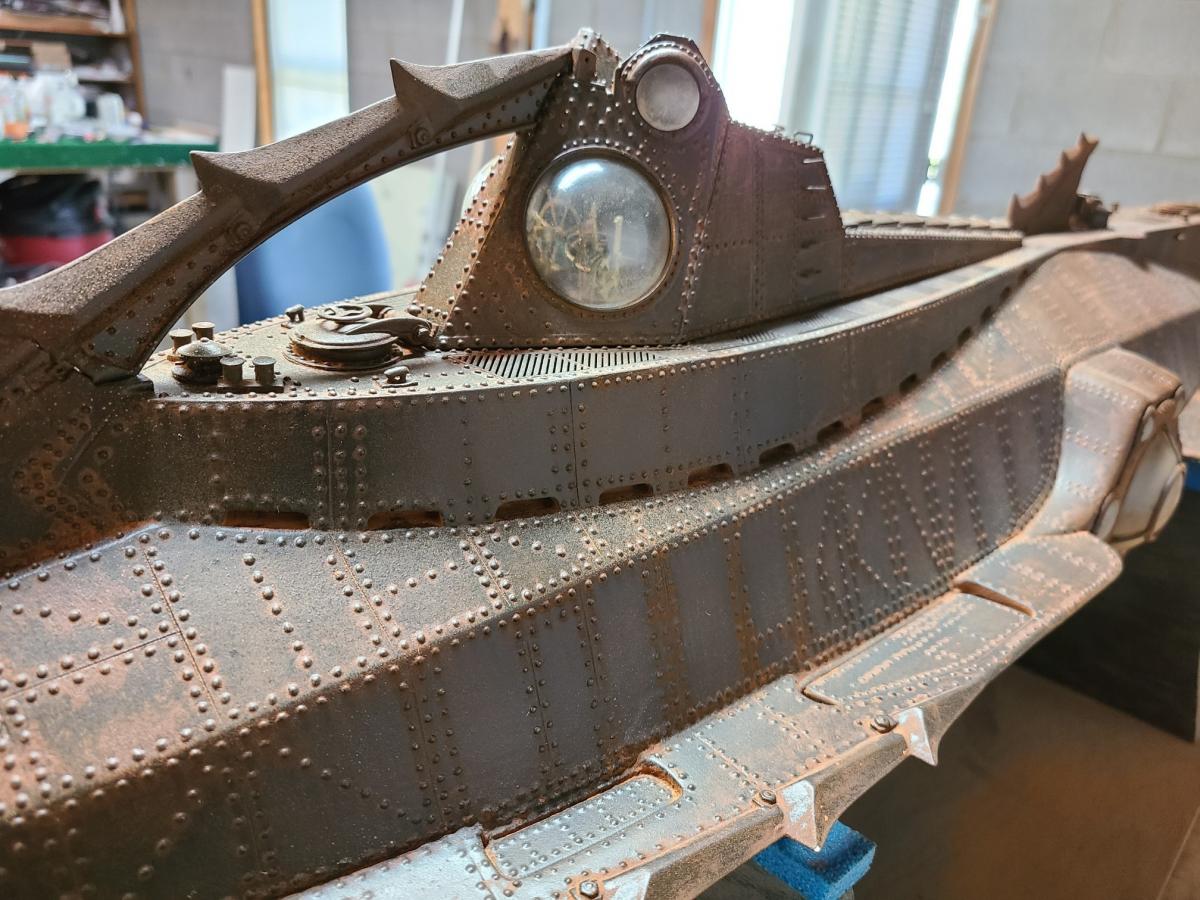

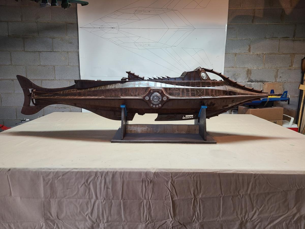

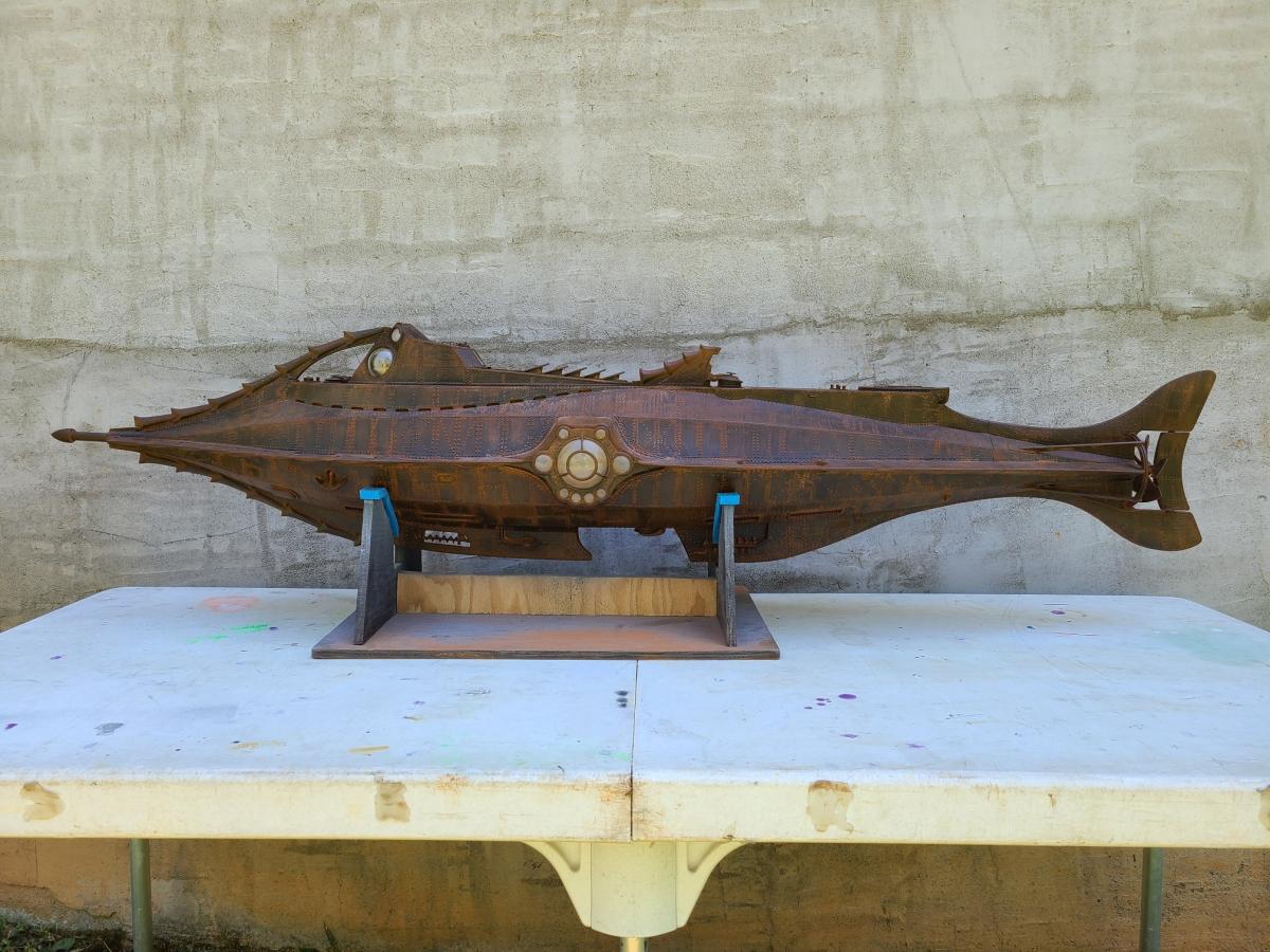

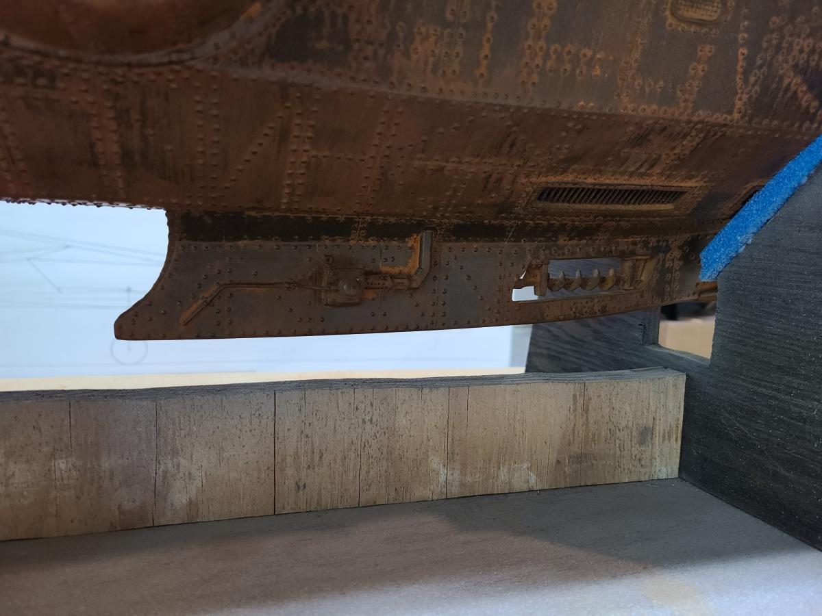

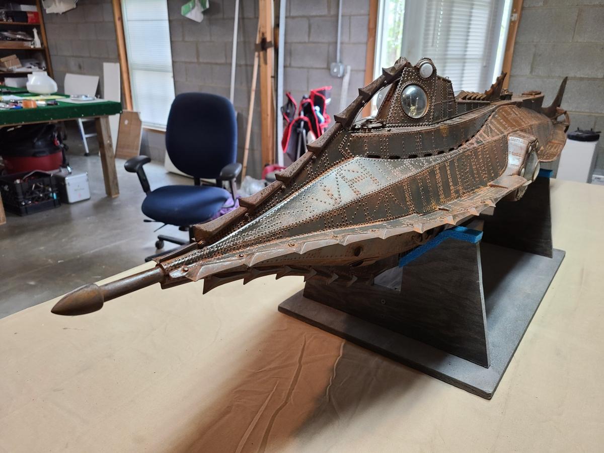

                                    So after looking at it for a couple days I decided to tone down the sheen a bit but even with a clear coat of matte over the Modern Masters Metal Effects paint it looked too contrasting between the bronzy base paint and the rust effects so I dusted the entire model with some Vallejo old rust powder pigment and then gave it another very light coat of clear matte. It was just what it needed. I couldn't be more pleased now with how it looks. The thing looks friggin' awesome now so on to the running gear.
                                    Click image for larger version  Name:	20200427_115555_copy_2016x1512.jpg Views:	0 Size:	155.5 KB ID:	251647
                                    Click image for larger version  Name:	20200427_115659_copy_2016x1512.jpg Views:	0 Size:	180.0 KB ID:	251648
                                    Click image for larger version  Name:	20200427_115813_copy_2016x1512.jpg Views:	0 Size:	111.0 KB ID:	251649
                                    Click image for larger version  Name:	20200427_115835_copy_2016x1512.jpg Views:	0 Size:	148.9 KB ID:	251650
                                    Click image for larger version  Name:	20200427_115924_copy_2016x1512.jpg Views:	0 Size:	116.3 KB ID:	251651
                                    Click image for larger version  Name:	20200427_131647_copy_2016x1512.jpg Views:	0 Size:	203.3 KB ID:	251652
                                    Click image for larger version  Name:	20200427_131252_copy_2016x1512.jpg Views:	0 Size:	160.8 KB ID:	251653
                                    Click image for larger version  Name:	20200427_131340_copy_2016x1512.jpg Views:	0 Size:	185.9 KB ID:	251654
                                    Click image for larger version  Name:	20200427_131345_copy_2016x1512.jpg Views:	0 Size:	189.4 KB ID:	251655
                                    Click image for larger version  Name:	20200427_131245_copy_2016x1512.jpg Views:	0 Size:	149.9 KB ID:	251656
                                    Click image for larger version  Name:	20200427_131636_copy_2016x1512.jpg Views:	0 Size:	145.8 KB ID:	251657
                                    Click image for larger version  Name:	20200427_131559_copy_2016x1512.jpg Views:	0 Size:	165.9 KB ID:	251658
                                    Click image for larger version  Name:	20200427_131323_copy_2016x1512.jpg Views:	0 Size:	195.9 KB ID:	251659
