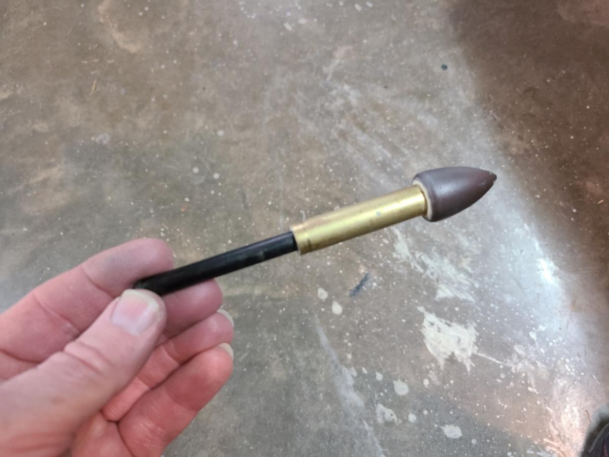

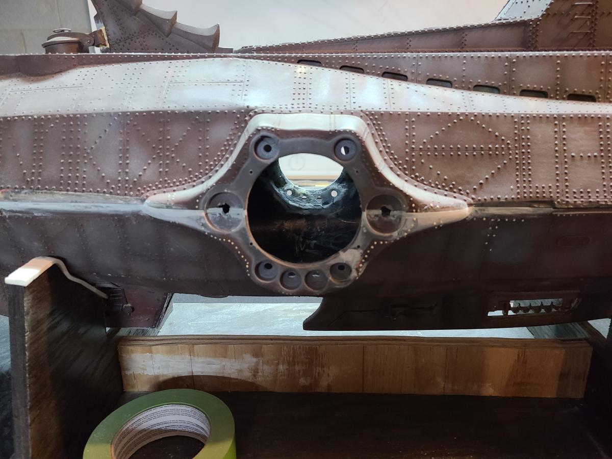

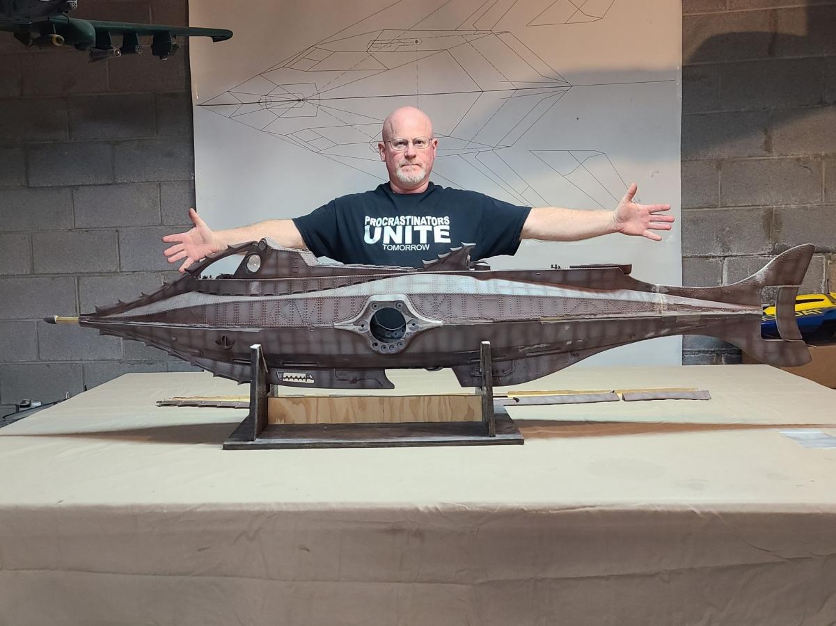

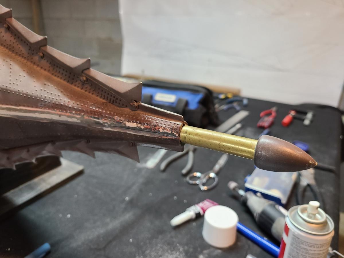

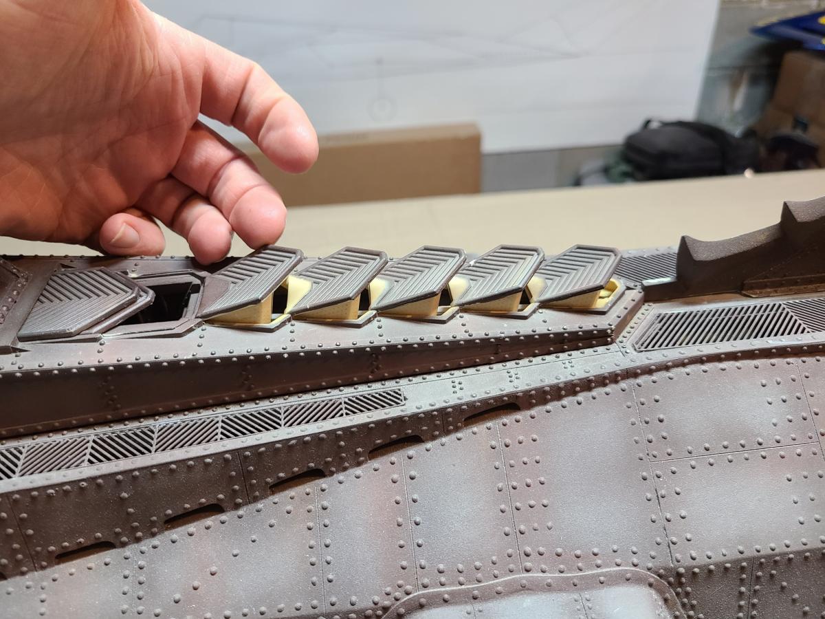

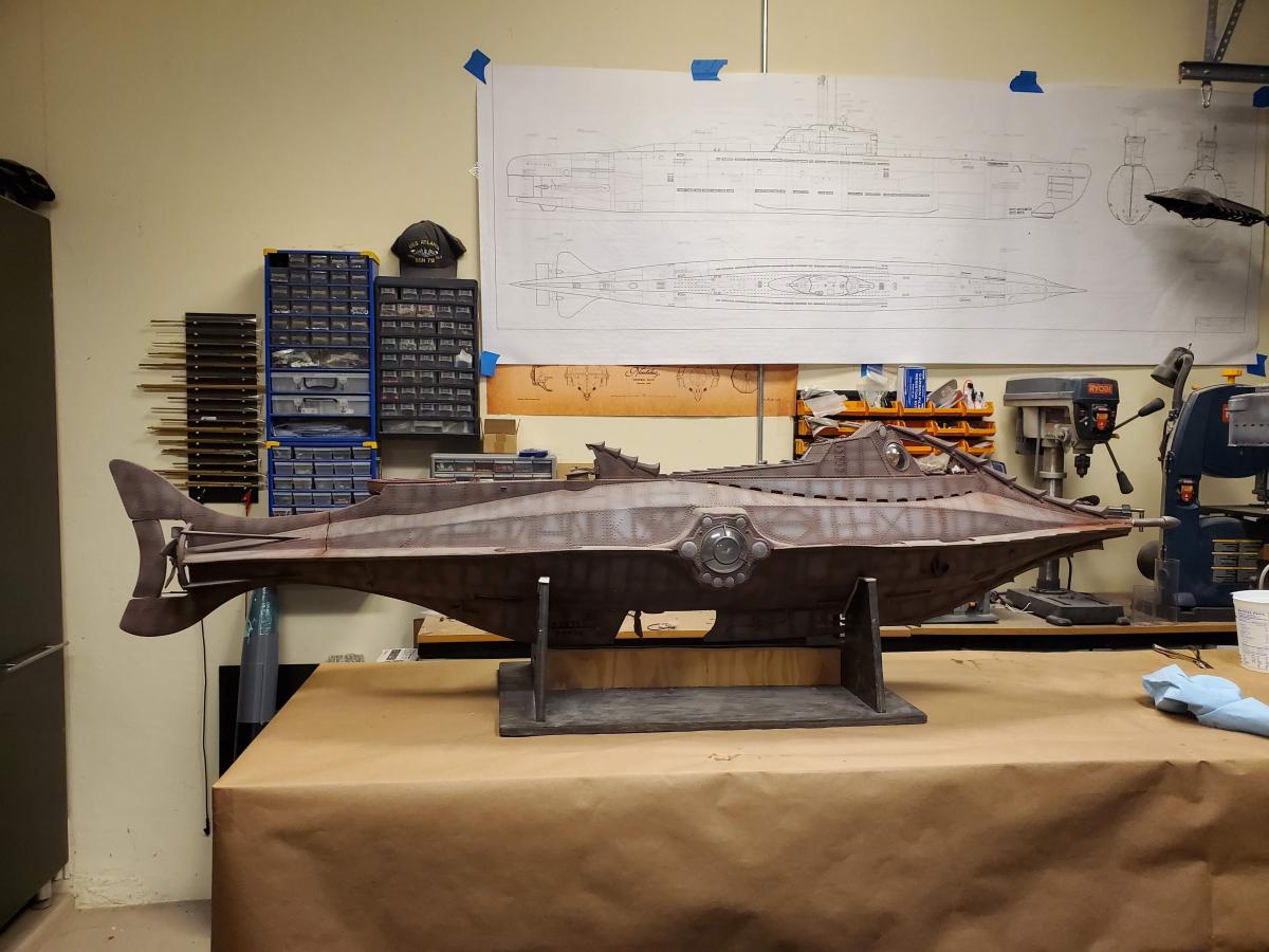

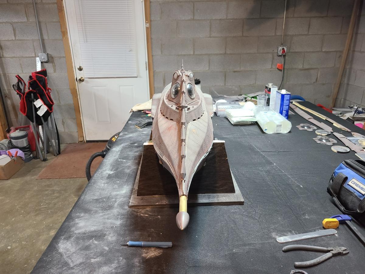

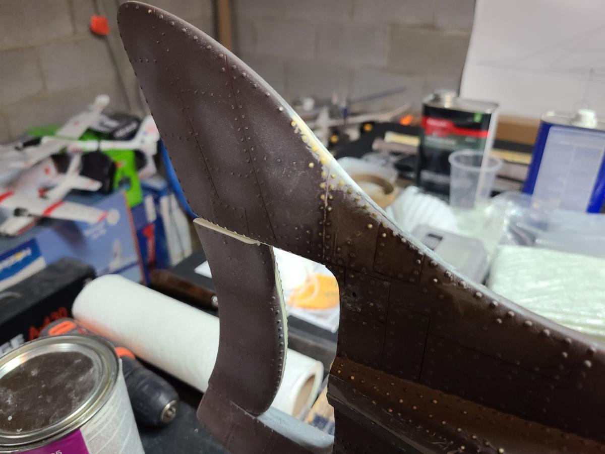

Its a big boat! This has been a dream of mine since I first saw the movie as a kid. When one recently showed up for sale on the Nautilus Drydocks I pounced! I am so stoked! It arrived with some minor shipping damage, nothing too bad. Upon initial inspection it was apparent it needed some TLC. I pulled the rakers off and the interior bulkheads out first thing. Reworked the ram based on how Bob did it on the 1/77th build, the rudder needed to be slightly shortened and the vertical fin straightened a bit. The breather vents were glued down but I have since reworked them to open and close. The biggest challenge was the fit of the top and bottom halves. There was some pretty serious warping going on. To correct it I added some brass alignment tabs to the top half and then did some serious bondo work to fill the worst of the gaps. A heat gun helped a lot too. I cleaned up the inside with a Dremel sanding drum and removed a lot of mold flashing that was on it and wherever I did some fill work I had to come back and add the rivets that got sanded off. It looks so much better now. I have the ballast tanks and one of the water tight boxes already. Most of the remaining parts have been ordered. Once I get the parts to redo the propeller pitch movement I will be able to put the rakers back on it. I plan to rework it the way Bob did the 1/77th. Going to put a brushless system in it and a modular sub system.. This thing is crazy detailed and is going to be so awesome when finished. I found out a little of this boats history. Apparently it was run over by a UPS truck and repaired by the guy responsible for making Spock's ears and the creatures in Gostbusters. He sailed it for years as his own personal boat.

I just scored a very rare (no longer made and just a few left in the world) 1/35th replica of the iconic Nautilus from the 1954 Disney movie 20,000 Leagues Under the Sea. The boat is 66" long and comes with a detailed wheel house, lights and photo etched deck grating. I will be rigging it for RC. I loved the movie as a kid and still do. This has been on my bucket list for a very long time so I am super stoked! It needs some minor TLC but overall is in really good condition. More photos to come once I have possession of it.
