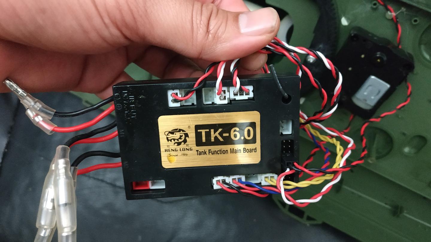

    i have an m1a2 abrahams pro wich i ran for 3 weeks got upgrade bug and have put blue motors in i have from my sherman mf wiring instructions but unfortunately i carnt identify colours of the wires does any body have a photo or diagram wich clearly identify colours of the wires coming down from the turret to mfu.

    Two tanks Welcome to Hobby Squawk, TwoTanks! Please see the attached photo showing the correct port locations for the corresponding colored wires on one of my TK6-equipped tanks. I hope this helps!

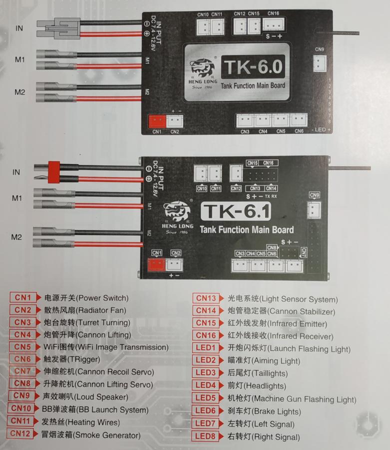

      Two tanks Here's a photo I took of the diagram itself, which may me more clear than my other photo of the wiring.

        Thank you for your help you made connecting back up much easier what i found more supprisng,when connected motors in the same ports originally i had forwards as backwoods and left was right . I had to reverse black and red and put motor one into two and two into one but she is running quite a bit faster good main battle tank speed.

          What is meant by LED 2 "Aiming Light"? Is that for tanks with a search light?
          • Rubicon99
            • 3316
            More or less yes.
