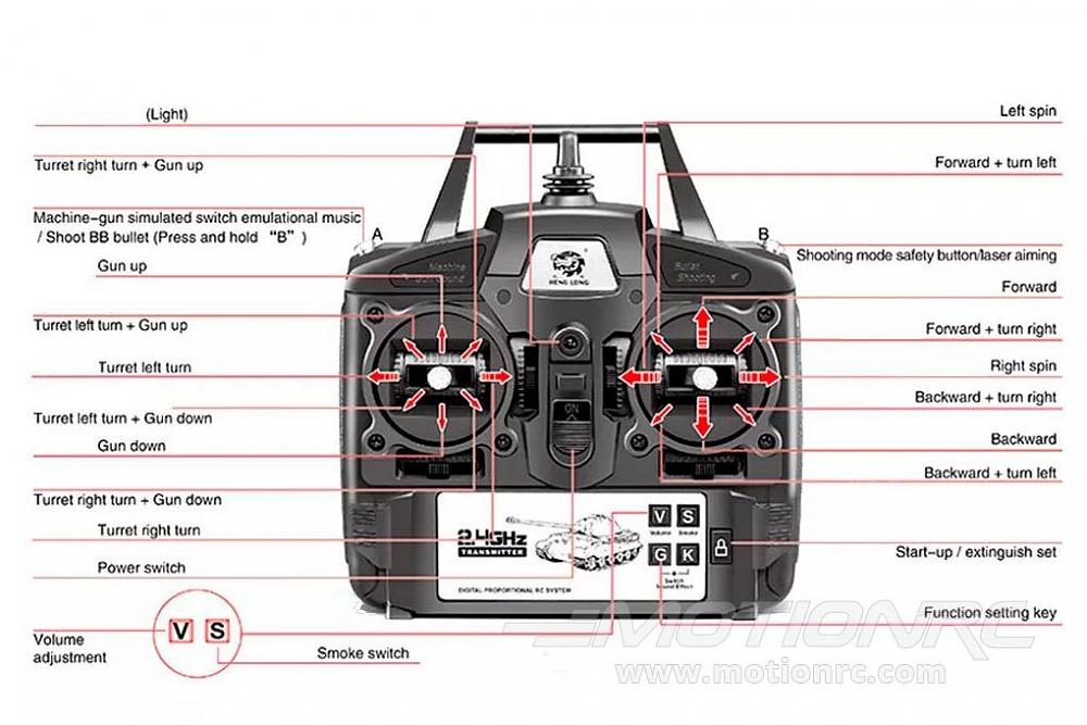

9) Press the "Lock" button on the far right of the radio. The tank will roar to life!
10) Press the "S" smoke button to turn smoke on and off. Note that it may take a minute or so for the smoke to heat up.
11) Press the "V" volume button several times and observe how each press makes the volume louder and louder, until it turns the sound off, then begins the cycle again. Select a volume you like.
12) Press the "G" and "K" buttons at the same time to cycle through four different sound sets. Leave it at the sound set you like, the radio will remember this setting the next time you turn the tank on. You can reset it at any time.
13) Press the "K" and "S" buttons at the same time as proscribed in the manual at the same time to cycle through the four levels of track recoil.
14) Press the machine gun button and verify that the machine gun sound and LED fires.
15) Hold down the machine gun button and press the shooting button at the same time to toggle the Airsoft firing sequence. You don't need to have an Airsoft BB loaded. Note, always point the barrel away, just in case there is still a BB in there from the factory testing.
16) Drive the tank forward and back with the right stick forward and back, and turn right and left with the right stick left and right. Notice that all the controls are proportional, meaning that you can do them slowly or quickly. See how in our videos, I am able to coordinate both sticks with differing speeds of input. That kind of precise control will come with practice. For now, just move them in all directions to verify the tank drives and turns in all directions. See the manual for how to fine-tune the radio settings for acceleration curve, sensitivity, max speed setting, etc.
17) Maneuver the turret with the left stick: Left and right traverse the turret left and right, and up and down elevate/depress the barrel up and down. Note, when you hear the "clack, clack, clack" sound, that means the turret or barrel has reached its endpoint. Cease giving it that control input.

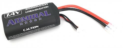

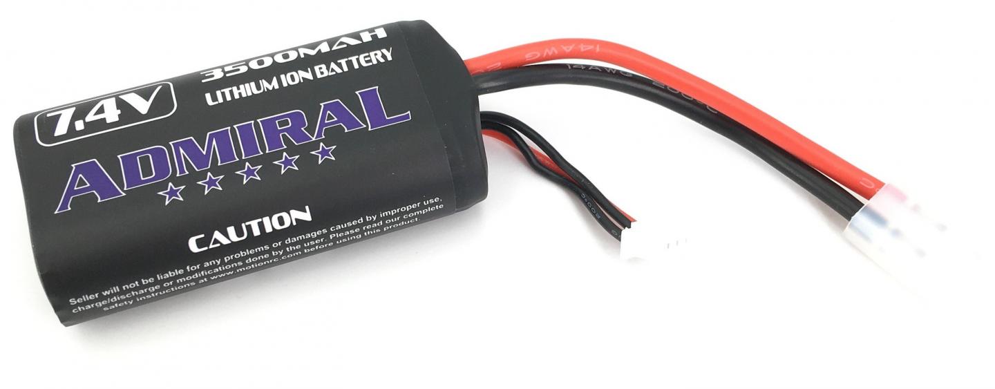

4) UPGRADE BATTERY
RC tanks, trucks, cars, etc in this category include RTR (Ready to Run) batteries. I've had good experience with them, probably because I don't run them into the ground. That being said, we also recognize that part of the fun with RC Surface vehicles is upgrading and hop-ups above the stock factory equipment, so we also brought in a new 2s 7.4V Li-Ion battery using imported Sanyo NCR 18650 cells from Japan. These will fit in *ALL* Heng Long tanks (they're essentially the same dimension as the case-less 18650 battery in the T-90 and T-72).
Compared to the stock battery, the upgrade battery not only nearly doubles the capacity (3500mAh vs 1800mAh), but they're also made of higher quality NCR cells from Japan.
These are in stock now and ready to ship HERE.

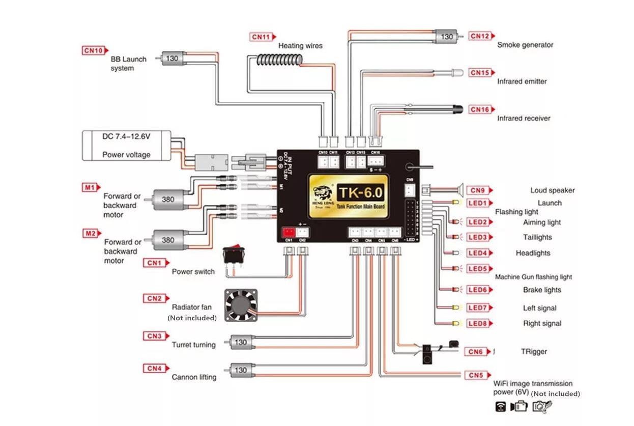

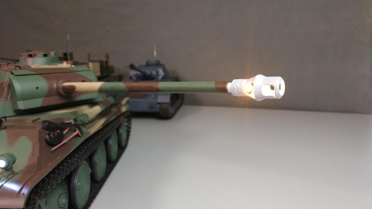

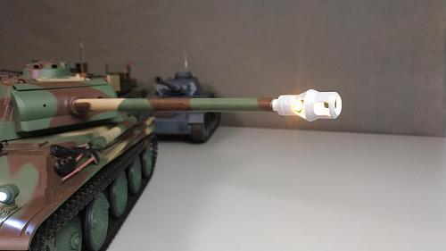

6) How to add LED "Barrel Flash"
One of the benefits of the TK6.0 MFCB is that out of the box it has six unused LED ports. Port #1 flashes for a split second whenever the main gun is fired. Wiring an LED into the barrel's muzzle brake, therefore, provides a satisfying flash in sync with the cannon firing sound and the track recoil. Doing this bypasses the airsoft BB firing action, of course, but I have enough tanks with that function. The inner diameter of the tank barrel is just over 6mm or so. So, a 5mm Amber LED works well. Disassemble the turret, insert the LED's wires in through the muzzle of the barrel, feed the wires into the barrel, through the breech, and down into the hull, where you plug them into LED Port 1 (called "Launch Flashing Light" in the wiring diagram below), then clip and twist or solder together the Channel 6 wires (called "Trigger" in the wiring diagram below). This will enable the LED to flash instantly as soon as you fire the main cannon. There is now no delay --the firing sound, track recoil, and LED flash are all synchronized together. Reverse the process to reassemble the tank. You're done!
7) WIRING DIAGRAM
Here is a wiring diagram that applies to all TK6 tanks from Heng Long. A printed copy is included in the instruction manual of every Tank.

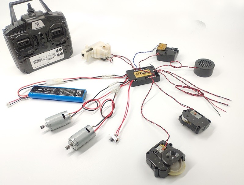

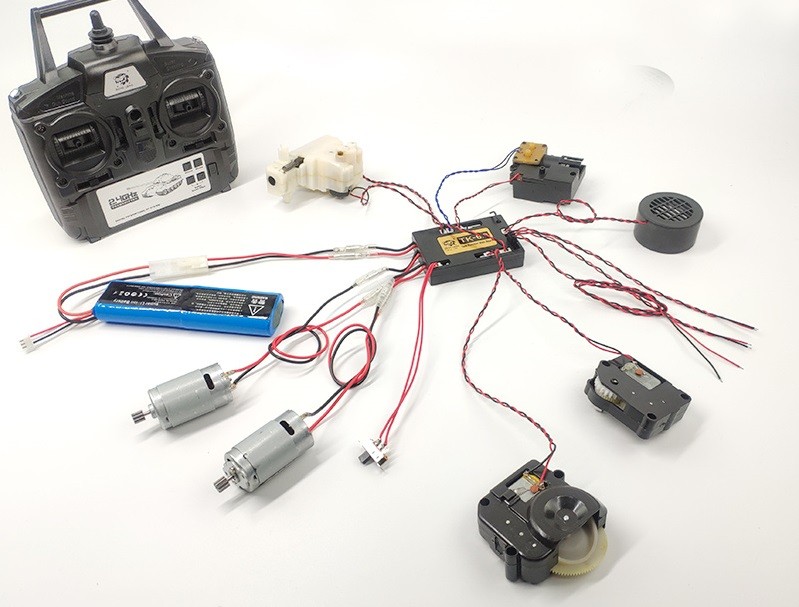

8) COMPONENT LAYOUT
Here are the major electronic components of your Heng Long TK6 tank.
