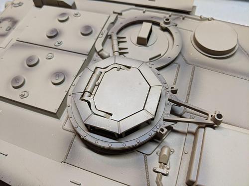

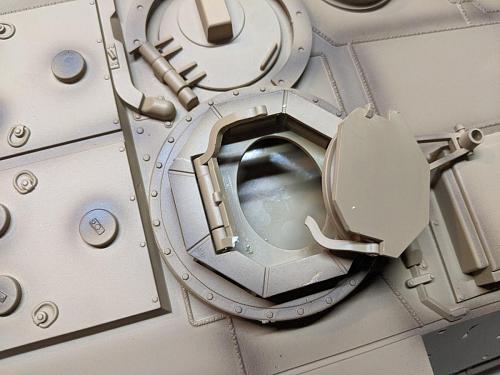

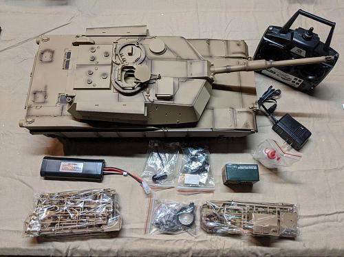

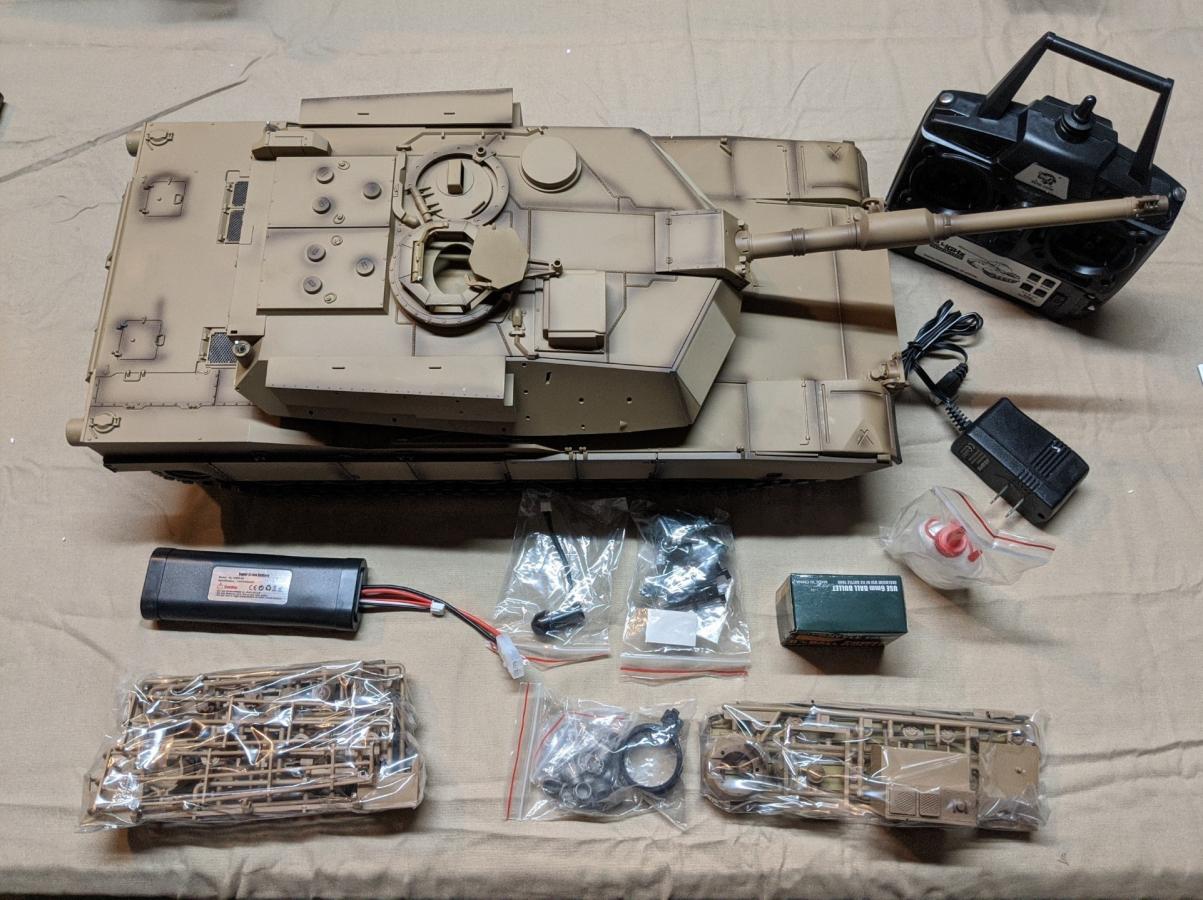

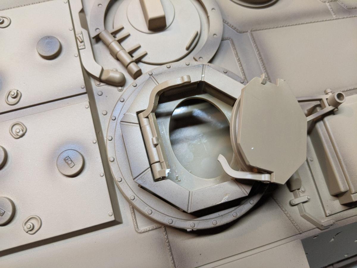

    Any Abrams Pro drivers out there feel free to post up your impressions and pictures. Mine arrived today and it is definitely a heavy rig. The packaging took a serious hit on the rear of the tank which broke the styrofoam. While there was no damage to the back of the tank the hatch was broken. It will be a challenge to fix. Not sure if it can be replaced.
    Click image for larger version  Name:	PhotoPictureResizer_200302_193359239_crop_2592x1944-1944x1458.jpg Views:	0 Size:	111.5 KB ID:	239420
    Click image for larger version  Name:	PhotoPictureResizer_200302_193111640_crop_2552x1944-1914x1458.jpg Views:	0 Size:	83.4 KB ID:	239421

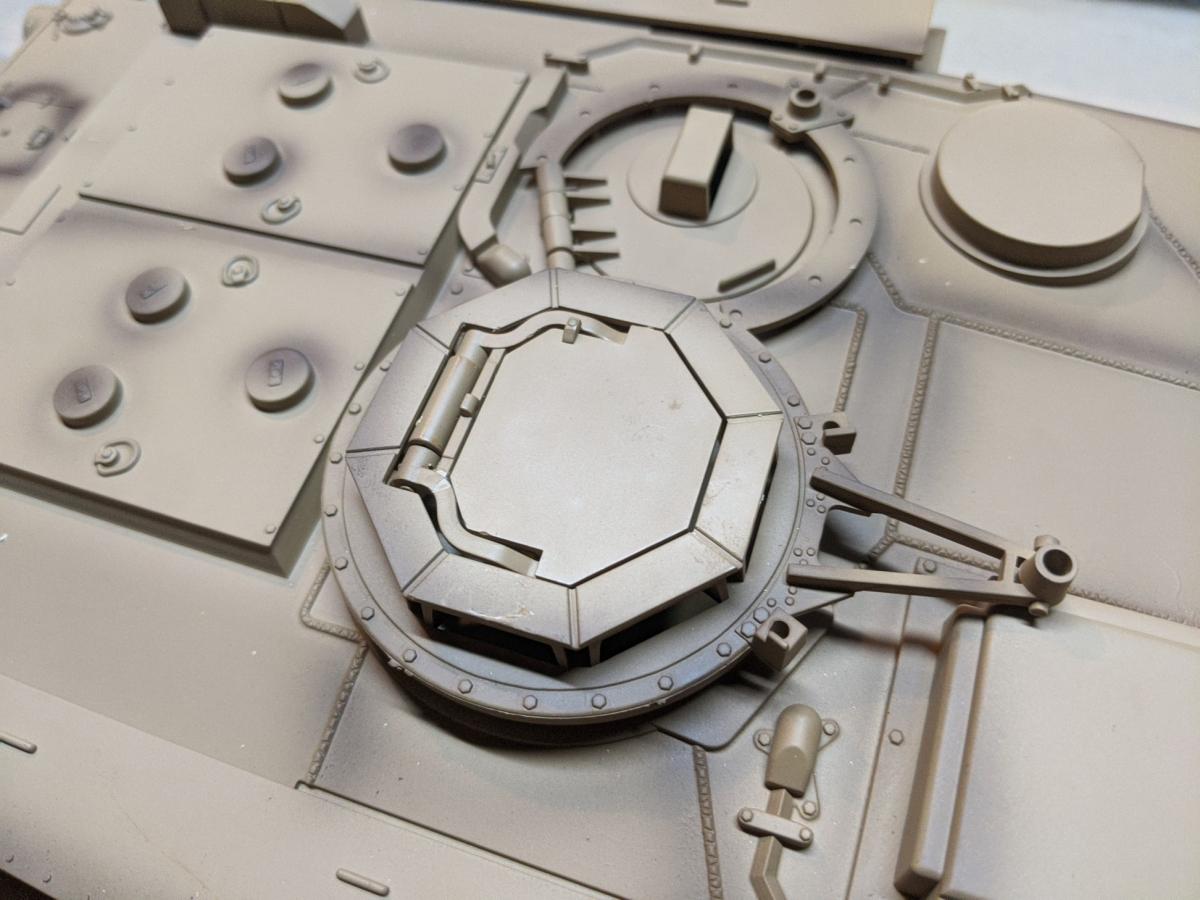

    I will certainly enter a CS ticket to report the incident. Anyway, I plan to post up pics of mine along the way and hope other Pro owners will do the same. Early impressions are that I like the weight of it and aside from the damaged hatch it looks great. There are a lot of extra pieces to add with some pre-painted which is a nice touch. I am looking forward to getting this together and trying it out.
    Click image for larger version  Name:	PhotoPictureResizer_200302_195157612_crop_2565x1920-1923x1439.jpg Views:	0 Size:	152.2 KB ID:	239422

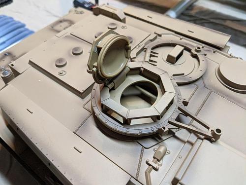

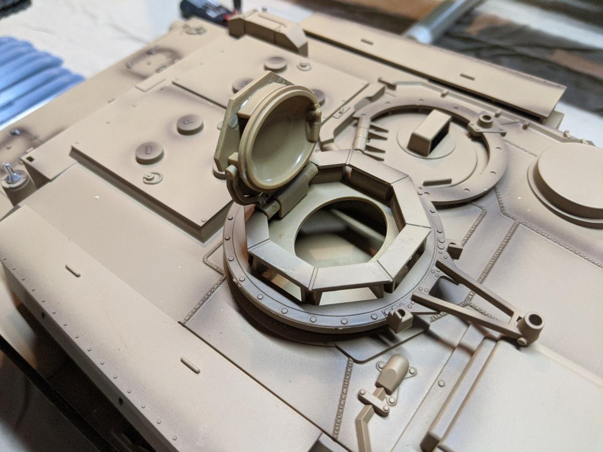

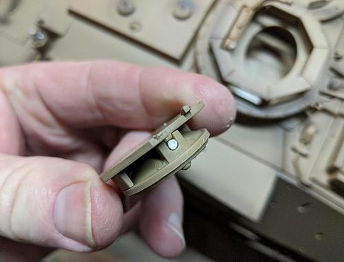

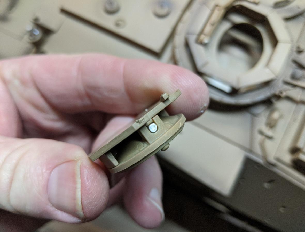

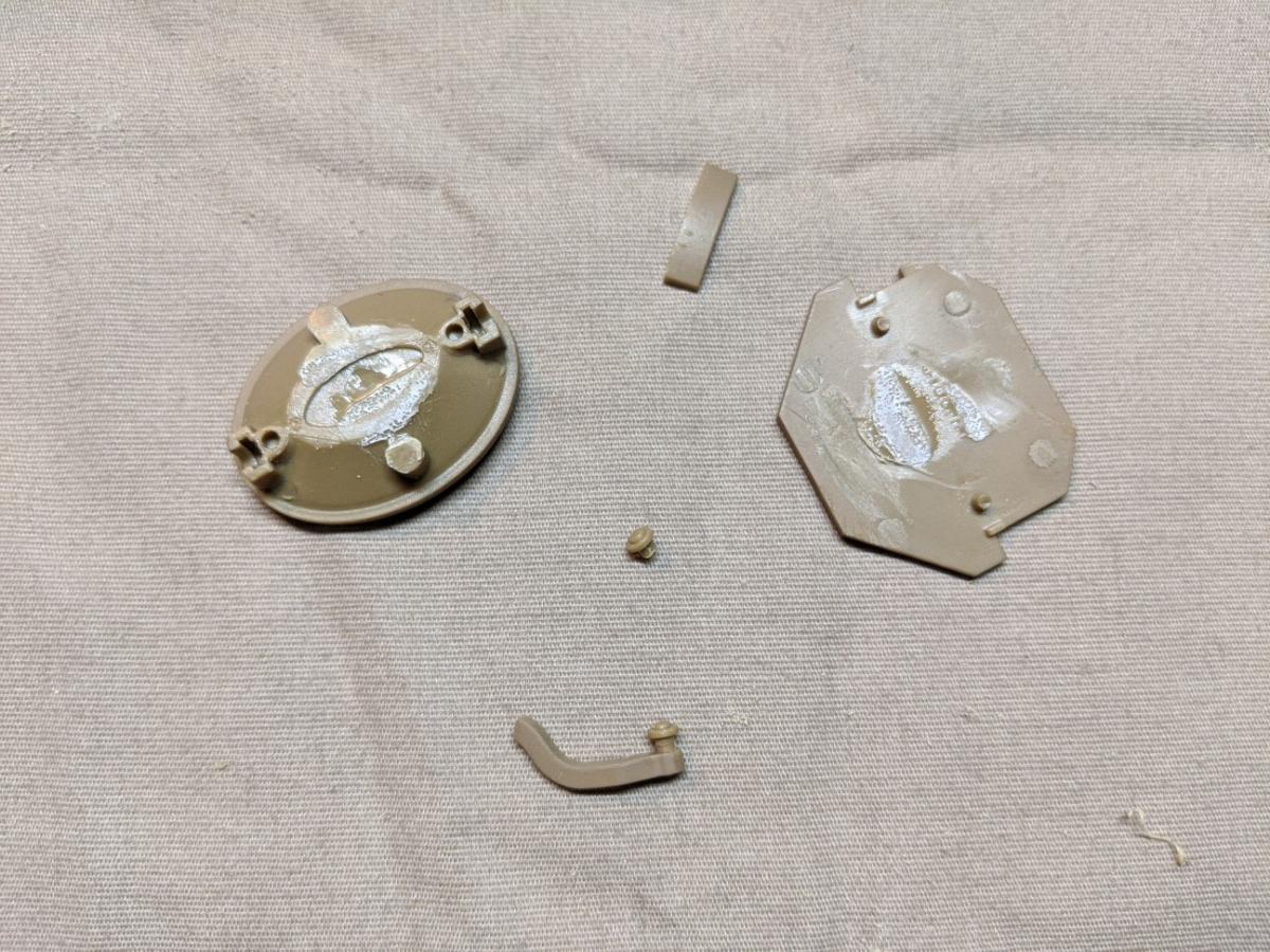

    Well, that took a lot less time to fix than I thought it would. First thing I did was take a razor saw and separate the upper plate from the lower hatch. This freed up the hinge pin and broken arm.

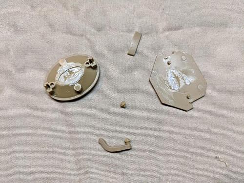

    Then I used a pin drill and very small drill bit to drill holes to reinforce the broken arm and broken hinge pin such that I could reinforce them with small pieces of piano wire. After pinning them together I used some acetone on a brush to weld the broken pieces back together again. The joints are now steel reinforced and very strong. Then I used model cement to glue the upper and lower hatch parts back together. Viola! All better.

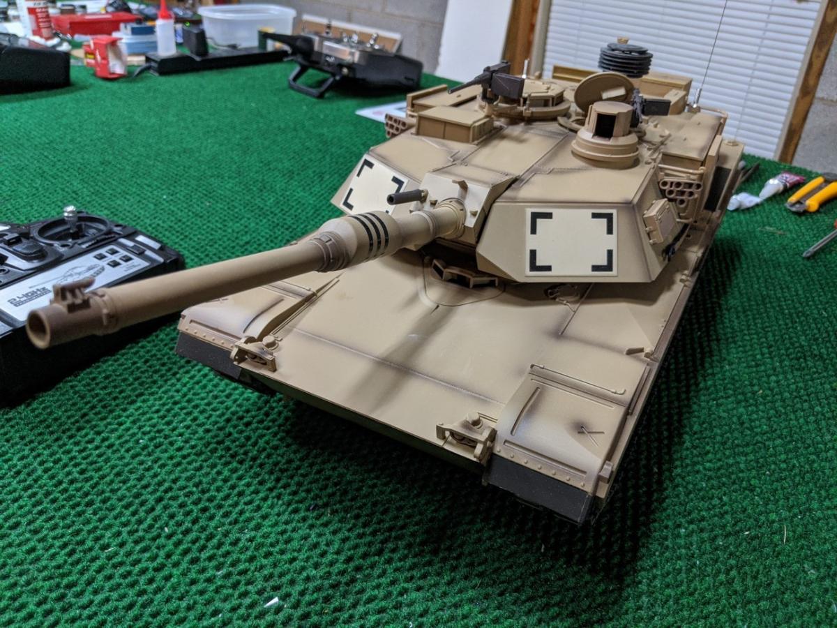

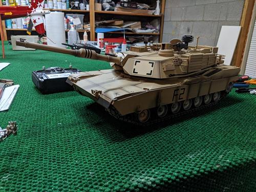

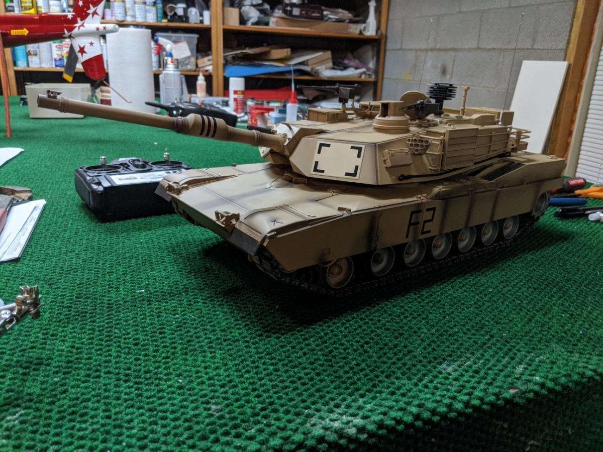

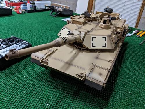

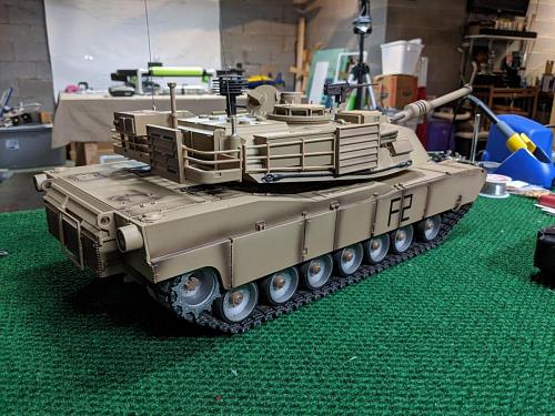

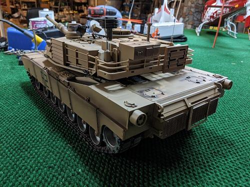

                            My Pro Abrams pre-weathering. This is a nice tank!

                              Hey RC jetdude, your Abrams looks great already, and the IR cover is trick...I had a chance to start on my M1 A2, and am also looking forward to some combat weathering...

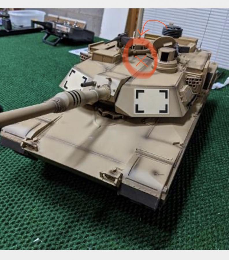

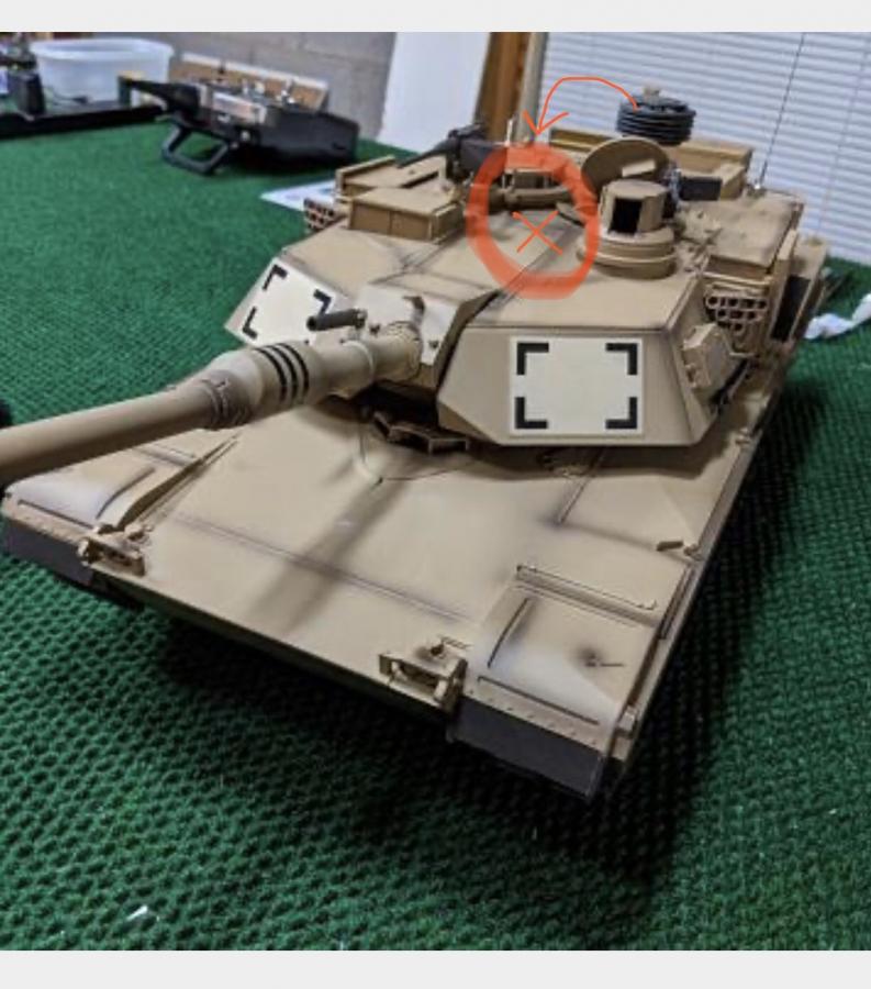

                                Just something we are seeing in our battles and testing with the location of the Abrams IR receiver. It sits to far back on the turret and this causes issues with the IR receiver “taking” hits from the turrets frontal arc by as much as 180 deg.
                                Might want to consider moving the IR receiver more to the front of the tank to make IR battling a bit more fair. We are asking folks that play at the two local clubs to move the Abrams IR receiver forward to the area just in front of the turret hatches between the gunners and commanders sights as indicated below. This seems to work out well for improving the IR receivers responsiveness.

                                  Copy that. Thank you. Are they installing a new magnet or moving the existing one?
                                  • #18
                                    Just installing a new magnet which is relatively easy.

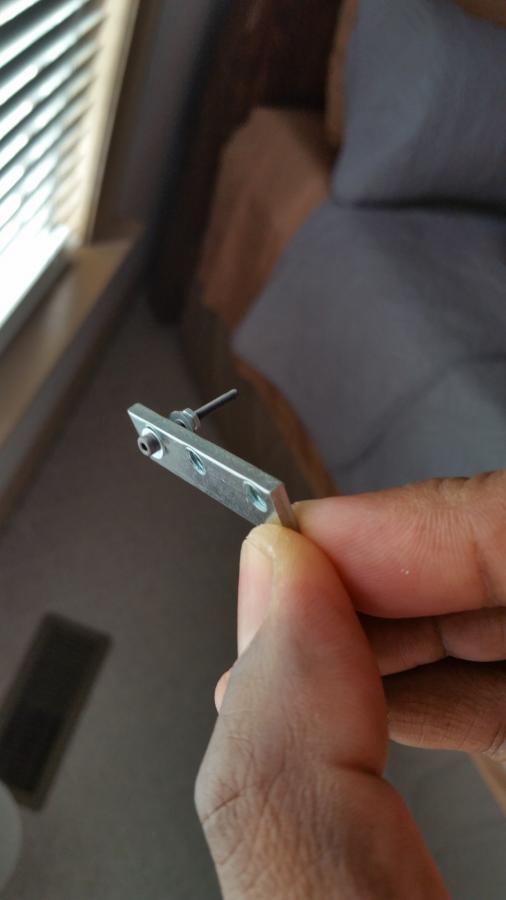

                                      I copied this as a " user reply" on rcgroups but figured it would be benifical for noobs, like myself, here.

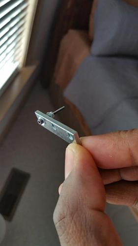

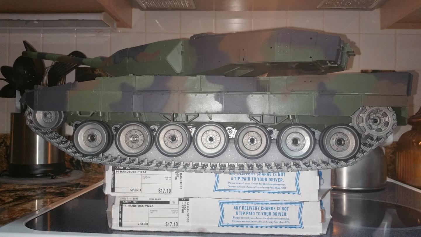

                                      have the Leopard with metal tracks too. I only run indoors, on my berbier carpet, which has a tight weave. So far I'm not throwing tracks, even while doing spins. When doing these, I do notice that the reverse track has slack between it and the next wheel. Also, I measure 13mm space between the middle road wheel and the track when the track is suspended.
                                      I was told that I needed to move the tensioner one notch (The Leopard from MRC do have track tensioner). I did this but found that the suspension compressed some.. so it was too much. So, I'm going to run mine until I get more I get more slack (break-in), then tension it. Head over to hobbysquawk.com, the tank section. Rubbycon99 is knowledgeable and gave me this info.
                                      Note, to adjust the tensioner, the hubcap was too small for me to get a proper sized philips in so I removed the 4 screws that bolt the idler together, removed the outboard side of the wheel, then you can get to the screw. While there, drill the access hole out for so you don't have seperate them again. You will, also have to remove the upper deck, held by 6 screws, to get the skirt out of the way. For some reason, the bearings were on tight. I fashioned a "wheel puller", so as not to put too much stress on the plastic hull.
