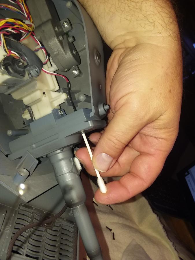

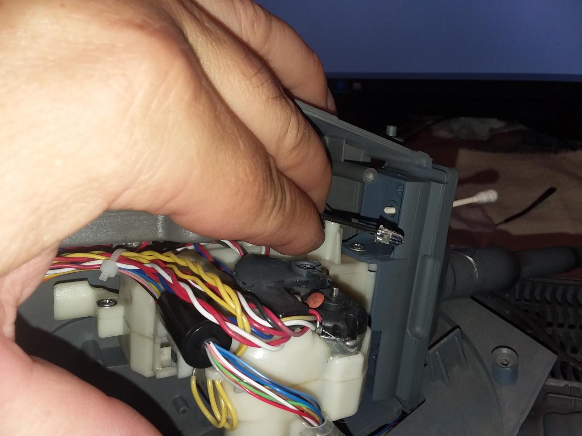

      I'm having "gunnery issues too". (IR that is)
      I sent the seller from whom I bought the tank the following message just now.
      "Dear toucanhobby,
      I have recently bought two tanks and for the most part have been quite happy with my purchases.
      The Tiger-1 I bought over a month ago and had to wait until just recently to buy a second tank to "battle" with. (The Sherman arrived just today)
      I was testing the Sherman's IR ability and found the Sherman can "shoot" the Tiger but the Tiger cannot shoot the Sherman.
      I seem to be having trouble with the Tigers' IR emitter. Upon closer inspection, it seems the IR diode/lens was covered with paint "over spray". I disassembled the turret and gently removed the diode and wiped the overspray from the end of the emitter.
      Unfortunately, this has not resolved the problem. As far as I can tell, the connections throughout the wiring harness are firm and connected but the IR emitter still does not affect the Sherman's IR receiver.
      I have already tried swapping the receivers between the tanks and ended up with the same results. (I tried this before opening up the Tiger)
      I have since reassembled the Tiger and it is working as before. (still unable to shoot at the Sherman)
      I am not above affecting my own repairs but I will send the tank back for repairs if necessary.
      What recommendations do you have at this point to resolve my problem?
      Thankyou for your attention."

      Hopefully, I'll get my little problem resolved soon.
