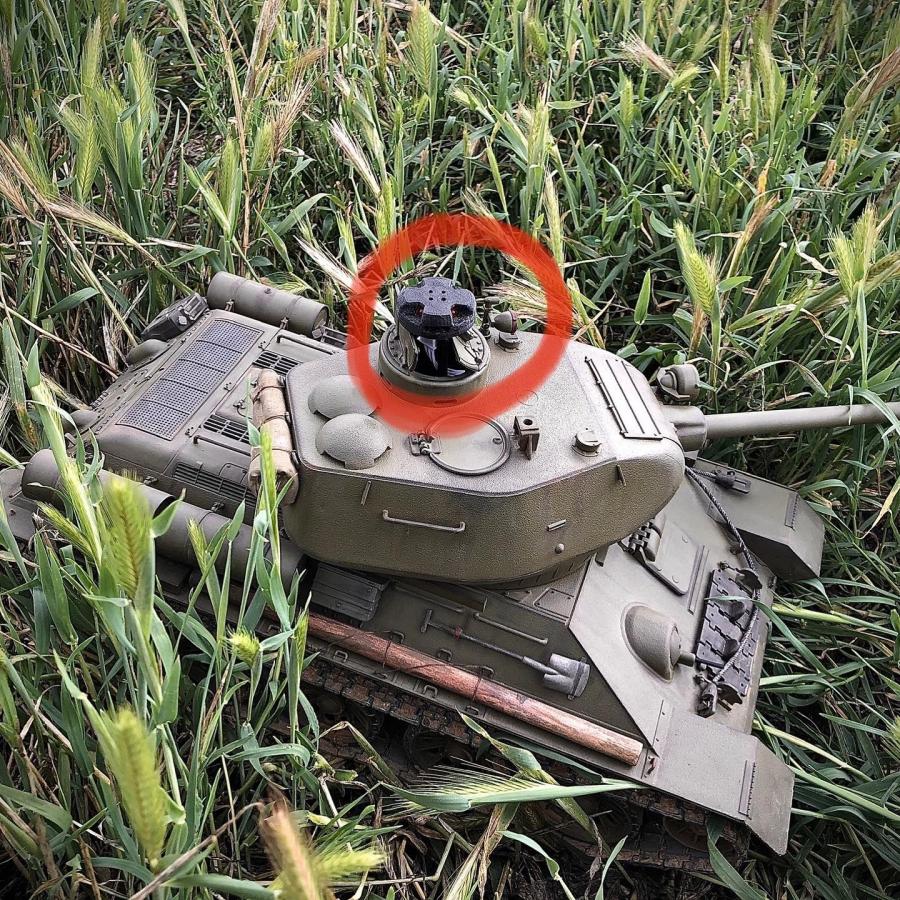

      Just finished testing LegoDEIs new prototype 6.0 Heng Long “compatible” IR receivers. I will be posting the test results soon, but can say they are a HUGE improvement over the stock IR receivers.
      Click image for larger version  Name:	8C9C83D6-9420-49FC-88CD-8E2E7325CD7F.jpeg Views:	0 Size:	264.6 KB ID:	244042
