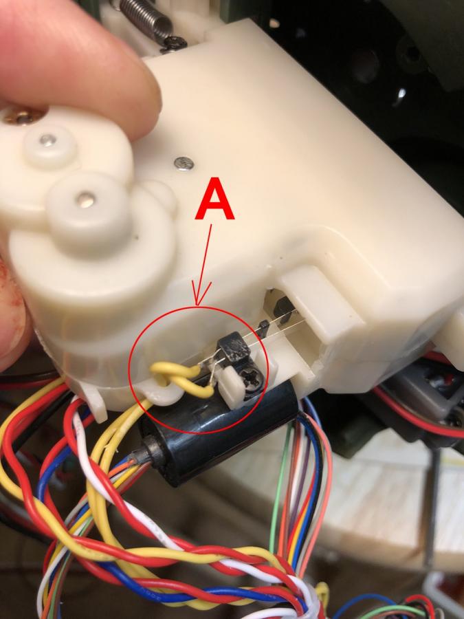

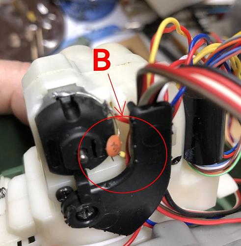

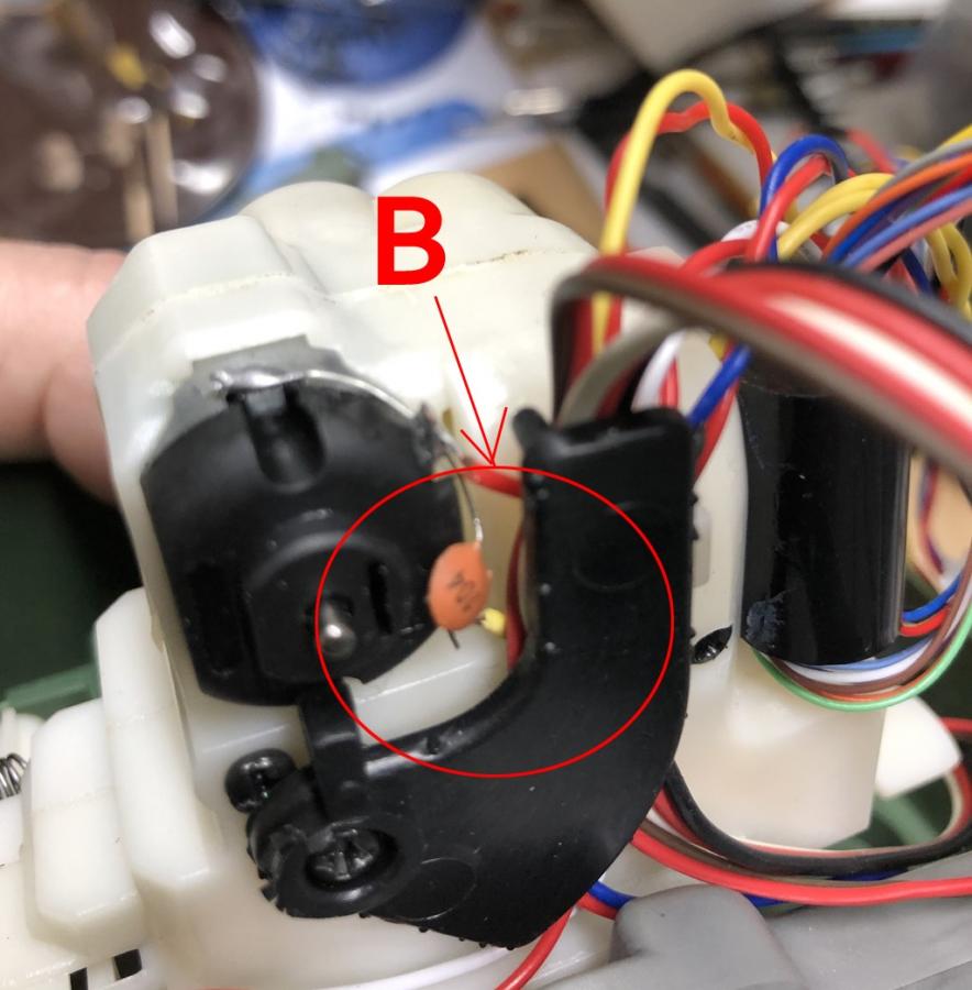

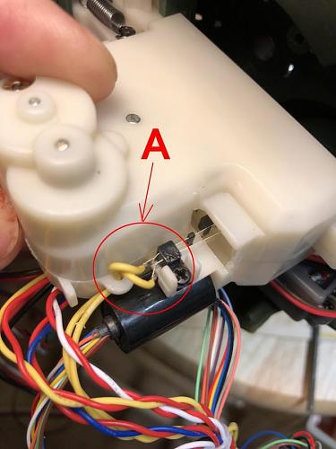

      Just so I understand, it's not acceptable to hold down the machine gun for quicker firing. Is it still acceptable if I rewire out the BB cannon function?
      Which yellow wires do I splice? In "A" or Picture "B"?

        Yes most IR battle groups or clubs want no BB functionality for safety reason. No it is not acceptable to hold done the MG trigger. Tanks have set rates of fire based on the weight class. 3-5-9 seconds, Light Medium Heavy. Would kind of be hard to explain how a 30cal MG killed an Abrams or King Tiger with frontal or side hits.
        Yes the yellow wire in your first picture. I usually splice it close to where it plugs into the MFU and remove the rest of the unused wire. This helps reduce the volume of wires crammed into the tank.

          Sounds good. Just tie the two yellow wires together that goes to the micro switch.
          I figure since had it all apart now would be a good time to tidy things up a bit..
          Thank you!

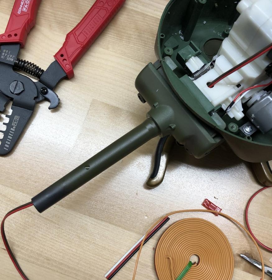

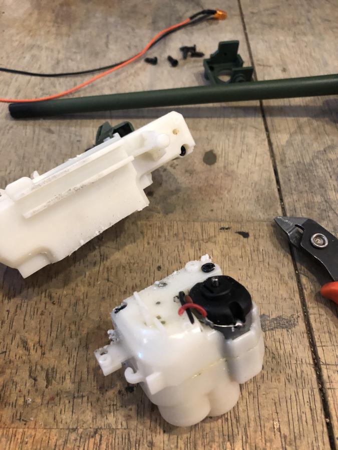

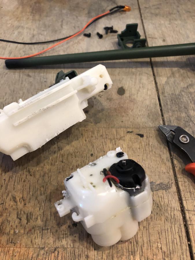

                    I’m guessing I have to remove the entire breech assembly and fish the wires out somewhere?
                    • Rubicon99
                      • 3311
                      Yes. Or simply remove the entire motors assembly as shown. Takes 30 seconds to saw off. Then run the wires down the barrel an out the bottom of the breach.

                        I got to looking at it. Maybe I could run the wires out the pellet feed ramp? Will have to dig into it a little more otherwise I'll do what you did and just cut it all off...

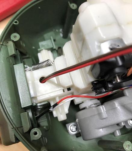

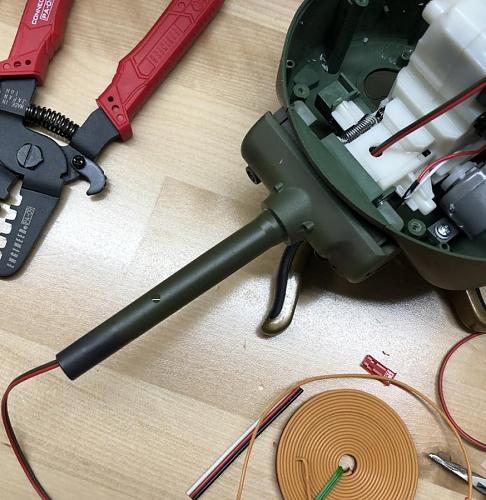

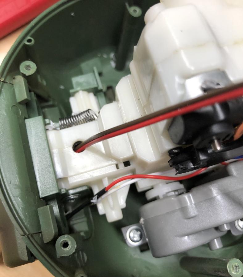

                          I hope I didn't screw this up but I just drilled a 3/16 hole in the area between the metal barrel and the piston.
                            Looks good!!!

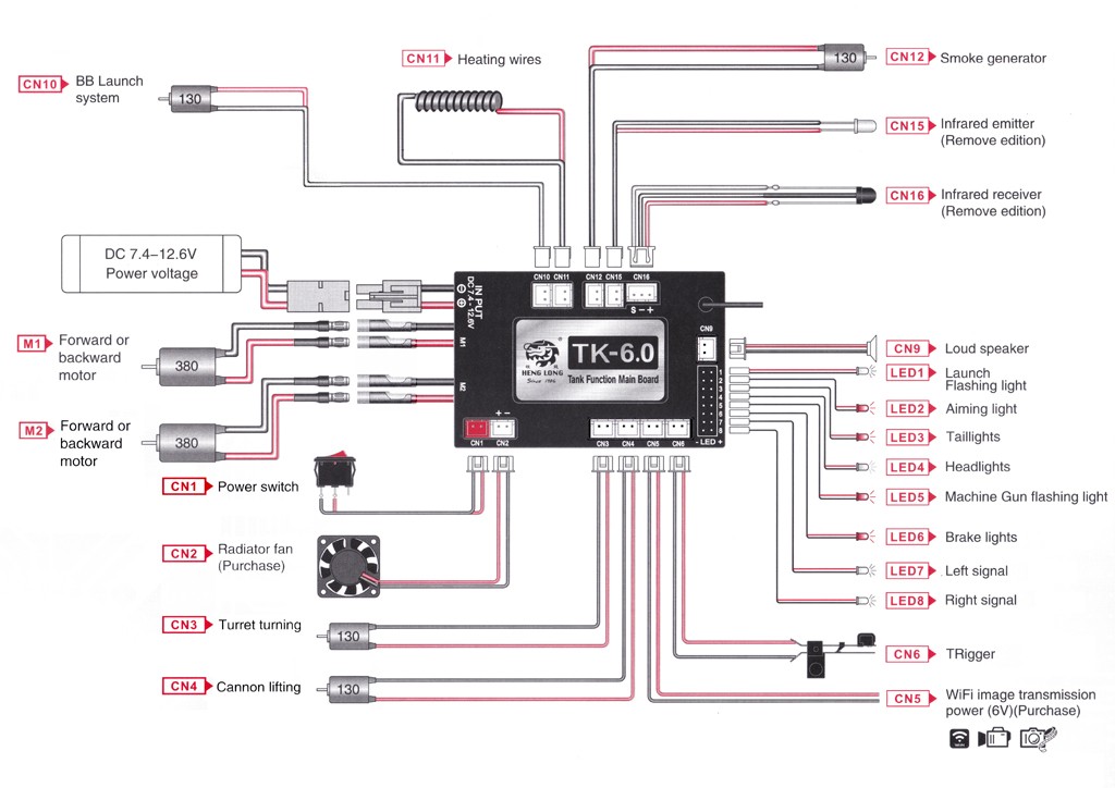

                              Next question, where do I wire the barrel flash LED?
                              In the Number 1, [LED 1] "Launch/Flashing light" two pin slot?
                              • Rubicon99
                                • 3311
                                Yes the number 1 slot.
