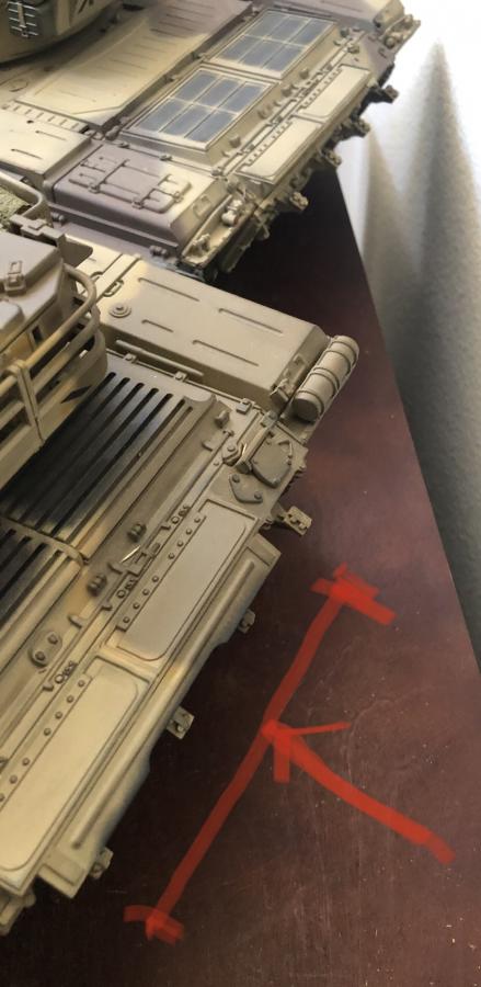

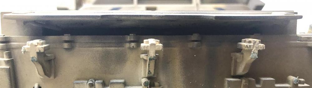

Below is a simple example of adding a heat exhaust vent. These are both T72s one with a vent one without.
No heat exhaust vent.
With heat exhaust vent.
Vent louvre added to rear of T72 (red) to help hide the added exhaust port. Notice the far T72 does not have this added vent.

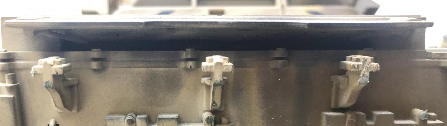

Good info. I've already opened the tank so often one of the screws stripped out, so I did the magnet modification. I was a little leery about the ability of 6 little magnets to keep it together, but it seems to be sufficiently secure when bouncing over obstacles.Comment
I've heard mix feelings on the magnet MOD; any new updates on your experience?Comment
Other than being mindful when picking it up, I haven't experienced any down side to it. I've hit objects with the main gun hard enough to rotate the turret against the slip clutch, bounce over 1X1 and 2x2, and tip it on It's side to access the battery without it coming off.
