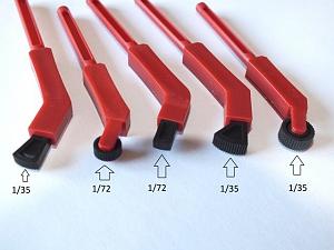

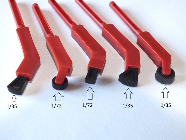

    SF, I presume you've seen this set. Trumpeter Zimmerit Application Tool Set (5-Piece) https://www.amazon.com/Trumpeter-Zim.../dp/B003M2N2LM . It's like $49.95 on Amazon. 3DP would be simple enough, \would need to know TPI or TPC for scale, I'm guessin'. Best, LB

      I've seen that one; unless I'm mistaken its this set which doesn't include a 1/16 size tool:
      • #4
        sfcfury, gotta have the TPI/TPC for 1/35th, so we count the number of TPI or TPC of the 1/35th tool, divide by 2.1875 = 1/16th scale TPI TPC. Then it's simple, design a saw-tooth for 3DP. I'll help with an STL file, just need the tooth count for 1/35th. I presume you're wanting the 'scraping type' tool and not a roller. The yutoob vids I've seen used the scraping method and it looks really easy. Best, LB

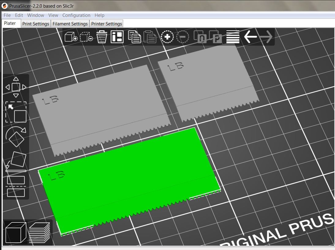

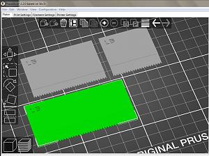

            [ATTACH]n253054[/ATTACH]
            [ATTACH]n253055[/ATTACH]
            [ATTACH]n253056[/ATTACH]
            Tankers, With a major assist from sfcfury, and as requested, here are 3 different widths of 1/16th Scale Scrapers for 3DP to assist in applying a "Zimmerit" Style coating to your vehicle. The 'grooves' are just over 2mm on center. Spacing is 1mm +/- and these are 1mm + in height. Any other improvement suggestions concerning these, let me know here in this thread. Best, LB
