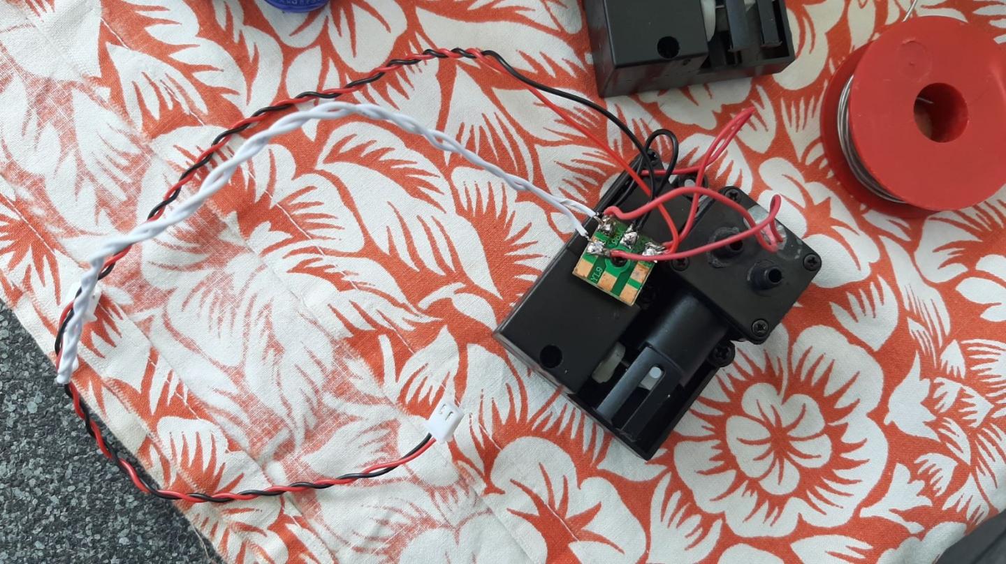

                      Well I ended up opening up the smoke module after all, but even after playing with that I didn't get any decent results. The little white 'roll' wrapped around the heater coil started showing signs of burn marks.
                      So instead of risking further damage I decided to contact my seller and have him send me a new smoke module. The one he sent me is almost the same one, only as far as I can tell wired for just 1 plug while the one found in my tank is for 2 channels.
                      Anyway I tested it in the tank and the new unit did give plenty of smoke. Problem solved right?
                      No. This one wasn't working proportionally like the origional found in my tank. Though assured by the seller that these are in fact the same units, just fitted with different wiring, I decided to resolder the new unit so it would have two leads, one for channel 11, the other for 12.
                      A baby simple job. Though when I try to switch my tank on, all it does is flash the lights.
                      It won't connect to the remote anymore while this new smoke module is plugged into the TK6 system. When I remove the smoke unit plugs from the TK6 unit the tank operates as usual without problems, aside from the smoke ofcourse.
                      Is there any reason why it would act like this?
                      Honestly this simple thing is becoming a little frustrating while it should be an easy fix. Half an hour of tinkering tops.
                      Can anyone here shed a little light on it?

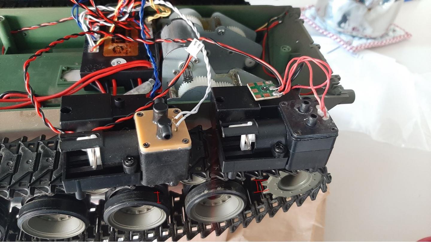

                      • Dutchy93
                        • 26
                        After a bit of playing with the leads I got the origional smoke unit working, the one that came with my bulldog.
                        When I opened both smoke units up I noticed that with the replacement one, the wick was wrapped around the heating coil, while in the one that came with my tank this wasn't the case.
                        There they just stuffed a small yellow spunge and a little wick down the box and bolted down the lid.
                        My guess is that the heating coil of the V6 version doesn't always connect well with the wick (as was true for my unit), and thus giving barely any smoke.
                        So I wrapped the cotton wick around the heating coil and tied it down with some thin copper wire, making sure it doesn't touch the poles of the heating coil itself.
                        This solved the problem for me.
                        So I'll leave this here for any other people who might come across the same problem.
