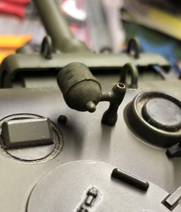

    First had to find as many photos of the actual light. Not many...
    Click image for larger version  Name:	spotlight5.JPG Views:	0 Size:	118.4 KB ID:	254944

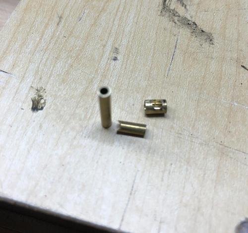

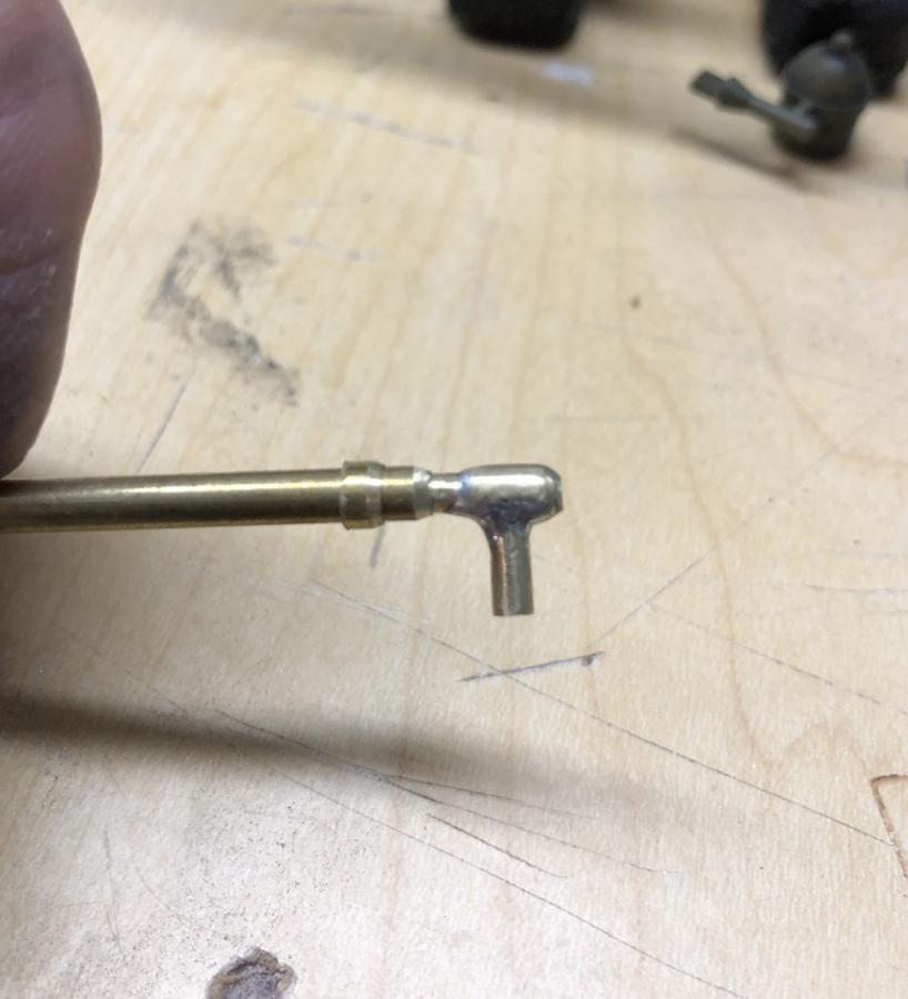

    Second thing was finding a small LED that would fit in the stock spotlight housing and a small 5mm Straw hat fit perfectly. I also didn't want to just drill a hole with wires running out the back.

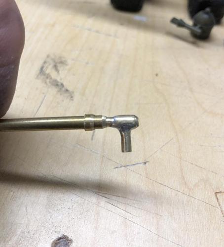

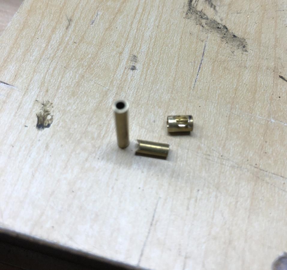

    So, I dug into my tubing bin and grabbed the smallest tube I could run two wires through and cut my pieces to best match the "real" spotlight.
    Click image for larger version  Name:	Spot_01.jpg Views:	0 Size:	85.8 KB ID:	254945

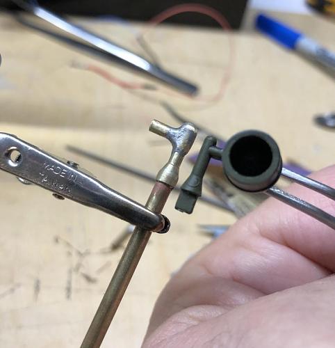

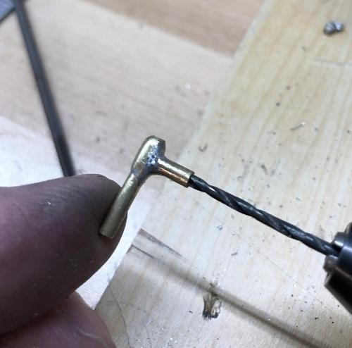

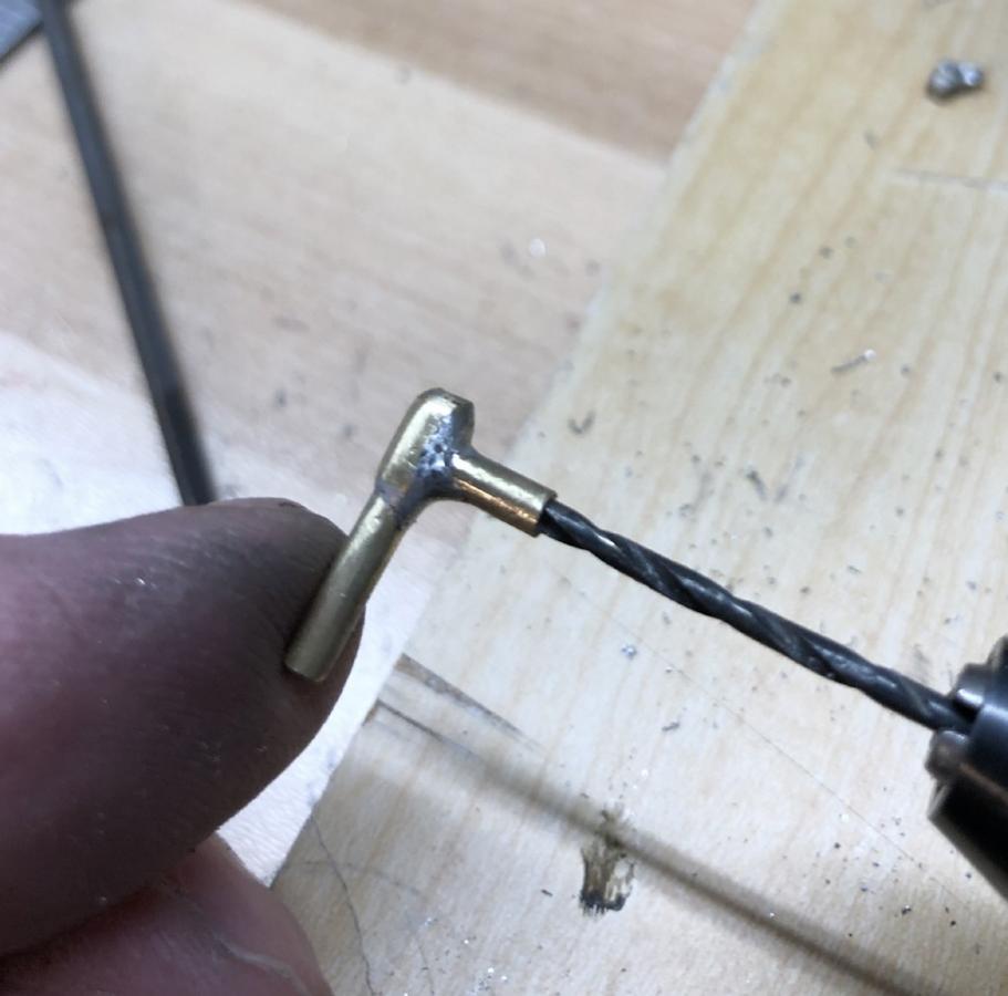

    Soldered some pieces together and opened up with drill for the wires.
    Click image for larger version  Name:	Spot_03.jpg Views:	0 Size:	58.1 KB ID:	254946
    A few more pieces to get the shape about right...
    Click image for larger version  Name:	Spot_02.jpg Views:	0 Size:	59.0 KB ID:	254947
    Did my best to match the size of the stock spotlight..
    Click image for larger version  Name:	Spot_05.jpg Views:	0 Size:	60.0 KB ID:	254948

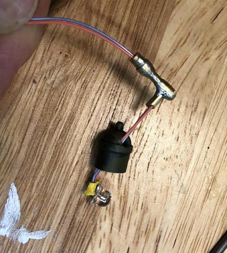

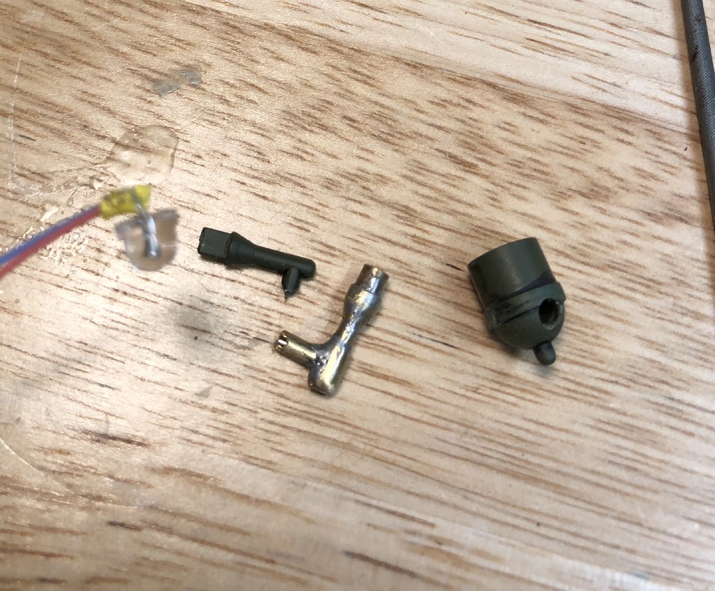

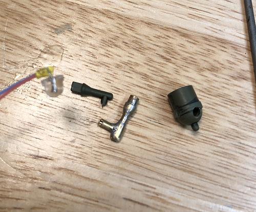

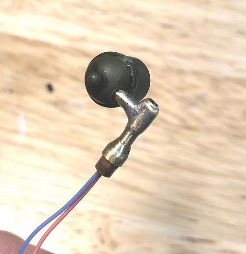

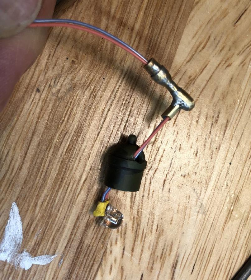

    Clipped the terminals way back and soldered the wires on the straw hat LED.

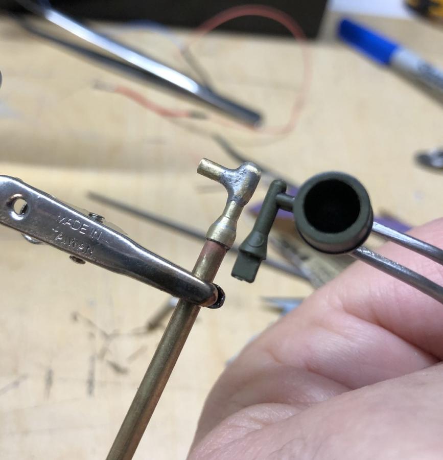

    Clipped off and drilled the stock housing.
    Click image for larger version  Name:	Spot_06.jpg Views:	0 Size:	242.4 KB ID:	254949
    It was a bear shoving those little wires around that 90degree bend..

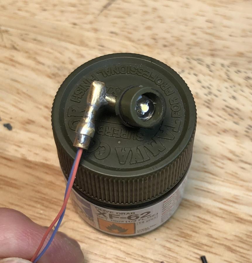

    Click image for larger version  Name:	Spot_07.jpg Views:	0 Size:	133.0 KB ID:	254950

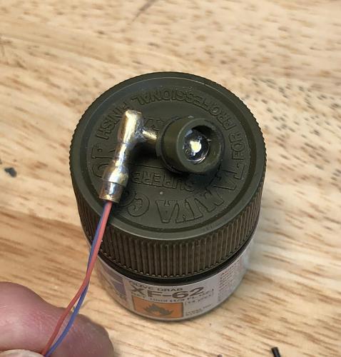

    But, I got it together, a little CA glue and it's together..

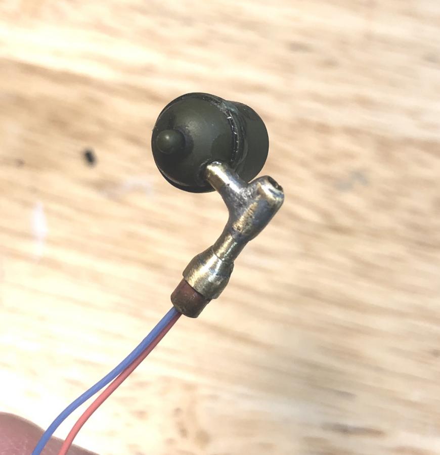

    Click image for larger version  Name:	Spot_08.jpg Views:	0 Size:	50.1 KB ID:	254951
    Click image for larger version  Name:	Spot_09.jpg Views:	0 Size:	80.3 KB ID:	254952

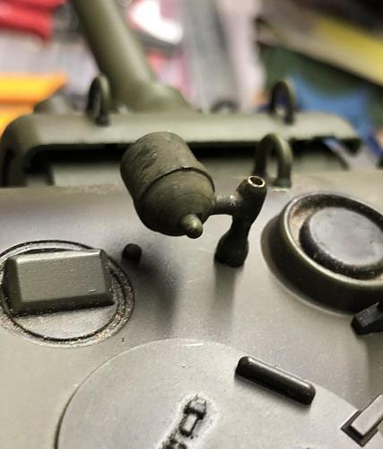

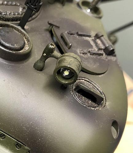

    Drilled the turret for a snug fit, globbed some OD on it and I think it doesn't look too bad..
    Still need to plug the hole on top...

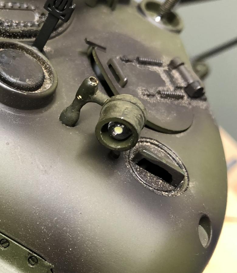

    Click image for larger version  Name:	Spot_10.jpg Views:	0 Size:	79.6 KB ID:	254953
    Click image for larger version  Name:	Spot_11.jpg Views:	0 Size:	65.0 KB ID:	254954

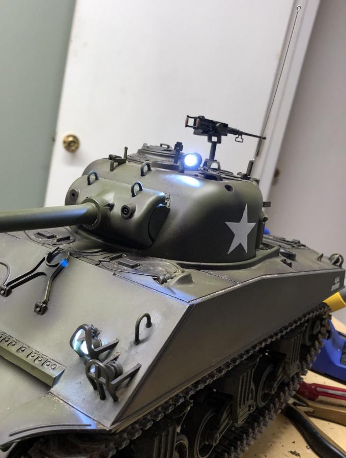

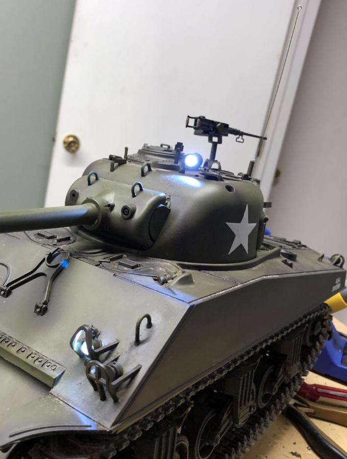

    Best part is it WORKS!
    Click image for larger version  Name:	Spot_12.jpg Views:	0 Size:	60.3 KB ID:	254955
