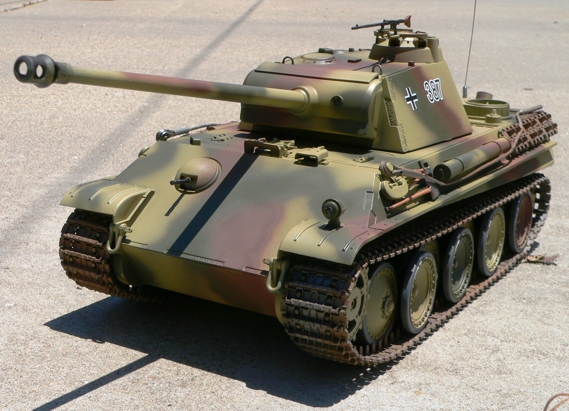

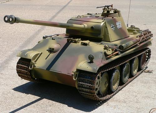

    In anticipation of recommencing my rc tank addiction (I have a new one enroute) I took out my old HL Panther G to run around with. It was a new model from HL when I bought it - how many years ago? After a few minutes of activity, one side just stopped. OMG, is it the board, is it the motor, I don't want to put any money into this old tank!
    I took it apart and isolated the problem; motor ok, board ok. The right side gear train had frozen up. I've WD-40'ed it, that helped, but not completely.
    So my question is, how best to clean out the bushings on the gear reduction axles. I don't think the bushings can be removed from the gearbox frame, at least not on my workbench without damaging something. I'm good at that. What's others done in this situation, besides buying new gears which is not an option. I did my own paint job, so I'd like to keep it.
    Click image for larger version  Name:	Panther G 3.jpg Views:	0 Size:	261.0 KB ID:	255689
    SoCalBobS I use Tri-Flow for the bushings and gearboxes in general. Works great!
    I like your Panther's colors, did you paint that? It doesn't match my TK6-version Panther G. I like yours better!

          QUOTE=Alpha;n255690]SoCalBobS I use Tri-Flow for the bushings and gearboxes in general. Works great!
          I like your Panther's colors, did you paint that? It doesn't match my TK6-version Panther G. I like yours better![/QUOTE]
          Yep, that’s my paint job. Standard German tank colors, undercoat of their yellow with red brown and green. Can’t remember the color names, but that mustardy yellow is cool. EDIT: It's Tamiya's Dark Yellow, XF60 I think is the number.

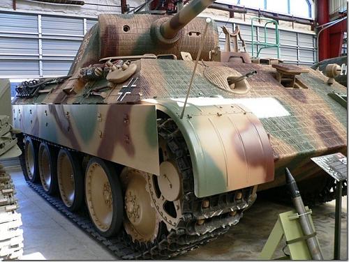

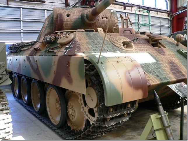

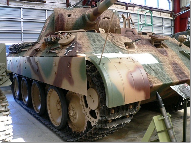

          A number of years back I visited the Littleton armor museum up near San Jose. Their pride and joy was a fully functional Panther, with some bright colors!
          Click image for larger version  Name:	19D037D4-A079-4A8B-8900-644584178A16.jpeg Views:	0 Size:	110.0 KB ID:	255702
