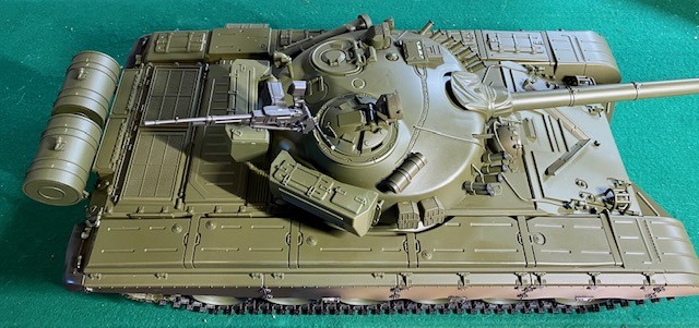

    I’ve been in various r/c hobbies for many years, including tanks, off and on. Many of my fellow r/c’ers had no knowledge of this tank hobby. For them, and anyone new here, I’m starting a thread about my experiences with a new Heng Long T-72. My posts are meant for a new modeler, not the veteran hobbyist. The forum sticky threads are extremely valuable, read them first.
    So my T-72 arrived yesterday. Attached is a photo of the bare bones body as it comes out of the box. I did the 2-minute test as recommended by the forum moderators. Now I have to decide the steps and sequences to assemble, paint and weather it.
    Each tank is unique, so Do I paint first, or assemble it? In this case, my first step is to attach the separate detail parts. I want to keep in mind the possibility that some parts might need painting first.
    I’m not in a hurry to finish this project, so there may be intervals of no activity. Others are welcome to chime in any time!
    Twenty six tanks, and not done yet!

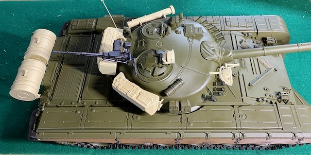

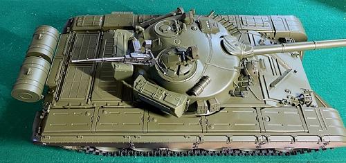

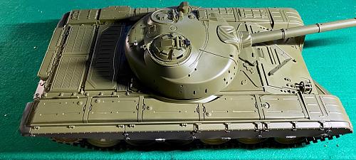

      Ok, attaching the extra parts took a lot shorter time than I expected.Essentially all done except for the flexible tubing representing the external gas tank hoses, and the driver and idler wheel hubs since I'll have to remove those to paint the tracks.
      Here is a big decision point will you be painting or leaving it as it comes out of the box? Some tanks are painted, some not, and some have smaller parts that have been painted. You'll be doing something different depending on your choice. You will be cutting off the parts from their sprue. I highly recommend a sprue cutter, I use Xuron's, but any will do. You'll get a cleaner cut than if you twist it off, not to mention the possibility of breakage. No matter how clean your cut, there will still be a mark. If you're painting, not a real problem. If not, you'll just have to accept it. The sprue cutter will minimize this. If you are going to paint, you can scrape it smooth, and also scrape the mold edges but if you aren't painting, scraping may reveal a different color of plastic under their paint. I'll be painting.
      The other painting issue is what to attach permanently and what to dry press fit for now, so you can remove it during painting. In my case, the gas tanks and stowage bins are all dry fitted. Smaller parts, such as tow hooks and smoke generators I dabbed on some glue so they don't fall off in use.

        I mask the wholes with a small piece of tissue paper pushed into the wholes. It doesn’t take a lot to pack the wholes well enough to kept paint out. Don’t worry about the IR and MG bulb being moved when you insert the tissue, they are rather tightly installed in the mantle.

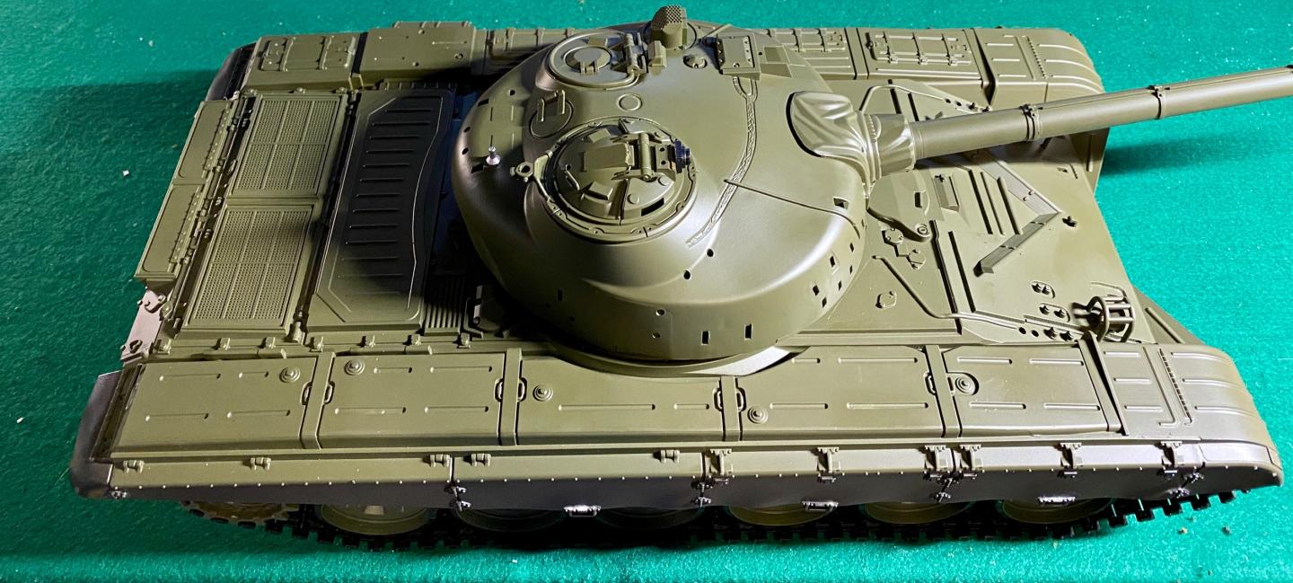

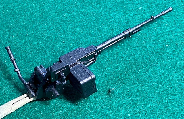

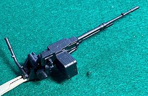

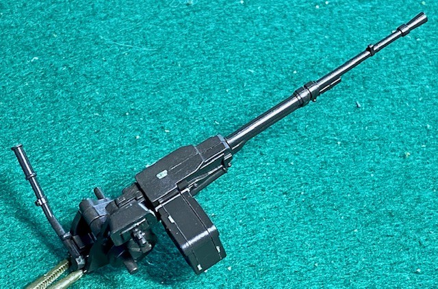

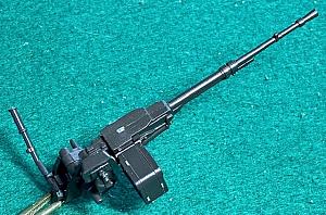

          Ok, time for some basic painting tips. Remember I talked about cut marks? On this machine gun, you can see them. Smoothing them down and painting them helps. I will be doing a bunch more later on, but here I sprayed some gun metal, then some flat black over it.

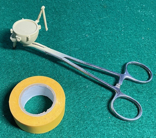

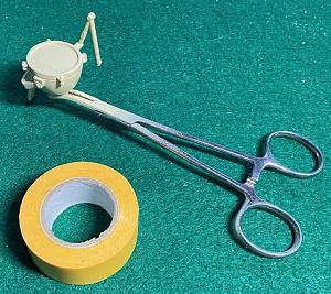

            Some more painting considerations. First, there is a great product, modeling masking tape by Tamiya. It's much, much better than blue painters tape for our purposes. It can be snugged into corners, cuts easily with a sharp hobby knife and doesn't leave residue. I taped the light lens and will pick it off in a few hours.

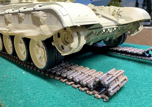

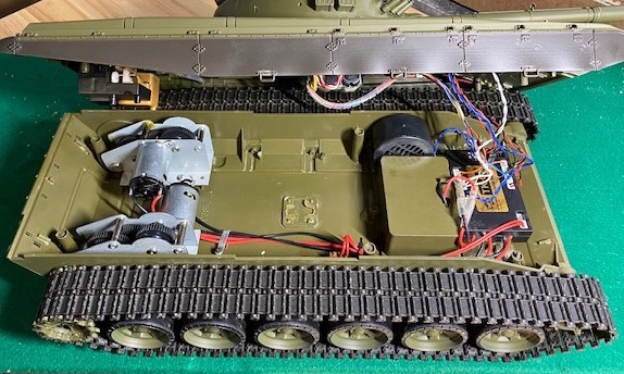

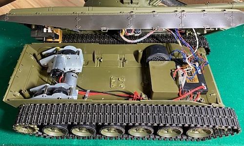

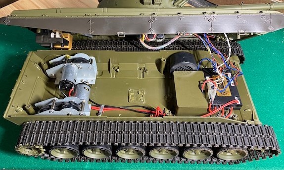

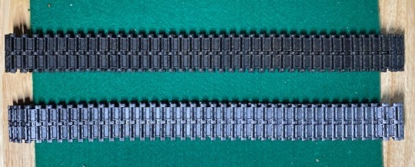

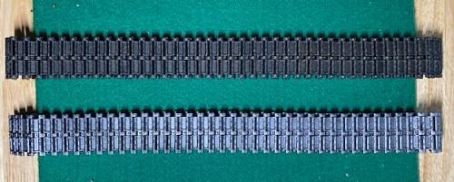

                    I'm back! After Rubicon's kind advice, I've opened the case. This is for a couple of reasons. Today, I'm working on the tracks. To remove them from the T-72 the top has to come off because of the side skirts. Six screws and done. I'm not going to unplug wiring from the bottom for now. Move the top aside, unbolt the driver wheel, and the tracks are off. By the way, when I saw the black gears, I was concerned I'd gotten plastic! Not to worry, the magnet test showed them to be metal, unless there's such a thing as magnetic plastic. You never know these days.
                    I agree with Alpha's comments regarding plastic versus metal tracks. They are heavier, and in some of the earlier HL tanks they placed a strain on the idler wheels. On a KV-1, the wheels finally broke off due to the strain. Newer tanks with metal adjustable idler wheels probably won't see this that much.
                    I'm spraying the links with Tamiya's TS-42 Light Gun Metal spray, since that's what I had on hand! I'll let them dry for a few hours before dusting with ModelMasters Light Earth to give a rust effect.

                    • #11
                      Thanks for sharing this interactive "painting my tank 101".

                        A couple of things. One you have the black gears👍👍! Those IMO are better then the newer silver steel colored gears because they are MUCH quieter. Second you have the new improved forward hull with added internal bracing on the front hull glances👍👍👍! These were recently added because the front hull would crack and the hull around the idler mount would start to rip off. Two of mine did not have these braces and both have cracked hulls(I since added metal reinforcements to fix the issues). My third T72 (green uparmed one) has the new forward hull braces!!!!

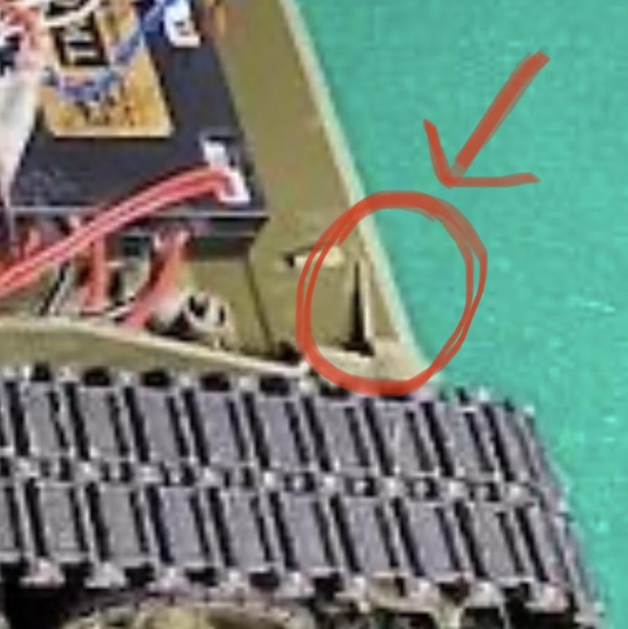

                        vvvvv Below is a photo of the new froward support brace/gusset.
                        Click image for larger version  Name:	DF77C1C0-9739-4A52-B63A-93E6B3508C94.jpeg Views:	0 Size:	72.5 KB ID:	256488

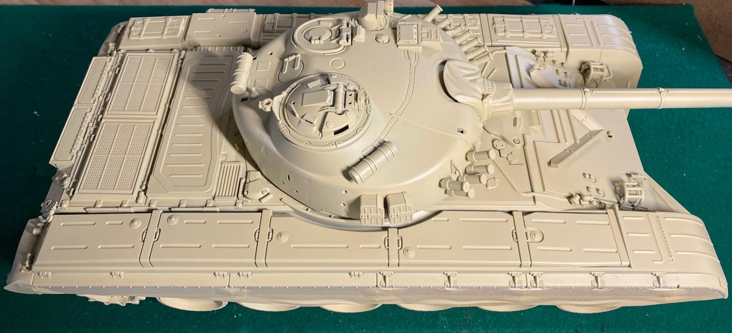

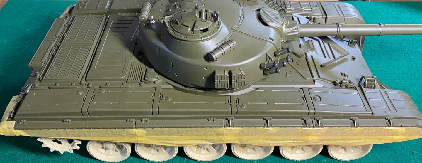

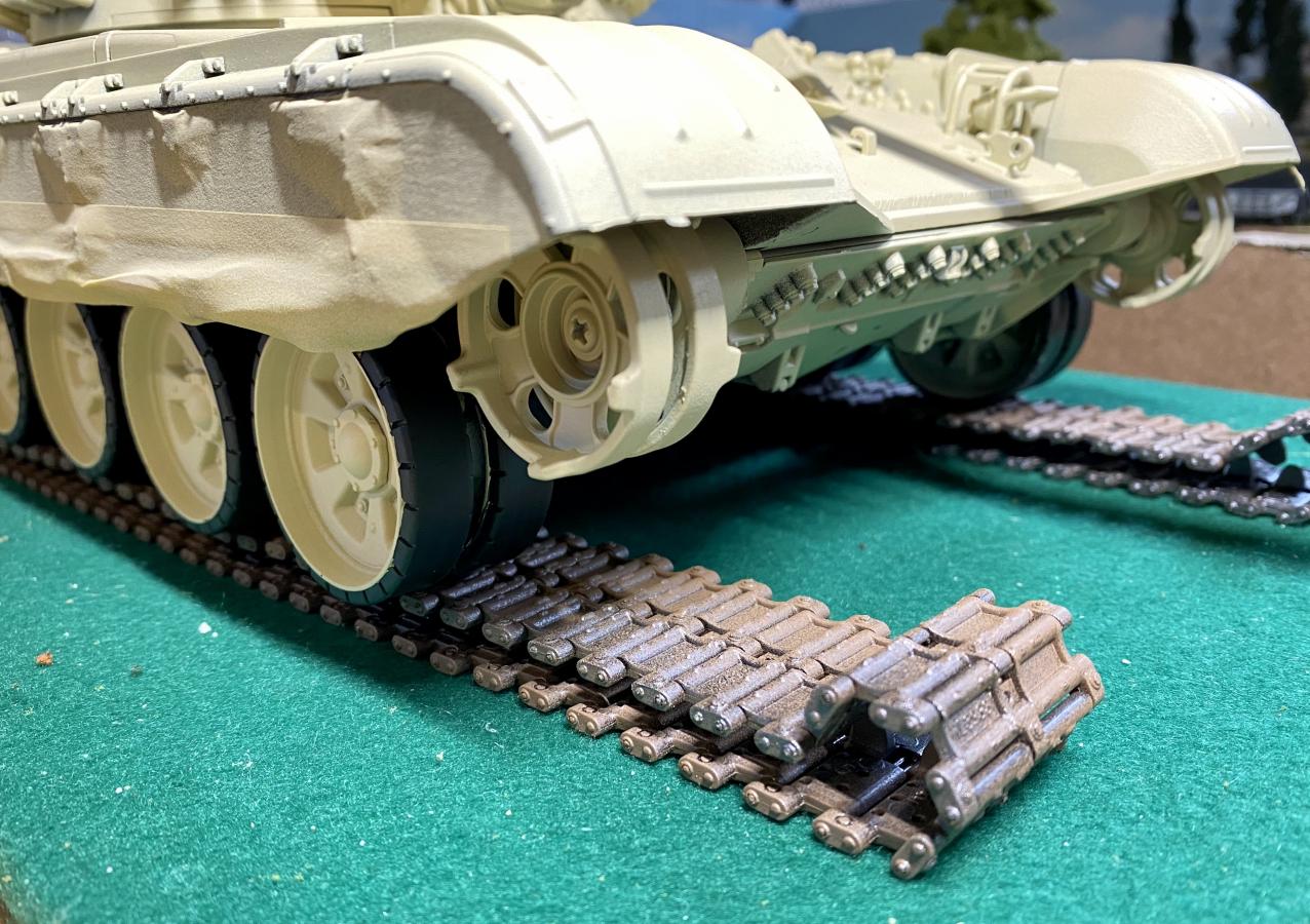

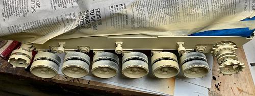

                          I've commenced my paint job. As I'd noted before, the hull top has to be removed to access the hull sides. Here it's done, and the side is masked off and the wheels painted. The tires will have to be re-painted with a brush later on.
                          Once this is done I can put the hull top back on. Also, I've used the Tamiya tape to cover the side skirts. They represent rubber I think, and the model has them painted a dark brown and I want to retain that. That tape will have to stay on until after the airbrushed camo phase.

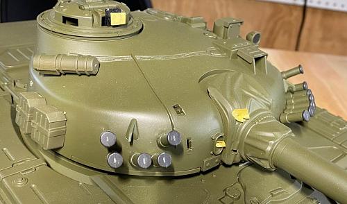

                          Taking Rubicon's advice, I plugged the IR &MG holes and the FPV camera lens using the Tamiya tape. See the mold separation marks on the smoke generators?

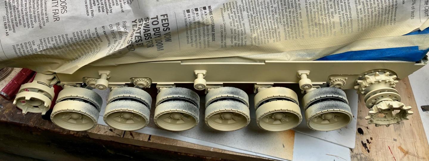

                          First coat of paint. We'll see if blondes really do have more fun. The color is NOT pink! You'll see. It's ModelMasters Modern Desert Sand. See the first photo in this post.

                                    Project update: track is rusted up, light earth paint dusted over light gun metal spray. Tires painted, not black! Vallejo dark panzer gray.
