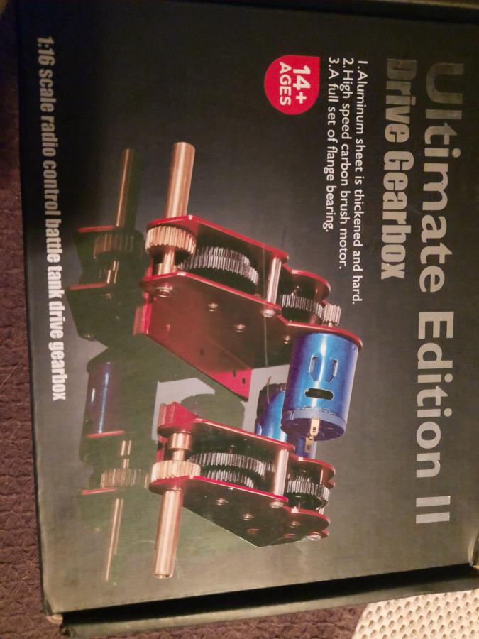

Yay!! Look what turned up today. I know what I'm doing this weekend. Just a little question though, do you have to run these in? I know they are the blue and not the red motors but I only have plastic running gear on the Abrams and I didn't think it would hand
New Gearboxes
Sappo You don't need to break them in, provided they're shimmed and meshed nicely from the supplier. We have since discontinued the blue motor setup, but it's still a good one, better than stock. Have fun!Live Q&A every Tuesday and Friday at 9pm EST on my Twitch Livestream

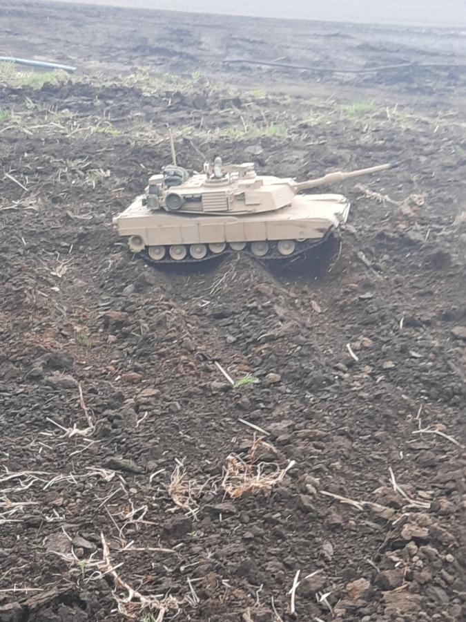

Got the new motors and gearboxes in and I am impressed, probably running at a scale 70 kph now. Actually got more power than the plastic tracks can cope with cause it spins the tracks on the lawn. Oh well MORE upgrades to do. One question tho what wattage is the speaker cause mine has decided to die on me.
If you think it is fast now, just wait until you upgrade it to the 390 red motors.Originally posted by saunderspeter071@gmail.com View PostGot the new motors and gearboxes in and I am impressed, probably running at a scale 70 kph now. Actually got more power than the plastic tracks can cope with cause it spins the tracks on the lawn. Oh well MORE upgrades to do. One question tho what wattage is the speaker cause mine has decided to die on me.
Trust me you are NOT even close to the limit of what can be achieved with plastic tracks. Blue motors are not that much more powerful then stock. They are about equal to running stock silver 380s at just under 9 volts. With the Abrams this mean you are at a scale top speed of no more then 35mph(55-60kph) with blue 380s and a 7.4 Li-ion or Lipo battery. By comparison running it all stock the scale top speed for the 6.0 Abrams is ~28mph with plastic tracks and just a bit faster with all metal tracks(slightly more grip do to heavier overall tank weight)Originally posted by saunderspeter071@gmail.com View PostDunno bout the 390s, this thing is fast enough now as is. Also pretty sure the plastic running gear wouldn't cope, I reckon I'm at its limit now
An Abrams with 390 motors, running a 7.4v battery and plastic tracks will achieve a top end speed on a super flat surface of ~40mph(65kph) maybe slightly more. To achieve even more speed one needs just to add higher voltage. Abrams plastic tracks are reasonably durable enough to handle 390 motors at up to 9 volts on hard flat surfaces.
Point to all this don’t limit yourself. These tanks are far more durable then you might think. And when you break a plastic track and you WILL no matter with stock or upgraded motors the plastic track is cheap and easy to repair.
