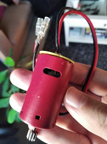

Thanks for the heads up. I got them from Toucan Hobby. The ones that also have their own website and eBay shop. Sent them a message on Facebook Messenger making them aware and asking if they can help out. Let's see how it goes.
Red 390 motors that are fakes!!!!
Are you sure it was Toucan? I have never seen them selling on Aliexpress.
The fakes do work but I suspected their voltage ratings are not the normal 12volts, more like 7 volts. This causes them to over heat fast and melt the fan blades when used with batteries like 2 cell 7.4 Lipos or Li-ion as these put out higher peak voltage then stated on the battery. A three cell 11.2 Lipo is a assured death.
The fakes do work well IF you use the older style of r/c 7.2 volt sub “C” NiCad or NiMh batteries. They still get hot though not as fast and tend not to melt.
Try running them as I am sure it will be more expensive to send them back. Plus it will not hurt your tank if they fail.

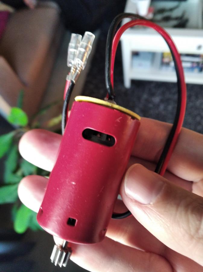

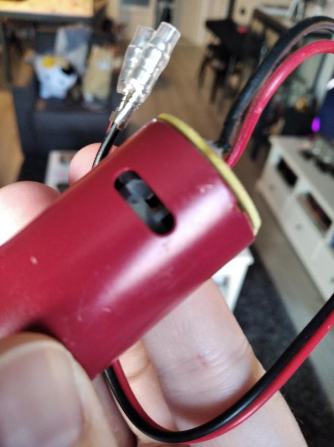

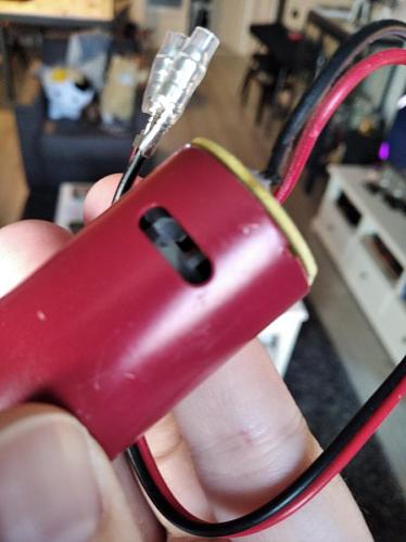

Can you post some pictures of the motors?Comment
Oh yes those DO LOOK like fakes!!!!
You could simply plug them into the tanks wiring harness and run them not installed in the gearboxes to test and see how hot they become. It’s not quite the same as being under load but it will give you some idea of what could be expected.Comment
I'll try that, thanks. I'm not getting anywhere with Toucan. They don't seem to understand the situation and keep refering to use batteries around 7.2v. Language barrier makes it difficult to explain the actual issue.
They also assured me it is made by Heng Long, so yeah... I don't think they reallly know.
