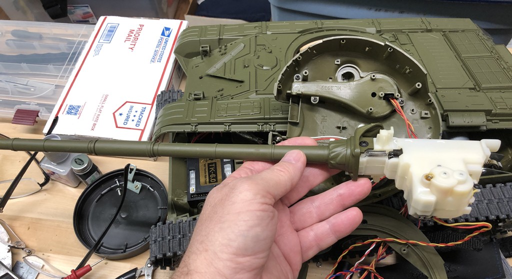

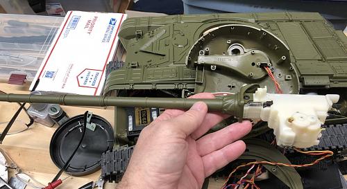

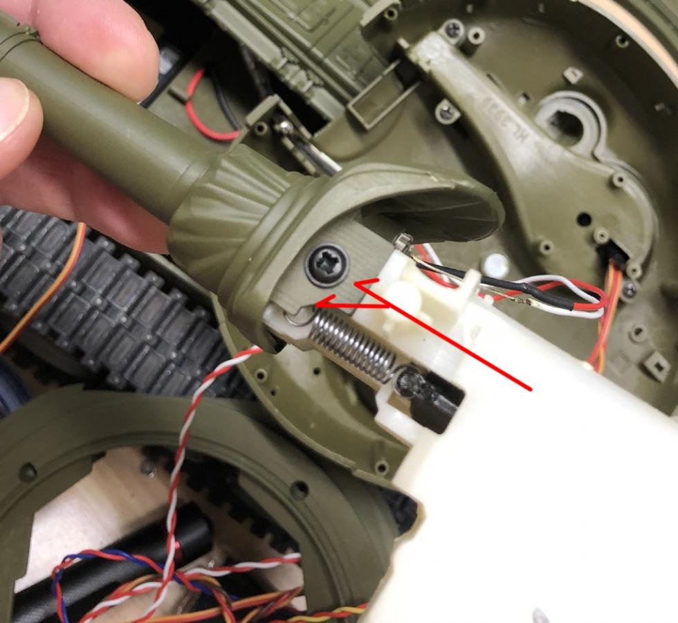

        Sounds easy, but.... Looks like my T-72's gun is jammed. No pellets coming out. I've opened the hull to inspect the gun. Externally, levers and springs seem to be working. here's my symptom, something has jammed in the barrel, most likely pellets since nothing has been shoved in the muzzle, dirt or anything else. I know this because a stick pushed in from the muzzle only goes in 2/3 of the way. I've compared this to two other tanks, and the stick goes in those as far as the firing mechanism itself. I could use a Harley tool (hammer) to smack the obstruction, but my guess there are other pellets behind the first. Any ideas guys?

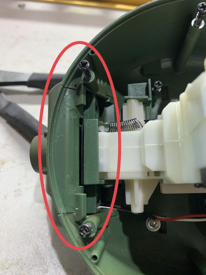

        Removing the barrel is pretty straight forward.
        Once you get the turret disassembled...

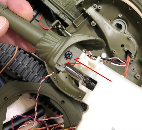

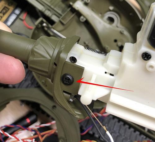

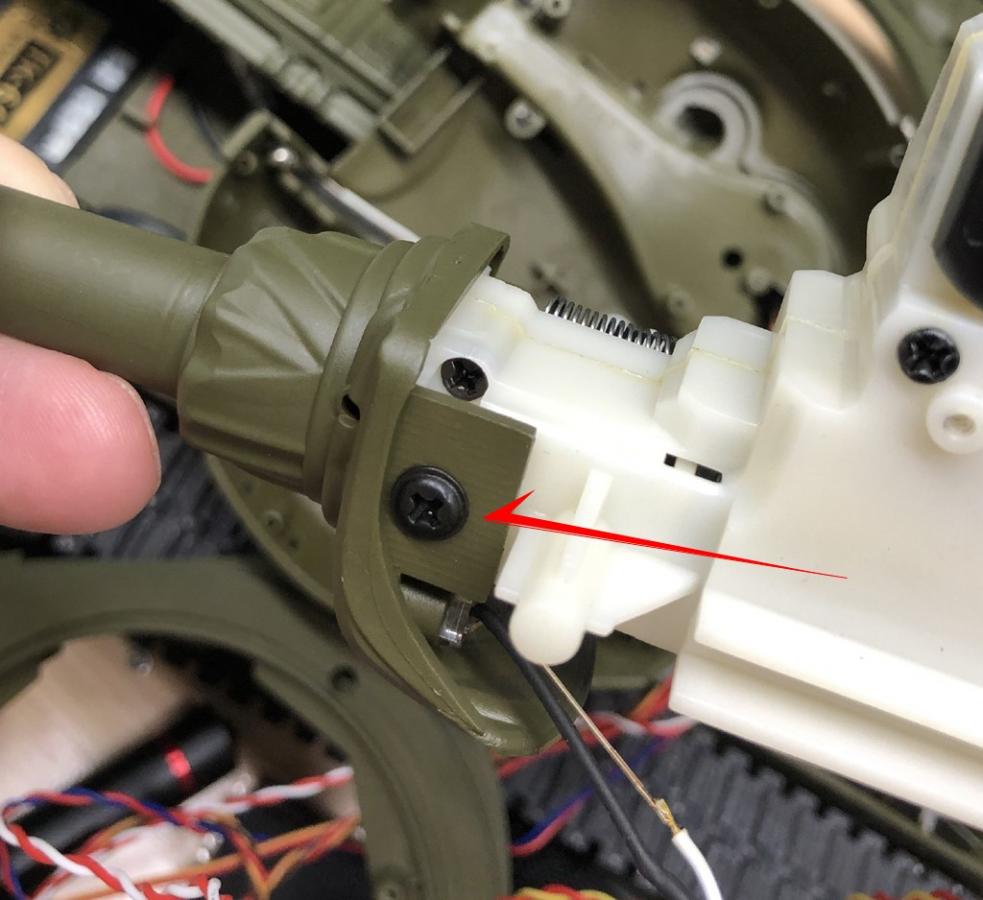

        Remove this screw from each side and unhook the little spring..
        Then you can easily use a rod or dowel to probe the barrel...

          Fantastic, B! Excellent pictures, too!

            Edit: disregard the above. Armed with your photos, I successfully removed the metal barrel tube. There were a dozen pellets in the tube and the gun. However, this prompts another question. There is a small rubber sleeve that fell out when I pulled the barrel out of the mechanism. Any idea where this fits? TIA!

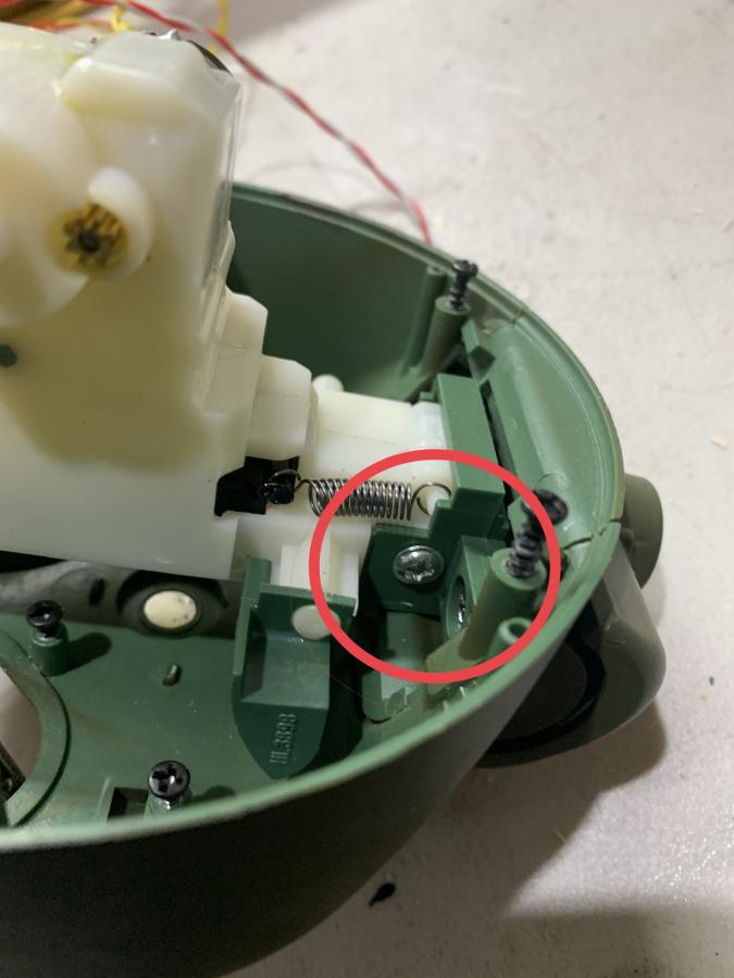

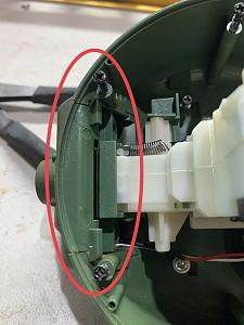

              I am struggling trying to determine how to remove the Airsoft from my Sherman Tank. As you can see in pic 1 there is a screw (one on each side) connecting the Airsoft to the barrel. Based on the pics from Beeg I should be able to remove the barrel (pic 2 area circled). I can pull the sides apart but can not extract that front section. I do not want to pull it too hard because I am concerned about breaking it. This is due to parts are in short supply. Is there a trick to remove the front section? Finally, I can purchase and install a standard Airsoft replacement without recoil and have it work in my tank?
