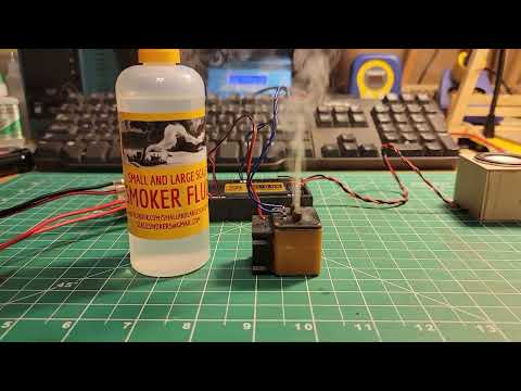

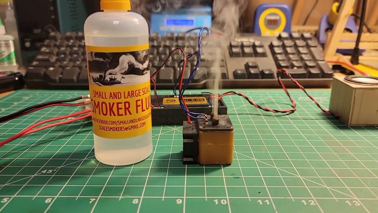

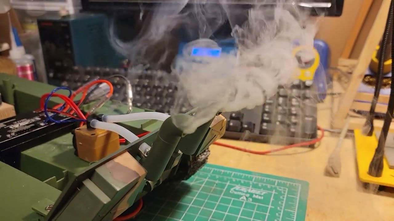

I replaced my stock smoker unit in my Heng Long KV1 with the upgraded heng long smoker that uses a blower instead of a pump to move air. What a huge difference in smoke output. Instead of puffing like a locomotive, it now has a steady exhaust like a real tank.
I also am using this much better smoke oil. I highly recommend it.
Vape juice is either propylene glycol​ (PG) or vegetable glycerin​ (VG) based. Since cloud chasers use a straight VG juice one would think it would produce nice smoke for a tank, but it doesnt IMO. Others claim a 50/50 mix of baby oil & indoor lamp oil works great. I recently received JT's Mega Steam oil used for model trains but I havn't tried it yet-looking forward to it.
