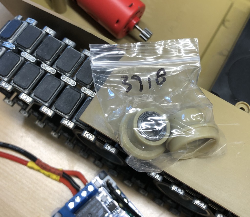

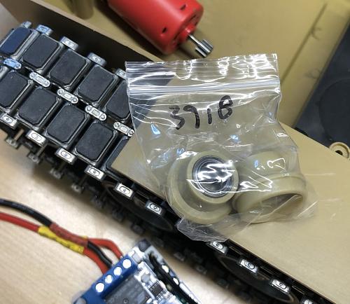

              • Beeg
                • 1335
                • Texas
                Yes. Takes a couple weeks but Tank Zhang is about the only place to get them. Just got a set from them last week.
                Hopefully this will all be much simpler when Motion RC gets their shipment of tanks and spare parts. I'm assuming the drive shaft bearings are a "Heng Long" part and not a 3rd party aftermarket option.
