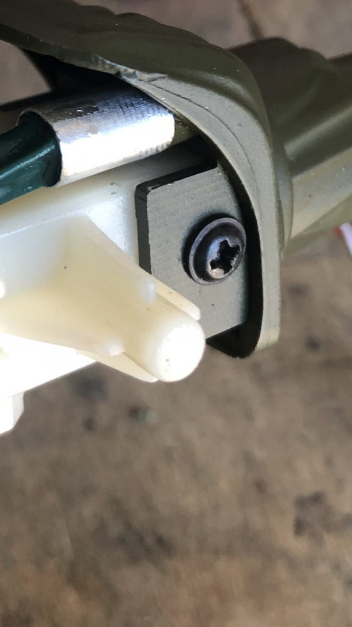

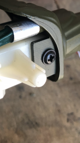

        I'm sorry to bother you again but im at this point and im lost.
        • Rubicon99
          • 3316
          Remove the barrel/mantle and breach assembly from the turret. There are two silver or black screws on each side of the forward breach. These attach the mantle to the breach. Remove them and the mantle and barrel should pull free. Once removed the barrel will slide out easily.
          They look similar to this.
          Click image for larger version  Name:	E8AF94FA-0587-4868-BD61-B125F17B2C6C.png Views:	0 Size:	544.2 KB ID:	266074
