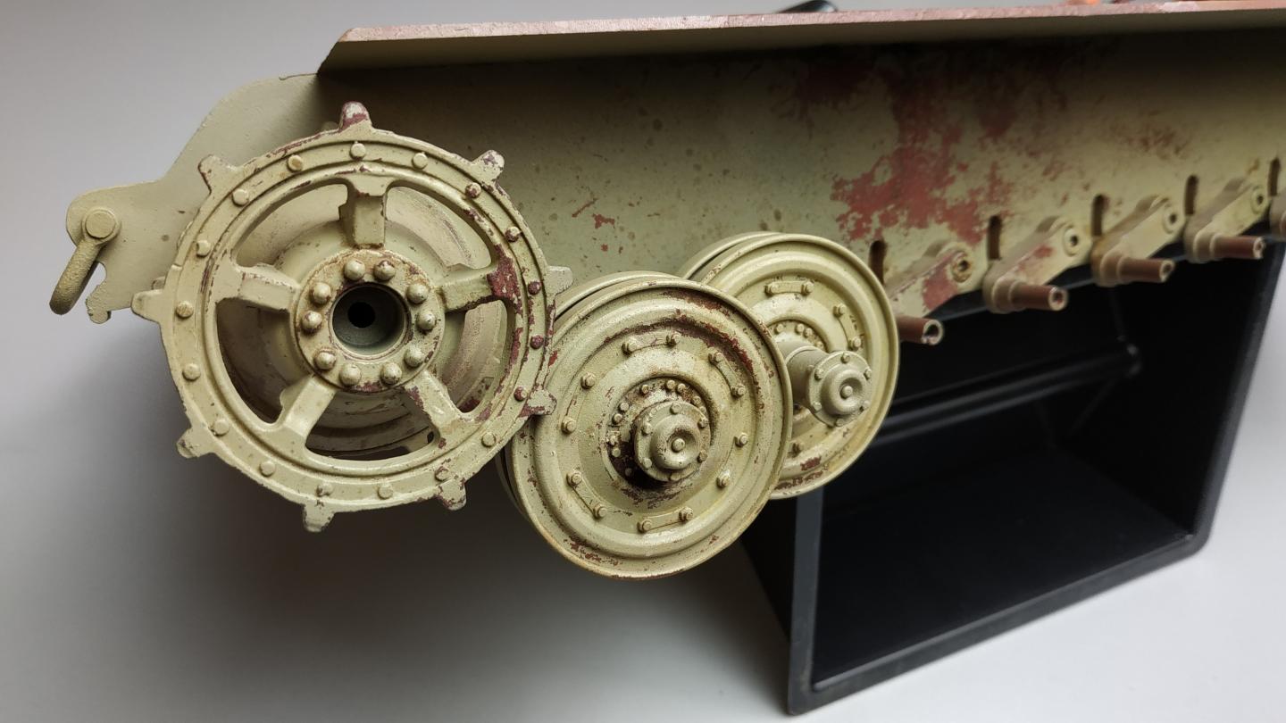

          The advantage of a clear coat depends on where you plan to run your tank. I've found that for indoor use, a standard clear coat is fine and well worth the few minutes it takes to spray it on. However, if you plan on running the tank over riverbeds and gravel, even a hard enamel clear coat will wear off quickly on the drive train and moving parts. Lacquer is better, but it will still be abraded off of the sprocket teeth, idler wheel teeth, suspension arms, etc.
          I consider it natural wear. One way I use this to my advantage is by painting multiple layers of paint around the drive train. Surface prep, primer, red primer, clear lacquer, gray primer, black basecoat, then top coat colors and weathering followed by another clear coat. It's a lot of coats, but it wears nicely in layers, revealing different colors depending on how deeply those moving parts get scratched. I also find it fun to touch up the paint from time to time, which only adds to the "layered" effect.
          I covered this in greater depth in my King Tiger thread.
