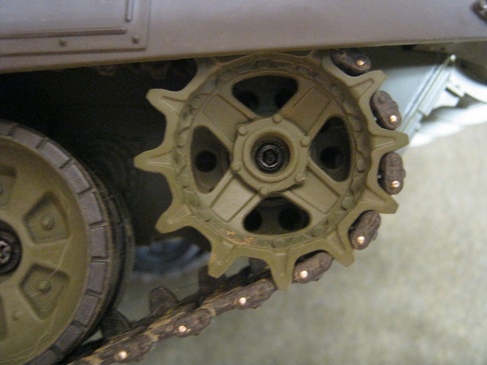

                              The T-72 came today, and I have been driving it around. Even after all these years, it immediately struck me how much better todays Heng Long is than yesterdays Tamiya with steering clutches, and rheostat throttle. Smooth, proportional control at any speed from a snails pace to all out, and functions I could have only dreamed about back then.
                              So far my only complaint is the interface between the sprocket and end connectors. The sprocket teeth are a little oversize so the end connectors don't fully seat which allows dirt to build up rather than clear out.
                              As impressed as I am with it out of the box, and since I already have the steel gears, I think I will give the metal tracks a try.

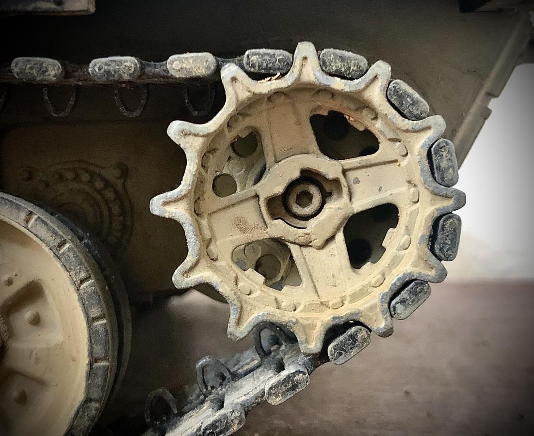

                                The issue you are seeing with the track to sprocket fit is caused by the single pin design of the HL plastic (and HL metal) tracks for that tank. They do not have enough “flexibility” and thus do not conform completely to the curvature of the sprocket. If you go with a set of metal tracks look at the ones offered by Mato for the T72/90 (same tracks). These are dual pin like those used on the real tank and have more aggressive track pad “cleats”. They also have taller track guide teeth (important for improved track retention) and clear sand / dirt out much faster.
                                Below is a well worn T72/90 metal sprocket and track from Mato. You can see just how much better they meshes then your HL stock parts. Click image for larger version  Name:	7797F330-DE04-420C-804C-F32C21BA83FA.jpeg Views:	0 Size:	142.6 KB ID:	278473

                                  #17
                                  The improvement is clear, but not as good as hoped. I think some file work may be in order.
