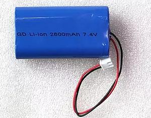

        This is the sort of batteries that I found. Price including shipping is $18 NZ Click image for larger version

          Sappo The connector and wire gauge shown in that photo is not sufficient for use in a tank. The ampacity on those components is much lower than what a tank's power system will draw. The Heng Long motors already draw ~2A at max speed without a load on them. Thin wires like those shown in your photo are typically for low current uses such as cameras, toys, etc. You want to be looking for wire/connector/battery cell that can sustain the amp draw of a tank. Typically this is a 14AWG gauge wire or similar thickness, at least a Tamiya connector if not a Deans or XT60, and a cell (and PCB) that can sustain at least 5 amps easily for optimal lifespan.
          • SoCalBobS
            • 2717
            • Southern California
            From your picture:
            1. It appears the main power leads are very thin, and the connector is a JST-PH type, neither of which would be ideal for the tank application - not able to handle the amp load. i would not be surprised to see the wires or plug heat up so much the insulation or housing melts.
            2. There is no balance plug or wiring. No way to ensure a safe charging process.
            My guess is that it is meant for a very low current draw application, like a phone or similar. My vote is no.
            Oops, Alpha posted while I was writing. What he said!

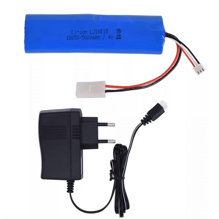

                And this is what I found, $52 nz for 2. Click image for larger version

                  Size issue? Maximum length to fit into the battery bay is 5 3/8" or 13.5cm., not including the leads. Motion RC sells shorty (fits in T-72) 1800mah's for $13 USD, 3500mah for $26 USD, and full length 7000mah for $50 USD, just for comparison. No charger included, though.

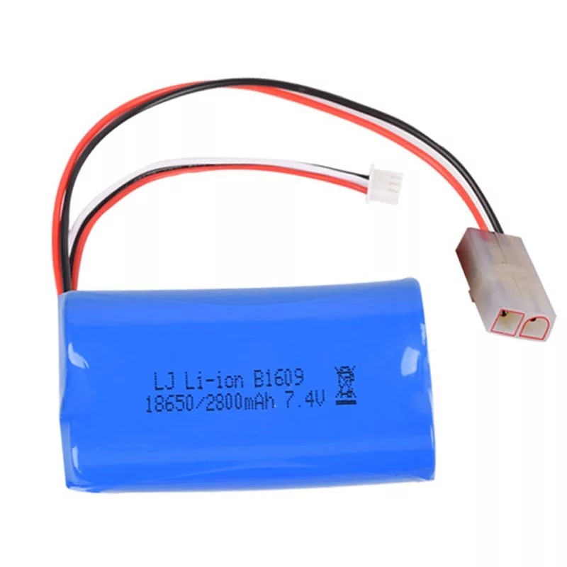

                    Very true mate,I found some 2800mha for $26 nz also, free shipping as well. Trouble with motion rc is availability, they tend to sell out quickly. Click image for larger version
