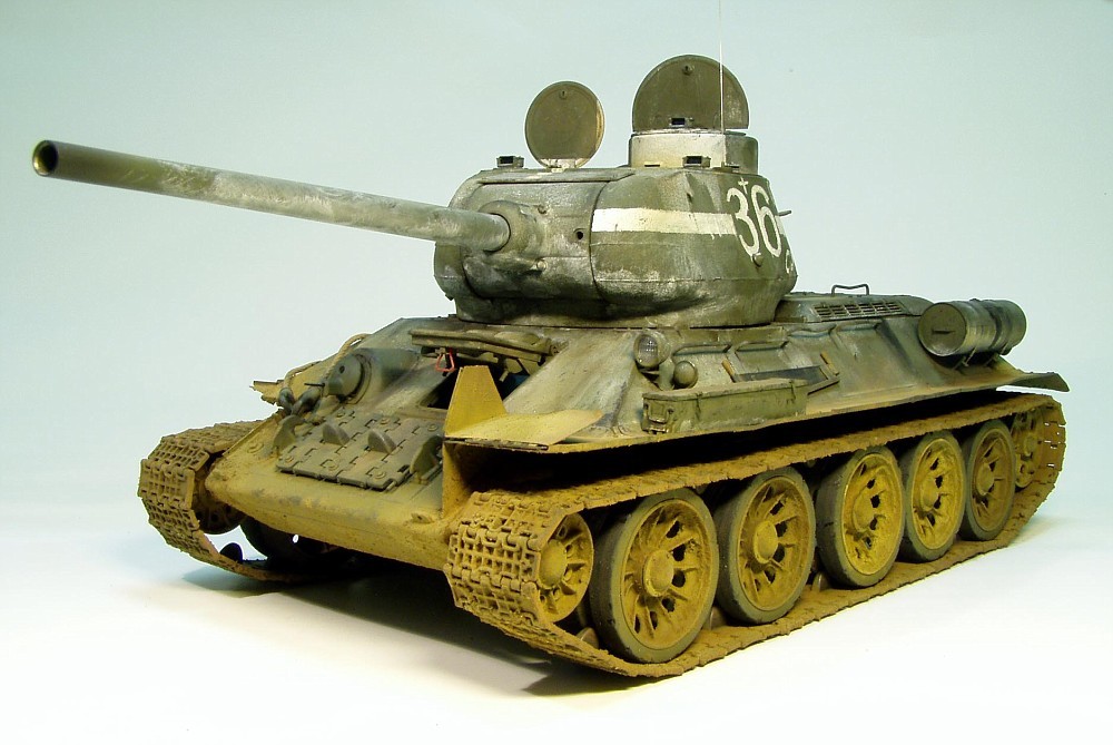

        Because of the texture of the surface, you really need to get the decal into the grooves for it to bond well, so to speak. Like Bob says, fingernails, skewers, anything not too sharp as. And just go crazy on the burnishing before peeling the backing off.
          I agree. The Heng Long T-34 has a special textured surface in certain areas unlike most of Heng Long's other tanks which have smooth surfaces. That texture looks more accurate for the real tank than super smooth steel, but wreaks havoc on any decal because the decal can't fully conform to the textured surface. Solvaset or similar products help to soften the decal to help it stick slightly better, but even so, for a more realistic Soviet style, I'd recommend just hand painting the markings onto the T-34. The tank doesn't have many, and better yet, the real ones were often painted on with mops and paint brushes, so a hand painted application can be considered "historically accurate", from my point of view.

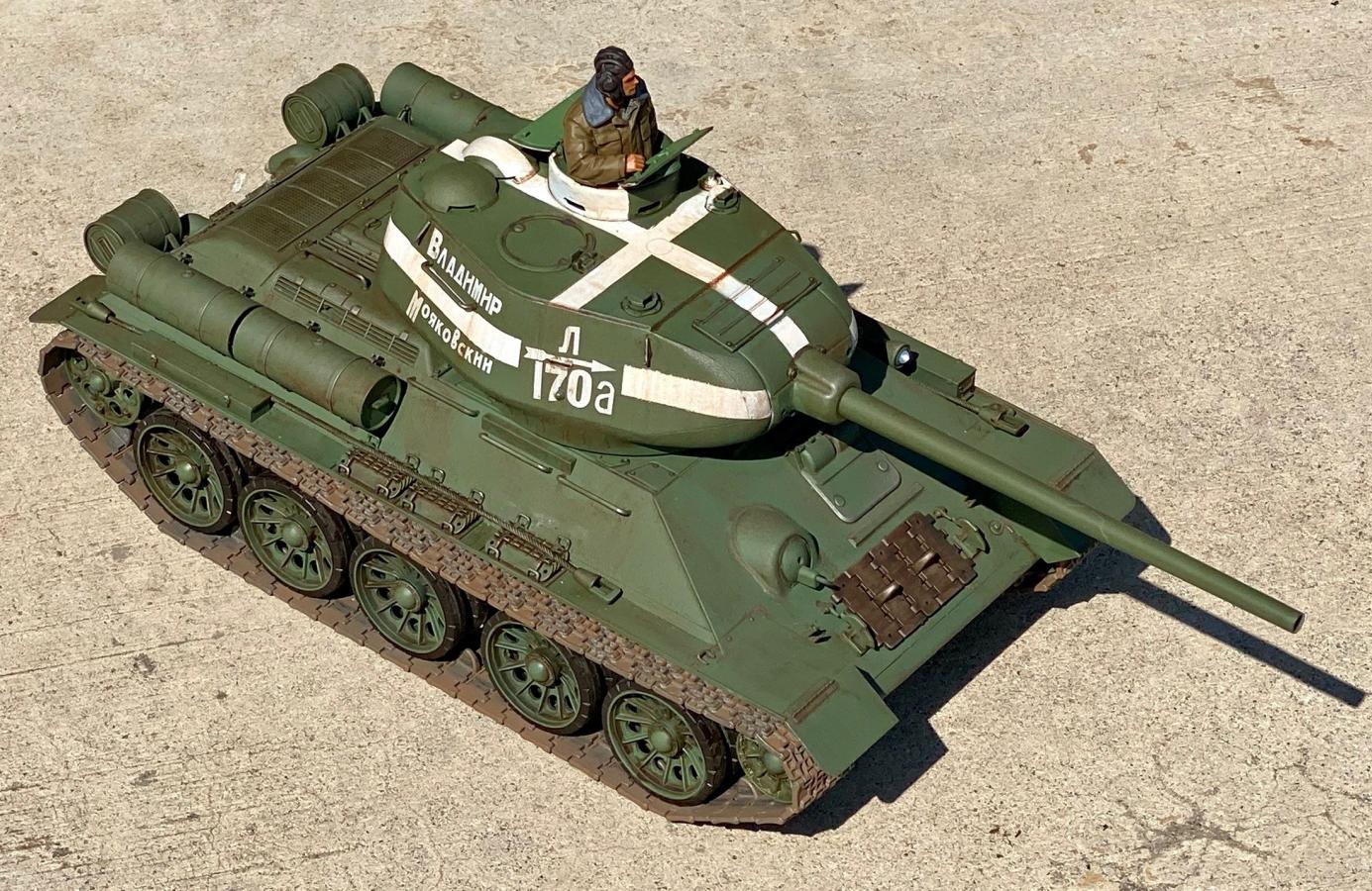

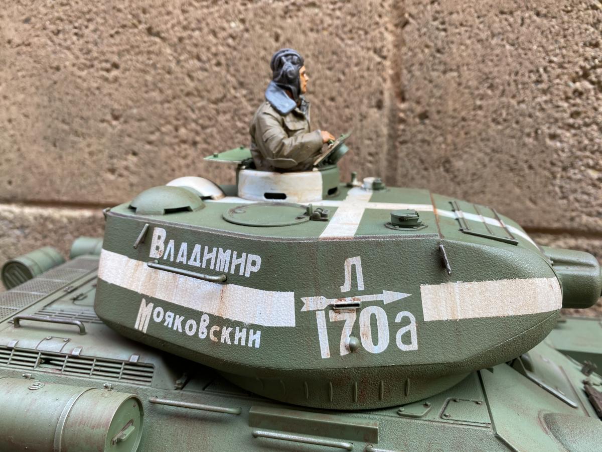

                  I used Archer wet decals on mine and was happy with the result. I followed the Micro Sol and Set procedure, then flat sprayed over them after they dried.
                  Click image for larger version  Name:	A1256705-39C9-4982-BC64-0C5966C5D955.jpeg Views:	0 Size:	289.6 KB ID:	278729
                  Edit: I added this photo to better show how well the Archers work. No film edges, no bubbles, wraps around protrusions. This was the first time I'd used them. Highly recommended.

                    Hi SoCalBobS, Your T-34 looks amazing!!. I got some wet decals for my Tiger I so I could do a "Michael Wittman 007" and they worked great. But the Tiger has smooth surfaces unlike the T-34. I will take your suggestion and use the wet set decals on the T-34. I like the way the texture of the turret surface is visible thru the decal. Thank you for the advise.
