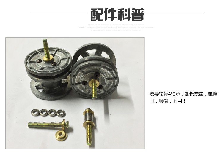

Idlers wheel with bearing (pic) that from Taobao shop ,I can buy direct from China. And I found a bit difference from ebay.

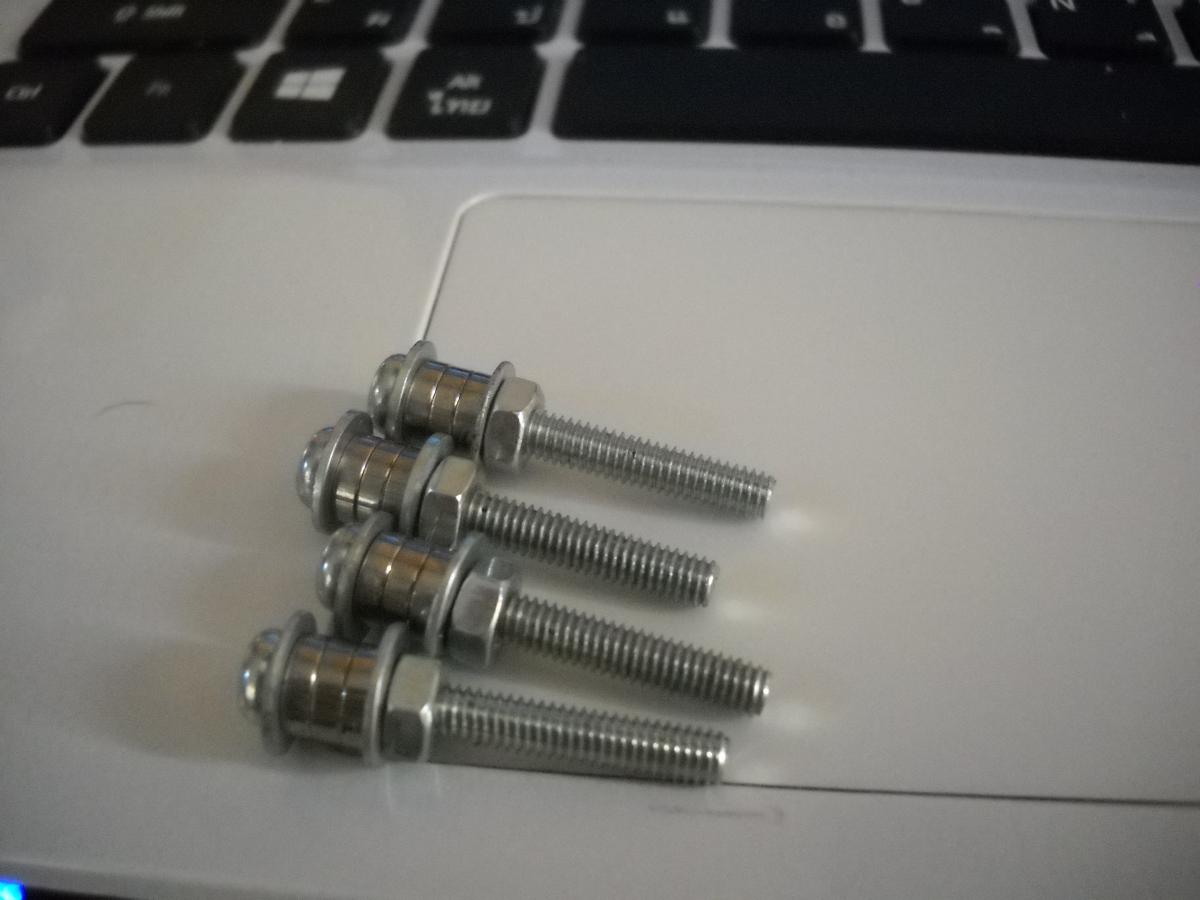

I'm not sure it come with bearing or not. If it 's not have bearing. OK, you have to made by yourself. With bearing size 4x6x2 mm 5 bearing per wheel like my pics. M4 screw(I'm forgot how long for King Tiger) and 2 washers as a pic.
